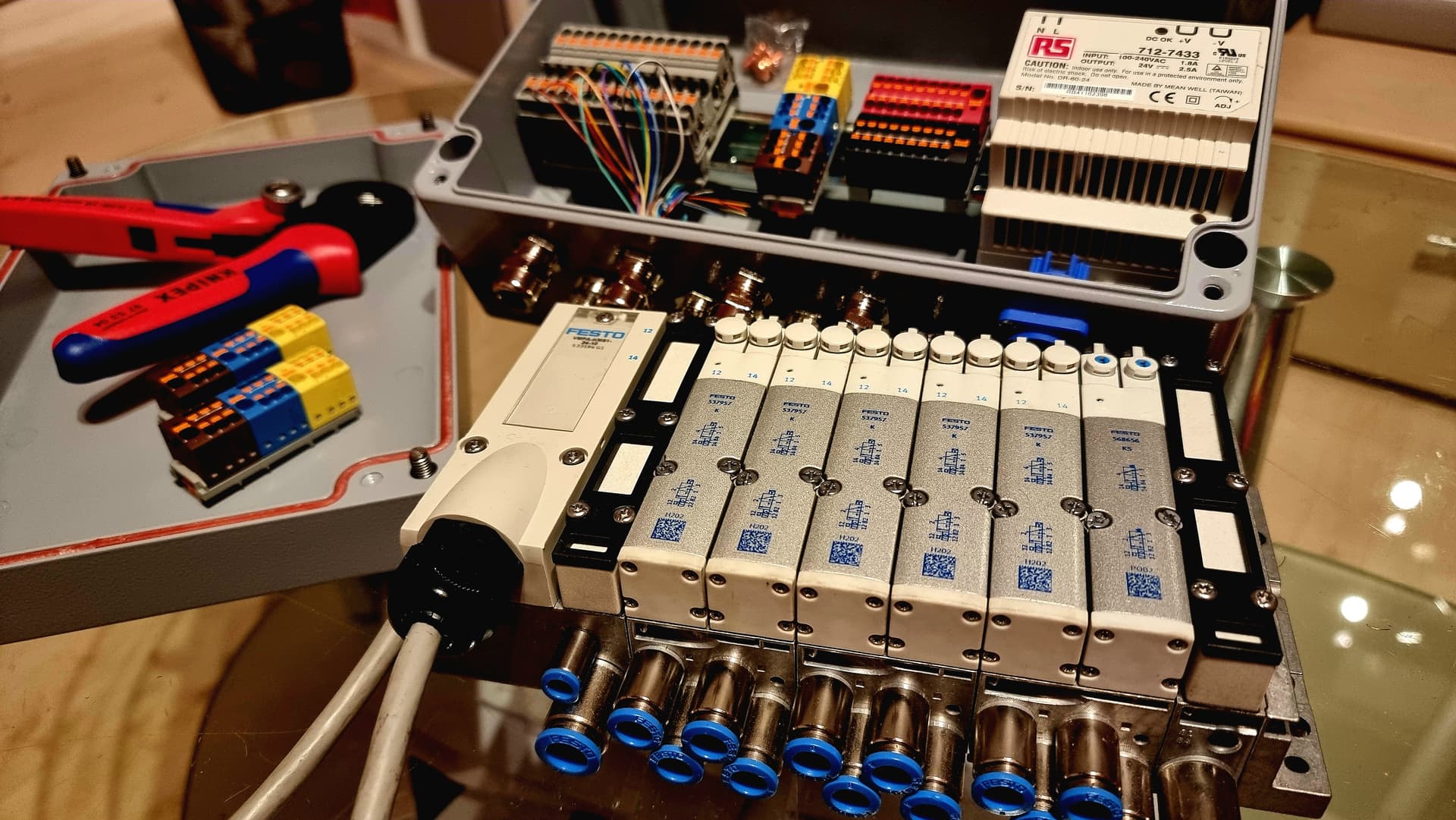

The control for the tool changer and vacuum table

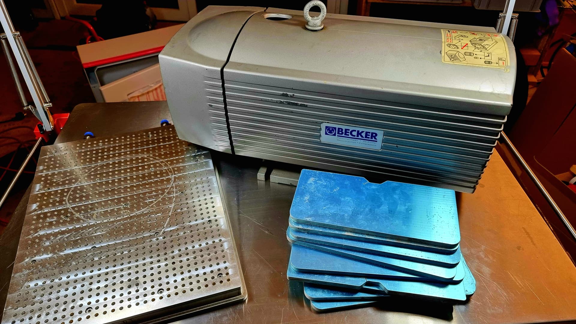

Vacuum table and vacuum pump

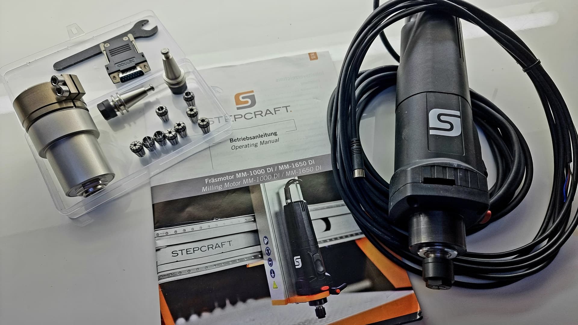

Tool changer and spindle motor

Do you have a link for the toolchanger motor?
Builds in progress are the best ones!
I am also interested in the tool changer.
Toolchanger is from Stepcraft
But so far I haven’t had the chance to test it, I’ll have to wait until LR4 is ready. I hope it works as well as I imagine it will
Thanks for the link, the prices seems pretty expensive?
From what I’ve seen, that’s a pretty reasonable price for a tool changer.
I’m probaly just cheap!
Do you find that tool changer and tool changing is a large part of your workflow?
Kress have a quick release version, but these are brushed motors, i kill those a lot with acm. Going the spindle route better and a rapidchange atc
Kress has been AMB for a while. @Tobs_e used one before and I am using one now. They are pretty great. :slight_smile: None of us have the toolchanger version though.
As i said the quick release version is more manual, but actually faster if you use a collar and a manual bit setter. Price aside im scared to run one of them and have issues with the motor later, i would have to import them to the us then manage to get it shipped to my country and thats kind of a hassle.
link-there is also a 1.4kw one
Maybe i will try one eventually, but fitting them to a LR is not in my set of skills :joy:
Yeah, I’ve got the 1400W ER16 version.
The problem with the tool changer is that you can’t really fix it to the LR since you have the lever to release the tool. I don’t see any way of making that work.
How that works for you? The spindle?
It’s great. You can see it in the Ghostrider thread and on my YouTube channel quite a lot. :slightly_smiling_face:
Yes but the quick release version would be harder to adapt to a LR
That’s what I said. I’d nearly call it impossible. :stuck_out_tongue:
Yes, im looking for a way to do quick changes between tools or broken bits (happens a lot depending on some materials)
Hey, whats your solution for mounting this spindle with the atc adapter to the lr4 core?
I would like to construct a fixture for this in Fusion. The ATC has a diameter of 43mm at the bottom (Euro neck mount, Philipp’s AMB holder could also fit here), the diameter at the top is 54mm.
But it will take some time, I just started printing the parts and don’t have the pipes and XZ plates yet.
