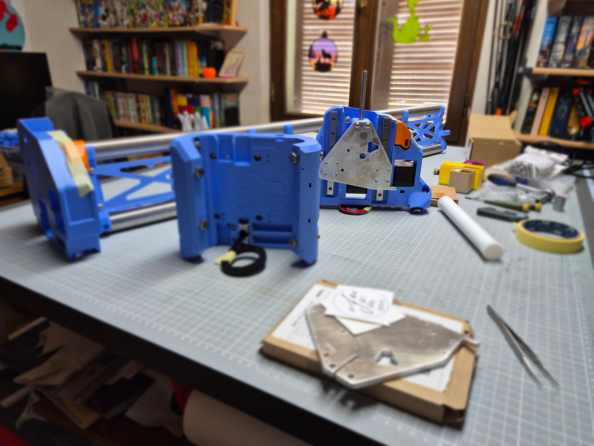

So I started small just building with steel tubes of 1m length. After my first steps in building, I’m very impressed how easy and fast it is to assemble a Lowrider V4. The designs are so clever and well constructed. 3D printing was as easy as possible, and assembly goes very well.
That’s my actual build so far:

Nice stickers on those aluminium plates. I heard the vendor is incredibly handsome and cool. :face_savoring_food::sweat_smile:

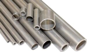

Jabimetal.at, Präzisionsstahlrohr 32mm, that’s what you want. Forget the uneven stainless steel.

Disclaimer: I am the vendor… :stuck_out_tongue: Really nice you found your way here, your project sounds awesome. I can’t add anything substantial though. :smiley:

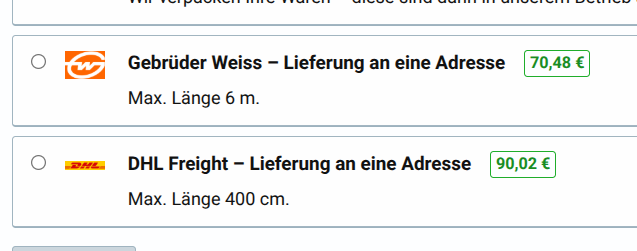

Jabimetal’s shipping was like, 13€? Not sure any more.
Hmmm, for me, it is much more then 13€:
It’s on the better side, but still to much in my opinion. 78€ for the tubes, 70€ for delivery…
I will try the railing maker next to me, and if he can’t sell something to me, I will revisit that option.

Zustellung: GLS – Lieferung an eine Adresse in Österreich/Deutschland 15,62 € 18,90 €
That’s what I paid for a full size LR when I built the second one, the first one was even cheaper. Did you put cut rails in your basket? You don’t want to order the full 6m.
That was the main position with 150cm rails:
1184103203 Stahl Präzisionsrohr 32x3,0 mm rund, nahtlos, DIN2391
[Position 1]: 4 Stück × 1.500 mm, gerader Schnitt
Individuelles Zuschneiden, der Bezug von ganzen Stangen einschl. Restmengen bis zur Produktionslänge der Stangen
nahtlos, DIN2391
8,23 € 6 m 12,88 kg 49,36 € 59,73 €

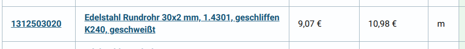

I would use this steel tube:
A printed plug? Have details to share? (as in .STLs or .3MFs)
No, you absolutely want the Präzisionsstahlrohr, it’s basically DOM tubing without any variety in its diameter.
Let them cut 4x1.5m, the second option where they also send you the rest without it becoming more expensive (there is no rest). Also kindly ask them to be extra precise because it’s for a machine in the comment. Mine were perfect.
Will look for it later.
You have to do some rust treatment for the Präzisionsstahlrohr, use Silbergleit for instance. You are not going to be happy with Edelstahl geschweißt because it’s never perfectly round which leads to core wobble in some spots and minor binding in others. I know from experience with the MPCNC and the LR3.
OK, I thought, if it is polished, it would be round. Lesson learned! Thank you!
