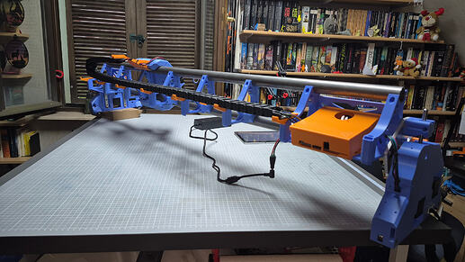

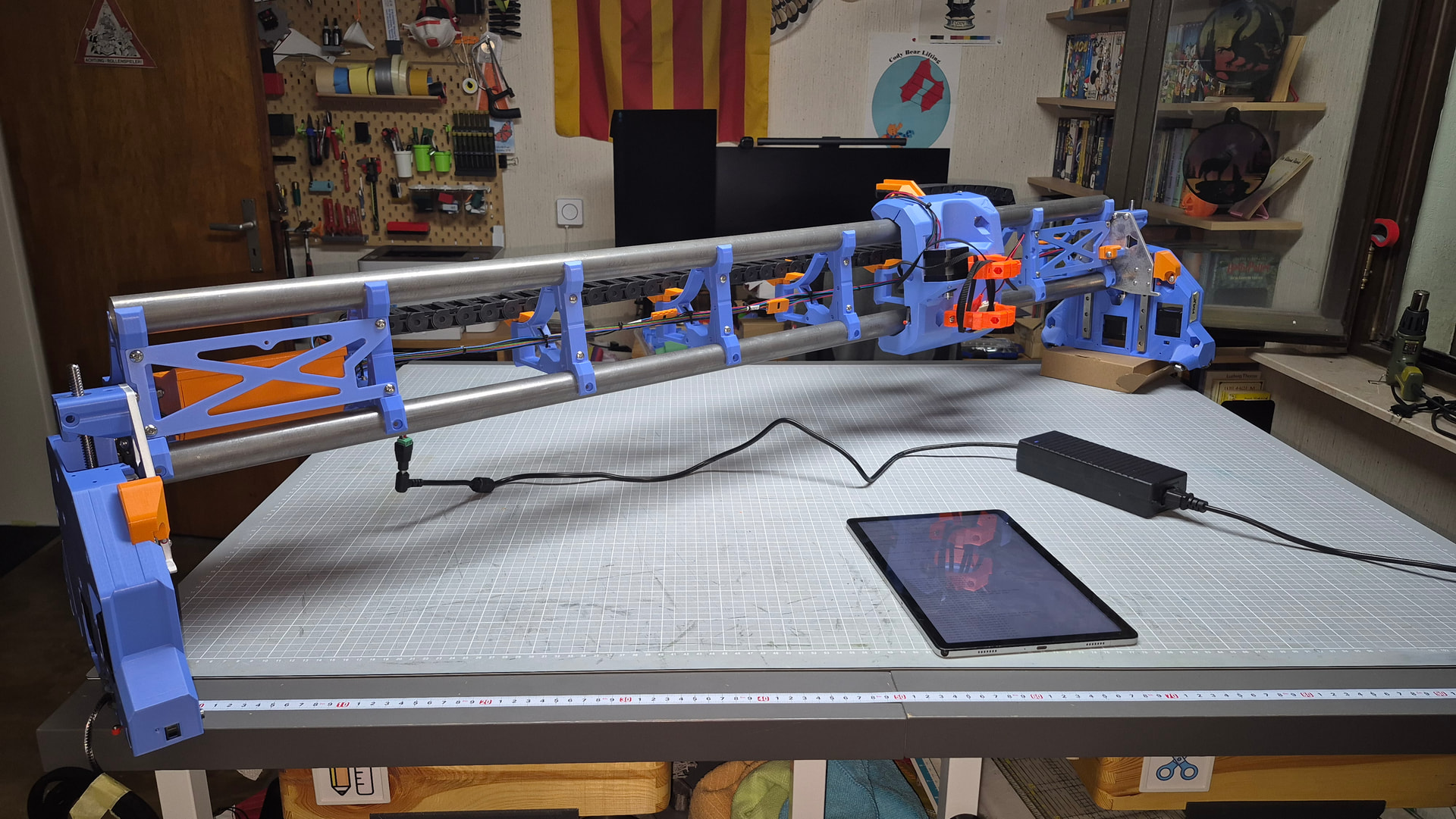

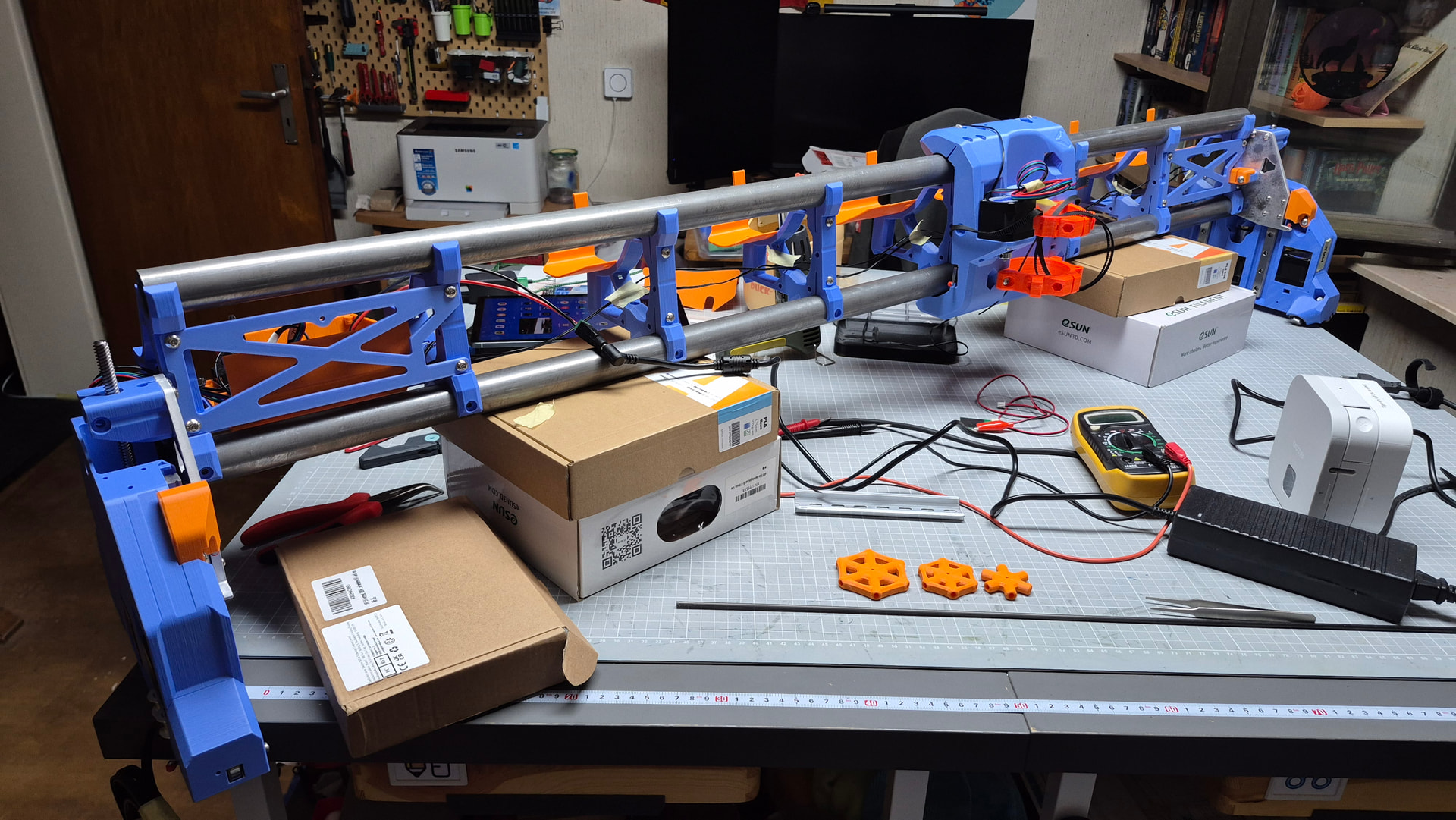

Hello!

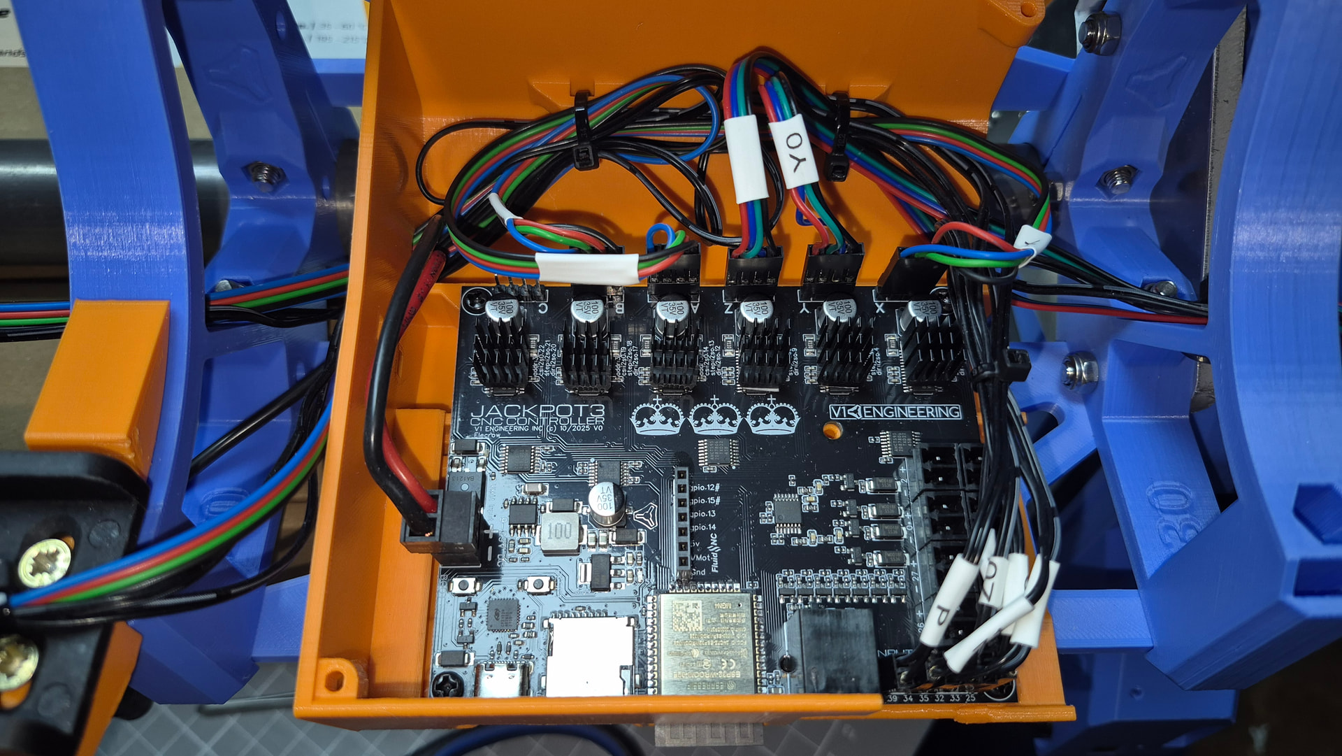

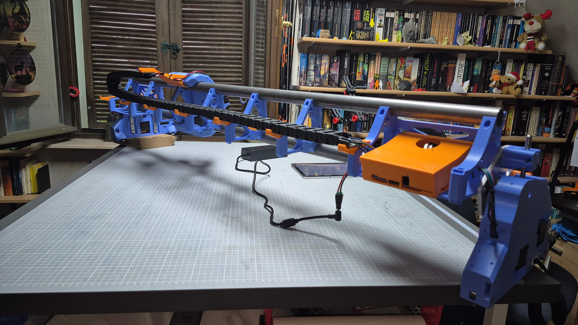

I worked a bit more on the beam! At the moment, all motors and switches are connected, and work fine over the web interface.
It now can stand on it’s own, when powerd.
Cable management is not one of my strong skills. But I’m happy with it.

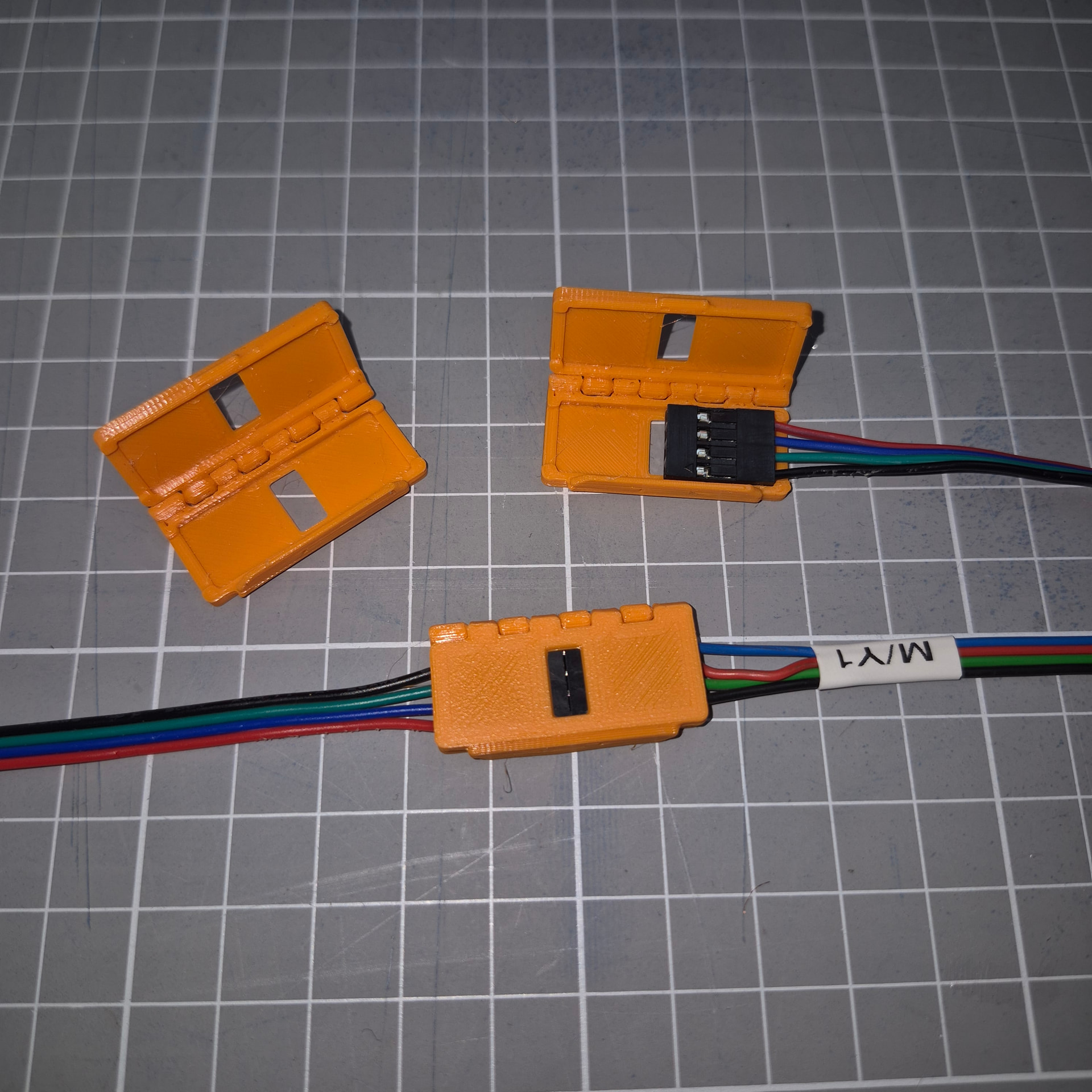

I did some decisions:

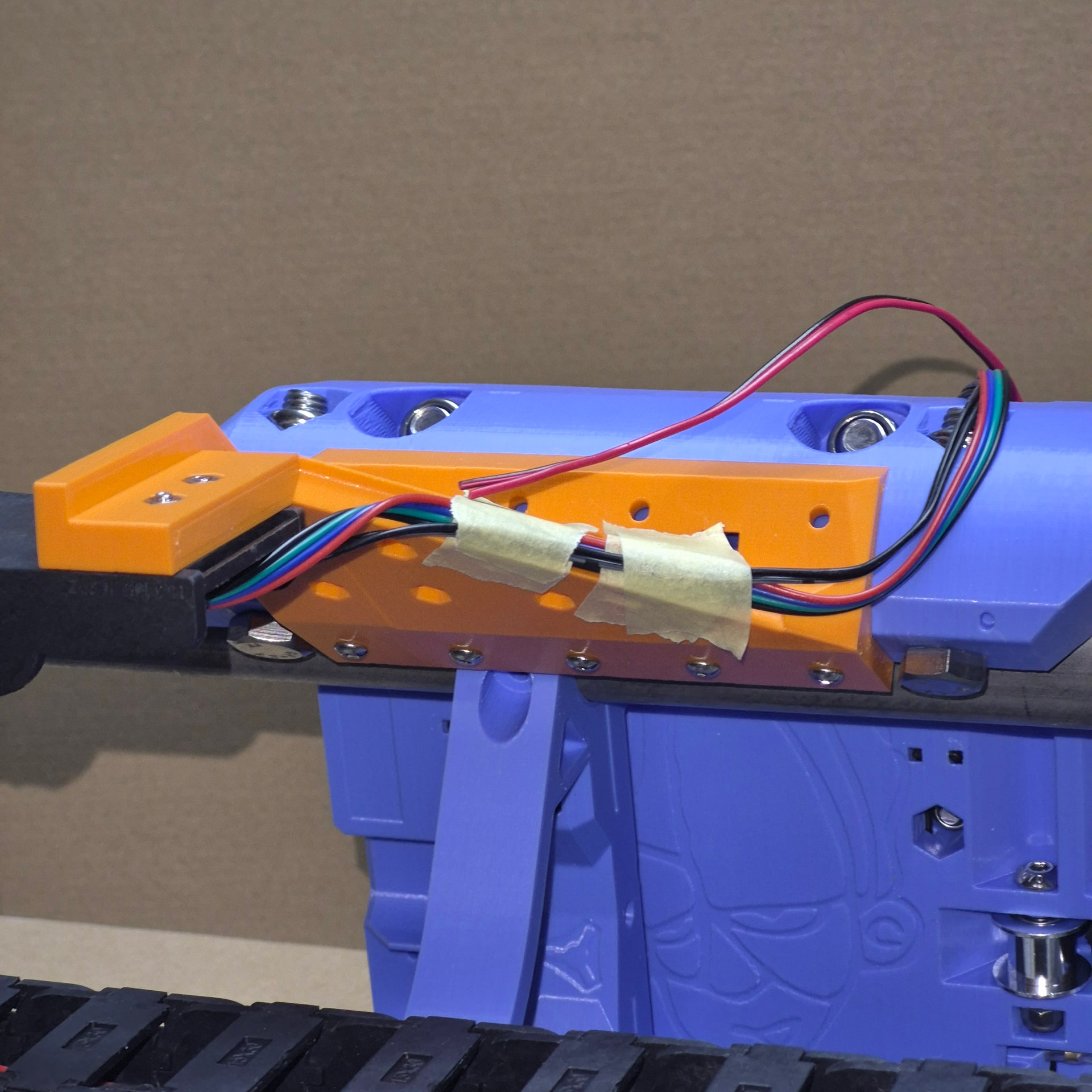

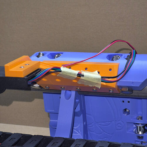

First I decided not to use the folding method to keep the inter cable connectors from the cable extensions secured. I used some 3D printed parts I found on printables (2,3,4,5,6,7,8 Pin Dupont Cover With Improved Hinge by Connor Pritchard | Download free STL model | Printables.com):
Time (or someone in this forum) will tell me, if that’s a clever ideal. I like the look of it!

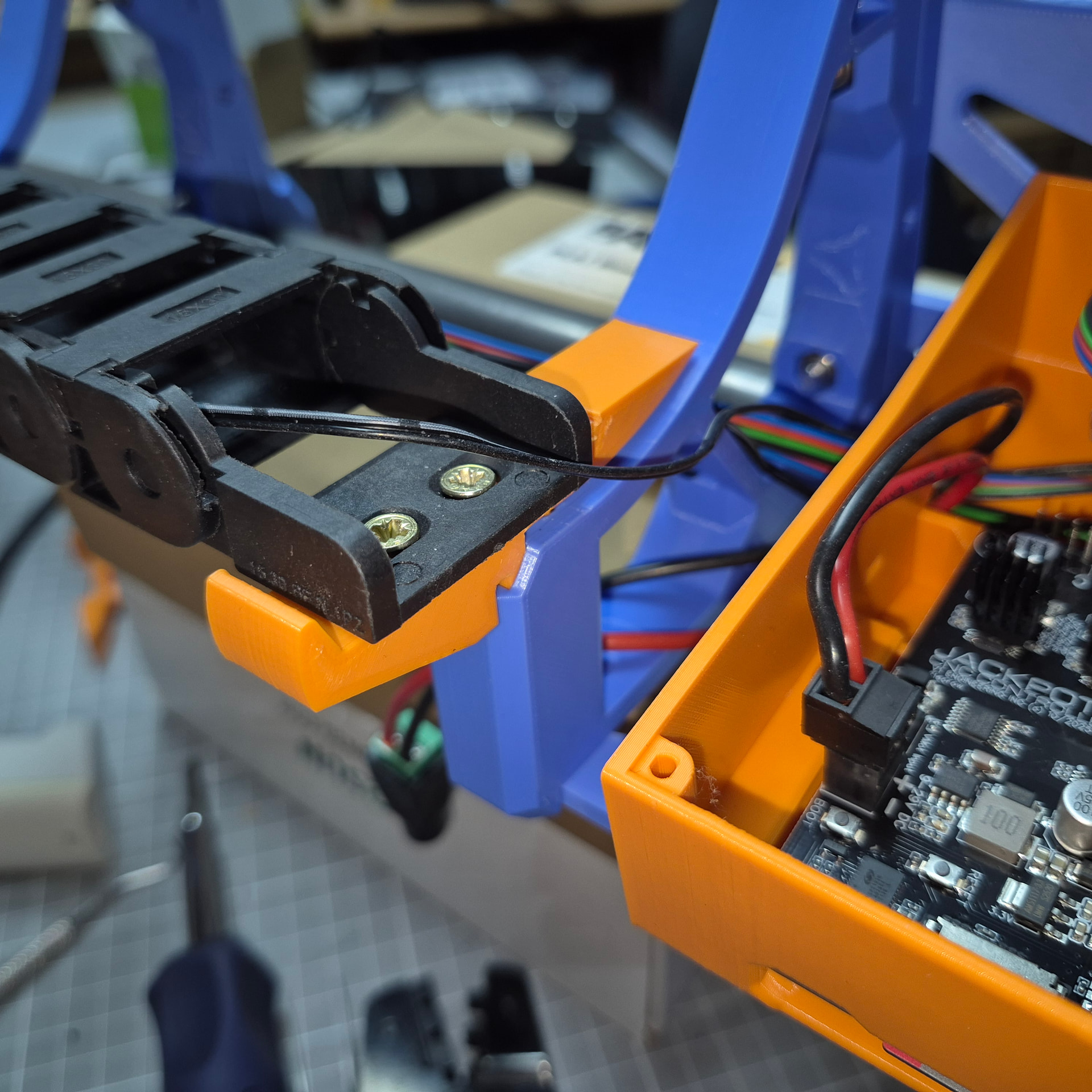

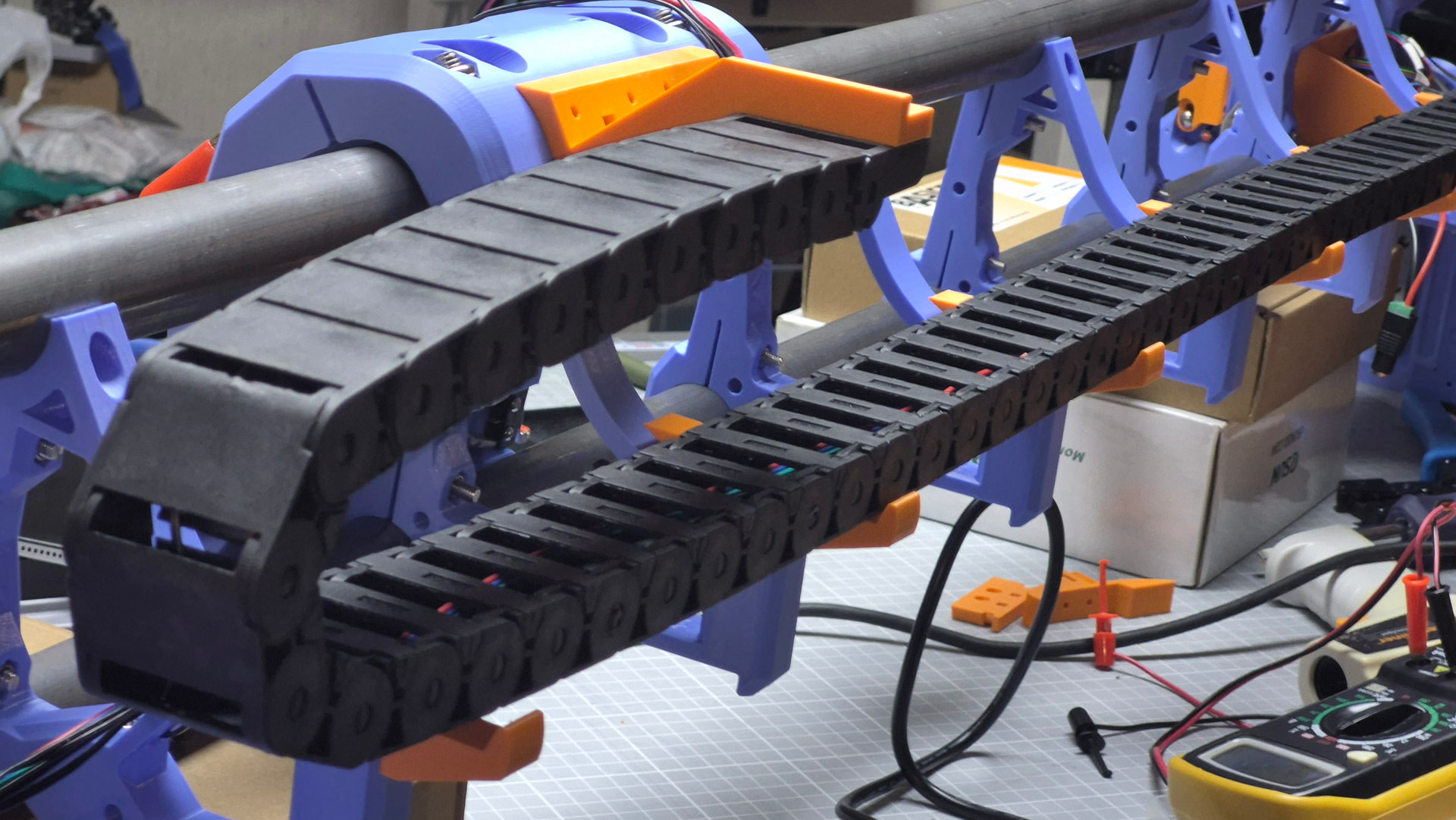

And I don’t have a shop vacuum, and won’t buy some soon. So I tried some solutions for guiding the cables. But I didn’t like any of them. That’s why I decided to use a drag chain instead. Using a solution I found on printables (Lowrider 4 Drag Chain by Tigger09 | Download free STL model | Printables.com):
I already changed the tape to cable ties! :wink:

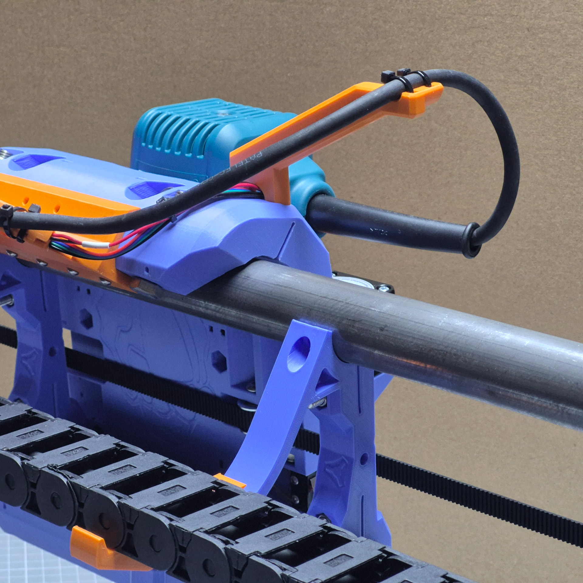

My Lowrider build is a bit stagnating at the moment. The beam is ready, it moves, I can home x and allready tried the touchplate for tool length.
Now I would build the table and y rails. But I can’t fit the wood into my small car.

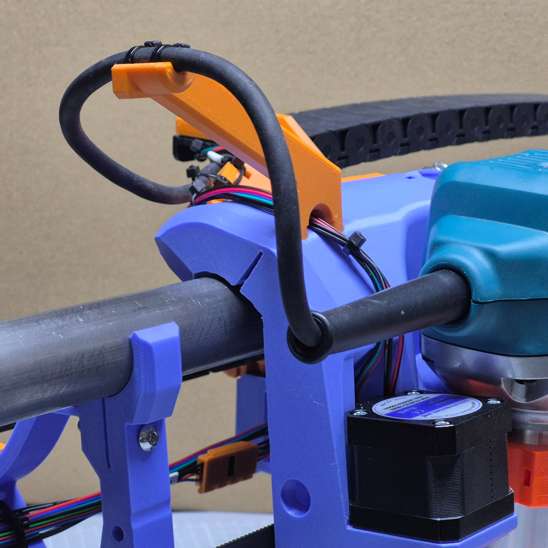

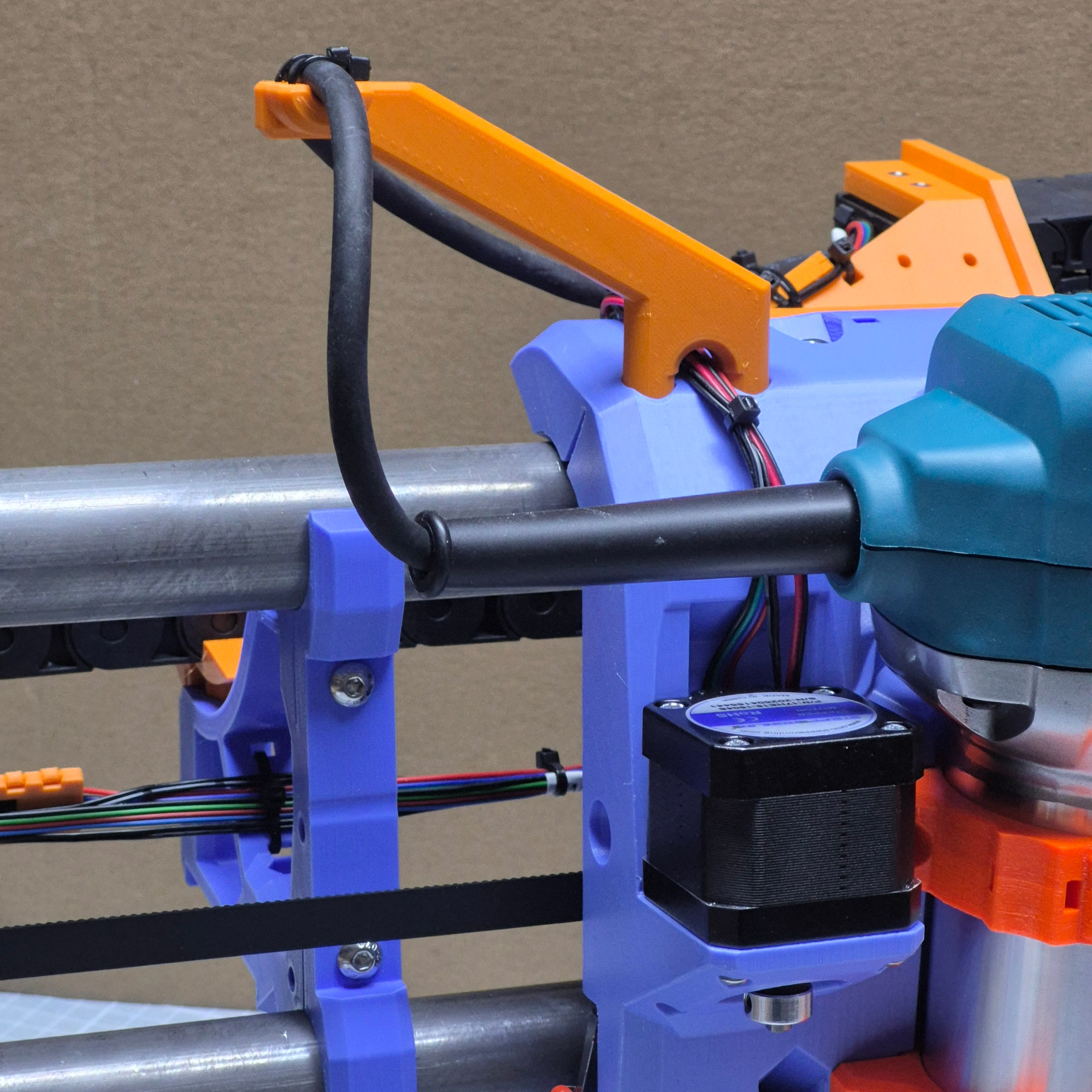

Meanwhile I played a bit around, and realised that the power cord of the router is catching on the lead screw on Xmin.
To avoid that, I printed an small arm, holding the cable up.
Works for me! And it mounts without tools and screws.
I don’t wont to upload it on printables, because it’s not thoroughly tested. But if you ask me, I will give you the stl or the SolidWorks-files.
