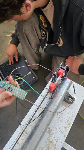

Still a work in progress, but we have hit the deadline on the classwork part of this.
We implemented a very basic load cell. We modified the belt nuts to include a straight segment where we could mount the strain gauges. The gauges register the strain of each axis.
The next steps are to move the load cells from the negative end of the axis to the positive end to get out of the way of the homing cycle. We then need to calibrate the load cells with a known load so we can see real rather than relative force values.
The load cell shows a clear peak and sudden drop when the stepper skipped steps.
Error avoidance:
When the force gets close to the maximum our machine can handle, the arduino running the load cells throws a signal to the Jackpot controller’s limit switch pin. The system aborts the program and throws an error letting us reset the machine.
The next step is to configure the machine to adjust speed based on the force rather than simply abort the program. This will reduce the learning curve on running the CNC and let us really push the limits of machining speed without worrying about scrapped work pieces.

That’s a cool idea using the belt directly as the strain material. What are the key advantages you see to doing it that way? Are there any downsides you can think of like a lack of linearity? Would there be any advantage to designing a more conventional/COTS load cell into the belt anchor?
Being able to measure actual belt tension during assembly would be a potentially useful feature to have, currently that’s a part of the assembly process that I suspect has very wide error bars on it, machine-to-machine.
Some form of real-time cutting force feedback would be an awesome feature to have, I measured spindle power a while back thinking that’d be a fun thing to have available as realtime or logged feedback, potentially providing a good method for determining tool wear or helping to debug setup issues.
Seems like a really promising idea. It’s similar to the accelerometer approach used for 3D printers but in a method that’s much more appropriate for a lower speed/higher force scenario like a CNC router.
