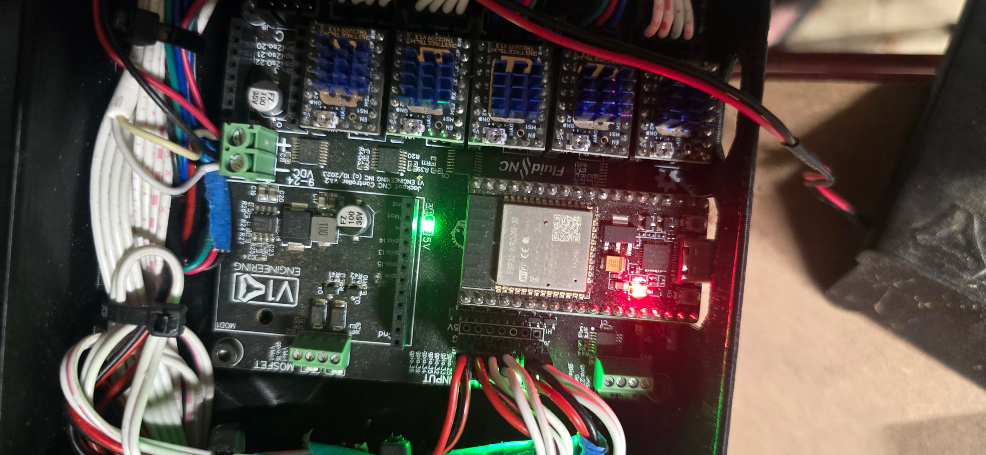

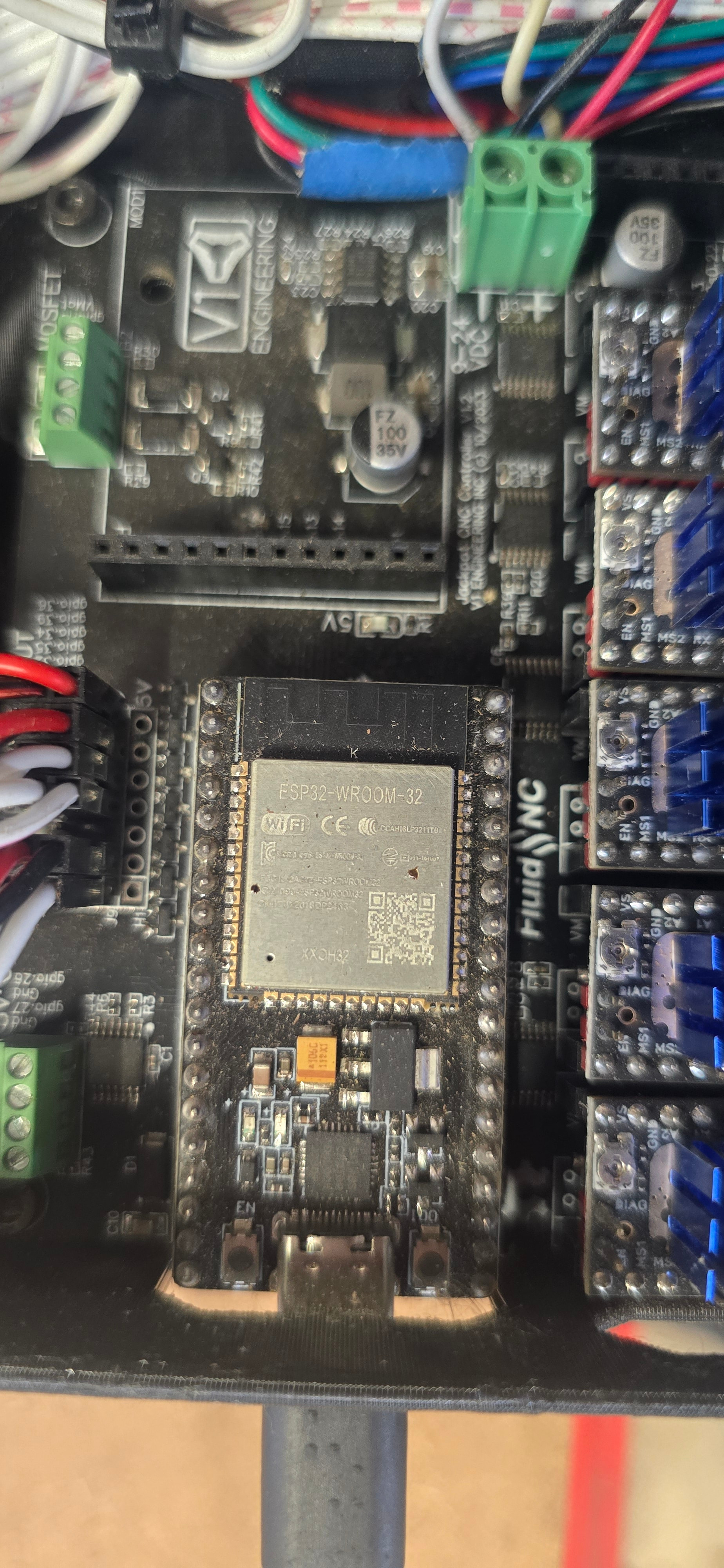

the SD card is pulled out and the USB cable is hooked up to the board but not the computer… currently.
Is the esp-32 fully seated?
If the harness connectors have been off the board, pull them all and add them back one at a time and see how that goes.
SO I have managed to get into the UI through AP, and move the machine. I have cleared the sta ssid and password. I have rebooted the routers. I still cant figure out what is going on, but it could be so many things. For now, I can AP into the machine.
Its just strange that it boots into STA, gets and IP address, but then its like the connection drops. Because it got an IP, it doesnt try to kick to AP. ESTLCAM not seeing the usb connection is just silly because I can run serial terminal through putty and send all the commands I want.
I even tried pulling the box off the gantry to see if the steel plates and everything else was causing an issue, but nothing changed.
Nothing has been disconnected since the last time I ran it on the wifi. And i havent run any updates or anything on the mesh/router side that may have kicked it off. I’m leaning towards a weak antenna even though my Deco mesh should be blowing past that issue like it always has. It drops the connection and then sits there waiting for the next signal which isnt coming. IDK.

Is your mesh node set to auto for the channel? You may have rotated on to a congested channel?
Just a few days back we had a random issue and a re-flash fixed it. Not sure how or why but, it is a pretty easy option. Just keep your config / edits you might have made.
Was trying to avoid flashing just because of this, but really everything is so different now that nothing is worth keeping. Might be time to start over and tune to this set up.
FluidNC Firmware - The Current tested and confirmed FluidNC version is 3.9.9, and WebUI V3, use anything newer than this with caution.
Just checking to make sure the Docs on the Jackpot 1 still show the last safe version to run.
I think 3.9.9 is still the official recommended version, but the latest (4.0.3) has seen enough usage without issues that it should be a reasonable choice too. Webdav support is the main useful difference. It also adds ESP32 S3 support but that doesn’t affect Jackpots.
Its not perfect, but functional enough to start really getting picky. Ended up with 600x 900y and roughly 90 Z. Those aren’t max values, but good round numbers just shy of the max. I think x was 610 and y was about 923. 600x900 it is. Everything is working as it should from AP. I did flash to 3.9.9 with webui v3. But I haven’t tried to get it on my wifi yet. I do have a CNC machine again though.

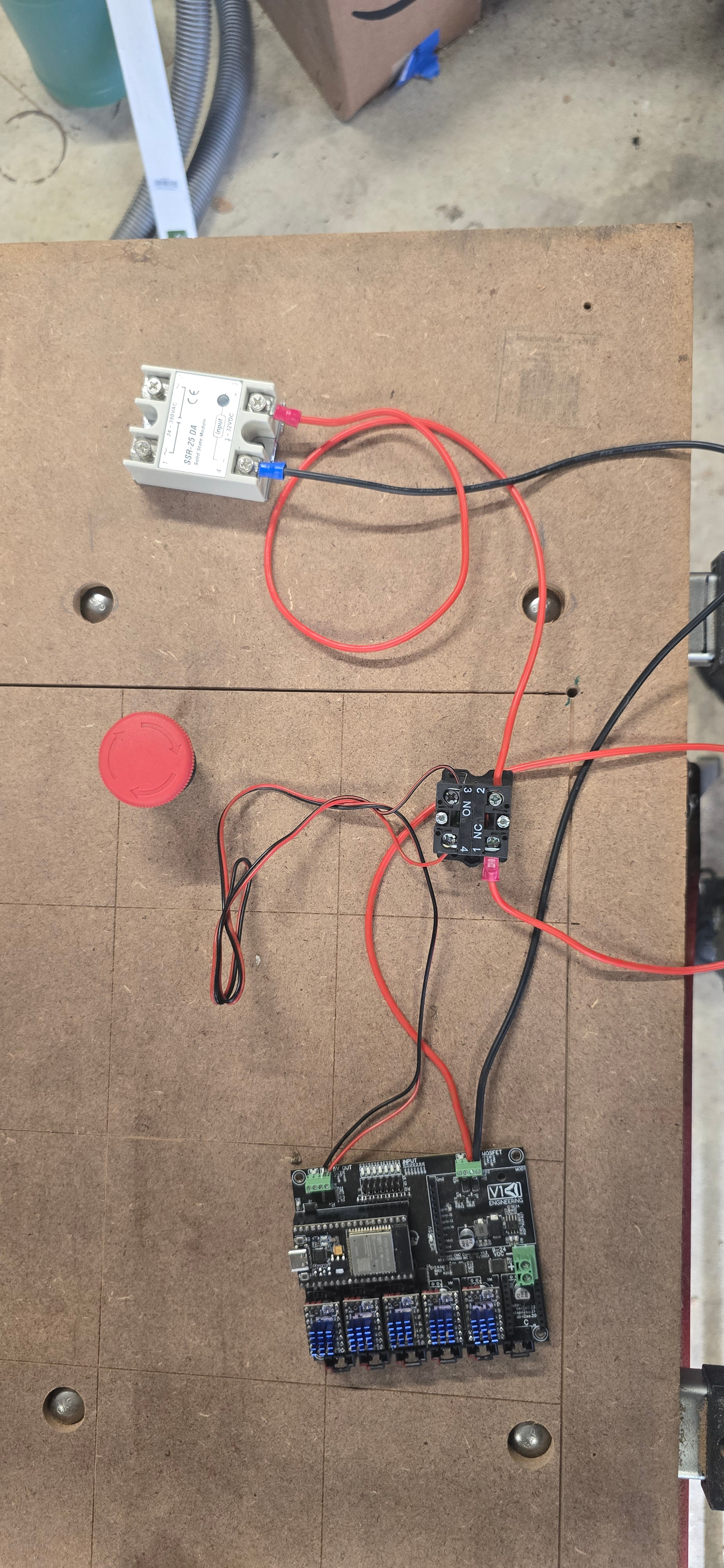

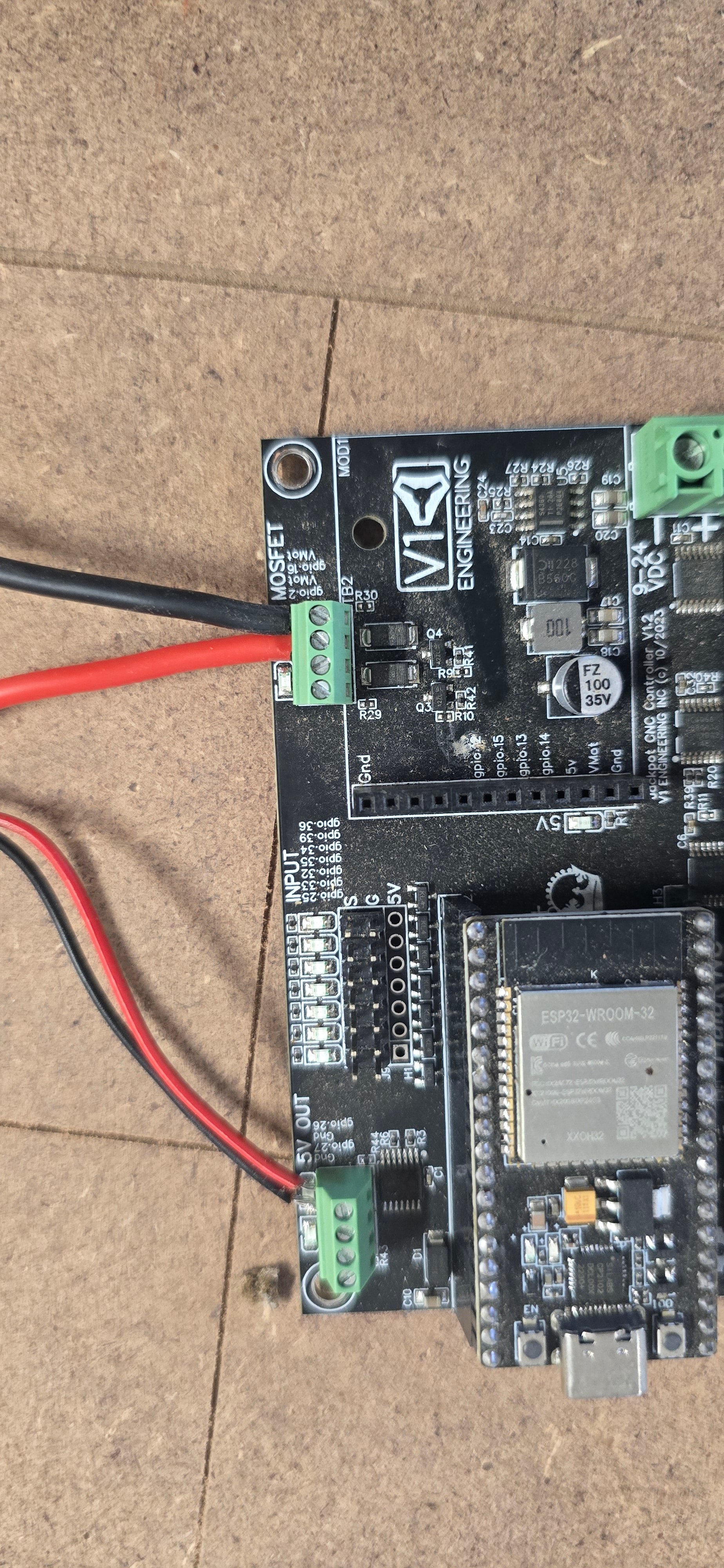

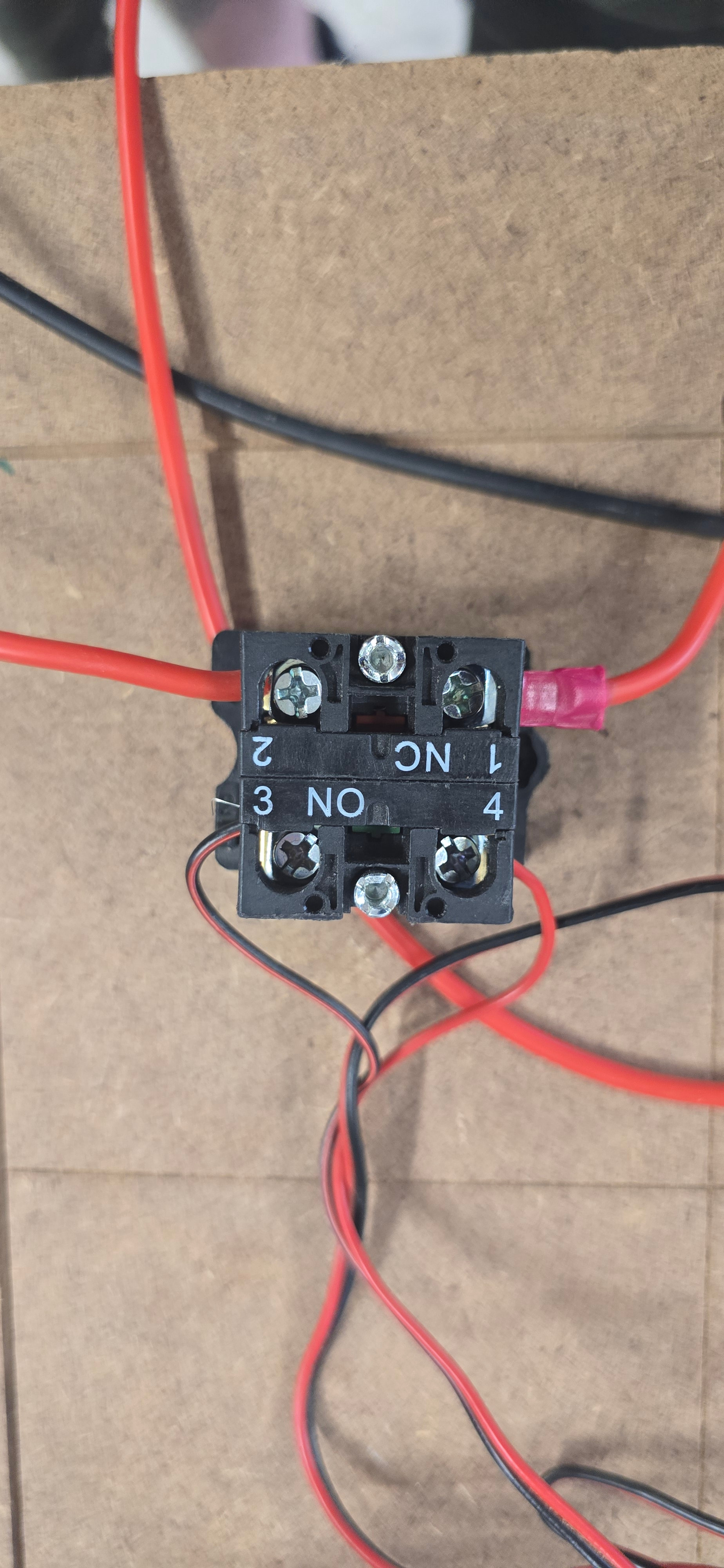

I’m redoing my wiring and finally moving conto of the router to the jackpot. I did some searching in here and the general consensus is got was kill all the things at the same time. I’m not willing to do that. The gantry will drive the not fully stopped bit into whatever is under it. So I’m opting for killing 5v ssr signal, and triggering a software halt that will keep the z motors energized.
MOSFET circuit:
MOSFET gpio → NC on e-stop → SSR input+ → SSR input- → MOSFET GND
Normal state NC is closed, MOSFET drives the SSR, router runs. E-stop opens NC, SSR drops, router dies hard.
5V GPIO circuit:
gpio.26 (5V out) → NO on e-stop → gpio.27 GND
Normal state NO is open, gpio.27 sees nothing. E-stop closes NO, pulls gpio.27 to the 5V signal, FluidNC sees the input and executes software stop.
These are just jumpers and their is no power to anything.

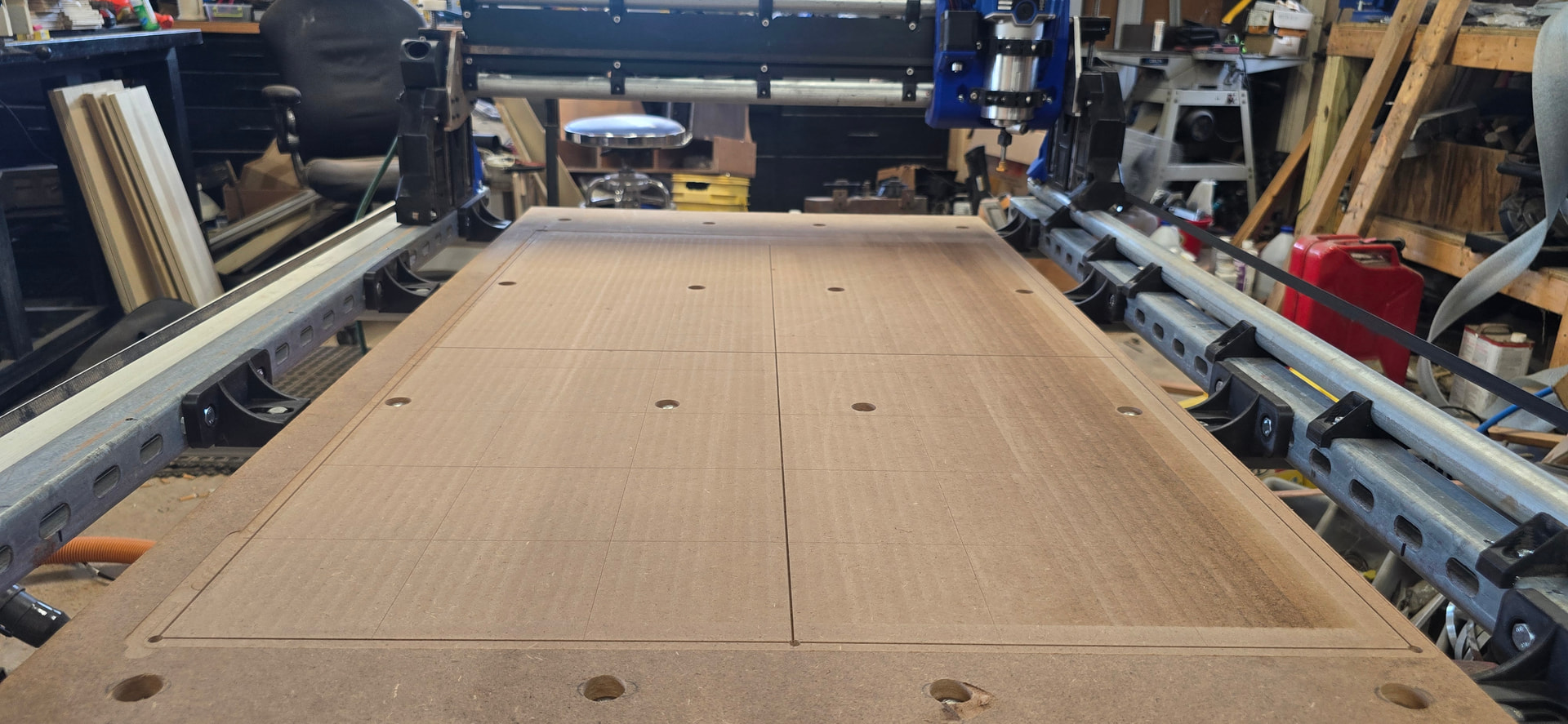

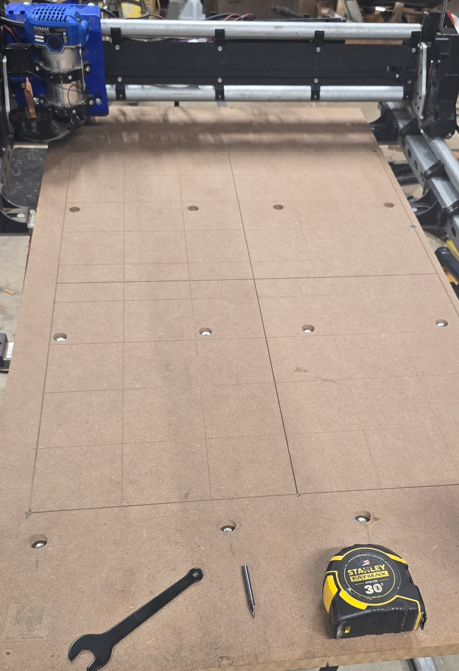

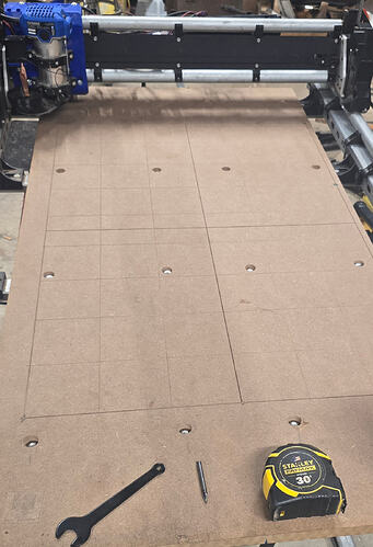

I’ve been working tram and did a couple side by side passes with a ¾” diameter bit.
it came out impressively flat. I need to surface the spoilboard and recheck, but this is about as close as I think i can hope to get with a cheap kobalt router.

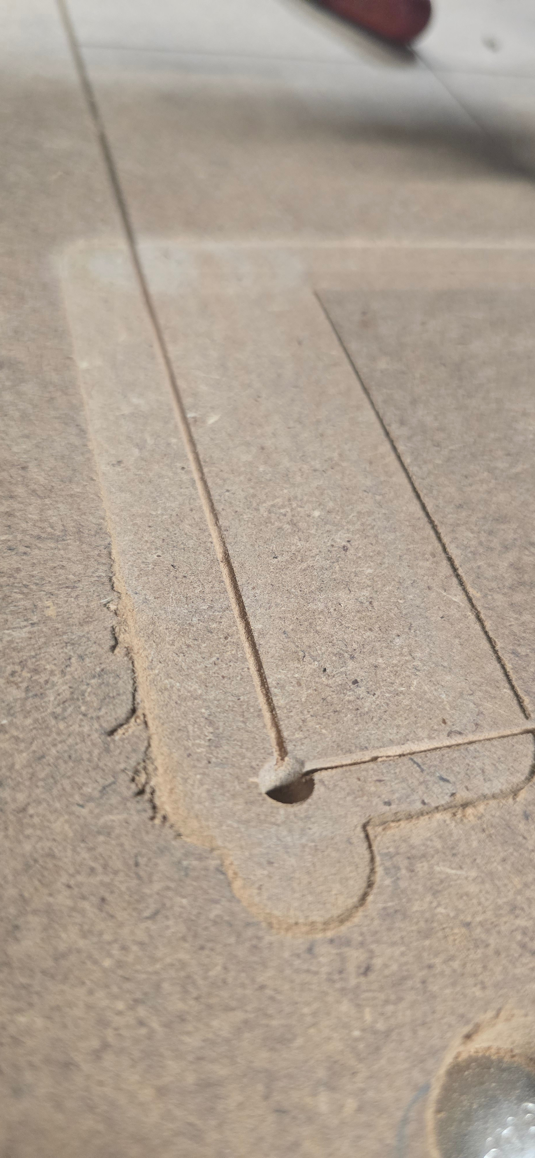

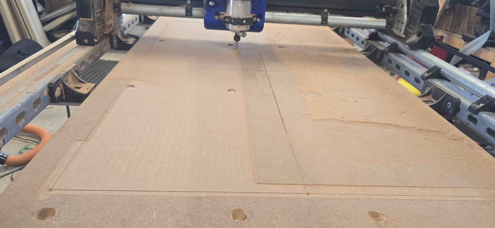

Not really sure why the surface gcode is offset on the Xmin but correct everywhere else, but it’s surfacing the spoilboard as i type.
got it all surfaced and the tram was close enough that even using ¾” bit at 1000mm/sec the vacuum after left deeper marks than the bit. I did run into some heat issues towards the end, but it was barely taking anything off on that side so I’m not to surprised it heated up.

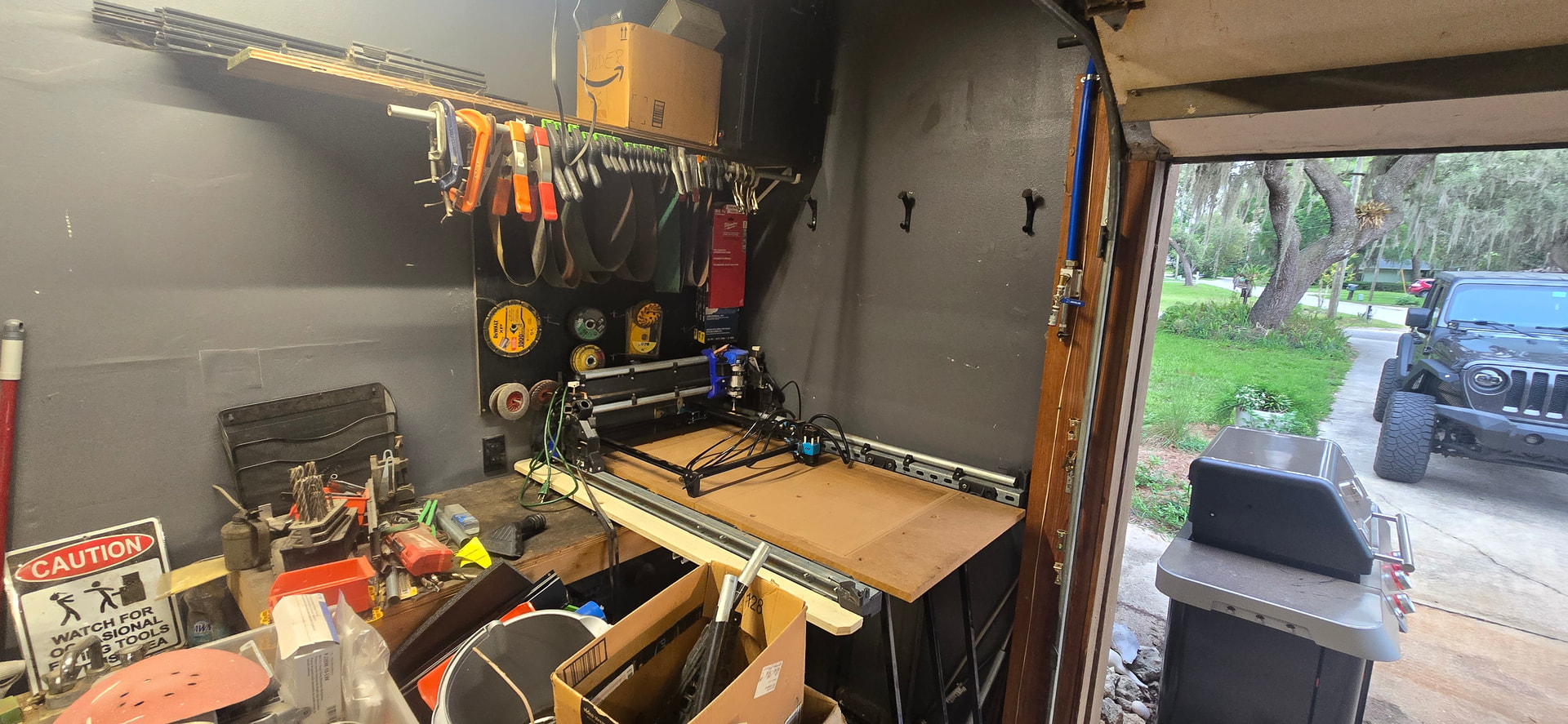

Then I got all the metal working tools out of the corner that I built around metal working…. Because now it’s the cnc and lasers home
Still have so much more to move out of that corner, but the machine fits beautifully! The laser will go just to the left of it and my little acer laptop that i wiped and through antiX on can go on a little pull out shelf as my machine code sender / control interface.
One thing I really like about how it sits in this corner is when I hit home, the machine comes to me. I’ll make a park macro to send it ti the back along the wall like it is in that photo. Once i get the crap out of the way, I’ll have access to the end and half of one side without any reaching. And because I’m not dealing with full sheet materials…. I can easily load and unload.
