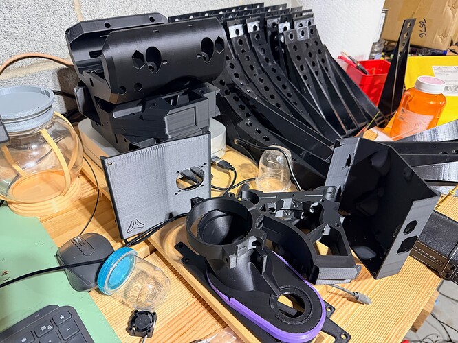

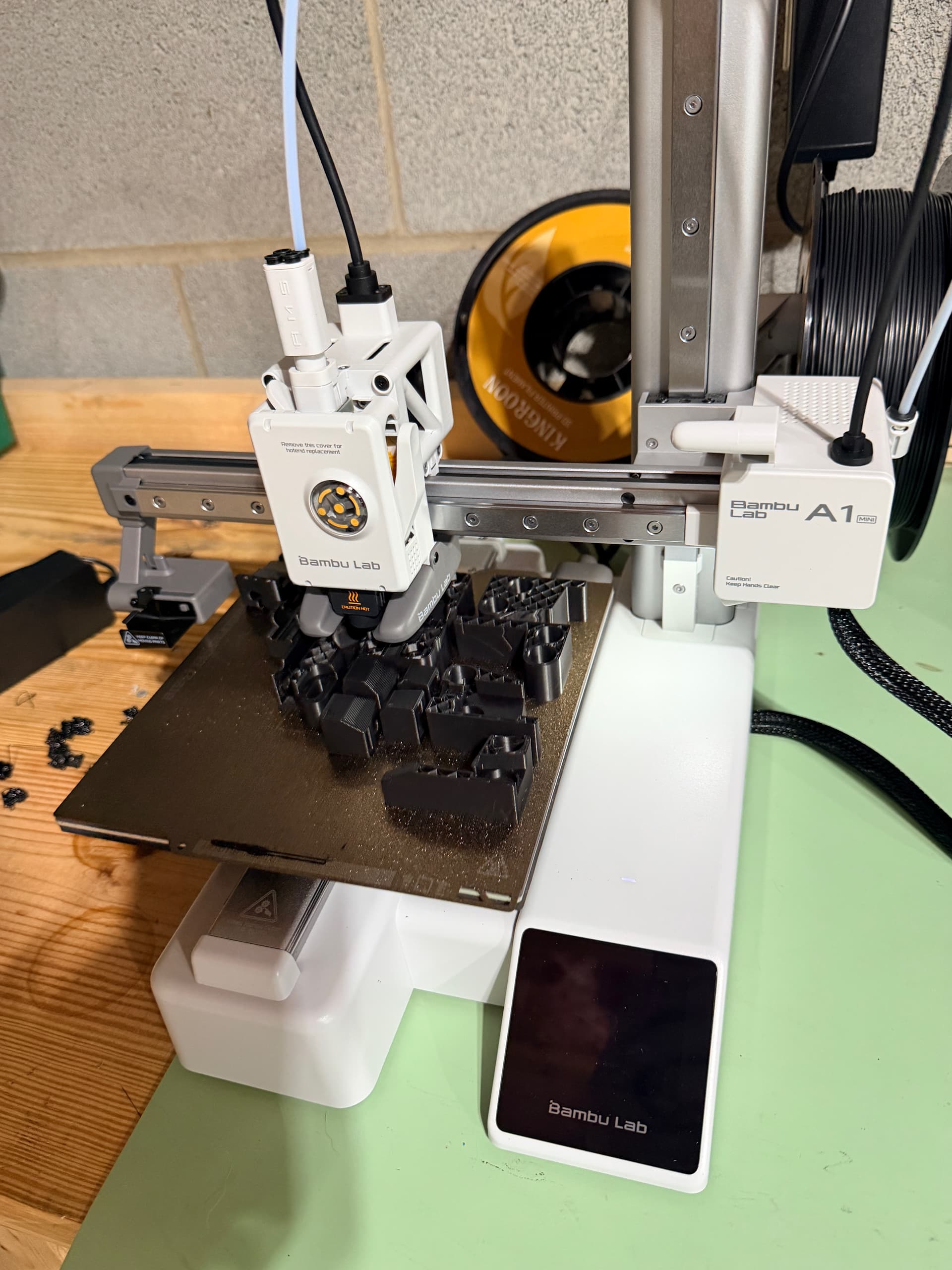

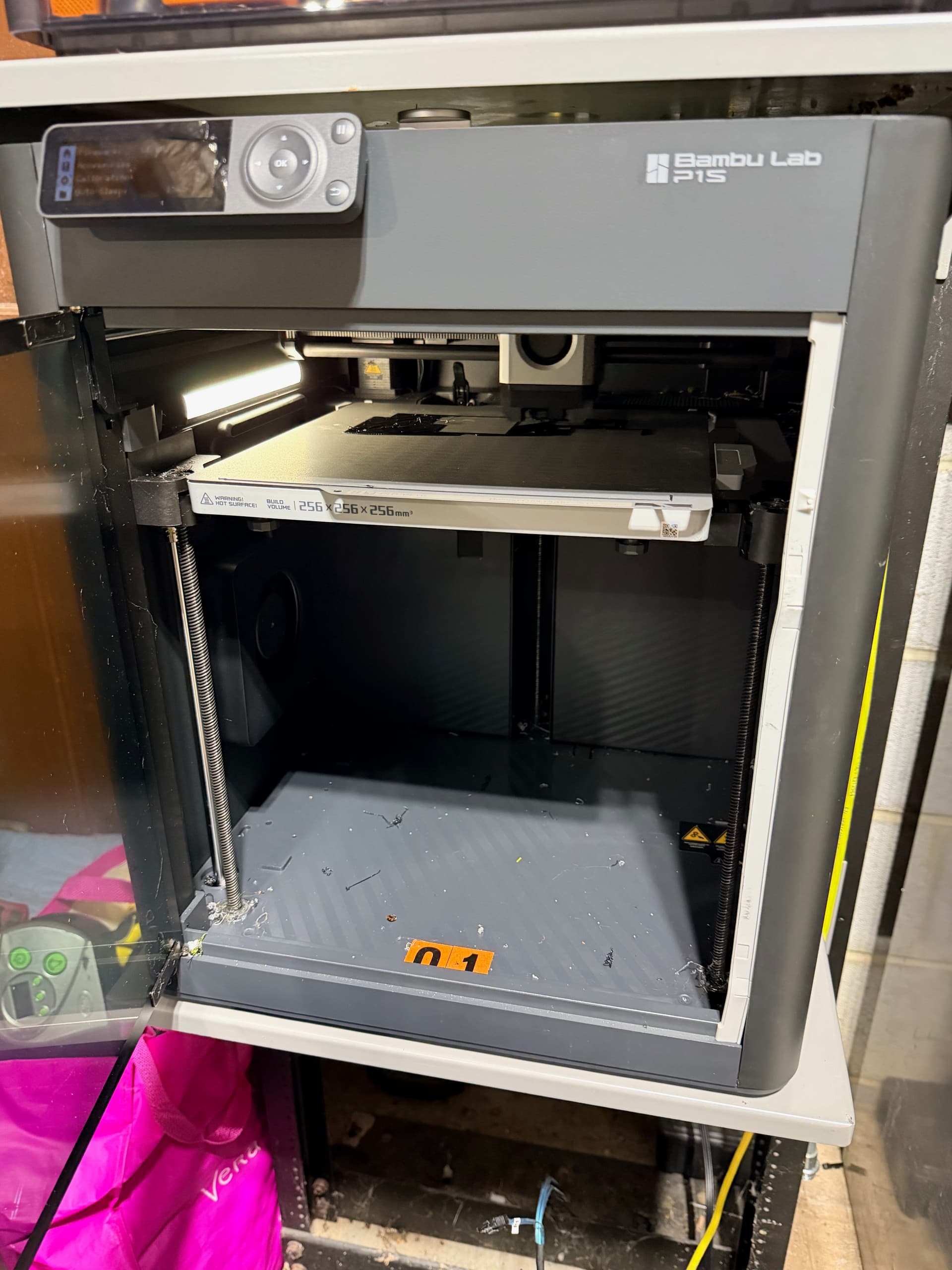

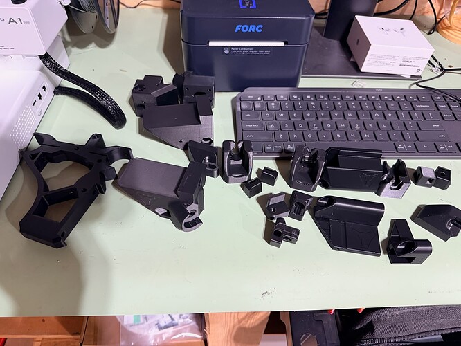

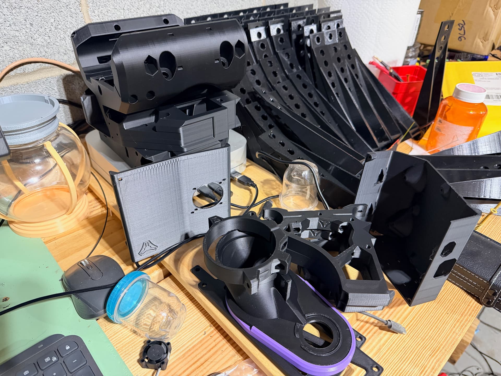

The Build So Far: 3D Printed Parts
The A1 mini and P1S have been working overtime on this V4 printed parts list and I’m happy to report good progress! Here’s where I’m at:
I’ll be updating this thread with more photos as the build progresses.

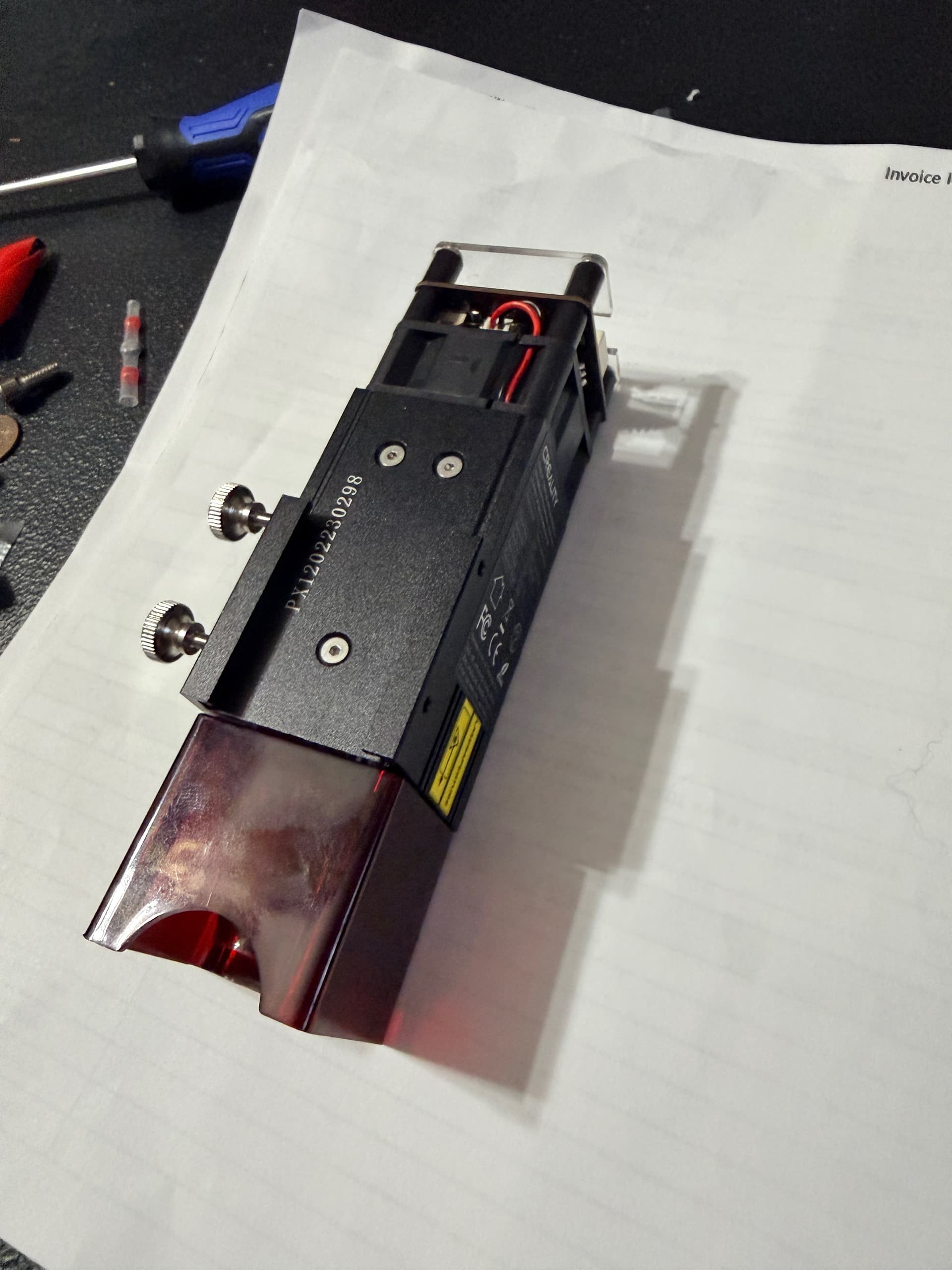

2. Creality 10W Diode Laser
I have a Creality 10W laser module that I’ll be mounting alongside the router for:
  • Cutting coroplast (polypropylene variety)
  • Cutting 3mm basswood and etching designs
The wiring is straightforward – it’s a simple 3-pin interface (PWM, GND, 24V VCC) that connects directly to the Jackpot3 outputs. I’ve already worked out the FluidNC YAML configuration to add laser support, which I’m happy to share once I have it tested and working.

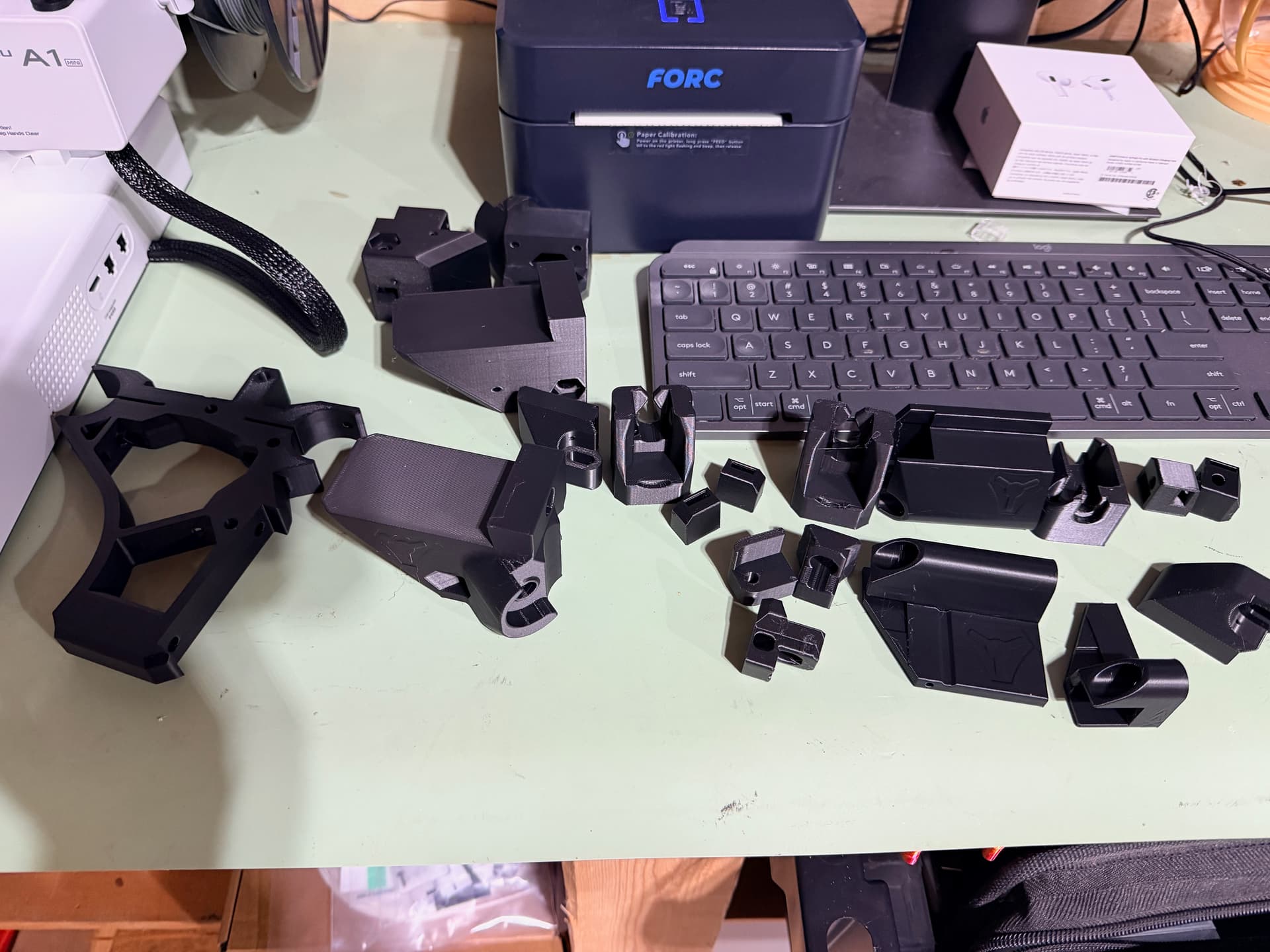

Quick Update
Making good progress on the printed parts!
3D Printing: Down to my last two prints - should be wrapped up this evening.

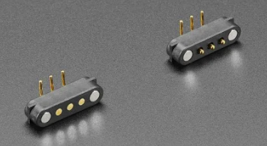

Personally I remove the laser when I’m not using it. I don’t know if it could be damaged by exposure to vibration but I don’t want to find out.
Hmm, definitely something to take into consideration. Maybe I could make the wiring a quick disconnect using some magnetic pogo pins.
I’m fortunate that my laser has a plug connection so it’s easy to change
Oh yeah, that is awesome! How many watts is that laser?
30W optical power.
Is that like optical inches? Is it a grower or a shower? :joy: :duck:
Diode Laser vendors like to play silly with over exaggerating their size so yes.
