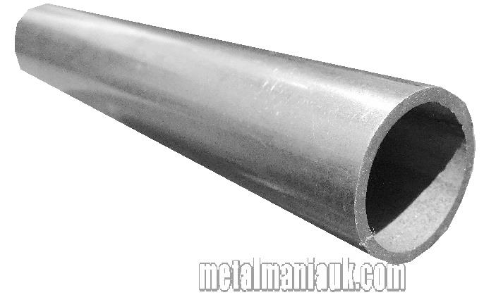

while I have your attention any suggestions where I can get galvanised tube from in the UK to suit the build or any suppliers of the alloy plates required in the UK I’m all ears.
Ahoy fellow UKer! Whereabouts in the UK are you based?
I used “FH Brundle” for my (mild steel) tube as I didn’t want to pay the oversize delivery fee on 30mm galvanized conduit. Very cheap and they cut it to length for me, too (so it was the right size rather than if I’d been at it :P)

I’ll have a look there for the bars too thankyou, I just found some 32mm galvanized bars for mounting TV aerials but in only 1.8m lengths I think they were £7 each and free delivery on £20+ orders. Shame there not longer

This is where I got the tube for mine quick delivery and cut to length if you want.
Cheers bud, looks a bit thicker than what I just found on Screwfix too…

I bought 32mm conduit (3.75m lengths) from Rexel at £18.11 per length. Metpro GC32 | 32mm Conduit Class 4 BSEN61386-1 3.75 Meter Length Galvanised Steel | Rexel UK

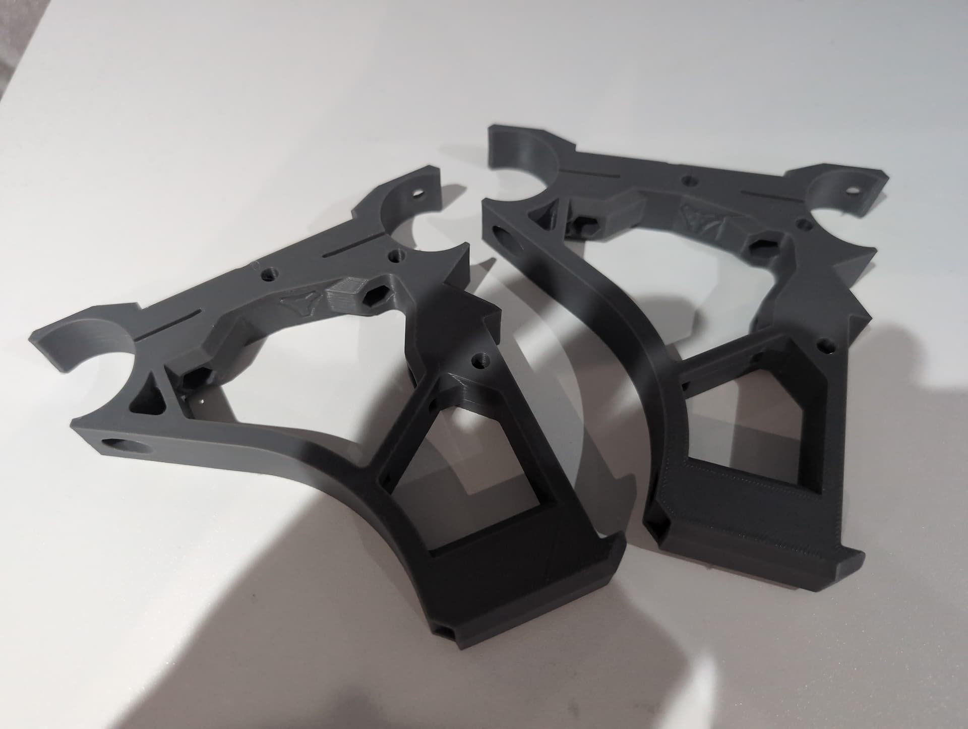

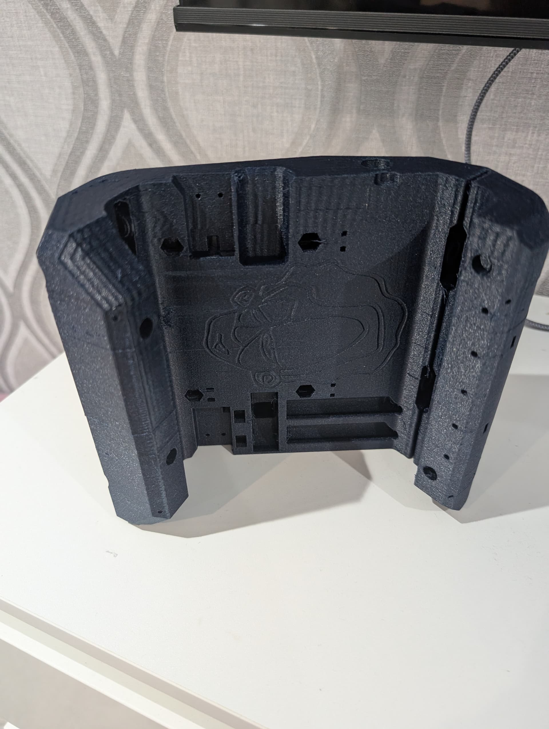

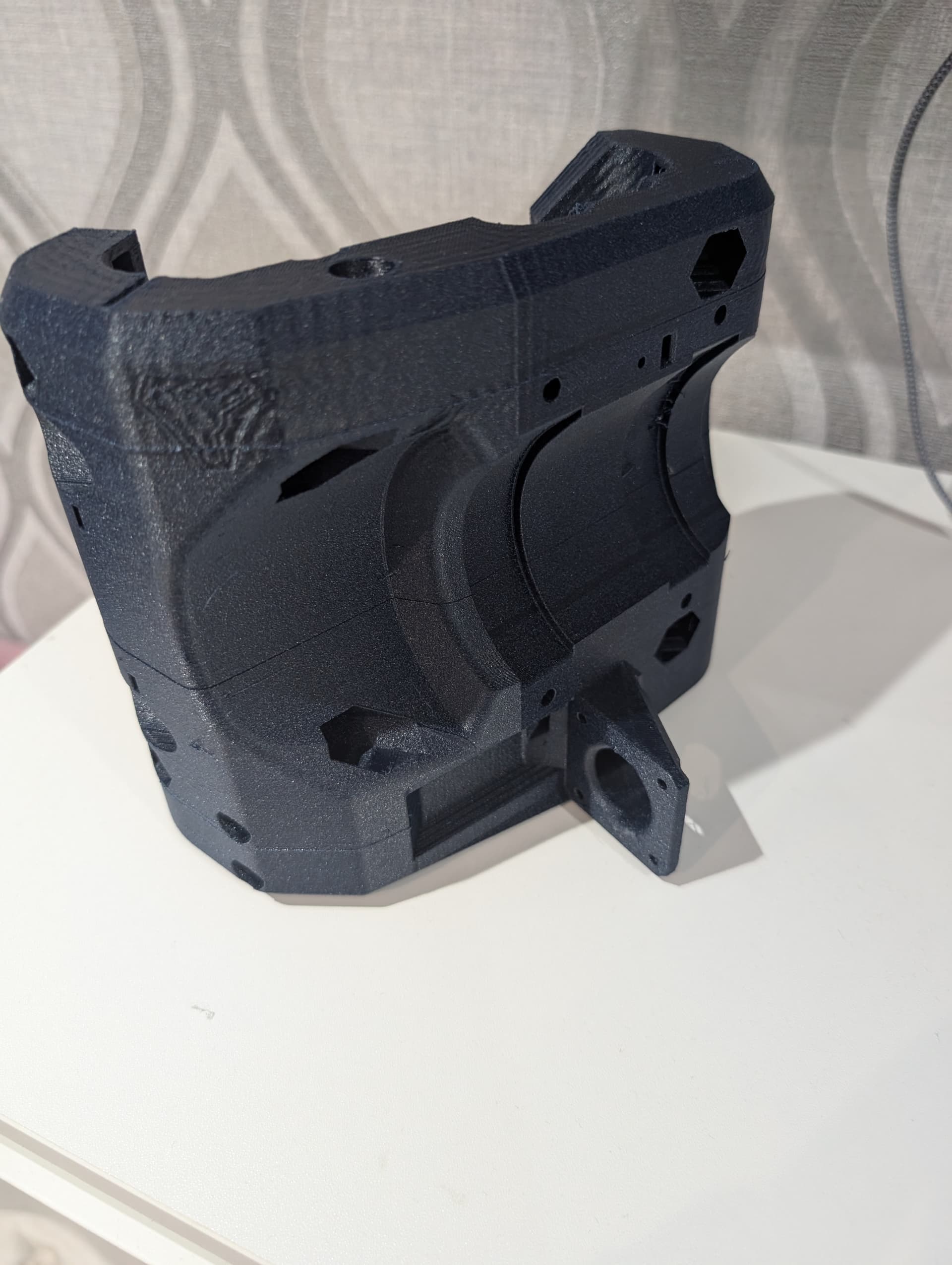

Well fresh off the printer part 1 of lots
And some more…

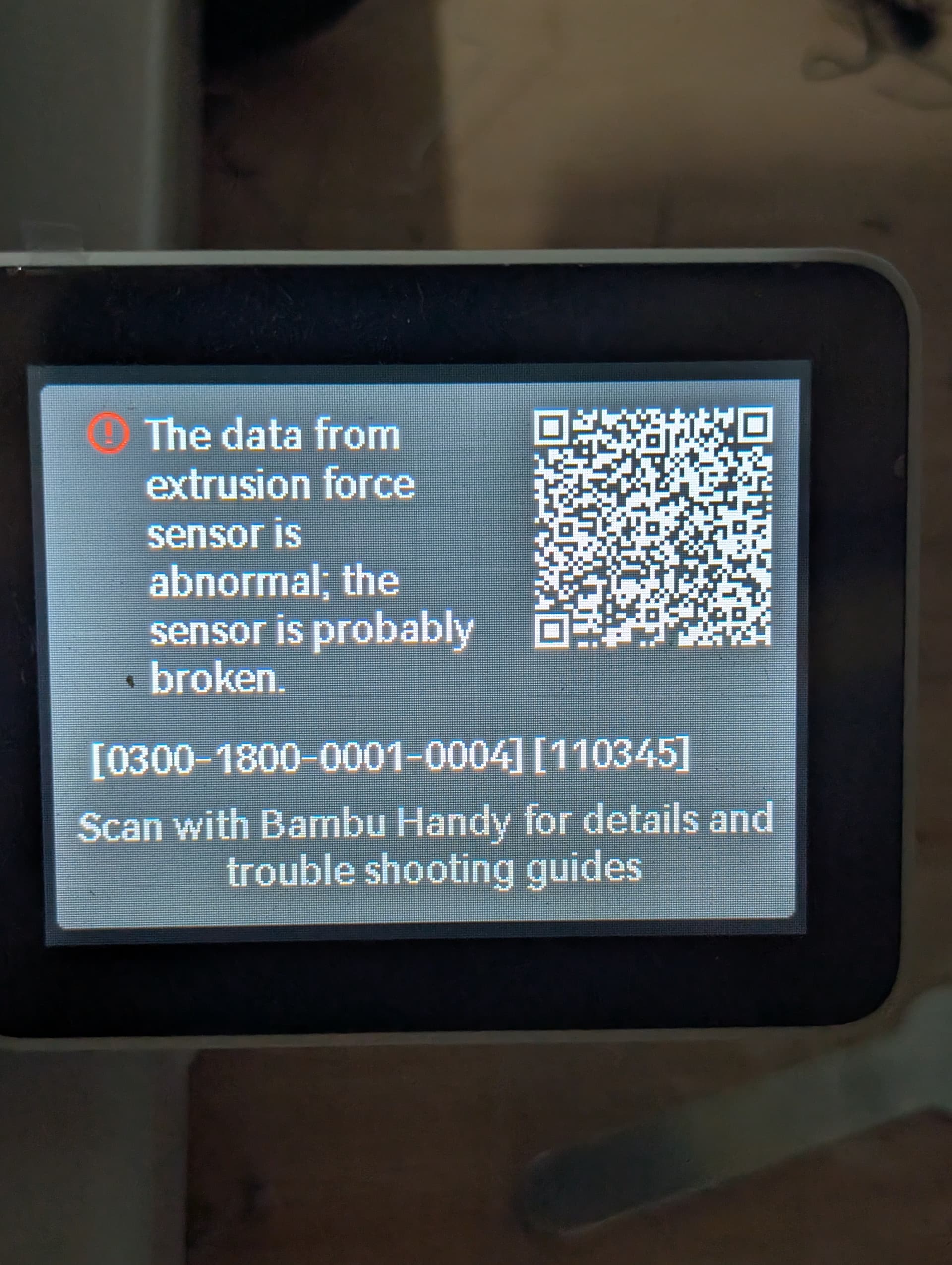

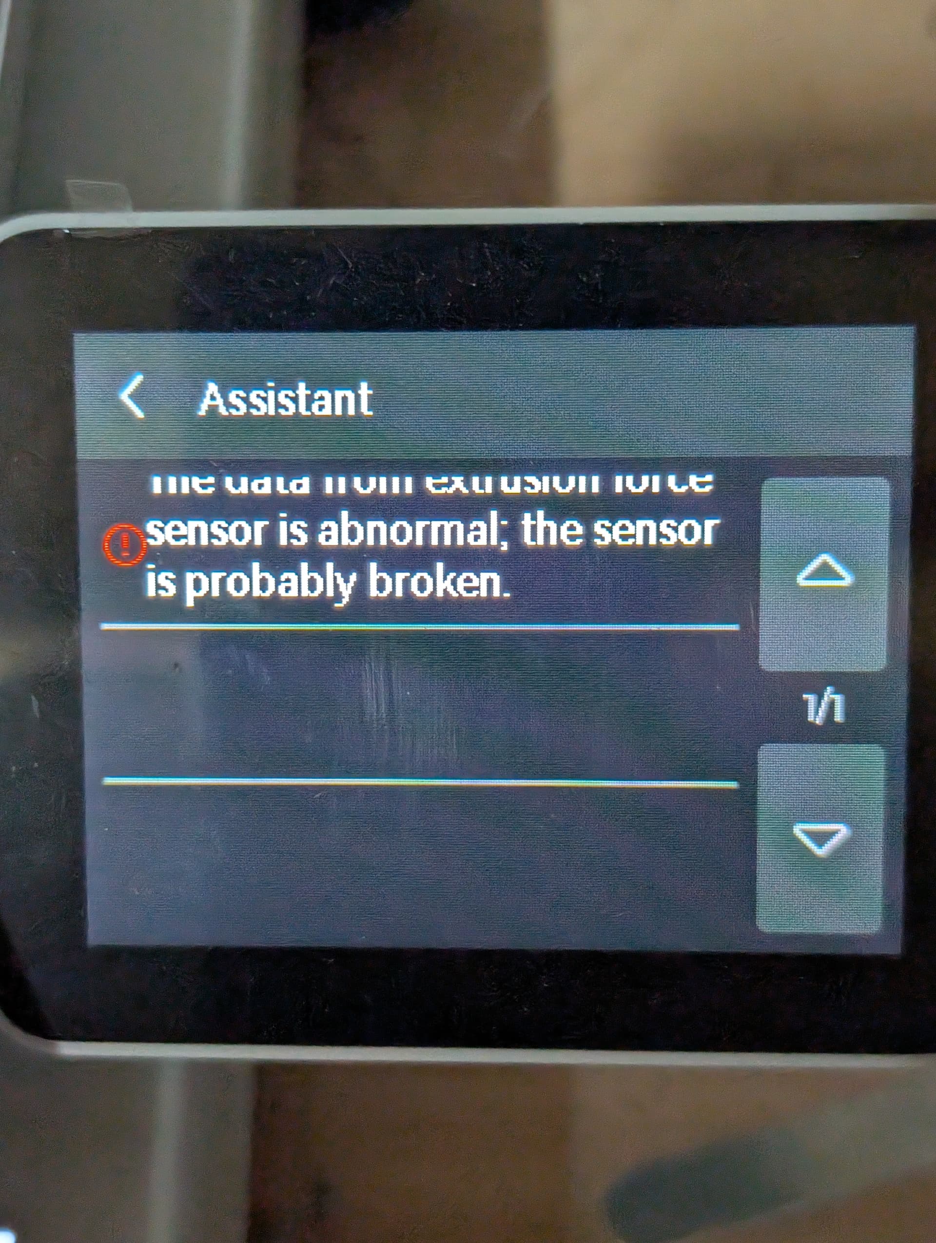

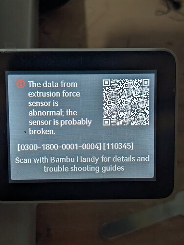

Well now my printer is broken until I can get some parts… Didn’t manage to print much, I’ll get the core built for now and a couple pipes to start the gantry
Just installed a complete new tool head with Eddie current sensor and we’re back in action!

did your tubes from Rexel work out OK? ie straight and adequately thick?
Thanks
Absolutely. I had previously used 25.4 mm conduit from Screwfix for my LR3. The tubes from Rexel are a lot heavier, and were delivered perfectly straight.

I bought a couple of 32mm stainless steel tubes from Screwfix 1800mm long, just need to see what size I need to cut them for a full size 4’ cutting size gantry

Hi Dave! The Screwfix tubes are a good shout and seem very affordable at 14 for 2m. How thick are they? Can’t find it on their website. Do they come straight enough? Being meant for handrails I’d hope they are thick and straight enough for the use
£12.99 for 1830mm lengths I think I paid just measuring them at about 0.8mm tube wall thickness 31.7mm od 30mm id
0.8 seems mighty thin, tbh.
