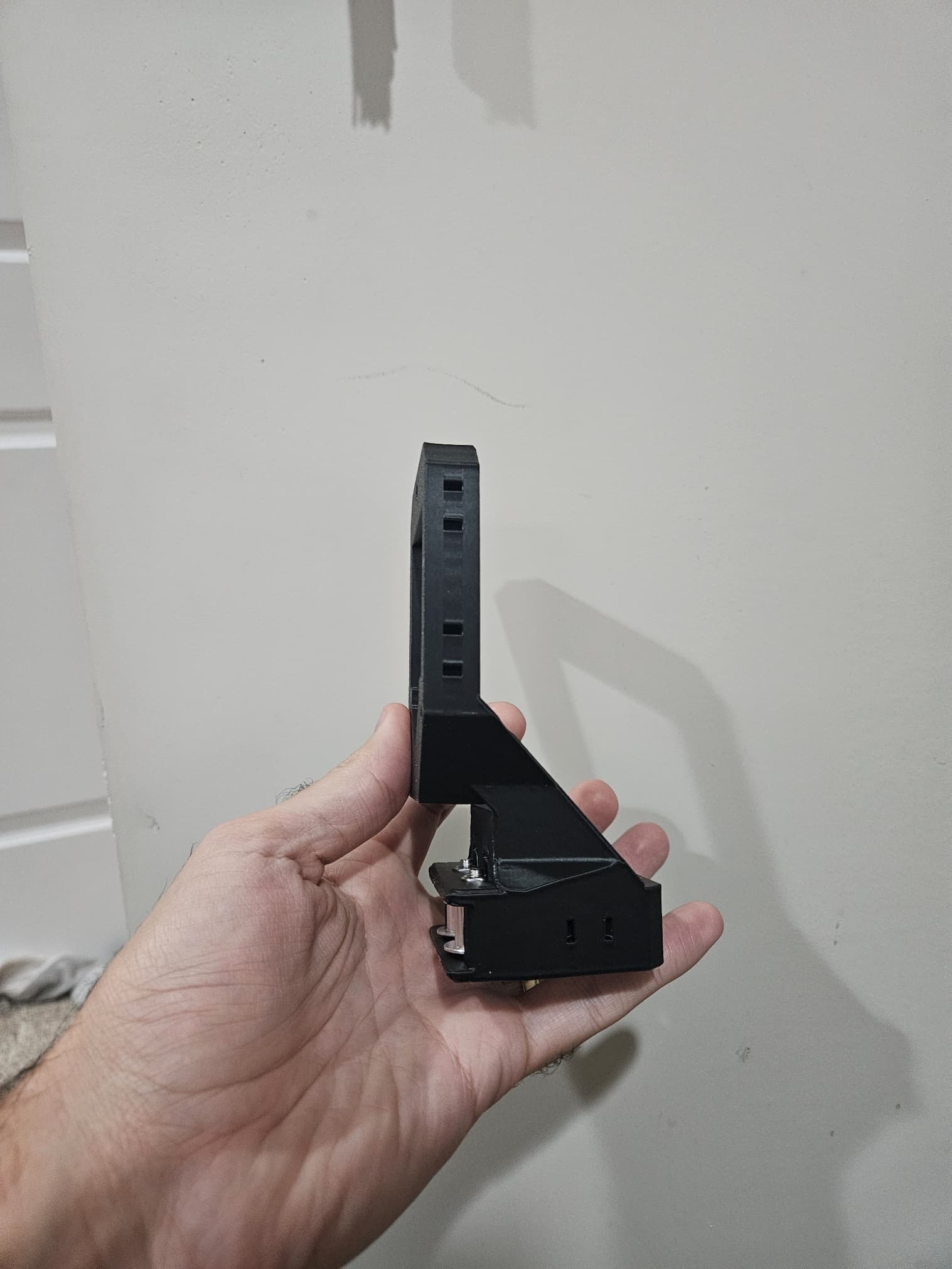

Oh so I already did the remix of your V2 to compensate for the extra lip. I even printed one already and it’s quite sturdy. I’m kinda looking for a sanity check to make sure nothing wasn’t missed in thinking this would work when designing my table. Hate to have to make a table twice haha.

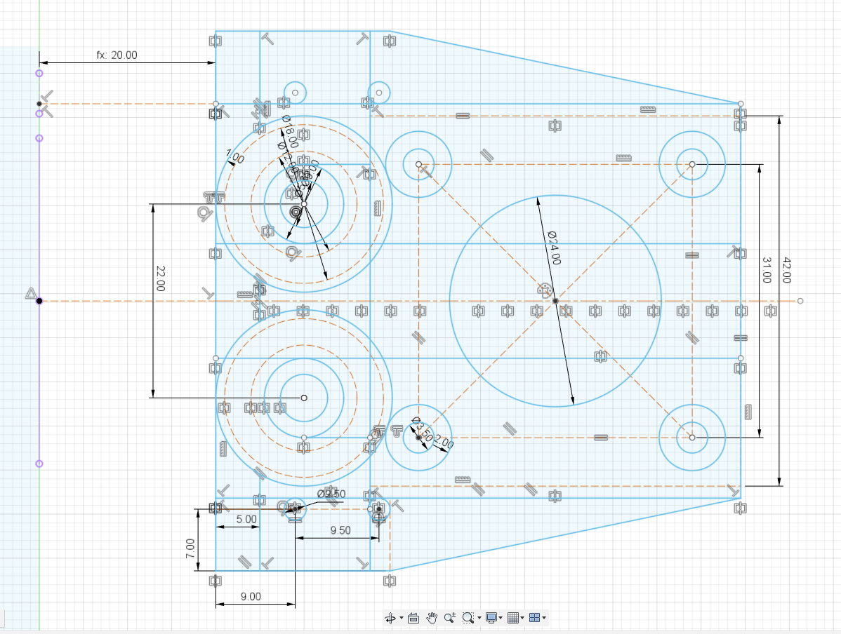

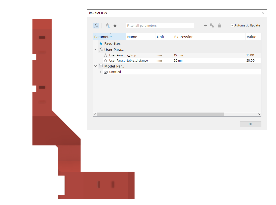

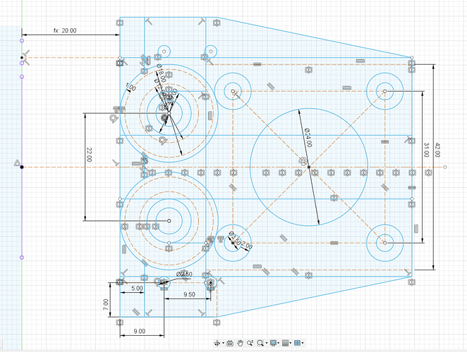

On mine, the 10mm rip will hit the motor mount, but I have my LR3 set well clear off the edge of the table, with careful positioning, the shim can pass between the table and motor mount
If need be, there’s a user parameter on the f3d file to easily adjust the distance between the side of the plate and the motor mount (also you can adjust the height)
20mm:

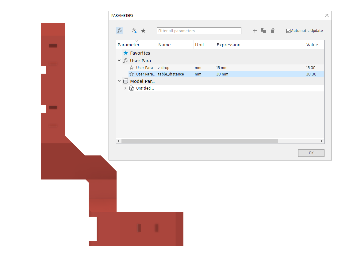

30mm:
But just to be fair, I never caught anything inside the side belt, as, if it’s properly tightened, it will sit pretty much flush against the side of the table

I like those ribs you added on the sides of the motor, great idea for stiffness
I thought it should help depending how much tension is on the belt so that it doesn’t flex inward at the bottom. My test print was in ABS so it’s going to flex more than PLA but still thought it would make sense.

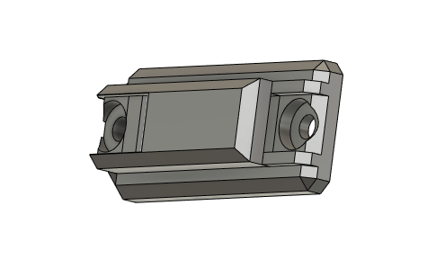

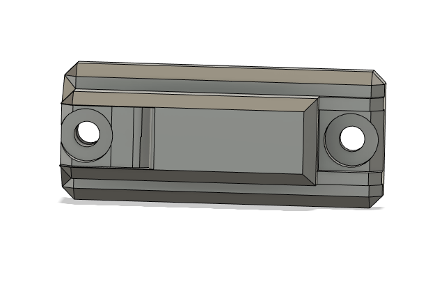

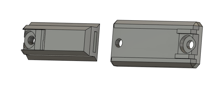

Thinking of something like this? My thought is keep it as close to the board that runs down the side (belt should be within 6mm of the sideboard), keep it sturdy (fasten the back plate on, then fasten the slide through the base plate so it doesn’t lift like the original design), it’s super low profile (13.4mm total height), but and it’s footprint is really small so that you can keep it tight towards the top and don’t need to lower the Y motor and pulley down too low.
Just a quick mock, let me know your thoughts.
Remember that you need at least one end stop on one end and it might not hurt to have an end stop on both ends (one each side).
One of them (one each side) would be used for homing purposes, and the other one might be just an emergency or fail-safe to keep you from accidentally driving the LowRider off the end of the table.
If you can work it out so that end stop is adjustable so that can be slid backward and forward and tightened into position with a couple of small screws and nuts, it can help you with being able to physically adjust your table for square.

I think the belt will cover the front hole which may cause an headache when installing :slight_smile:
You also need a way to adjust tension while installed
Concerning endstops, I’m currently trying to de-couple them from the tensioning block so that the machine won’t fall out of alignement when you tighten the belts
