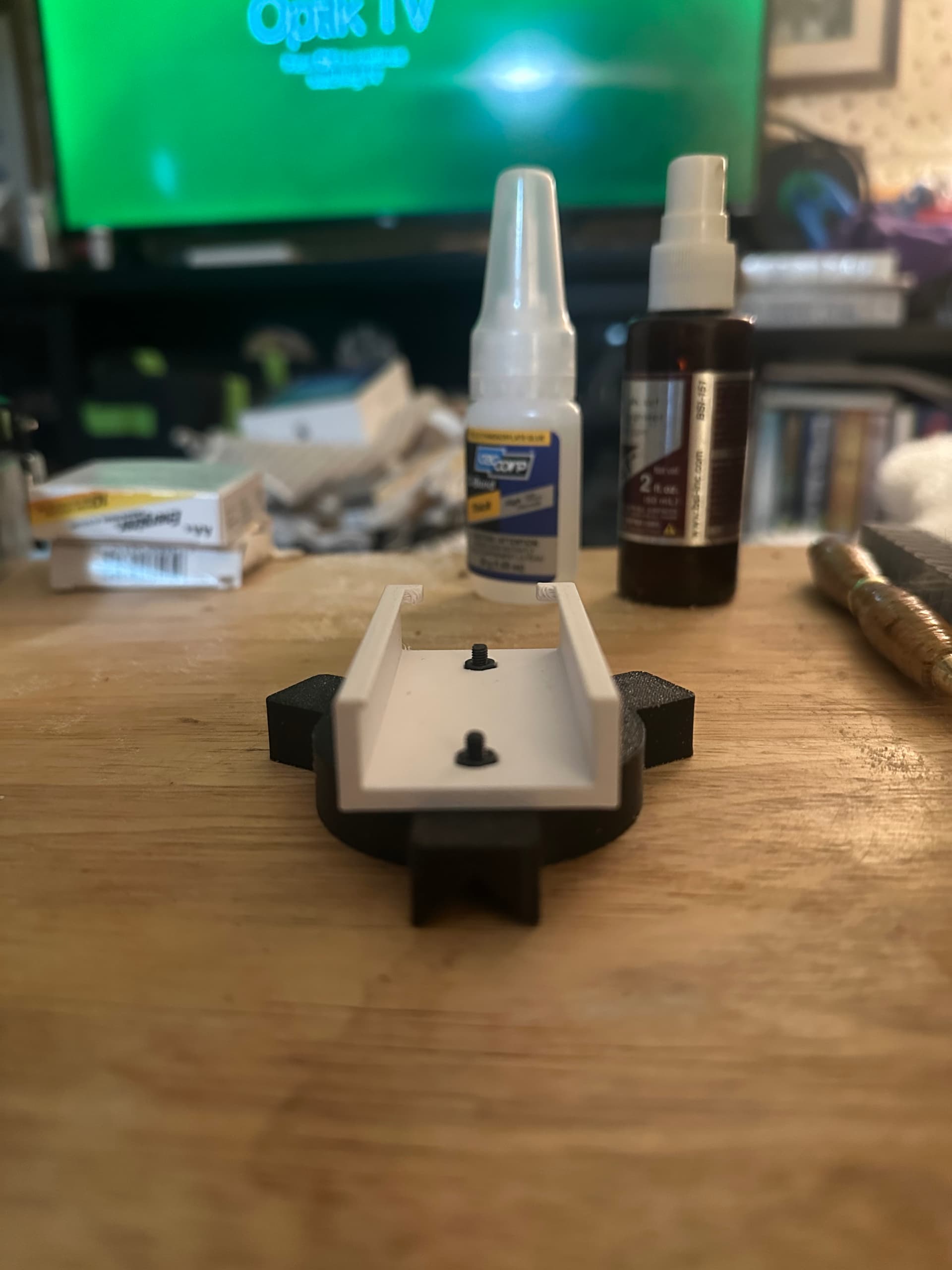

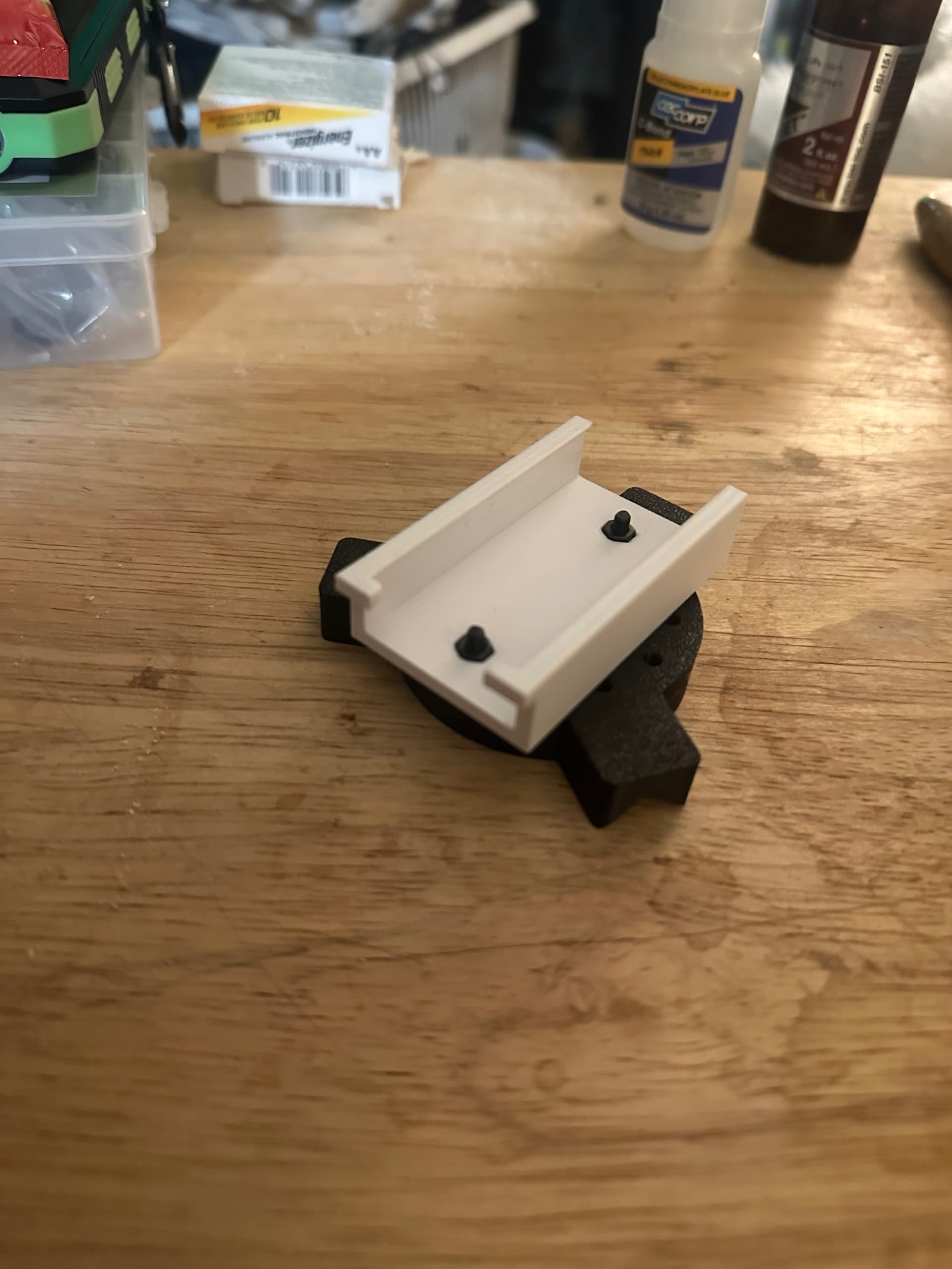

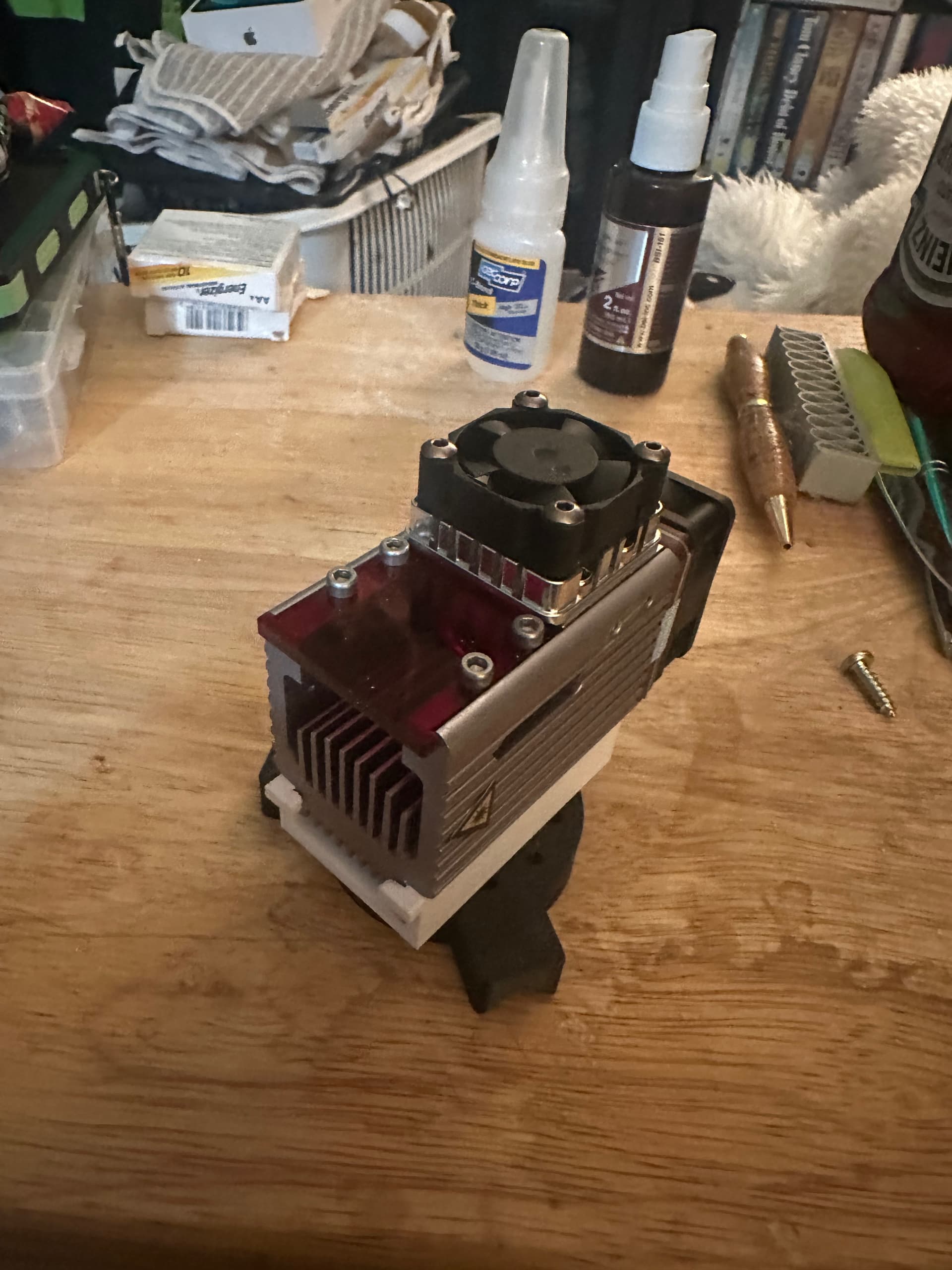

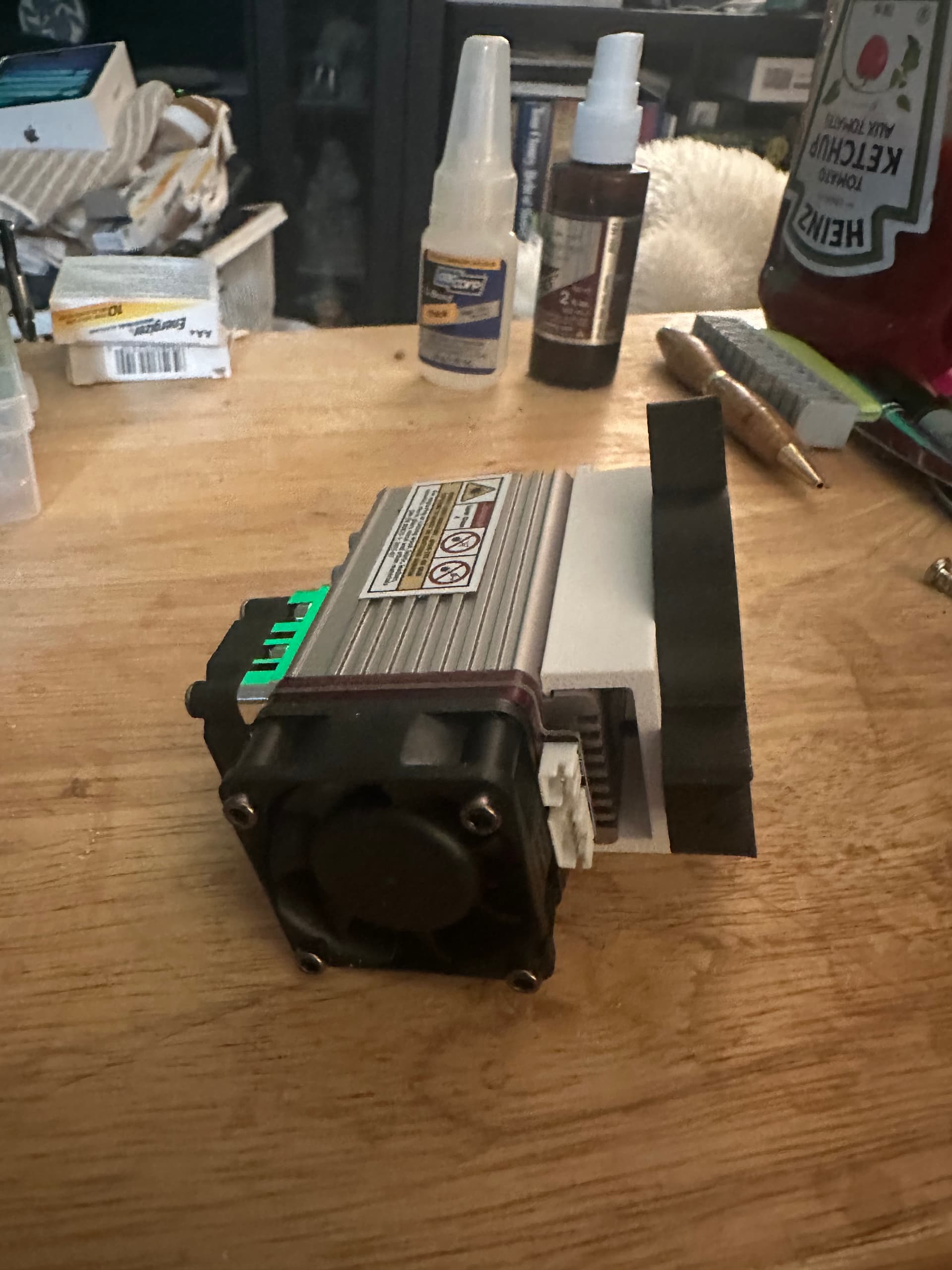

I’ve gone through the thread and I couldn’t/didn’t spot a build for the new A40640 II laser. I printed the mount assuming the original is the same, no screw holes line up. I tried searching printables and came up with nothing that’s already been created. Has anyone made a A40640 II LR3 Kinematic mount?
If you search for that model name on printables and find something that is tailored for it, you can do a remix to make one. Also, perhaps there’s a diagram from the seller/manufacturer that tells screw hole schematic that could help in making a remix that fits it.
I have finally designed a mount for the NEJE A40640ii laser. I got hung up on using screws to mount the laser module. Finally, when I started designing, I realized there’s slots that the module can use.
Simple design, the laser module slides into the mount and doesn’t require screws.
NICE! Did you share that? If you would be willing to, printables is a nice place to share.
