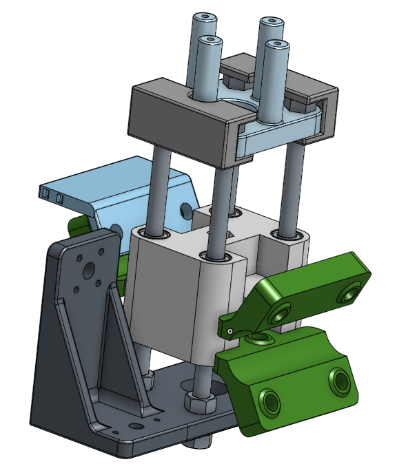

For completeness sake… when I last left off with FoamRipper, I was starting to wander off into an area I have less interest in, and practically no use for, given that I’m no longer really cutting, building, decorating, and flying planes. So, I weenied out again, and chose to concentrate on the machine itself… specifically, the FoamRipper’s carriage, Z-axis, and needle-cutter.
[attachment file=97813]
If interested, the development of this carriage and cutter is detailed in two RC forum threads… refer to either of these for more information regarding the carriage and needle cutter construction and design.
https://forum.flitetest.com/index.php?threads/cutting-foam-sheets-with-a-needle.24251/page-122#post-465429

A more “normal” job for the FoamRipper and needle cutter is cutting plane parts…
The carriage, Z-axis, and needle cutter are now up on Thingiverse
https://www.thingiverse.com/thing:3582124
So I think this brings FoamRipper to a reasonably complete state and I’ll let it be. Thanks to all who’ve shown interest and suffered through!
