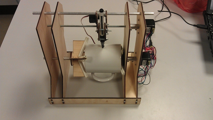

How about something like this for working with mugs?

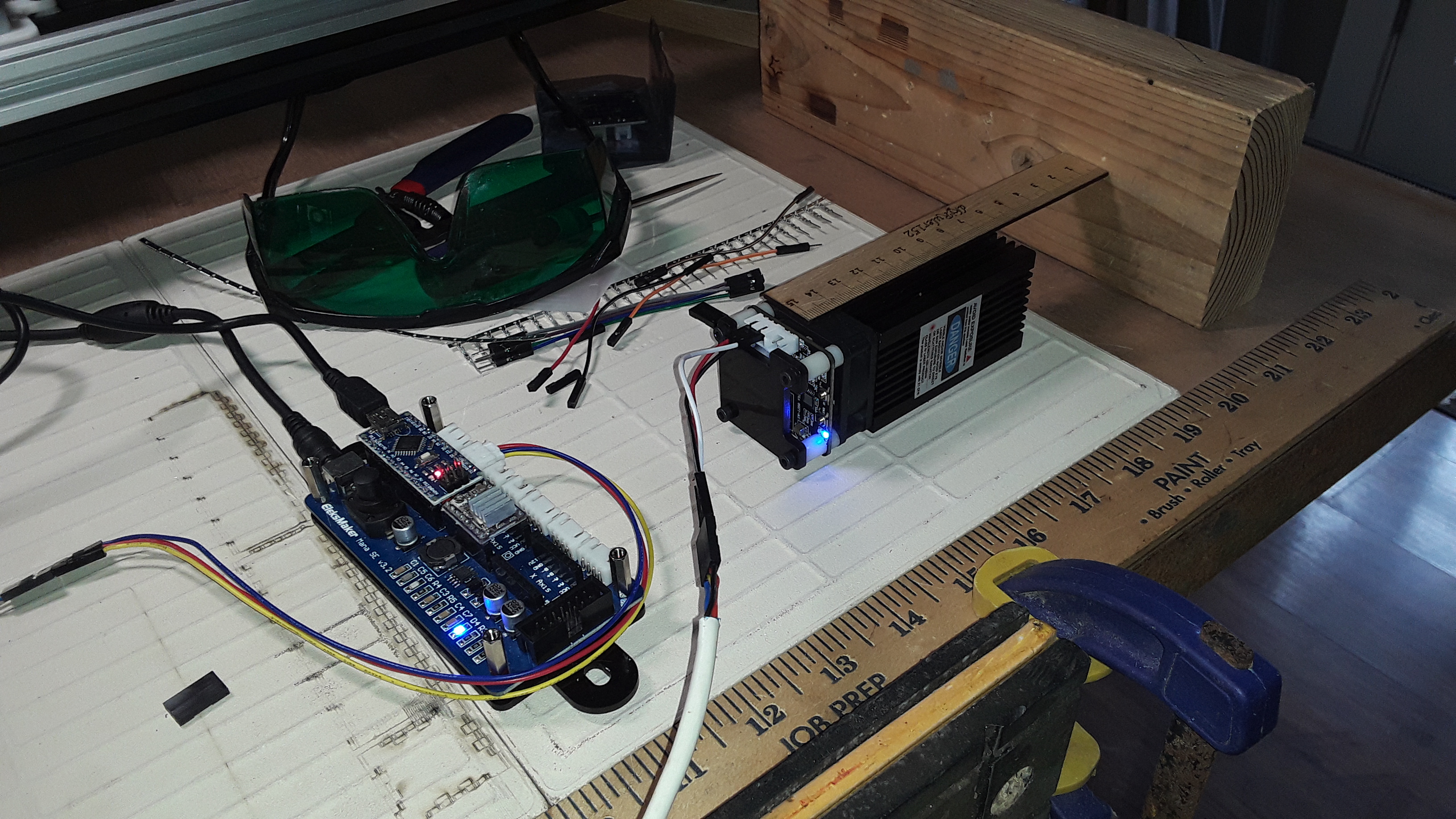

Okay… today was laser day.
Remember the “20W” laser I “zapped” with static a while ago? I ordered a new controller off Ebay that looked as though it should work.

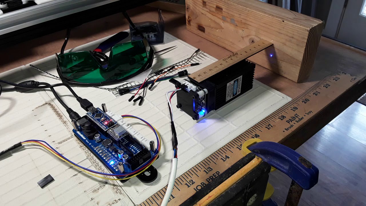

I set up the “zapped” laser module for retest… to confirm what I was seeing before setting it aside.
Sure enough it was acting the same way… Grbl gcodes M3S0, M3S10, M3S100, M3S500, M3S1000, M3S0 seems to be working… but the laser output was pitifully weak. So I removed the old laser controller board and installed the new. Fully expecting to see the laser at full power again… I was disappointed the see that the new one acted exactly as the old one did. So, now I know the laser diode itself is what suffered the static damage. Oh, well.

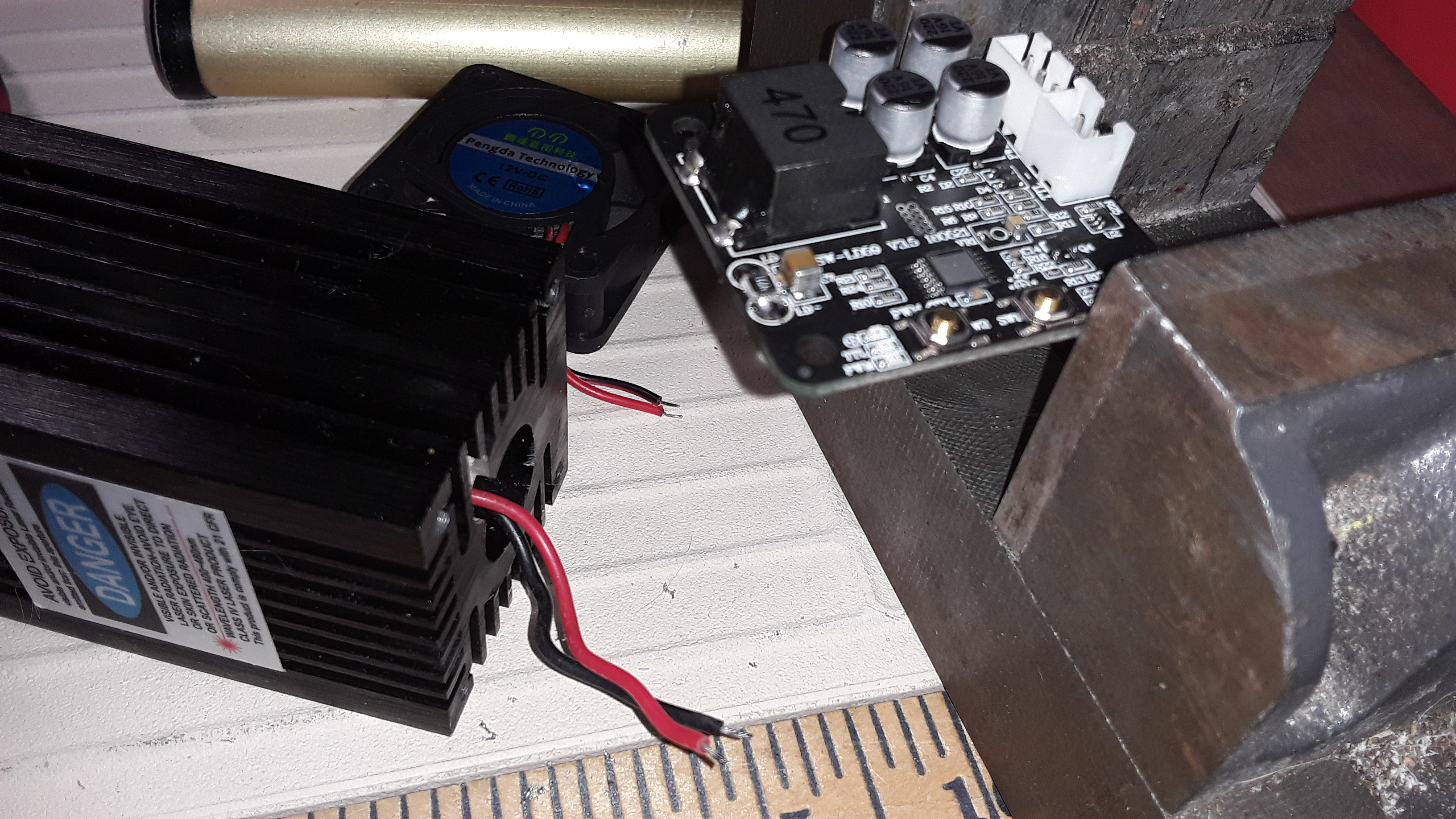

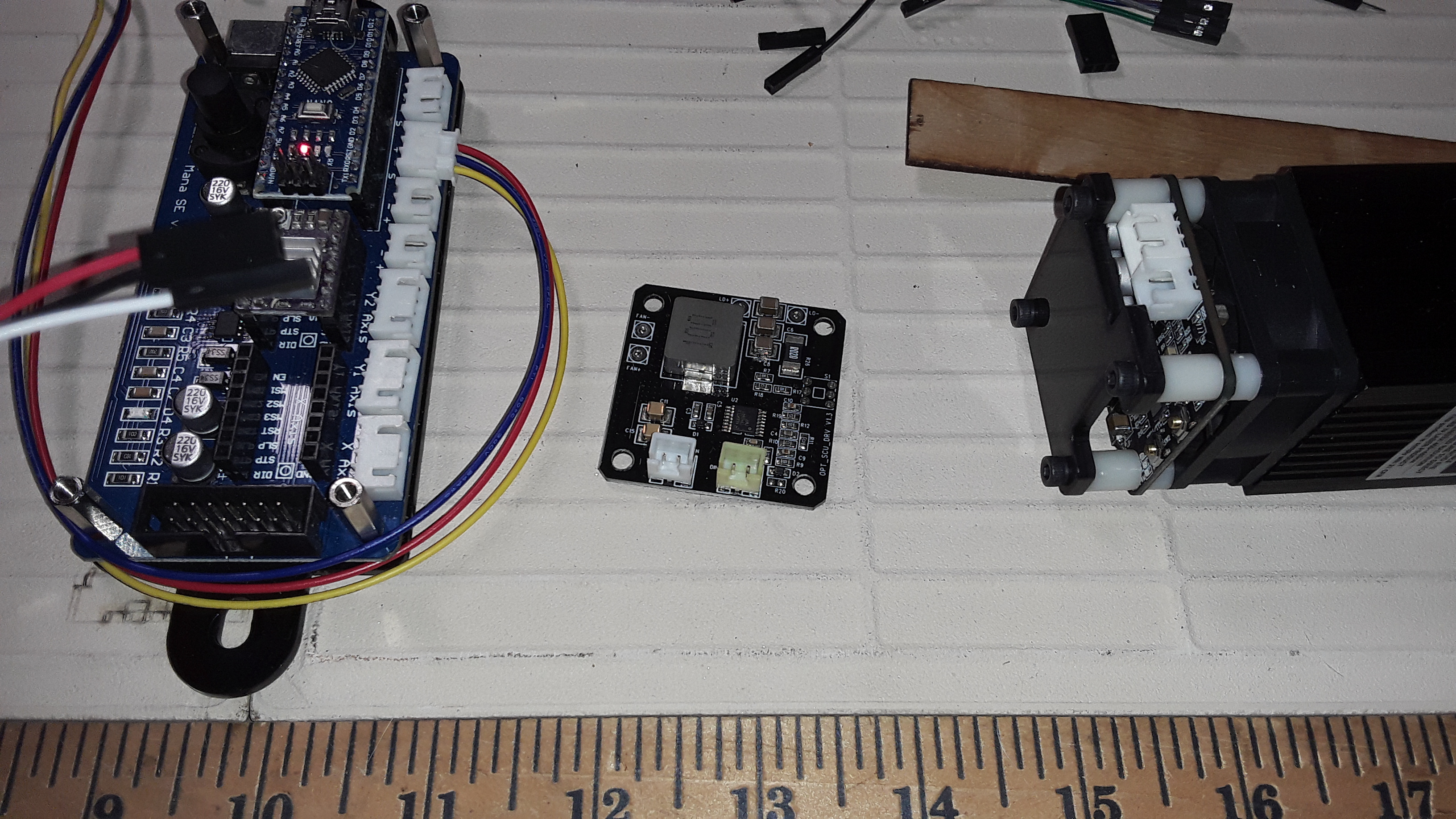

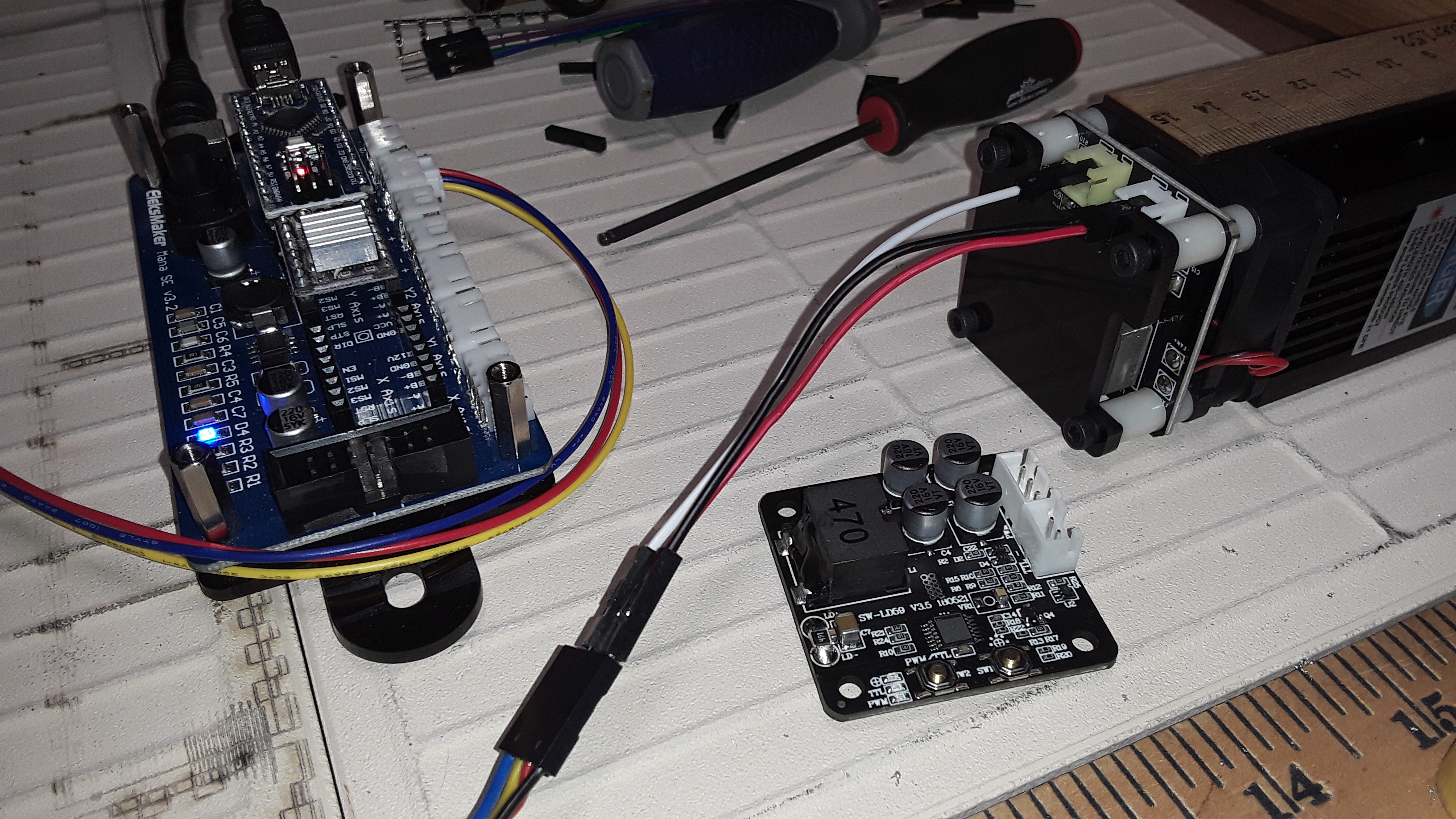

Here are a few photos of the board replacement. The test set up with just the laser power and PWM outputs hooked up (not seen is the Pi 3B+ and CNC.js I’m using to control things)…
The replacement laser controller board in the middle…
Old controller and fan disconnected from board…
The old controller board (bottom) and new (top)…
The new controller board has been installed and powered up…
As noted, the new board acted exactly as the old one… it recognized gcodes, but the output was pitifully weak. So, one mystery “solved” (that is, I know what’s wrong with it)… and on to the next.

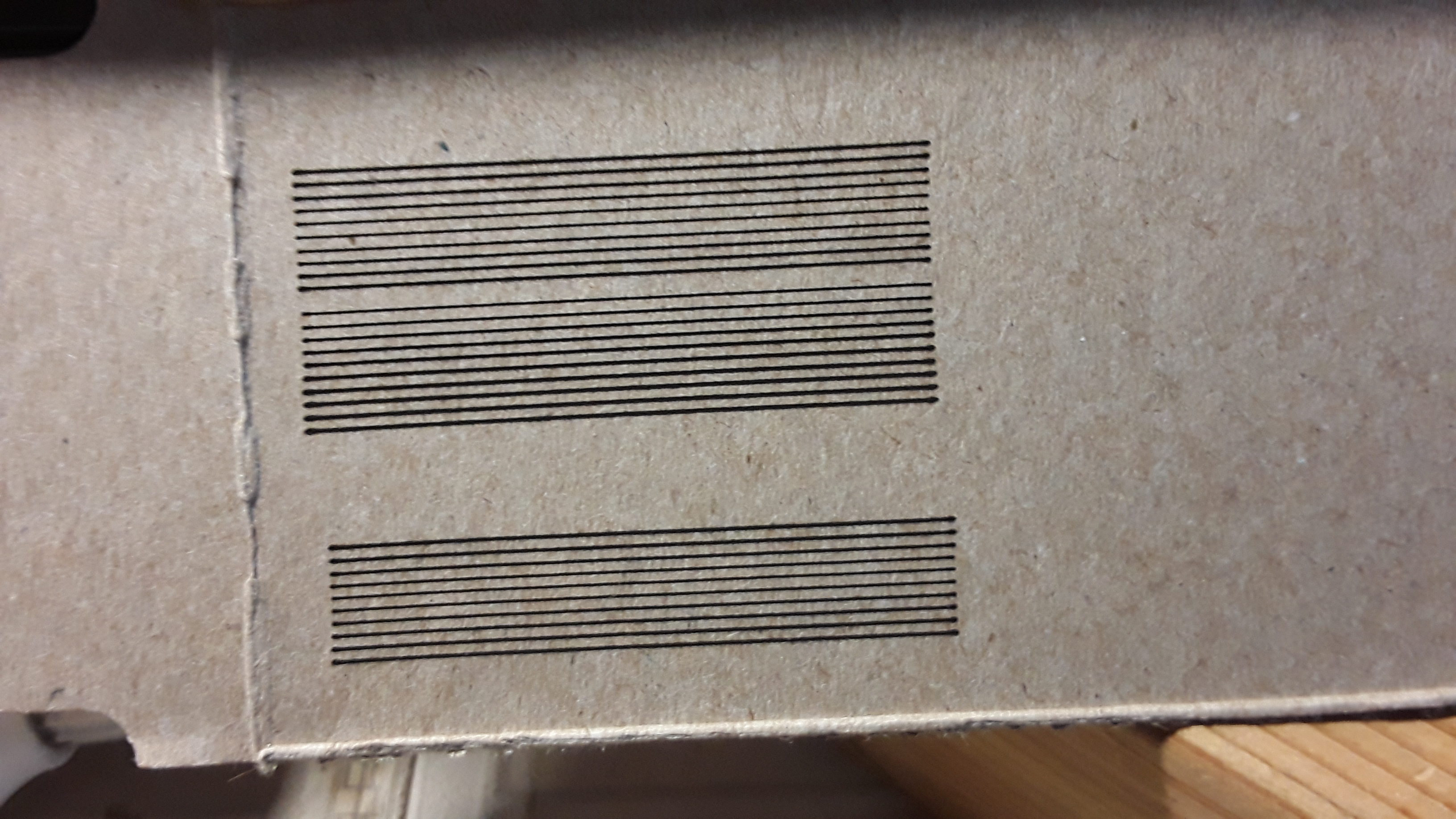

As far as focus is concerned, I do have other lasers to compare and the Neje just doesn’t seem to have the finer focus of my Eleksmaker. I use Ryan’s focus test routinely… and the line “gradient” (adjacent lines are 2mm apart in Z) used to determine best focus just doesn’t seem as distinct. Neje here…
and Eleksmaker…

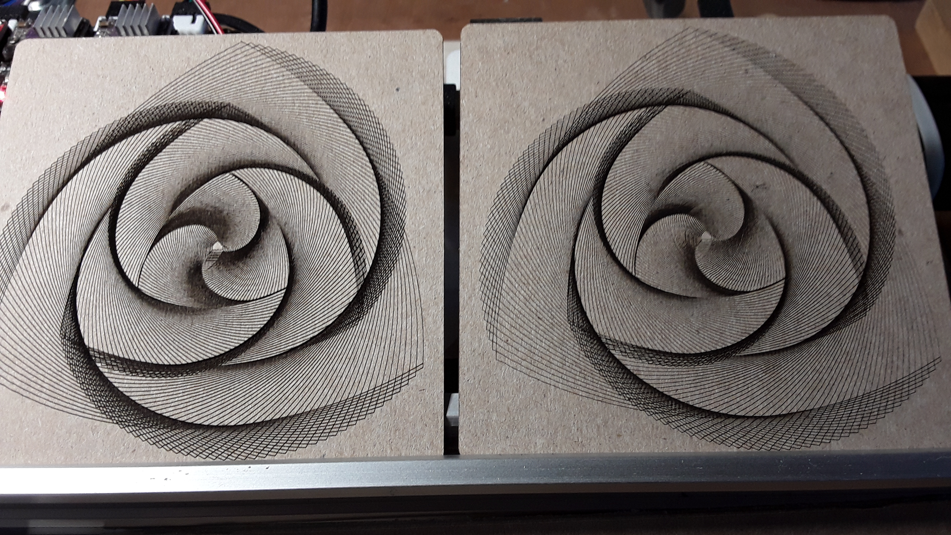

And the exact same gcode file for Jeff’s Mines pattern was plotted… Neje (left) and Eleksmaker (right).
The Neje plot just seems heavier and darker in shaded areas and general line work… compared to the Eleksmaker. That is, of course, according to my old, tired eyes :wink:
– David
