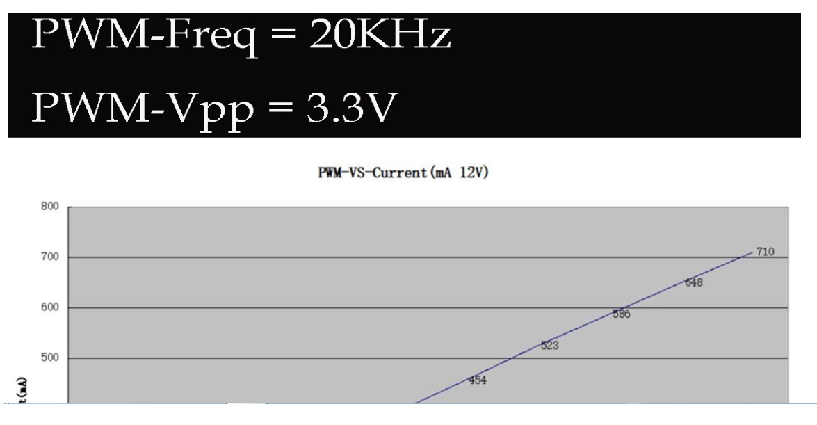

As usual, NEJE is a Chinese company that releases specs for their products that are, at best, confusing, and at worst, wrong.
Clearly states PWM: 50kHz-20kHz / 3v3 - 12v
Although I am not impressed with the 50kHz - 20kHz figures…it makes me thing they have got that wrong and maybe it should be 5kHz - 20kHz, but the 3v3 - 12v would indicate to me that a 12v PWM signal will be OK…but again, I don’t trust it, don’t forget the laser is running off a 12v supply and the Chinese love to ‘lose things in the translation’. (to put it politely.)
In the details page they print this -
clearly showing the output power reaching it’s theoretical maximum with a 20kHz 3v3 PWM signal and a 12V supply.
At the end of the day it’s your laser and you can feed it with whatever you like!
Sorry Dave but I disagree with you about the Vavg… the input to the laser will be some form of FET and it is only interested in the time its gate voltage passes it’s gate/source voltage, not the level of that voltage…it does not behave like a transistor, it behaves more like a switch, switching on when the gate voltage is above Vgs and off when the voltage drops to zero so it follows the duty cycle switching the laser diode on and off at whatever the PWM frequency is. some FET’s have a very low tolerance to it’s gate voltage, certainly less than 12 V, much closer to maybe 4V, and some FETS will tolerate a higher gate voltage and unless you know the specs for the actual FET used you are risking blowing it if you feed it with too higher voltage.
Your Vavg is certainly measurable and has significance in an analogue circuit…but not in this application.

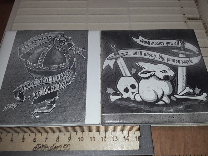

Have you ever tried laser etching photos on eggs?
No, I haven’t. I’ve threatened, over the years, to build an Eggbot and a rotary axis but, always resisted… telling that part of me to “go away… I don’t like being bullied.” :crazy_face:
I’m more likely to entertain that now, living in proximity to some of my grandkids. I’ve also confirmed that the white tile etching method also works on plain glass… so am positive you could etch mugs, glasses, etc…
It works on plain glass as well?? I’m sold! Can we see up against the light?
I’m curious, when glass (or tile) is lasered, does it affect the surface texture or is the image below the surface?
Not exactly sure what you’re after but maybe this helps…
It leaves a hard, slightly raised, texture on the glass… where the paint/glass are hit with the laser
This is all done with a simple little 2.5W diode laser. The glass is first coated with a light coat of flat white spray paint, allowed to dry, the image is lasered, and the paint remove with thinner or acetone.
