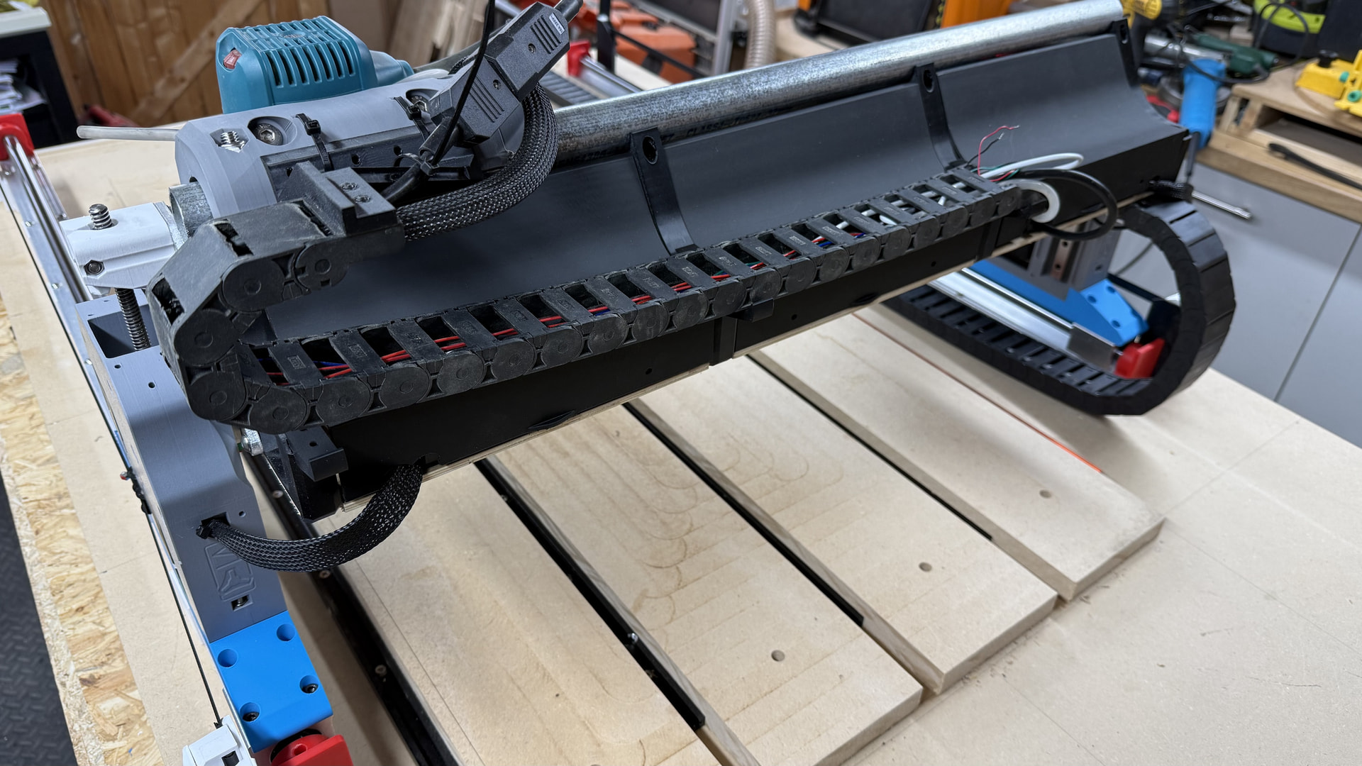

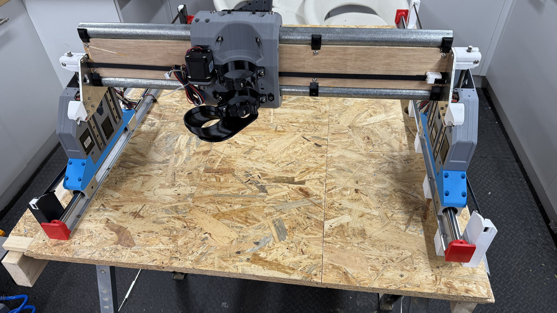

Over the past 4 years I have gone through a steep learning curve with regard to CNC machining. I started with Ryan Zellars excellent Lowrider V3. This served as a platform for learning CNC from scratch. I already had experience with laser engraving (using Lightburn) and 3d printing using an Ender3 V2. So the basics came easy. I very quickly came up against the limitations of the LR3, but very quickly afterwards, Ryan released the LR4. This was a significant improvement in capability, but again I soon came up against limitations. My main hobby is building solid body guitars and I use the Lowrider to rough out the bodies, but I have lost count of the number of times I’ve ruined expensive body blanks when the router suddenly catches or bites into the wood grain and starts veering off on its own path due to skipping teeth on the belt or climbing off the rail. I also found that I needed more depth than the standard version would allow. I have tried all of the modifications available, Doug Joseph’s hidden belts mod https://www.printables.com/model/1486226-unofficial-lowrider-4-cnc-hidden-belts-mod-hidepro, Mirko Ferronato’s high Z-axis extender https://www.printables.com/model/1320121-high-z-axis-extender-for-lowrider-4-cnc-300mm-or-c. Some will definitely stay going forward, Bart Dring’s Fluiddial mod paired with Doug Joseph’s case Fluid Dial (Fluid NC dial pendant by Bart Dring, using M5 Stack's M5 Dial) . I’ve also designed a few mods myself, but one mod I’ve wanted to do for a while is a y-axis linear rail modification, and here it is. I’ll be adding all of the printable parts and setup procedure. I’ve still to assess if it gives any performance benefits, but one big advantage is that the whole CNC table can be stored vertically, without taking it apart.

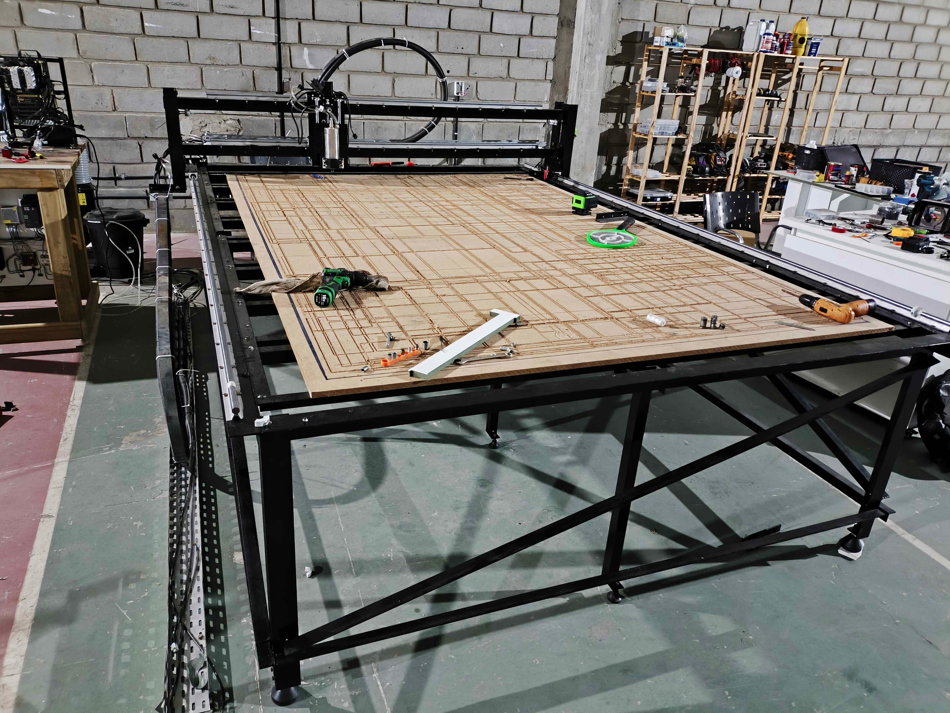

I have a CNC machine whose table would actually work very well with this modification, as it’s built from 2.5-inch steel angle. However, depending on the cutting speed and depth, the X-axis gantry on my current machine tends to flex.
So I’d like to try mounting the LowRider gantry on linear rails like you did. It would also be a good opportunity to test whether the LowRider gantry can handle the weight of a 2 HP water-cooled spindle over a relatively large span of about 2.3 m.
I’m currently building a standard LowRider V4 as well, using a regular router, so I’d be able to compare the two setups directly. If the linear-rail version performs better than my current CNC, I’ll probably keep it as the permanent setup.

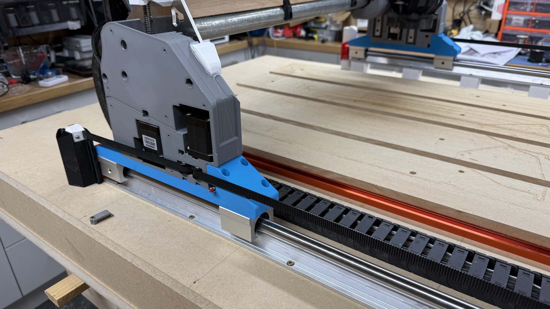

I’m just in the middle of doing a write-up for posting on MakerWorld with photo’s etc. I can send the 3MF file if required, but there’s no explanations or setup with it. It is fairly self explanatory. The only fiddly bit is the y-axis datum switches.

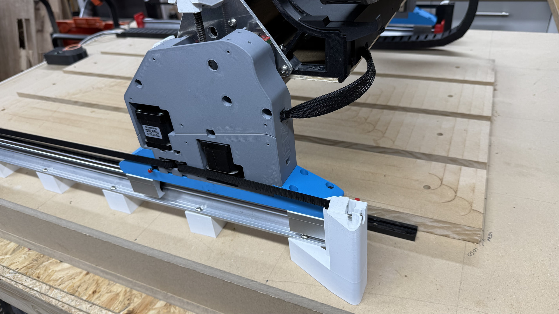

I’m doing this as well. Got the rails yesterday. My first step was figuring out how much higher the rails were over the conduits, so I could adjust the table as needed to compensate for the increase in height. I plan on temporarily mounting the carriages today and doing some more testing. Designed some printable parts to replace the standard ball bearing “feet” and if they work out I’ll post those on printables.
how did you accommodate for the different height where one rides surface but one is on the conduit? Did you simply make your blue blocks different heights?

No, I lifted the max rail up onto stand-offs. They are in the print project on Makerworld. I toyed with the idea of redesigning the Y-Z plates to make both sides the same height, but I wanted to keep the mod as simple as possible.

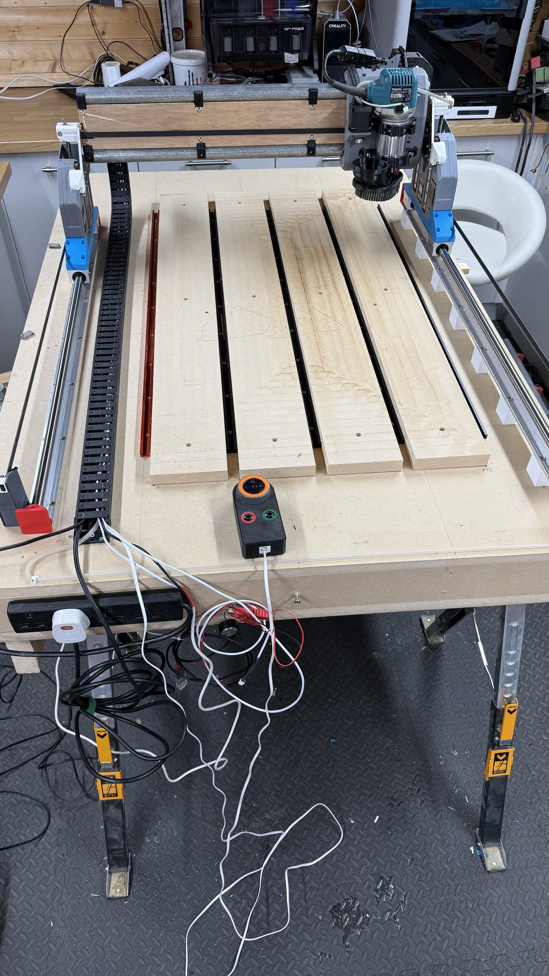

I’ve been testing the new layout on a guitar body blank and I am delighted with the results. I can run the feed rate at least double, with no problems. I’ve been testing on Obeche wood, which is a very soft and light hardwood, but it’s working great.
I see it now. I completely missed those blocks!
