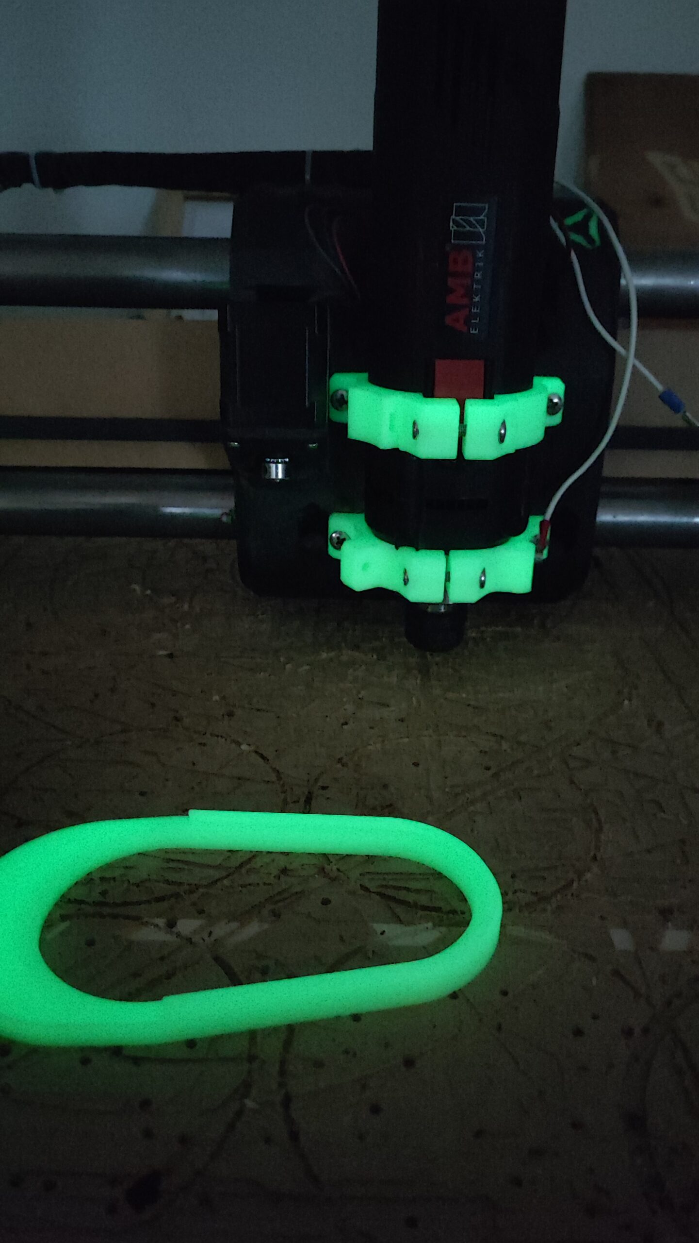

I printed the Ghostrider exclusively using Prusa Galaxy Black and Glow in the Dark filament from Das Filament with the recommended settings, sometimes using multicolor prints. It doesn’t add functionality, but it looks great. :slight_smile: I milled the XZ plates myself from 8mm thick aluminum, and the rails are precision steel tubes with a 3mm wall thickness, treated with Silbergleit (a metal lubricant).

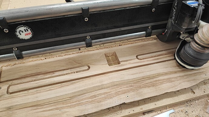

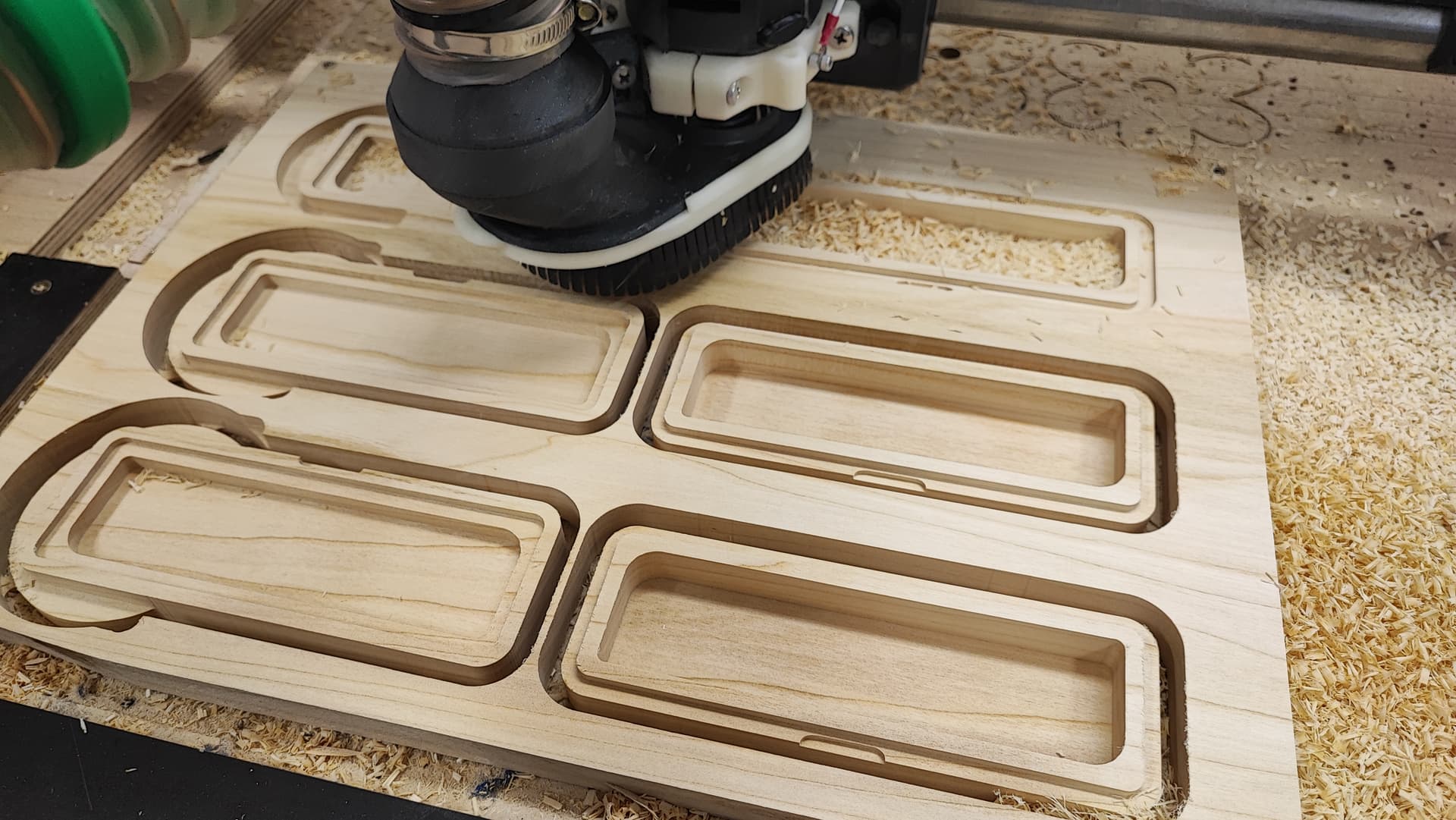

You’re buying a LowRider built by someone who has been working with V1 Engineering machines for over 5 years – starting with the Primo, then the LowRider 3, and now the LowRider 4 (which I built two and a half times during the beta phase). The machine is precise, as you can see from my inlay work and decorative boxes (assuming sharp bits). Feed rates of 2400mm/min at 6mm depth using a 6mm two-flute bit are possible, though I usually limit depth to 4.5mm in hardwood. The basic settings are saved on the Arduino Mega, and I’ll include a sample tool list for Estlcam.
