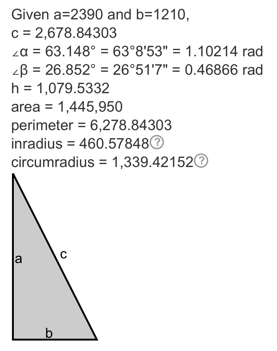

This new machine is fantastic! This morning I did 2 more tasks.

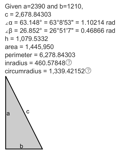

  1. I checked belt accuracy, using the v-bit and painters tape method. Sent it 2390mm with the terminal then measured the pinholes and came up 2391mm. Not bad!
  2. Next I checked corner to corner. Punched pin holes in at x10y10, x1220y10, x1220y2400 and x10y2400 and my corner measurements came out 2678 and 2680mm. This blew my mind how close it was!

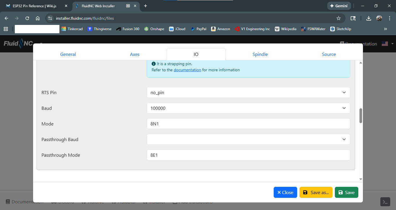

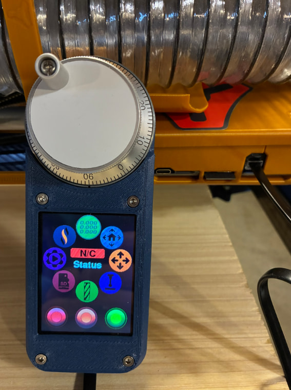

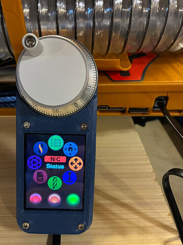

Okay, I know I’m putting the cart before the horse and steering him right off of the YBR on top of it, but if anyone could tell me what I’m doing wrong with enabling this pendant, I’d be so grateful…
I downloaded the JP3_LR from Github and found this commented out at the bottom of the config.yaml

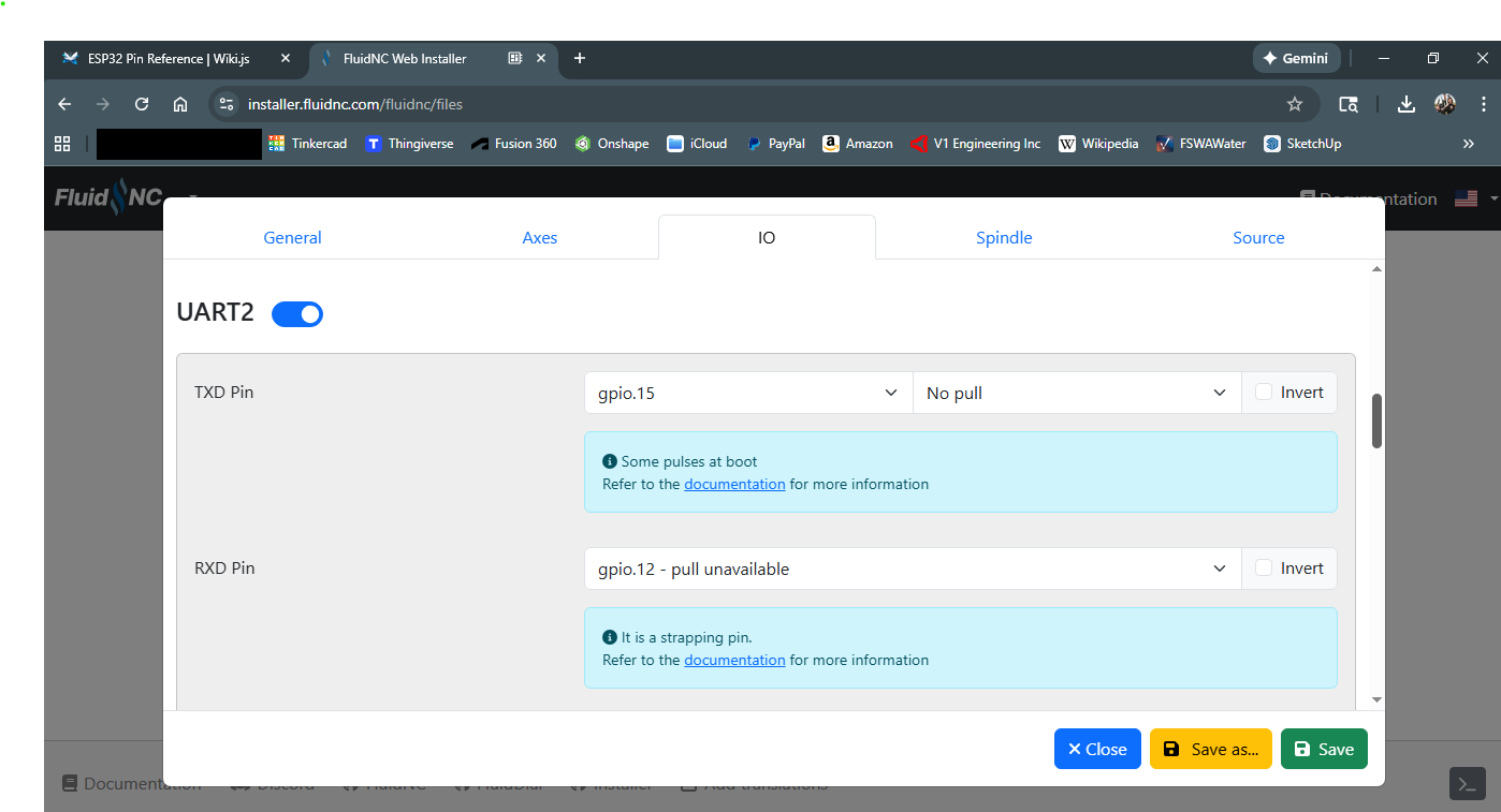

So I tried enabling those settings through the FluidNC Web Installer…

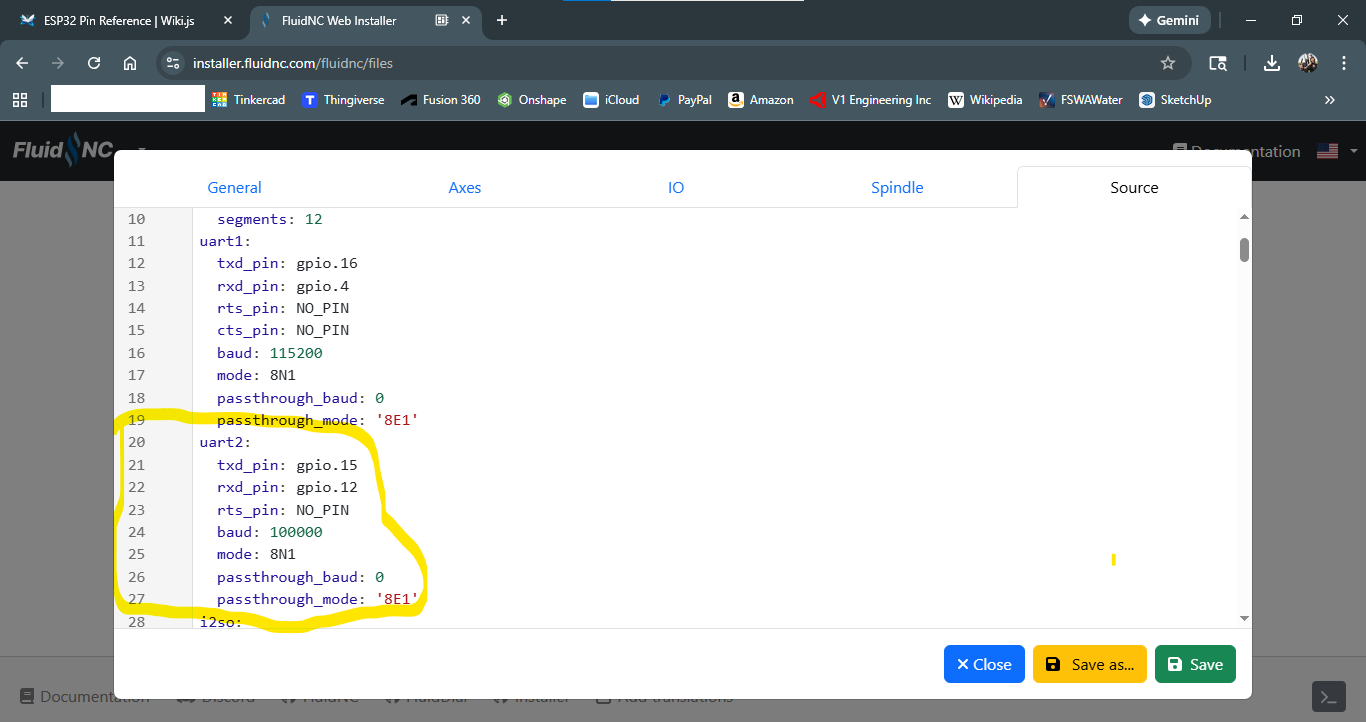

Which then showed up in the source file…
But still no connection?!
Any thoughts?
Yours looks different than what I see here…

I would use a text editor, you will need to disable (NO_PIN) the other place that shows pin 12 and 15. If I am not mistaken.
That web tool is best for an initial set up but have already taken care of that for you.
This is from my JP3 config:
uart2:
  txd_pin: gpio.15
  rxd_pin: gpio.12
  rts_pin: NO_PIN
  cts_pin: NO_PIN
  baud: 1000000
  mode: 8N1
uart_channel2:
  report_interval_ms: 75
  uart_num: 2
