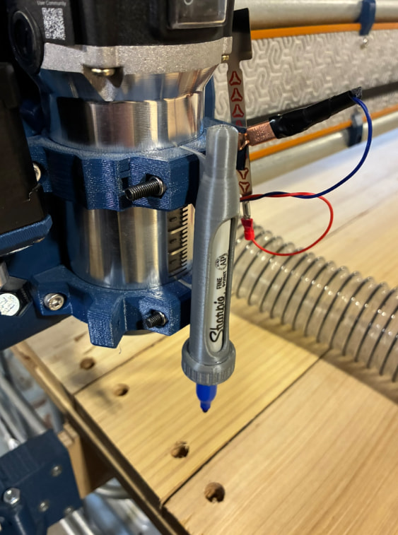

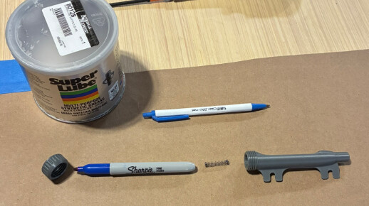

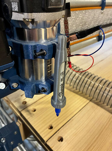

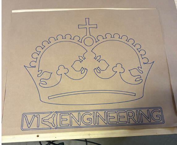

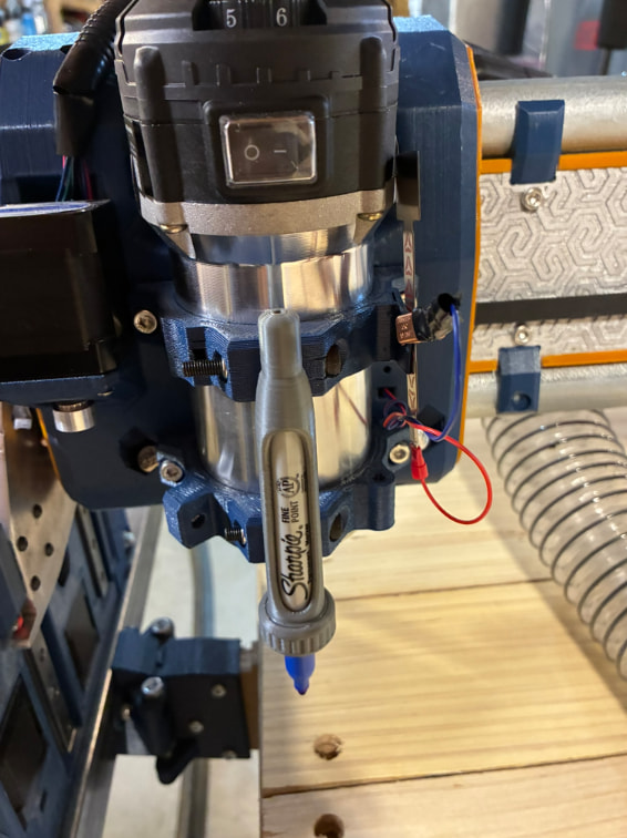

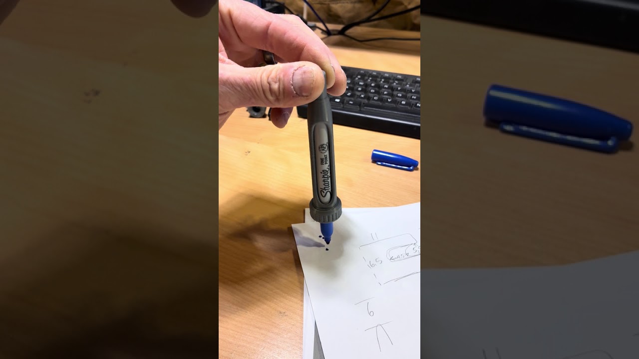

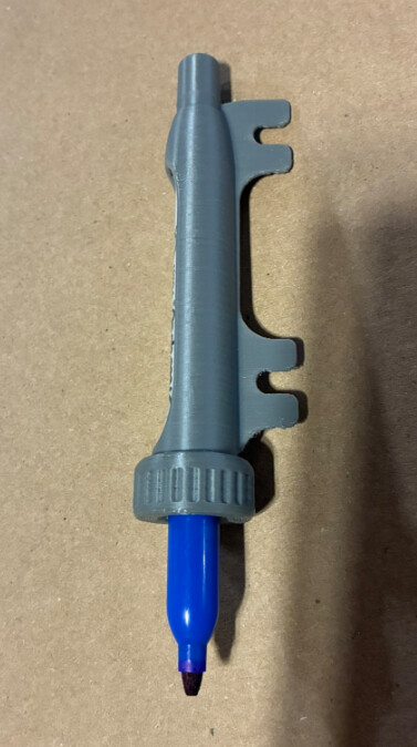

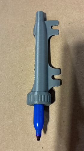

BTW I made a spring loaded Sharpie mount for the LR4. If anyone is interested just let me know I I’ll share a link to it. It places the Sharpie about 56mm in front of the center of the spindle, so you have to account for that. Also, I raised my clearance plane to 10mm so as to clear the spring action.
I put a little super lube on the threads to make it smoother to go together. The spring comes out of a cheap Bic Stic pen.
I would like to have this. Lol so i can mark up my sheets with the same program and stop doing it manually
Sure, here’s the links!
You win for the largest crown!

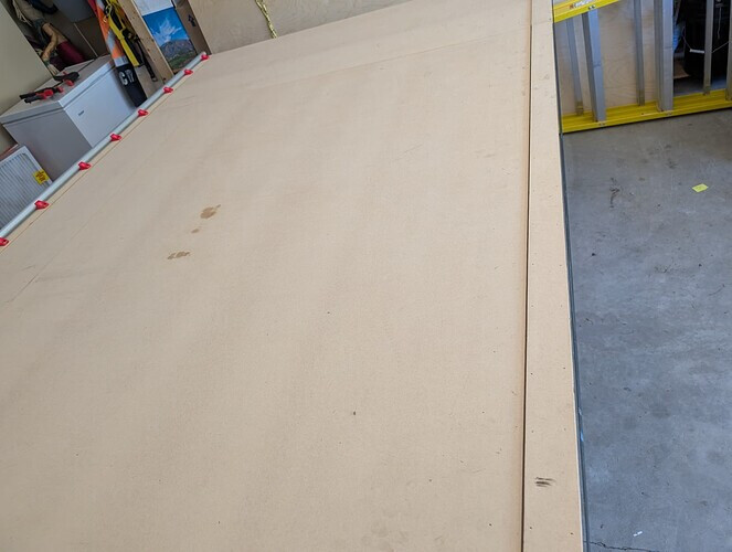

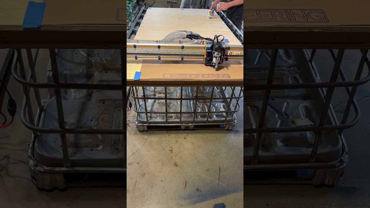

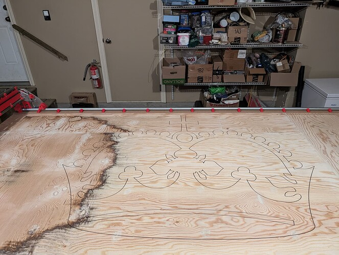

Did you face off your plywood waste board with a surfacing bit? From the picture it looks good! I only ask because my waste board is plywood, not MDF, and I wasn’t sure how well that’d work.
(I actually started a thread in the past I wish there was a product to build a waste board… exploring options other than using the uniform composition of MDF)
Yes, I used the 1/2" Dovetail bit that is frequently recommended here to surface the plywood. I ended up taking almost 4mm off of some parts of the surface before I came close to the lowest point.
Then I covered the plywood with 3/8" MDF over top to act as a flat surface, to cover the scabby looking plywood, and to act as a permanent spoil board.
Next I added some MDF blocks so that I could slide the sheets of plywood stock into a fixed position quickly and repeatably.
I slipped a sheet of 1/8" MDF under the plywood to act as a temporary removable spoil board as well, to keep the 3/8" MDF looking nice a little bit longer.
I also added some of the 3/8" MDF under the Y rail and along the edge where the Y rollers run, in order to maintain full Z travel.
