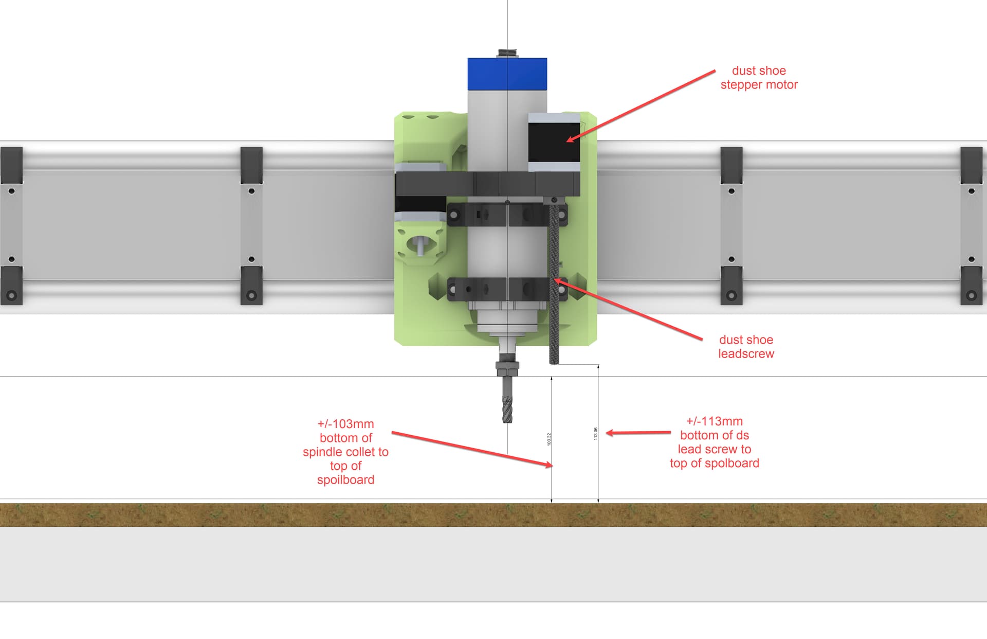

He’s already solved how he can go about adjusting the dust shoe height, by a length adjustable linkage to the leadscrew nut.

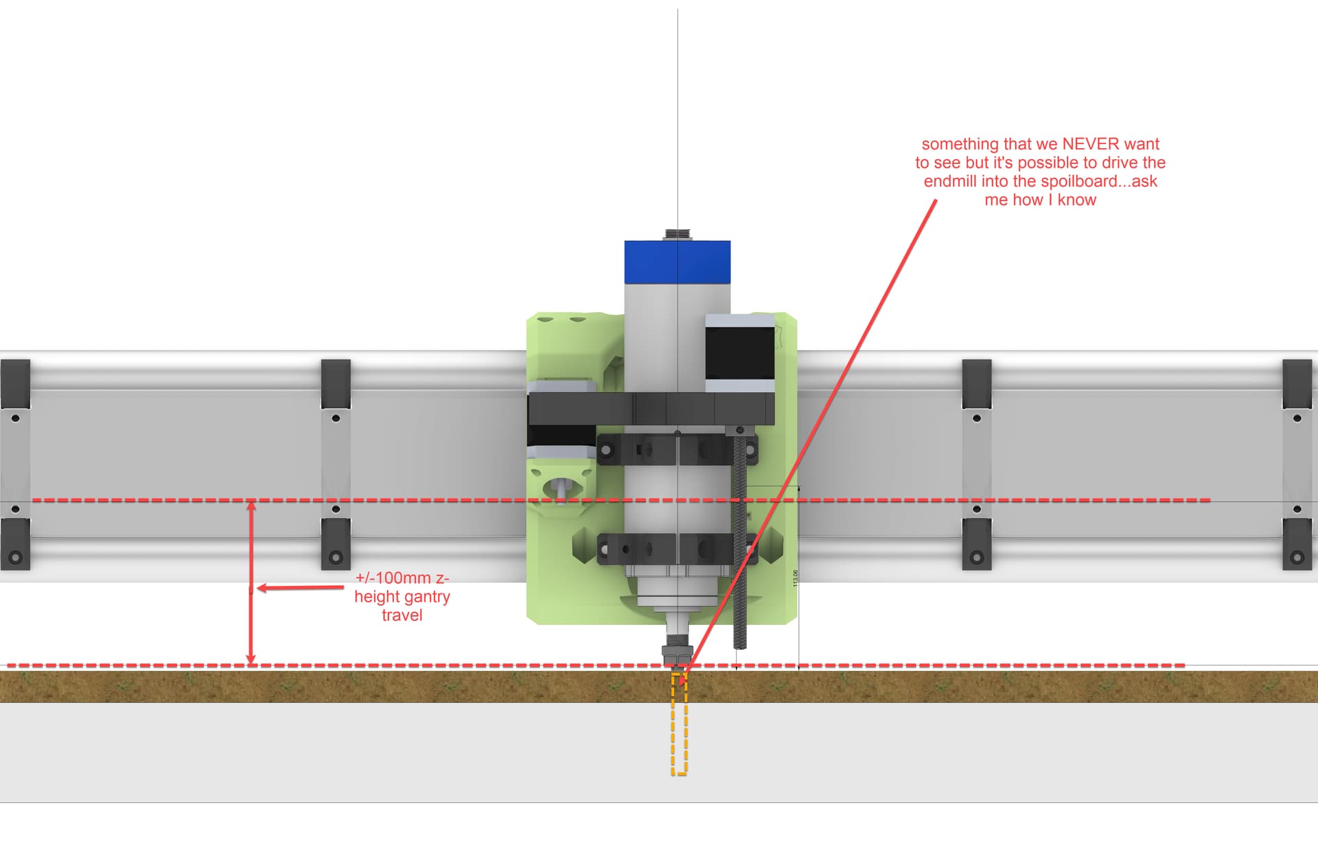

Here is my first design iteration:
Video Link:
LR4- Independent Dust Shoe V1
Here is a mock-up of the “Glowrider” on the existing Primo table I already built.
Now I just have to build it.
I just saw this “auto-dustboot” from the Altmill, and this is cool. Using the mist settings to control it’s activation is a neat idea.
I’m going to k.i.s.s (keep ot sort-of simple) and do the height setting manually to “zero” out the height of the dust shoe and let it raise and lower as the gantry lowers and raises. However, in principle, once you have a stepper that drives the device, if you can write code and plug in the correct wires, it could be automated with sensors and controlled via GRBL commands, etc.
I see the benefits on a regular fixed height x-gantry cnc, but the LR z axis moves everything up/down. Im going to be really impressed to see your working setup, as i would like something like that but for attaching a pressure plate
Yes and no.

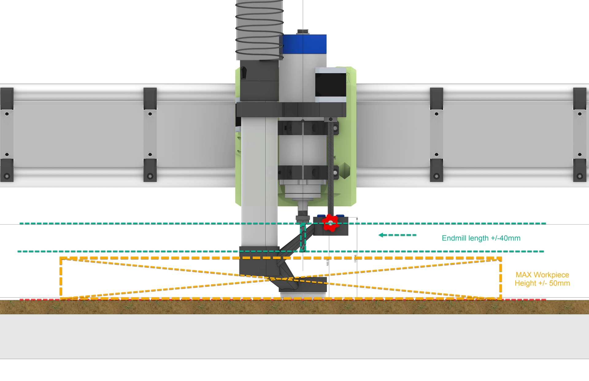

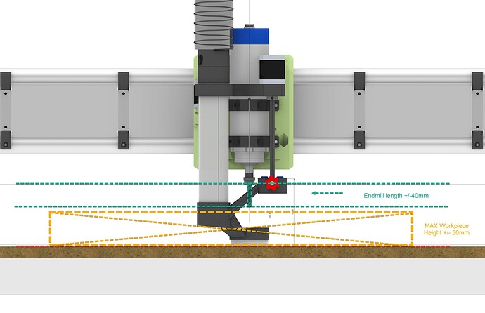

For a fixed height gantry where only the Z-axis of the spindle goes up and down, having a “software-controlled” dust boot mounted to the fixed gantry that moves up and down independently of the spindle makes sense. Obviously, many people do that for various reasons, not the least of which is to get the dust boot out of the way for tool changes.

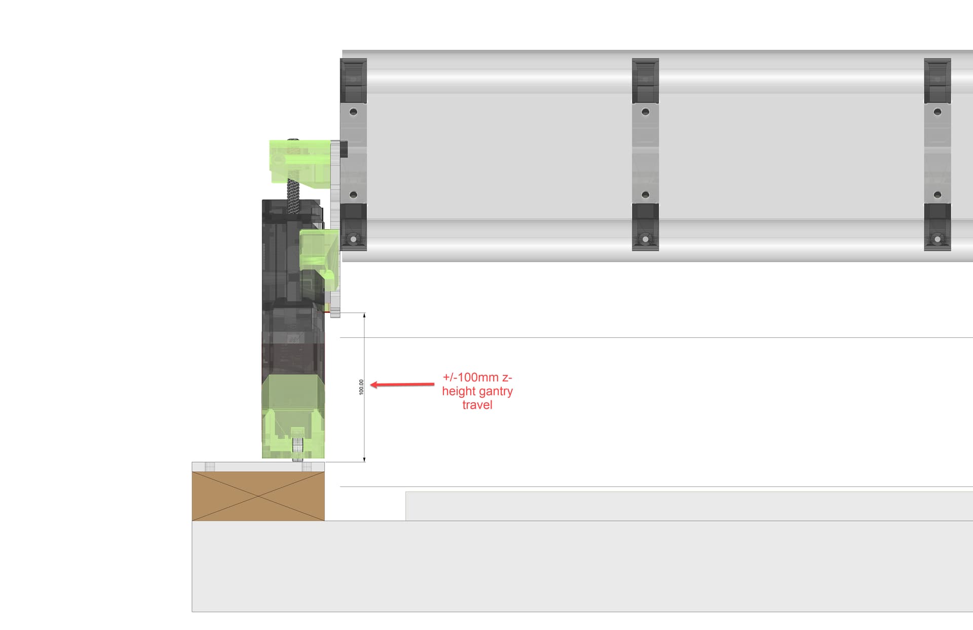

In the Case of the LR4, there are use cases for having an independent z-height dust boot.

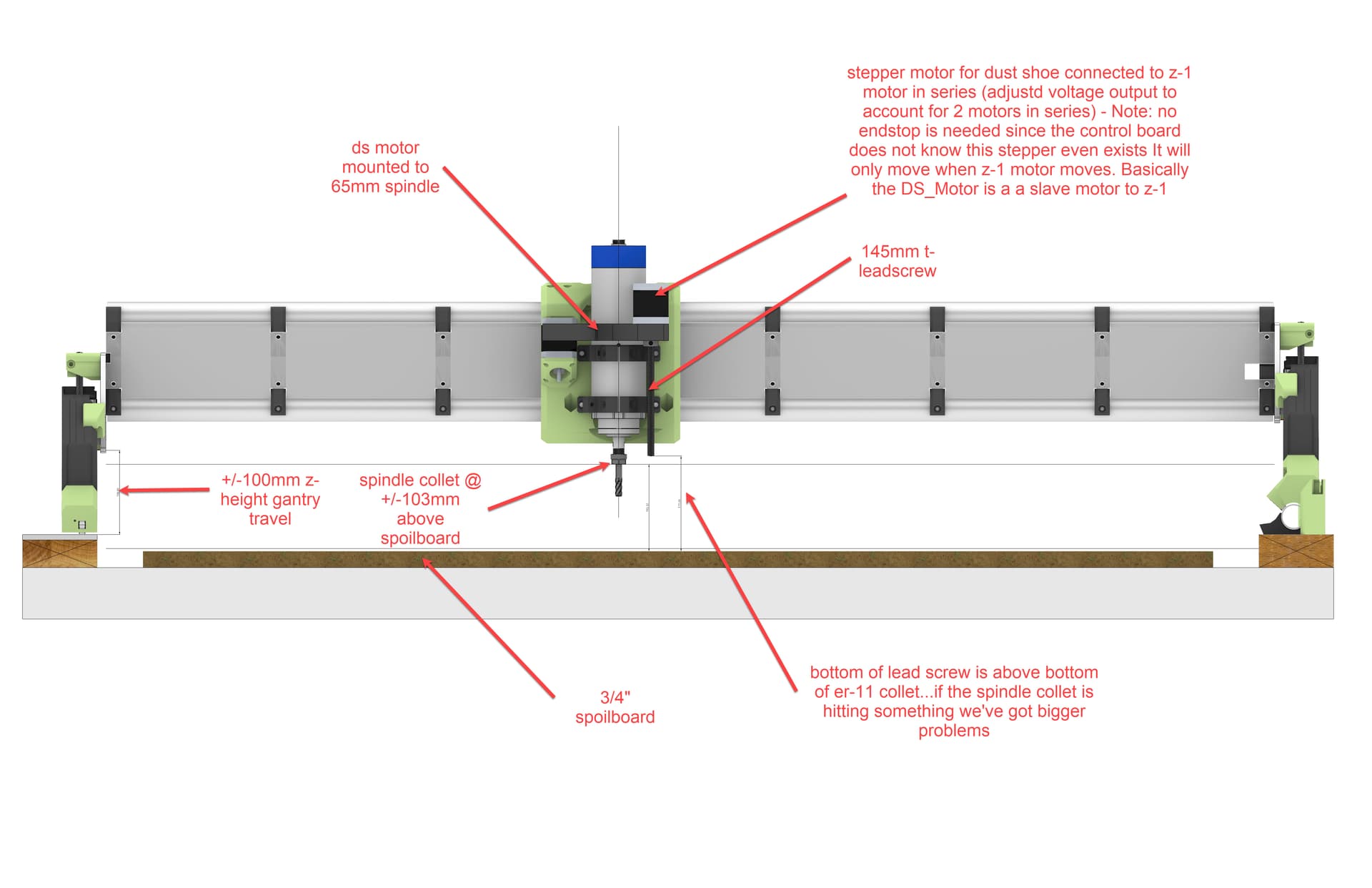

The complexity, if you want to call it that, is that the gantry is moving up and down, not just the spindle. So mounting anything in a “fixed position” to the gantry would be pointless, which is why we still need the stepper motor.
However, unlike a fixed gantry setup, we can not control the “height” of the dust boot with “separate” movements from the gantry unless we add the 6th stepper and create the g-code that controls that motor separately from the gantry z motors. Hence, the reason why we need to make the Dust Boot stepper motor a slave to z-1 and establish the dust boot starting z-height when the gantry is at z-maximum or homed position.
This could be useful for an air nozzle for chip removal when cutting aluminum as well as a coolant mister for cutting metals, essentially keeping the coolant or air nozzle at the top of the workpiece instead of burying it into the workpiece or having it above the workpiece to avoid contacting the workpiece.
Anyway, like I said at the outset, this is just a crazy idea until it works. For most LR4 users, this is not necessary and would be a nuisance.
Genuinely curious to see what you end up with.

I was noodling in my head with (2) 1/4” diameter stainless steel rod flanking the spindle and mounted to the gantry.
A dust boot would ride up and down on these rods with a collar to set its z-height max, and springs would be mounted outside of the 1/4” rods, say a 3/8” diameter spring that would have a stop collar at the top of the rod.
The spring would push down on the dust boot, thus keeping it on top of the workpiece.
But >>>>> and it’s why I stopped thinking about it.
If the gantry/spindle ever moves away from being over the workpiece, the springs would push the dust boot down to the top of the spoilboard, thus making it crash into the workpiece if the spindle moves back over the workpiece.
This is why we need to match the gantry movements, but in reverse so every gantry movement down results in a dust boot movement up.
Of course, this is all theory and pixels right now, I need to make it plastic and real to test it out.
