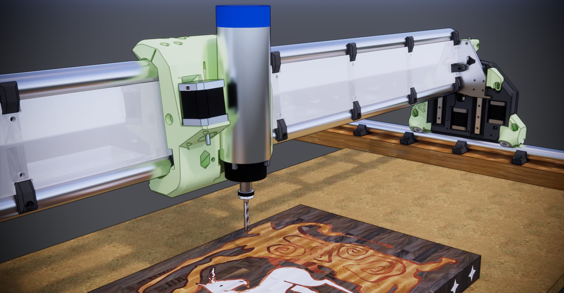

Lowrider 4 assembled model
Thanks. I still am a big fan of your work and videos. In the long run, it’s likely better if I build my LR4 3D mock-up model myself anyway.

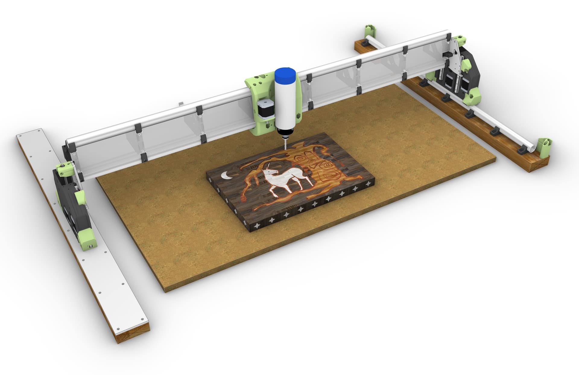

I’ve decided to keep the X and Y axis as stock and to make the Gantry on my 2’x4’ table as the 4’ dimension. IE: X = 48” and Y = 24” work area. I mean, this is a full sheet capable machine, so having a 4’ gantry is or can be considered “normal”
The bonus is that the homing position is standard and consistent with my Primo Build, and there will be no obstruction on the table at the front where I have a cut-out in the table to do vertical work mounting.
I also want to design a pseudo Z-independent dust shoe since I’ve gotten used to having one on the Primo.
In general, I’ve been inspired by Marius Hornberger’s Z-Independent dust shoe on his CNC:
Z-Independent Dust Shoe
And even though on the LR4 the whole gantry goes up and down, I want to design a dust shoe that maintains its z-height at the top of the workpiece (if possible) or at a minimum, use some sort of spring load z-height so that it can fluctuate up and down based on the workpiece height and tool bit depth.
So getting myself very intimate with the “stock” LR4 3D printed parts and where I can make attachments etc.
As you probably know, I did a Z independent dust shoe design for the LR3. So, I’m definitely not opposed to the idea. That said, the LR4 stock dust shoe is excellent, and since Ryan has made available both standard length TPU bristles and a LONG set of bristles, I’ve been quite happy with the new stock setup on the LR4!
Part of the “fun” for me at least, is not the final destination but the journey. So my brain is already excited about the challenge of designing a dust shoe that can go up and down independently of the gantry, which also goes up and down.
I’m already wondering if I can use the 5th stepper driver to interpret or intercept the z-axis movement and mirror them with the dust shoe. IE: when the z-axis of the spindle moves down 10mm the z-axis of the dust shoe would move up 10 mm and vice versa.
So in theory once you set the z-height of the bit IE: workpiece Z-0 that also establishes the machine coordinate z-height (whatever that number is)
In theory you could then independently raise or lower the (A) axis for the dust shoe to it’s own A0 work height. which would then be adjusted by the inverse of the new z-height as the G-code was running.
Like many things it all works “in my brain” however getting it to work outside my brain is the hard part. :slight_smile:
If I go down that journey, I’ll post my progress, and if I get it to work, I’d be happy to share it with others.

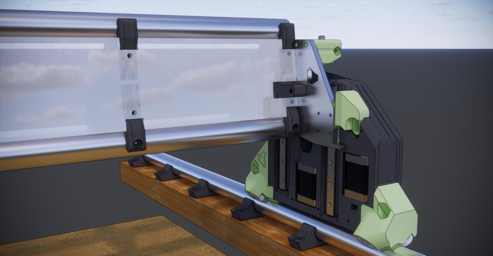

Modeling on the Glowrider V4 has begun…
This kind of remindes me of another build… Can’t put my finger on it though… :stuck_out_tongue:
(And yes, someone actually suggested Glowrider which would have been much cooler than Ghostrider… :D)
Next steps are to dream up an independent z-height dust mounting system.
I’m thinking of a weighted dust shoe riding on stainless steel rods with a stop collar and spring so the dust shoe can go up and down mostly independently of the gantry.
It would be mounted to the gantry and go up and down with it, but the springs would allow it to go up and down based on the work material height. IE, the TPU bristles would touch the top of the workpiece, and that force would make the entire dust shoe raise up.
I would need stop collars to prevent the dust shoe from dropping too low and hitting the side of the workpiece, though.
For starters, though, I’m going to try out the stock dust shoes with variable height TPU bristles, and like Doug said, maybe I’ll just be happy with them.

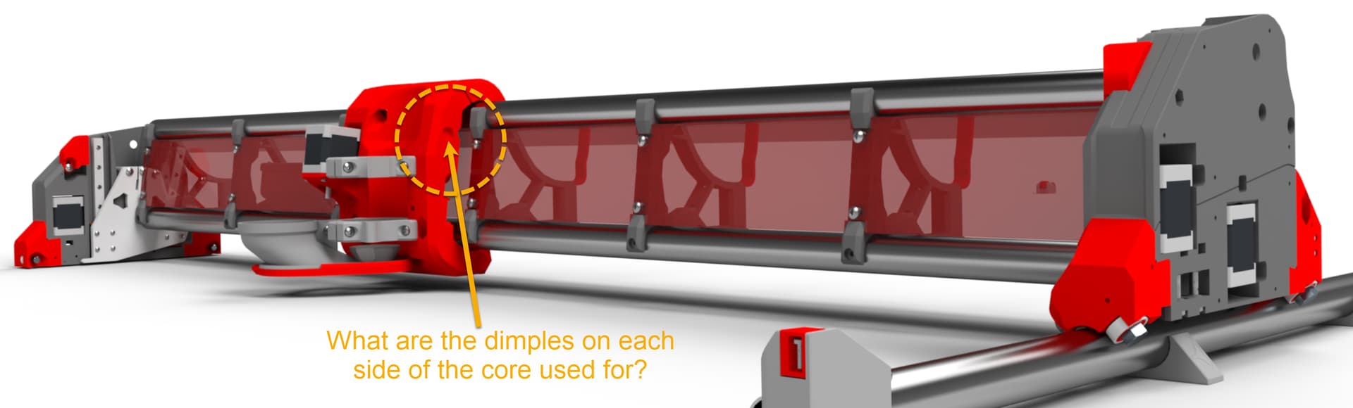

Side question,
But it may be related to my dust shoe mod?
What are the two dimples (recessed spots) on each side of the core used for? Are they just cosmetic or was there a purpose intended for them?
I may use them as a “snap in” location for the dust shoe
To accommodate the use of pancake head bolts on the z max plate I think.

accommodation to get every bit of X travel out of the core that is possible. They are clearance for the screws that go into the XZ plates. with the V1 provided screws (and many other pan-head M5 screws) this allows the core to travel all the way to the XZ plate in both directions.
