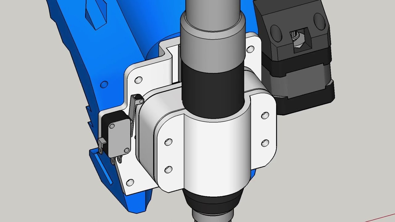

Thanks for the great thoughts and advice! The idea of the dedicated magnetic pen mount is cool, although I’d have to do the work to generate it. Conventional wisdom might say that creating the metal strips of the right shape is easier than salvaging more magnets, but for me it was the other way around. I located the metal strips on the secured side and put the magnets on the removable side. Processing by cutting metal with the bandsaw was required for both the magnets and the strips. Of course once I get the CNC plasma working, I could easily cut the strips in that shape. Maybe then I will reprint and flip the magnets onto the secured side and put the metal strips on the removable side. The bandsaw work on shaping sheet metal to match the shape of the magnets was harder and more risky than processing the magnets. If I could locate another old PC hard drive I could get another set of those strong magnets, for whatever.
I think I will be ok on the pen holder re. stick-out. Will know for sure once I get it running.
Following with interest, I’m planning on a floating mount for my LR3 plasma but it’ll need to fit a hand held torch rather than straight machine torch like you have.
I posted the “Part 1” video about 3 weeks ago. Sorry for delay, between then and now. Here as promised is the “Part 2” video on getting the plasma torch mount with floating Z setup:
Video — Part 3 — plasma torch mount with floating Z setup :
Video — Part 4 — steps to make the plasma torch mount with floating Z setup more easily reproducible by other makers:
Video — Part 5 — remaking the plasma torch mount with floating Z setup in favor of magnets that are standard, available, and affordable:
I need to rearrange my workshop to better use the space and to make room for the plasma cutting table! I had been delaying that but I’m headed into it. I actually plan to make a portable assembly table
out of the 4x8 previous “base” “shelf” that was under the LowRider table (previous version). I’ve been trying to decide whether to leave it whole and add legs and casters, or cut it down the middle and stack it on itself, with legs and casters, to make a long, half-wide double decker.
Part 6, final video on the 3d printed plasma torch mount. Future videos in the series will be on other aspects of the plasma cutting table / setup.
Note: printable files for the torch mount are now available on Printables. Click here!
