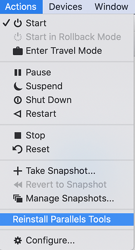

ATTEMPTING to INSTALL PARALLELS TOOLS:
su
eject /dev/sr0
MENU: reinstall Parallels Tools
mkdir /media/cdrom
mount -o exec /dev/sr0 /media/cdrom
cd /media/cdrom
./install
Often I cannot get installer to run (permission issues). Whenever I do, it claims two packages are needed, linux-headers-4.19.0-17-rt-amd64 and DKMS. The auto install of these always fails and I am told to install the two packages manually and re-run the installer for Parallels Tools.
MANUAL INSTALL OF DKMS:
sudo apt-get install dkms
MANUAL RE-INSTALL of linux-headers attempting to fix issue of Parallels claiming 4.19.0-17-rt-amd64 needs installed (it is already installed):
I went into Synaptic Package Manager, reinstalled 4.19.0-17-rt-amd64, and then booted into it, then booted back into main newer kernel, and after repeated attempts, finally got Parallels Tools install to complete.
