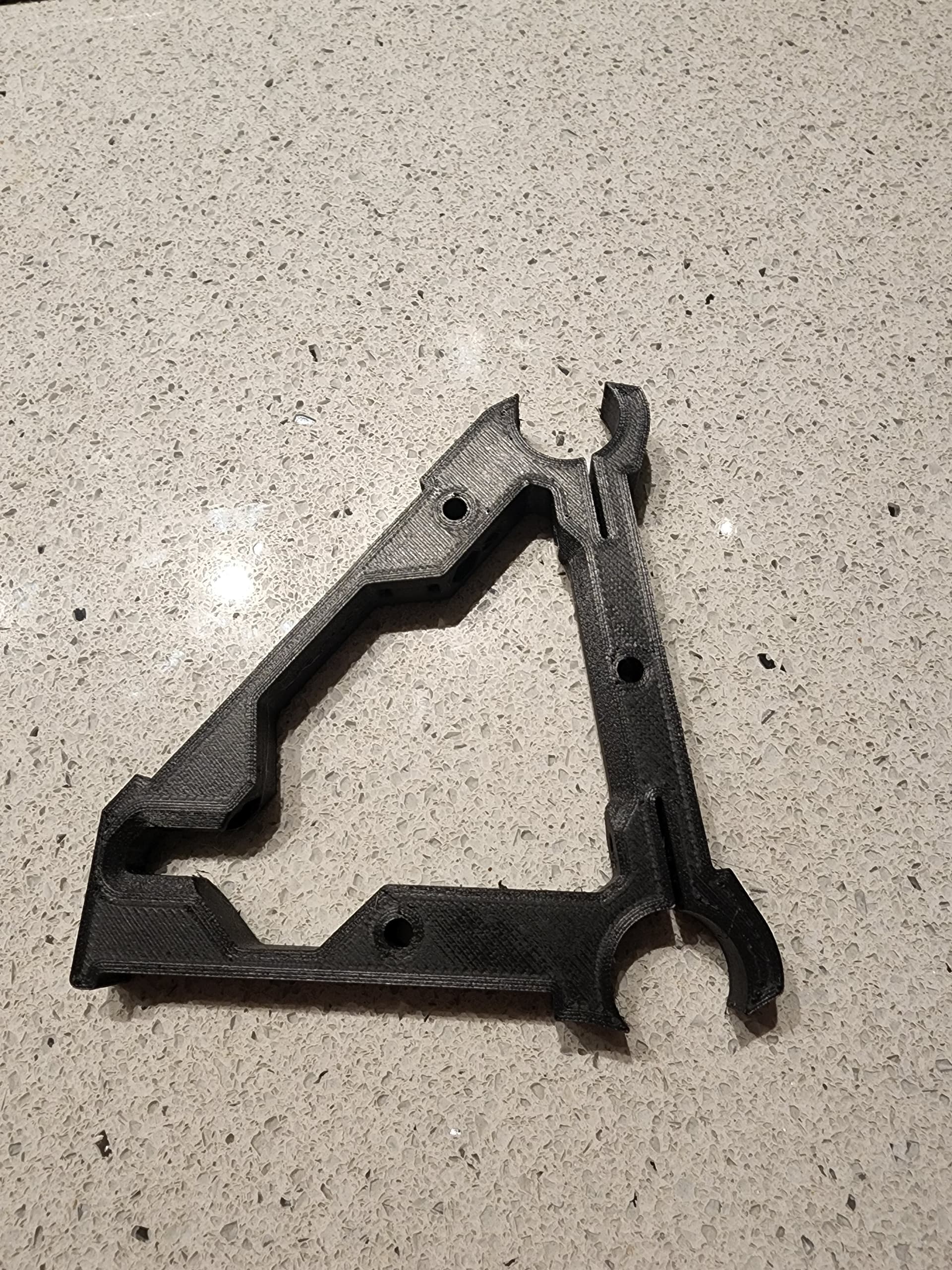

been lurking for a month after discovering the lowrider. Super stoked. Just started printing in PETG and ordered the core parts kits.
Looking forward to officially being part of the community. :call_me_hand:
Welcome in !
Unless you have a very specific reason for PETG I highly recommend PLA for at least the XZ plates, and maybe the core.

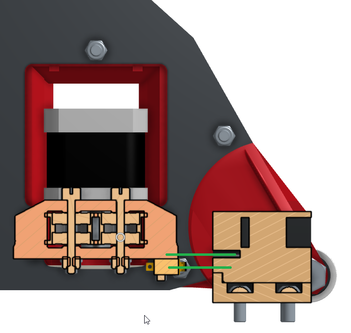

I am new here, even though I followed the forum discussions many times before. Durring my LR3 build, I always assumed that the holes in the front-y-belt-holder parts are meant to accept a screw as an adjustable stop for the limit switch mounted on the y-drive part, but I noticed that the hole and the limit switch does not seem to line up. Is it the same on the beta machines or have I got it all wrong? Thanks.

If you are using endstops you would never use a screw, that would be less accurate. Use M666.
If you are not using endstops then the screw hits the Y drive and serves as a hardstop as intended.
