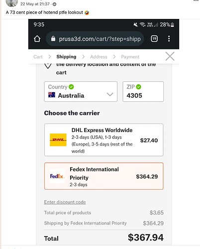

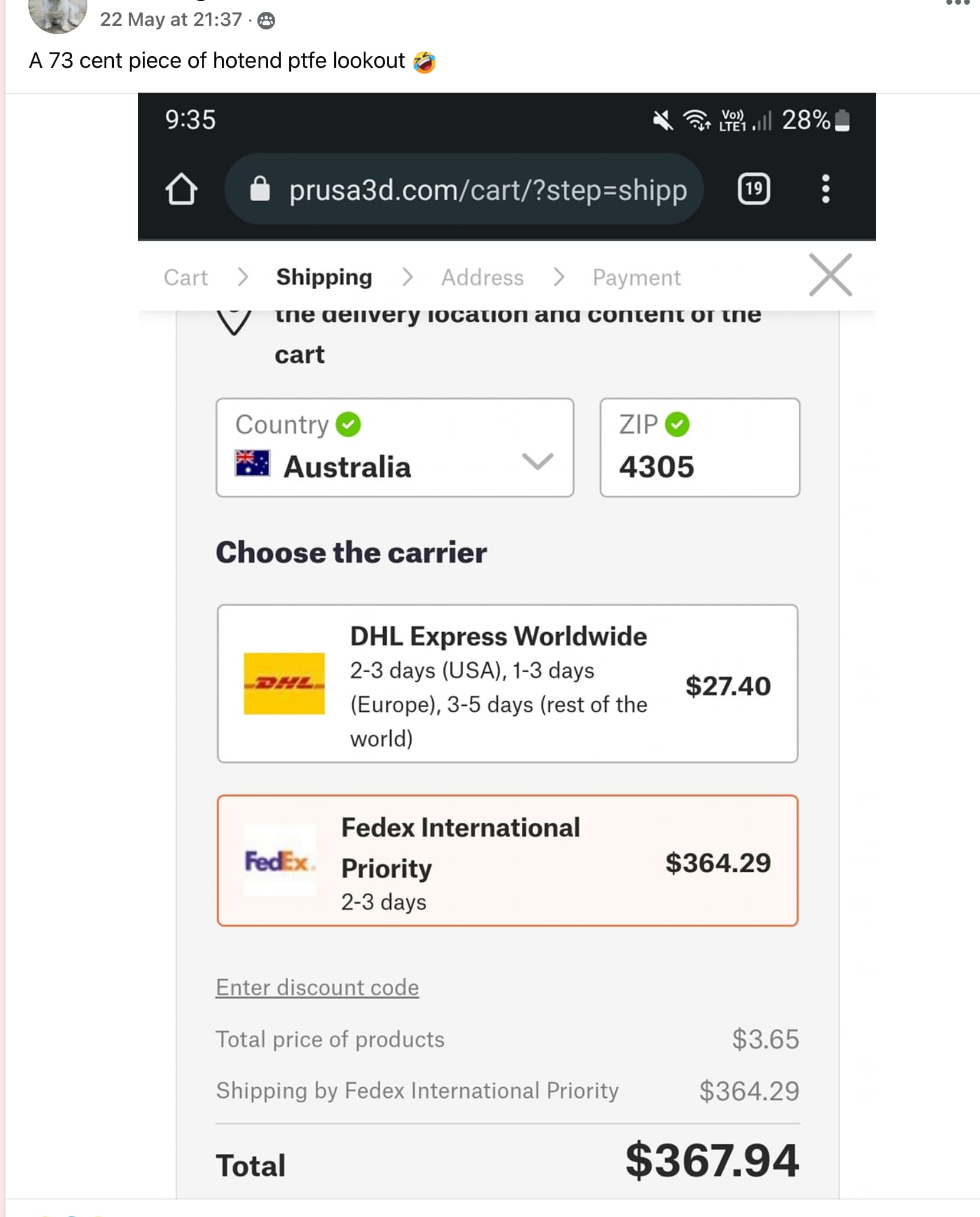

Man, Australian shipping is all over the board. No USPS currently, UPS some boxes are $85 some are $129 for the same stuff. So far it is staying pretty good ratio but too many $129 and I would have to change the rates.
I think most of us are used to that - this from FB this morning. Your shipping blokes think we are a long way away and from my experience USPS is worst of all. I used to have friends in Canada re-ship things for me in the bad old days, and there were even companies here or specialised in re-shipping because many US companies just don’t want to deal with those problems - thank you for standing by!
Wow. That looks like shipping to Alaska used to look.

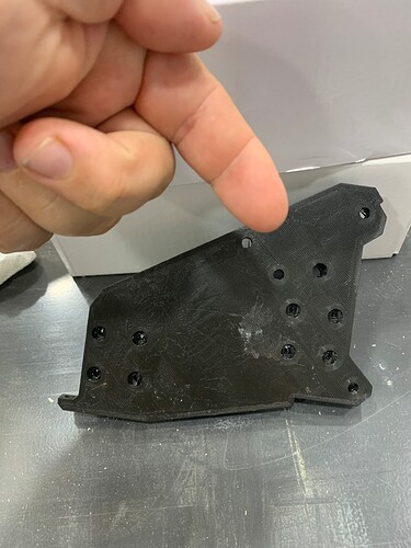

Just got done printing an XZ plate and the image of the milled part doesn’t quite match the printed part. There is a small crescent shaped hole missing in the printed.
Is this an artifact of manufacturing, or a mistake? I can probably drill out the hole if it’s needed
Thanks!
I noticed the printed pieces are not the same on left and right. I assume the 2D profile is designed to accommodate both sides with a single part.
The printed parts do not need them.
