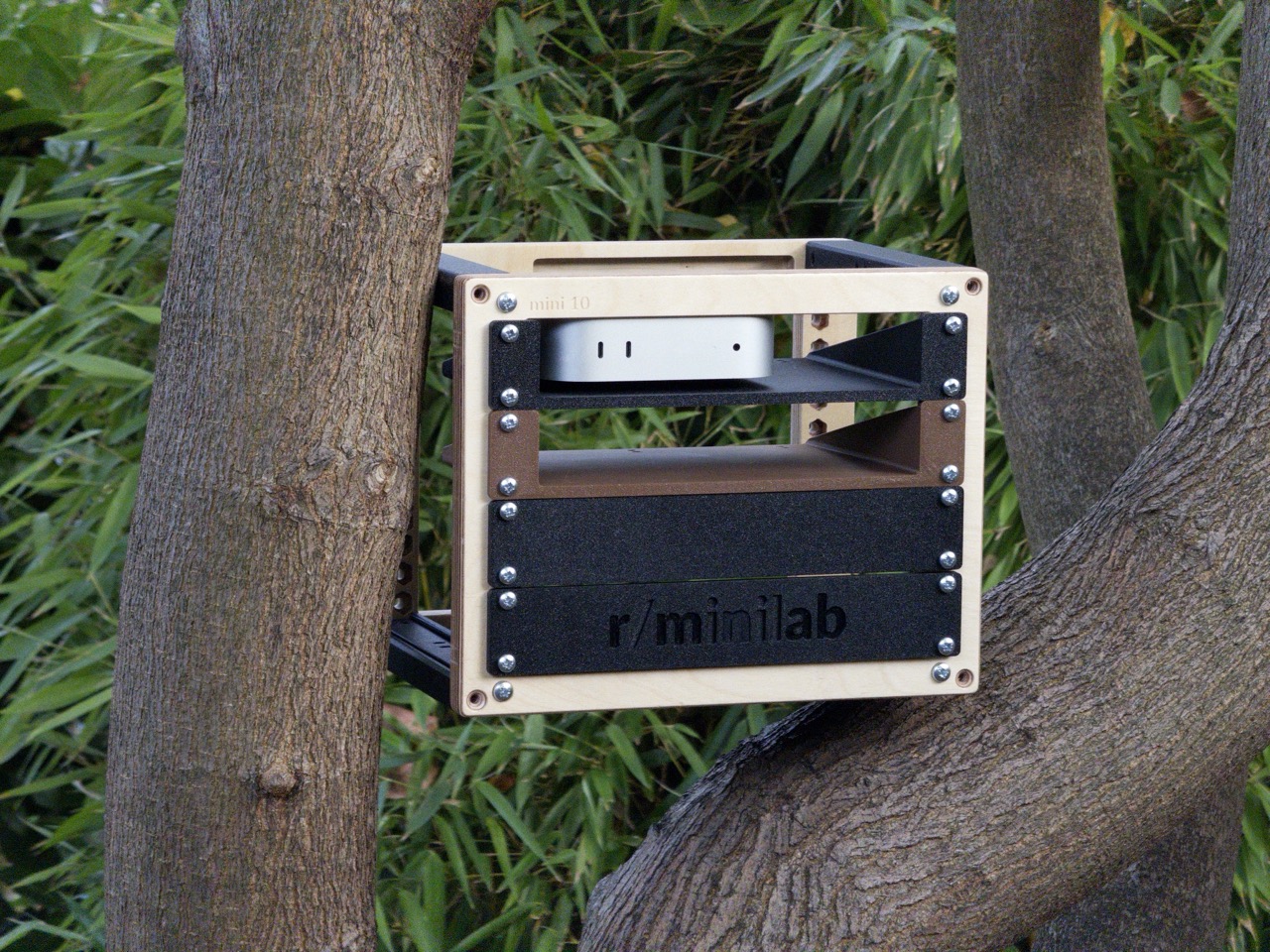

I’m in the middle of designing a new 10" mini rack product/project and gutted my CNC is offline.
