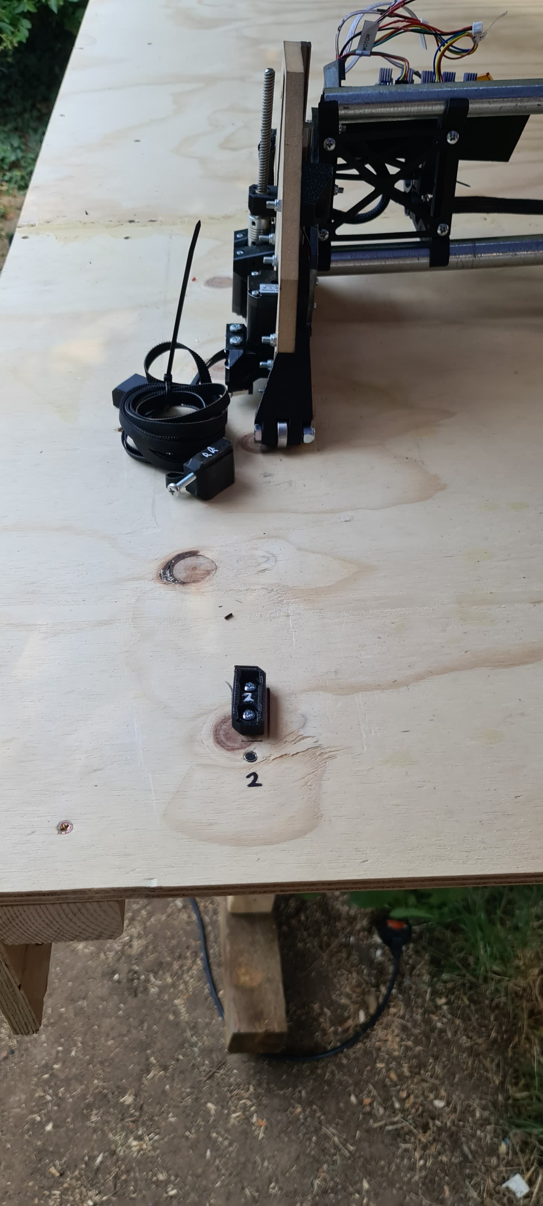

Soo, the build er… continued, but… today… i hit a rather er… unusual hiccup…
The sun has seemingly gotten lost or forgotten that the UK is meant to be grey, dull and cloudy… I mean hey, i’m all for a bit of warm weather… means i get to jump in the hot tub with the dogs and play stupid buggers with them… but… even covered and sheltered from direct sunlight, some of the plastic parts for the LR3 have er, melted… :frowning:
The belts have dissapeared into the middle of the rear tension blocks… The 2x X axis poles no longer sit in their mounts if i want the the ZY plates to sit at 90deg from the bench… (i.e. upright as they are intended to be…) They now sit like a car with waaaay too much camber at around 30deg and my braces and temporary strut plates look like something from a Dr Suess book!!
So… the next 2 days are meant to be even hotter and that means it’s not worth doing anything now till next weekend… a whole week lost!
My 3d printer is unreliable, (damaged in storage, fixed, damaged again in storage, etc. etc.) so the original parts i ordered from @vicious1 directly, i feel quite gutted knowing how much it takes to print all these out just to have them warp before they get any use… Probably worth mentioning the service from Ryan & V1 was awesome and the parts arrived in perfect , flawless condition, it’s entirely the unreliable british summer and the sun getting lost thinking it’s in Dubai or something :slight_smile:

some pics from today,
pic 1 is the belt having dissapeared into the tensioner after the tensioner became soft in the heat…
pic 2 shows how the belt was looped prior, so all that is now stuck in the tensioner that’s now hardened again!

Was that thing in a greenhouse? I’ve only ever seen one other machine warp like that and that’s where they had it stored.
No mate. On the workbench in the garden with a canopy covering it… the weather was 38-40degC
Weird. Who made that pla? Want to stay away from it. :rofl:
And there was me thinking i’d up sticks and move to a hot country with all my new CNC side earnings (i wish fml!!) pmsl… nah, no issues with supplier. it’s plastic after all and it was flippin hot.
