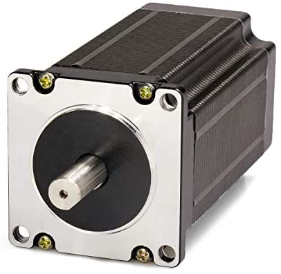

I have been reading all the information shared in this forum and it is all great. I want to build a V2 with 1.5A nema 23 motors which are compared to the nema 17 but I can’t know about 3d printing and I would like a design like the Lowrider v2. Someone has the stl to adapt a nema 23 of 1.5A please.
This has been discussed in the past on these forums do you should be able to find info on that conversion. I’m curious as to why you want to use bigger motors. Early consensus was the bigger motors don’t really provide benefit relative to the added cost of bigger drivers needed to run them. You don’t get additional speed or accuracy.
@ttraband I also don’t get missed steps, even with bigger DOC, even while cross-cutting plywood.
Also, instead of pushing NEMA 17 motors and generating a lot of heat, which plastic does not appreciate, I run my NEMA 23s at 48V. Higher voltage means lower amperage which means the steppers run cooler. This is important when the temperature runs into the triple digits over 100 days each year…
I understand that point. I would like to use a nema 23 that I reuse from a xerox printer, I have 5 equal ones of 1.5A and thus be able to save a little money and not buy new ones. Buying through amazon costs me 90 dollars. (I am from mexico)
I’ll absolutely defer to those with practical experience with the conversion.

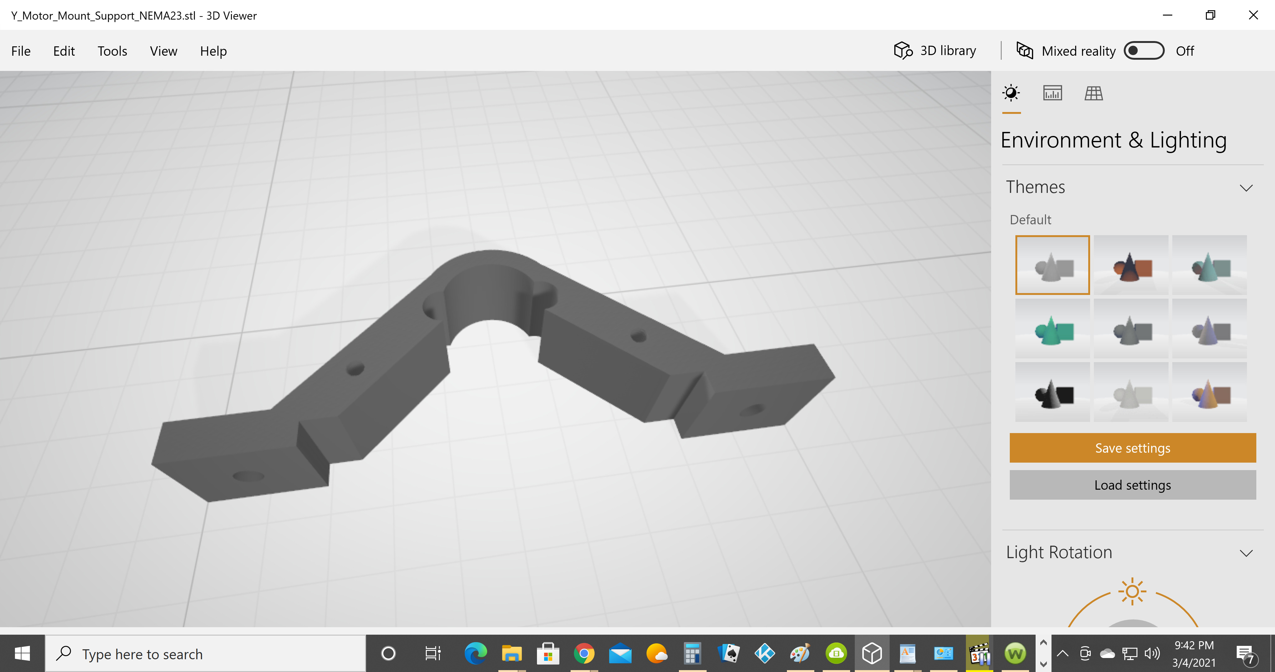

what part is this and where does it go. pullin hair out i don’t have.
its in your parts list it is called Y_Motor_Mount_Support_NEMA23. with the pictures i have i can’t get it clear look. oh by the way, i thought you had a article in instructables. dean
This part was designed to be attached to the Y-plate below the Y_Motor_Mount_Bottom to support the section holding the Z-axis lead screw nut. I was concerned that the extra gantry weight would be too much for that stress point.
