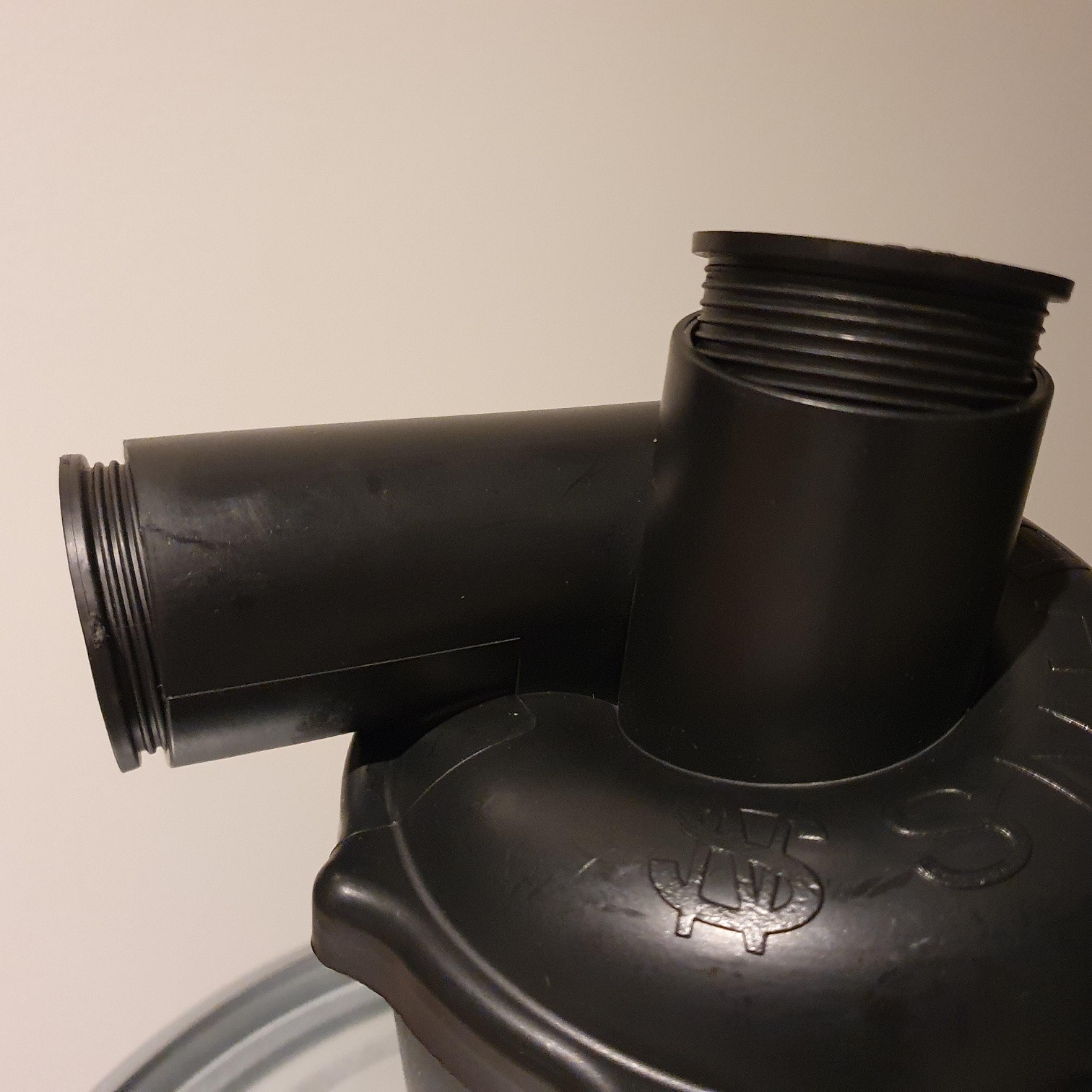

Yesterday the delivery guy handed me an early Chrismas present :slight_smile:
My dust bin and cyclone filter arrived. Yeeey!
Some pictures, for those that like to see them:
As you can see, I opted for a metal 60 liter bin, after reading @BingBadaBoom 's feedback on the PVC version. I wasn´t keen on securing the bin from the inside :slight_smile:
I will have to say though, that after testing the metal bin, I nearly got a heart attack, as the lid of the bin actually did got sucked in because of the vacuum. It made a hell of a noise :slight_smile:
Good thing that I can open the valve on my vacuum cleaner to avoid further issues.
As you can see on the pictures, I added adapter mounts to perfectly fit my 15 meter hose, and the hose of my vac cleaner. What I don´t like is that the mount of the vac cleaner isn´t that solid squeezed in, so I´ll have to keep an eye on that so it doesn´t disconnect. Time will tell.
During testing I did not notice any decrease in performance, so that´s a good thing :slight_smile:

What happened there? You know that you could add a spring valve in the lid, so it opens instead of imploding:)
