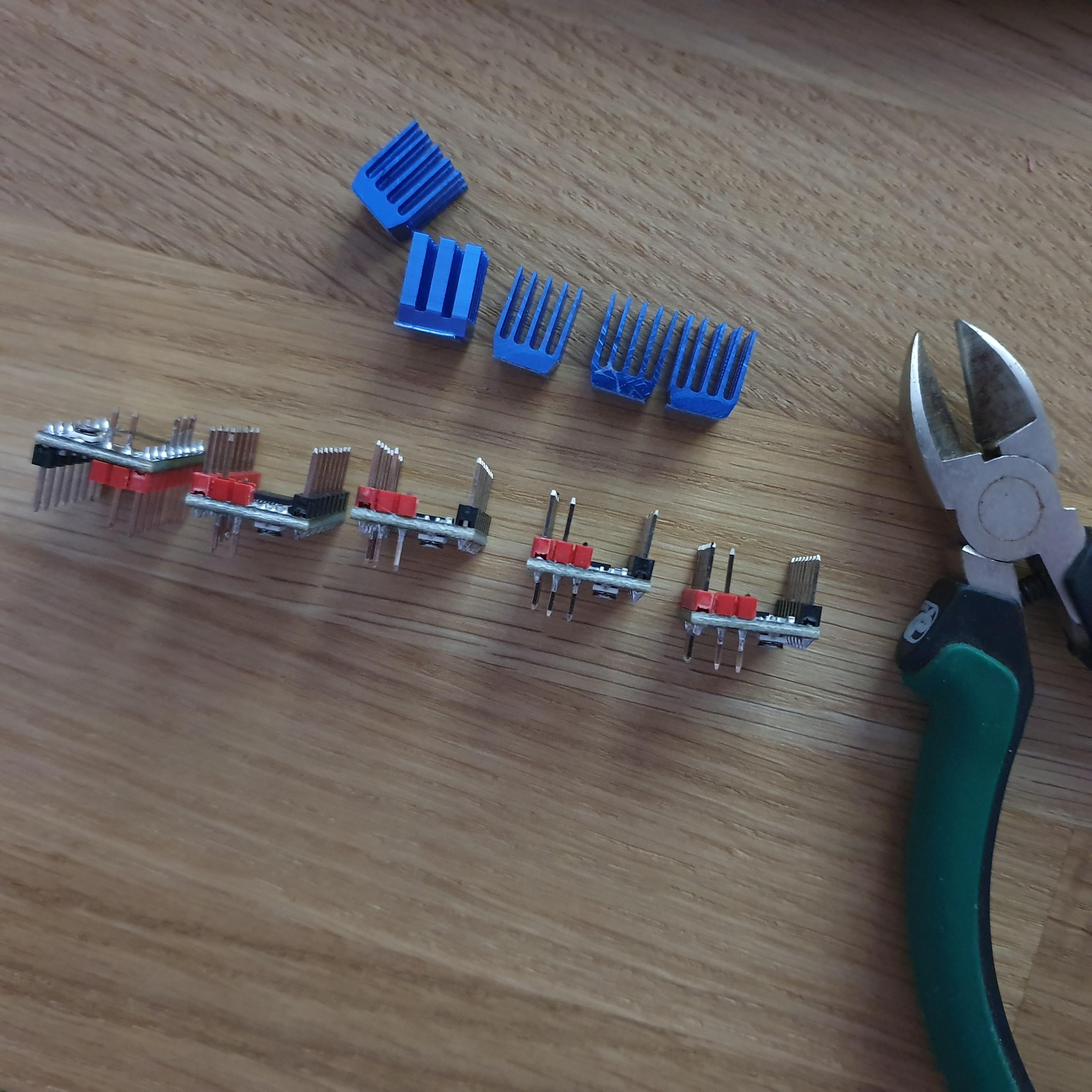

During the weekend I wanted to start on the SKR Pro configuration. But I doubt if I understand the FAQ correctly.
I want to use auto square functionality. AKA Dual End Stops. The FAQ mentions to remove the Sensorless pin.
Do I need to do this for Dual End Stops? Why not just keep it?
And, I believe it would be best to remove it instead of bending? To avoid shorts and static noise?

You can bend or cut the sensorless pin, or desolder it.

So, last night I made some time to do the initial setup of the board based on the FAQ instructions.
First, I removed the jumpers below the drivers mount, cut away the sensor pin (as I did not find my soldering iron quickly), mounted the cooling elements and finally mounted it all to the board.
