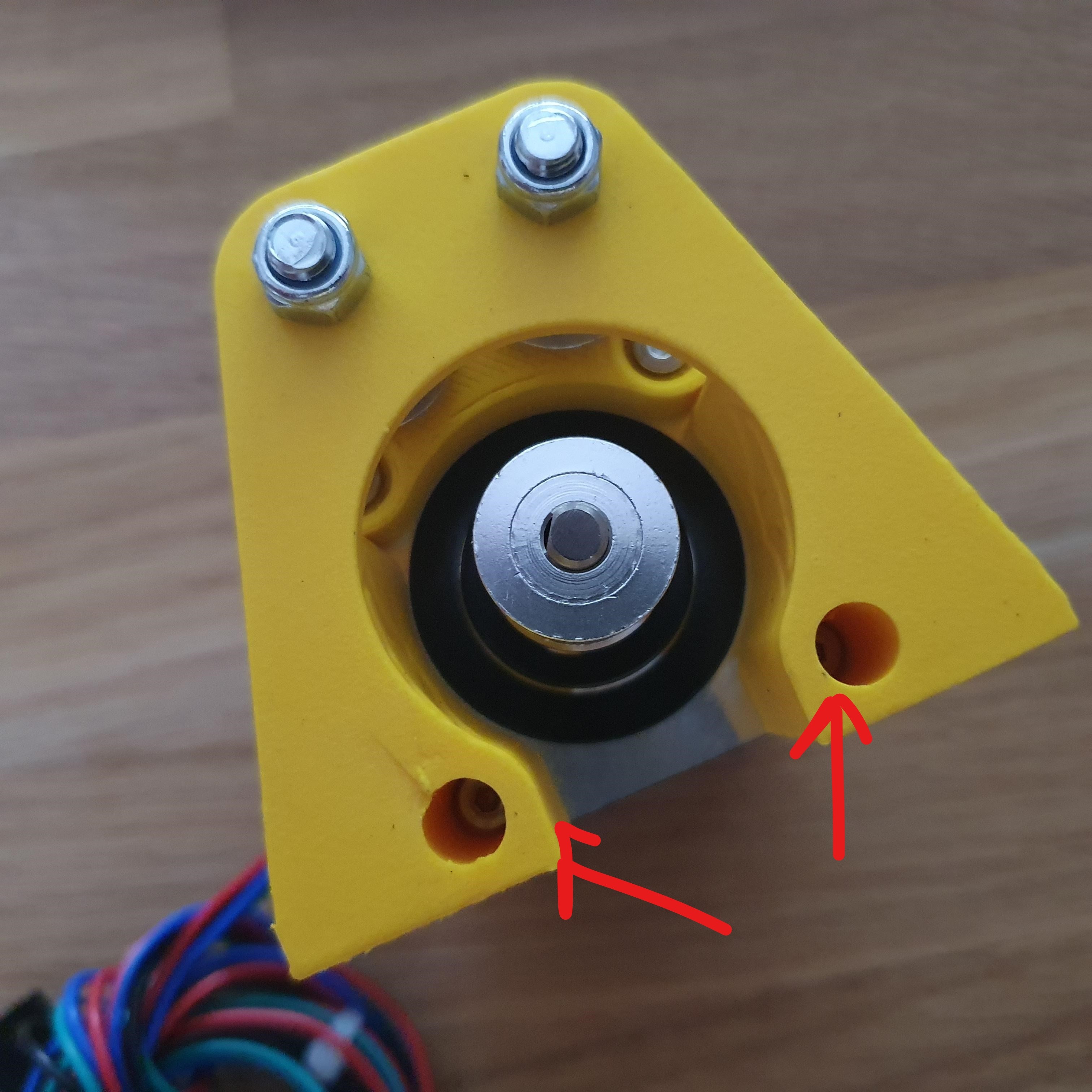

During install I found it hard to install the motor cover on the Y-plate. I was lucky to find a screwdriver just long enoug to reach the end.
I was also a bit surprised, that the pulley had to be mounted very low on the motor shaft, I previously thought it would be installed on the D shaft to have a good grip. But it seems to be alligned lower then the D shaft. So will have to check that it´s alligned correctly when installing the belt.
