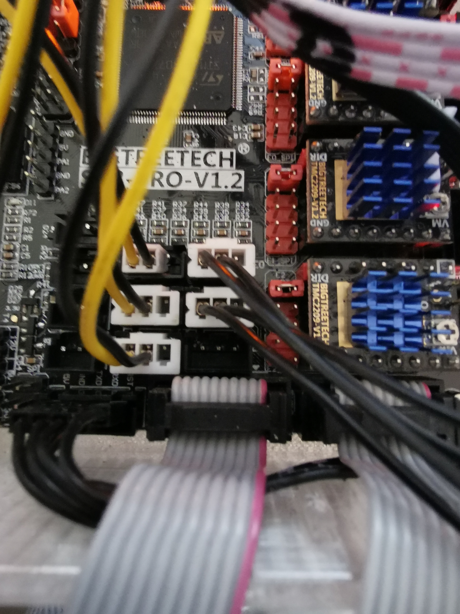

the endstop connect

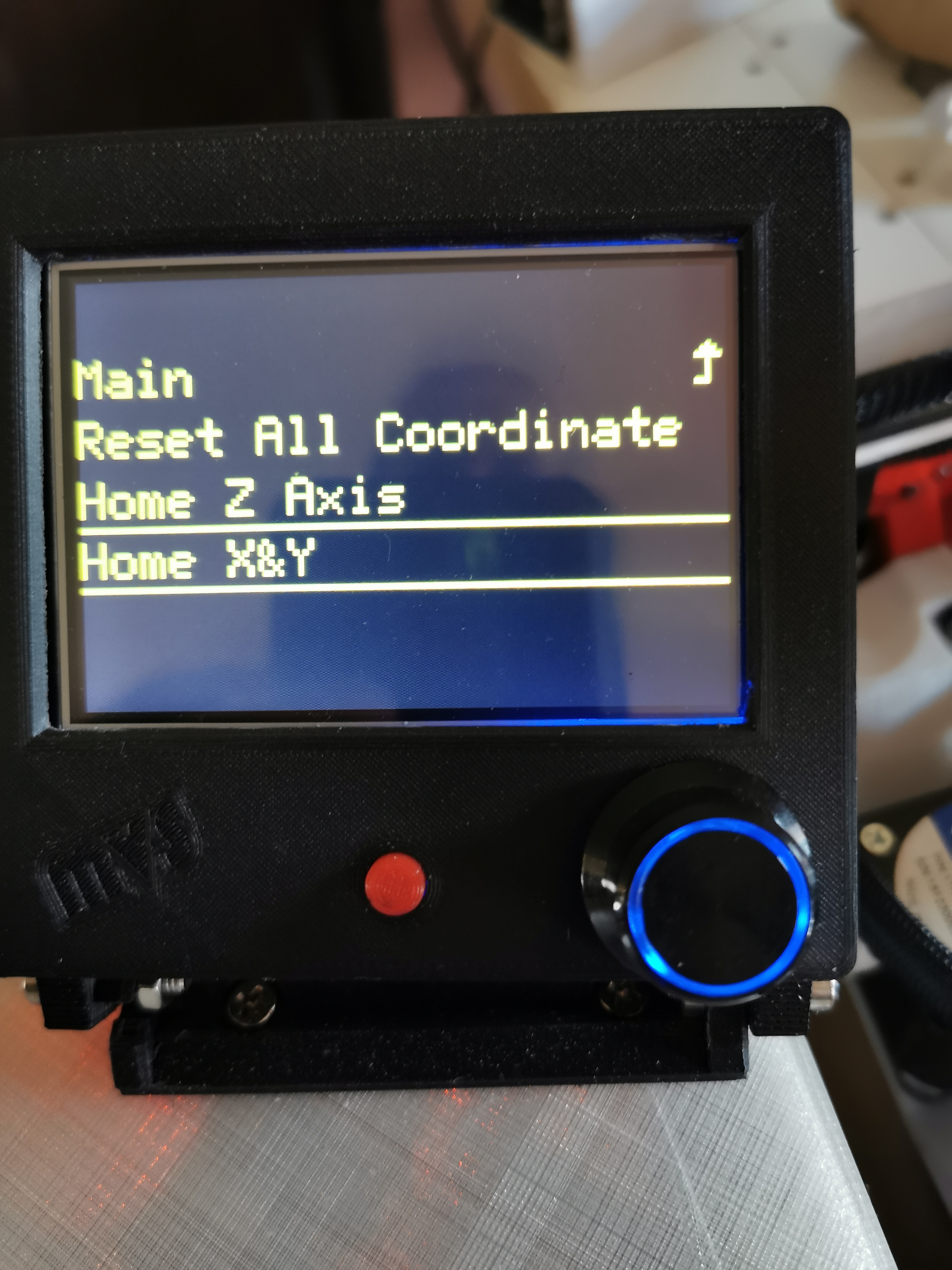

try to home all axes 1 by 1 not working but i think i found why in the configuration.h there is an error i think line 665 #define Z_MIN_ENDSTOP_INVERTING true should it be false ?

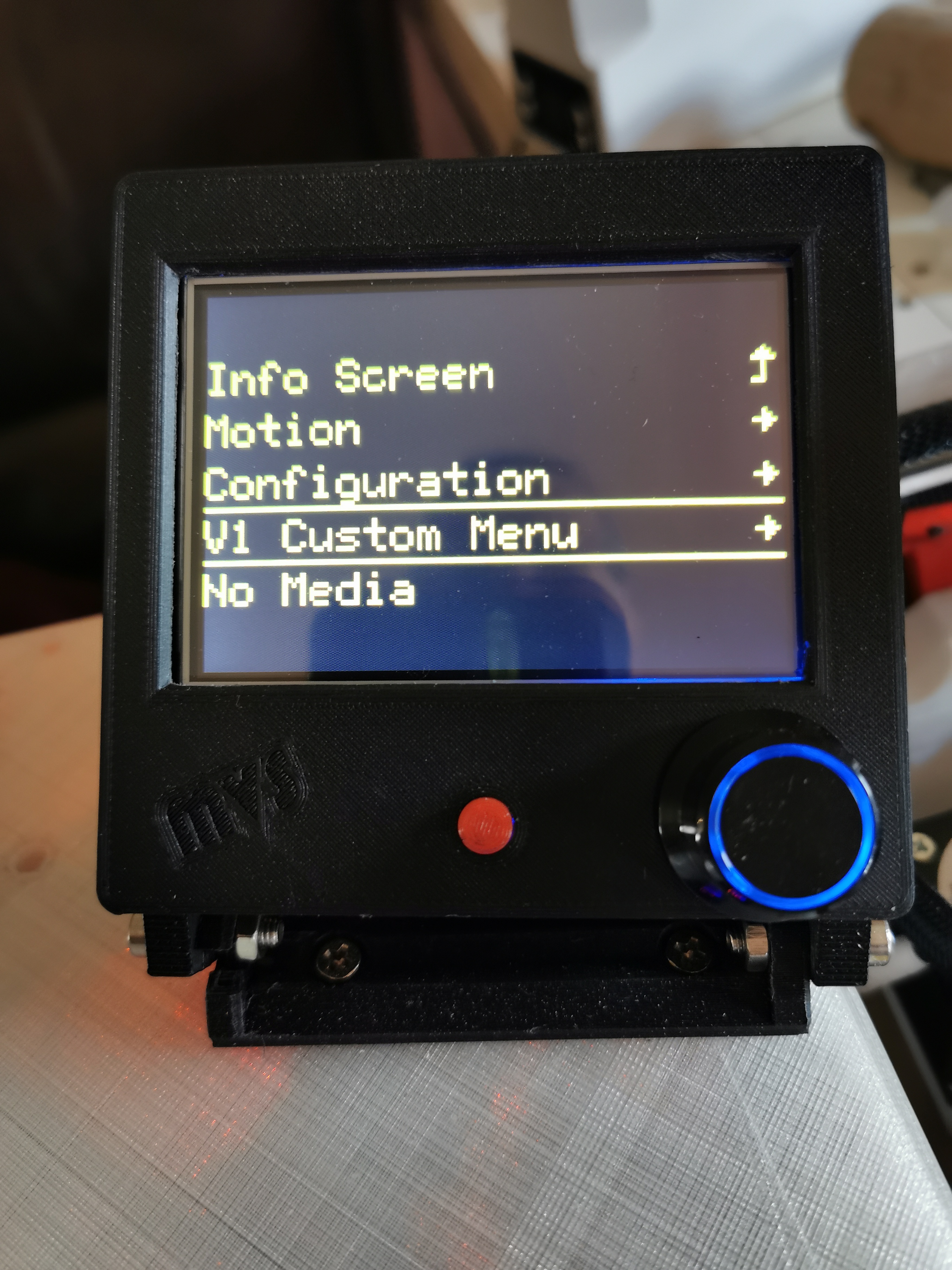

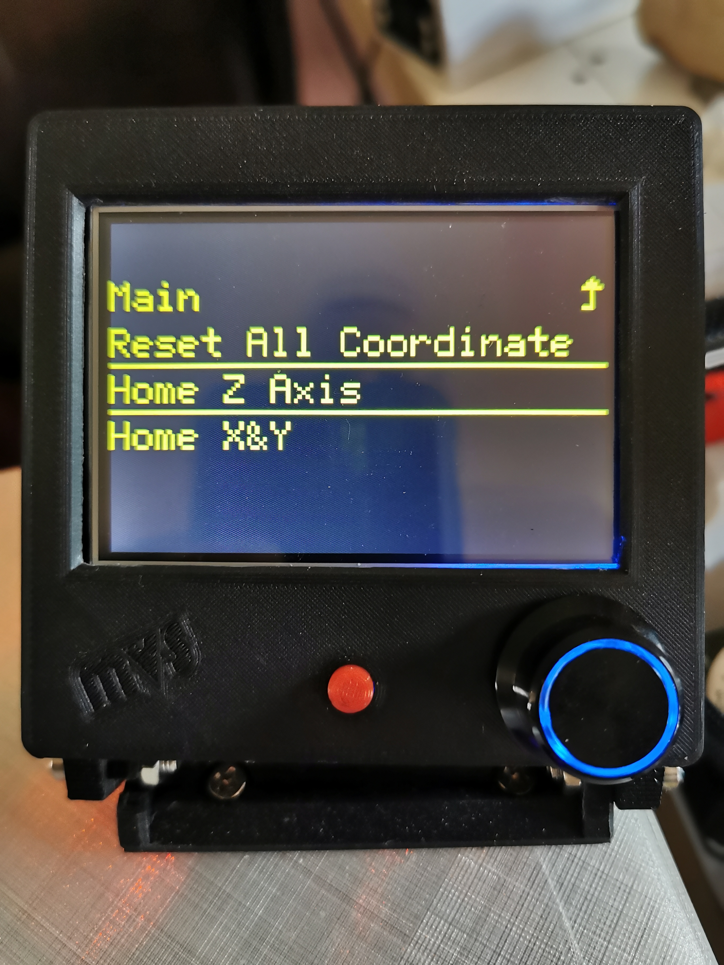

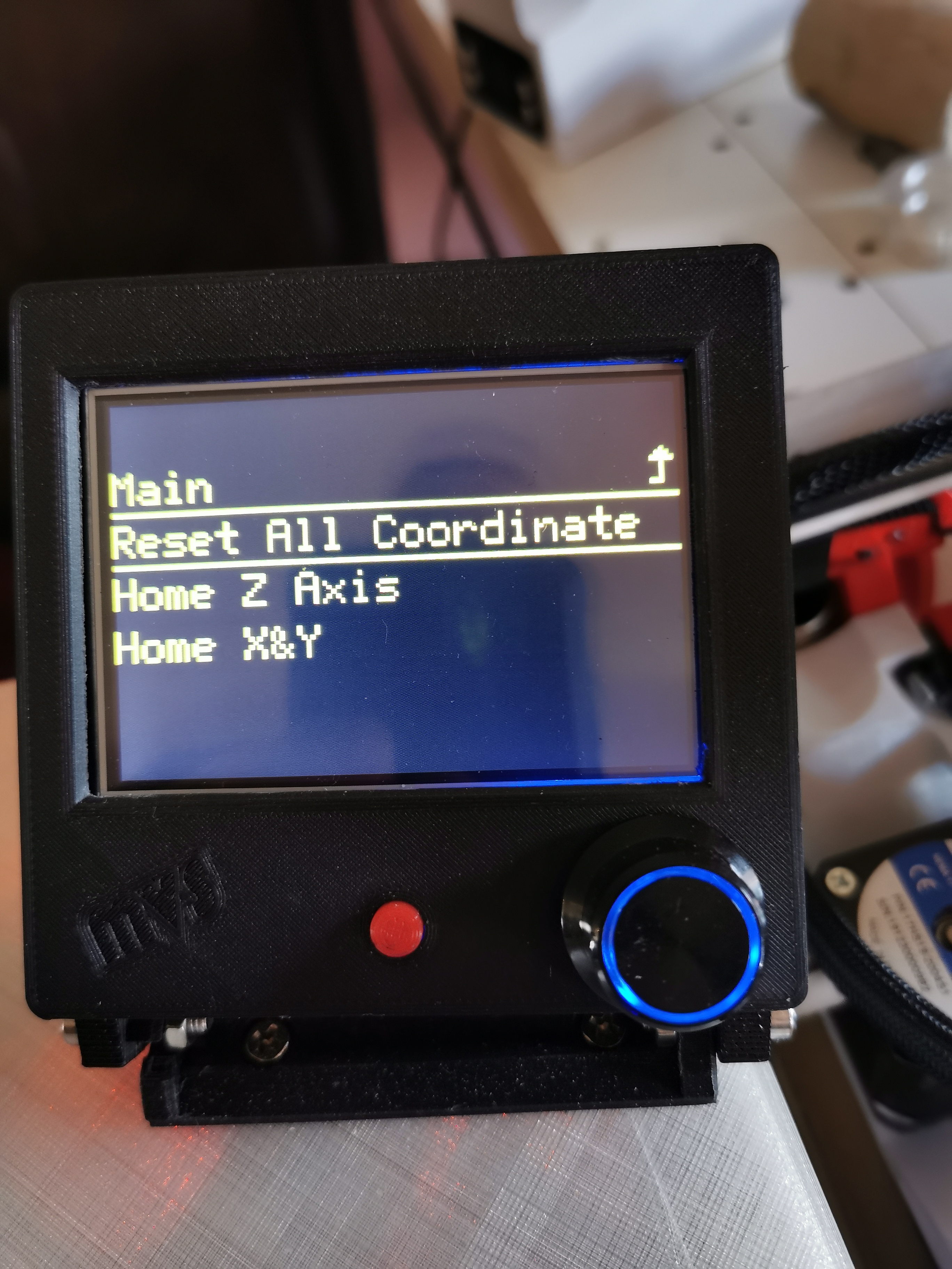

the homing in v1 custom menu is nto working good

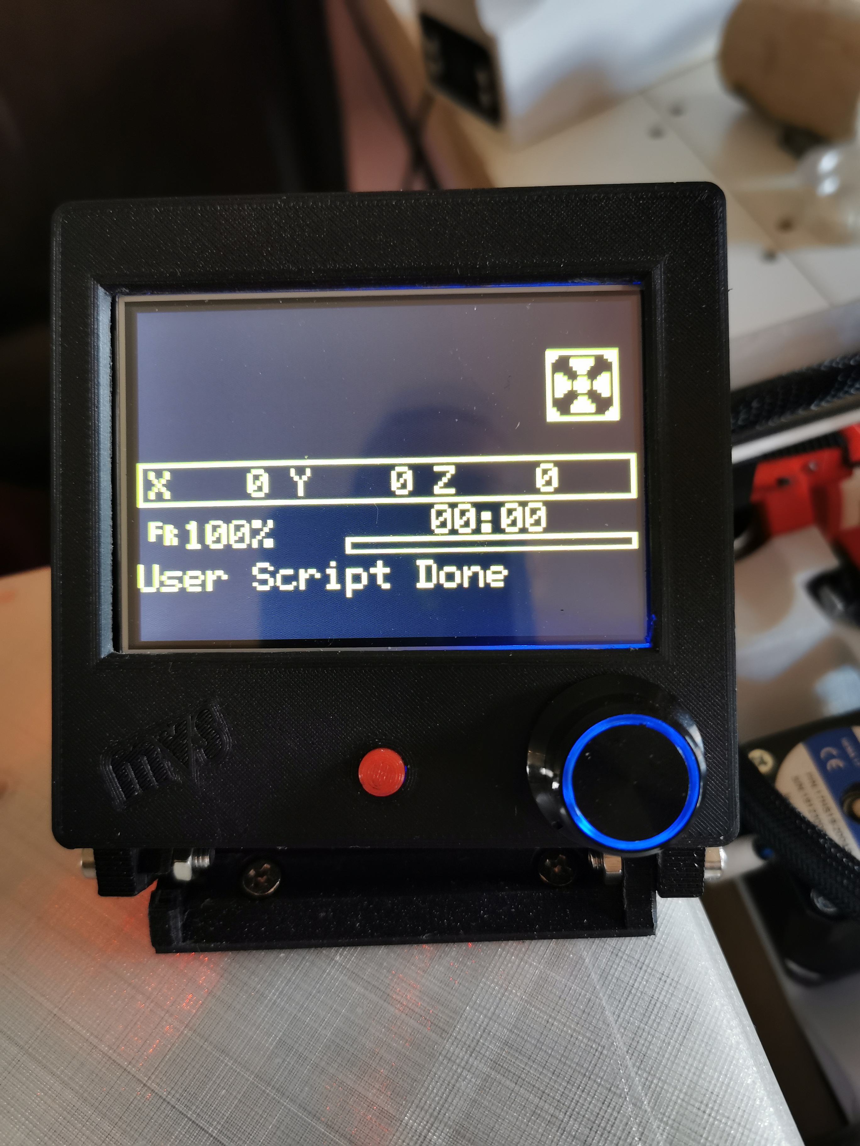

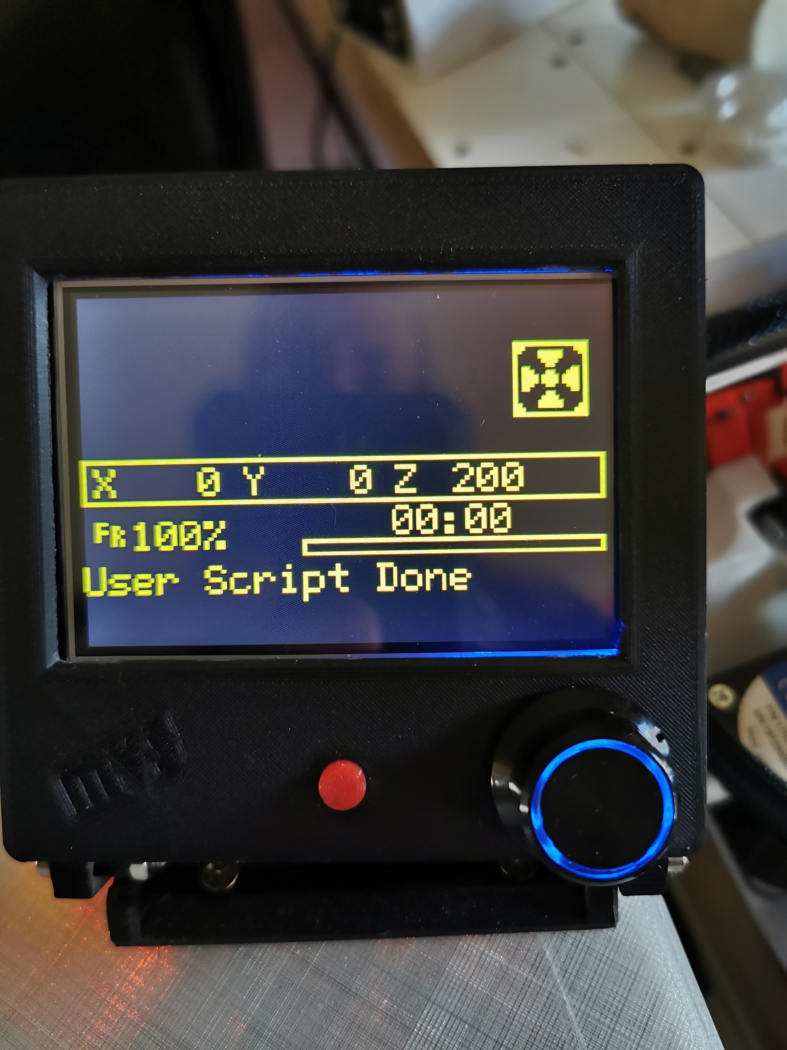

after homing Z axis and home X&Y
back to main screen screen the X=0 Y=0 and Z=200
and when homing X&Y only the left Y move both direction the right on move only one side but if i just go in move axis Y both axis work good
Looks like you wired your endstops incorrectly. They should all say open unless the switches are triggered. The Z min is the only one that is correct.
You should verify one at a time to make sure they all work.
Hold one switch and run M119, when you are holding it it should say triggered, and not holding it it should say open. Repeat for every single switch.
Oh I take back what I said about which endstops plug into which ports. What I said was probably not correct, or at best, out of date. M119 will tell you for sure.
This firmware should use this for endstops. I can see the Zmax port is not populated.
That line should be right. The z min is for a probe, which is normally open.

I finally fix X and Y they wasnt plug good
the Z i realised the configuration is set the opposite way i was thinking
if i understand good the zhome is set to go at 200 up !
i had my 2 endstop on the bottom at 0 so it caused few problem i will have to try to find bracket to change my 2 endstop !
and i will have to configure the bed one way to set it to x1220 y 1220 z200
because when the x is set to the extreme right 1220 and i do homing printer halt probably because it is set x300 y300 z200 i think is there a way to set it by gcode ?
and i also have an error message on graphical screen scrolling unknown command m221 and beeping
