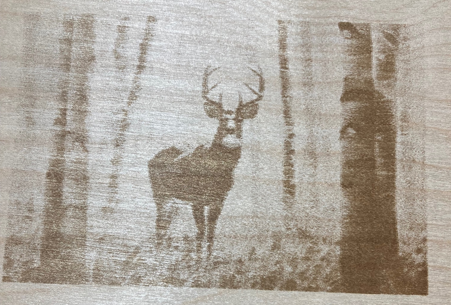

I think I have tagged it correctly. the first greyscale test ran nice no lag spikes with the usb connection.
not sure where to place this but this is probably the best greyscale testing video I have found
Making Progress, going to try an svg version next
Try running fom SD card
I use Lighburn for my Jackpot V1. I only use the Wi-Fi for 3 minute or shorter burns, anything longer upload to SD card and run from pendent. I have ran 8 hour burns successfully many times 15,000KB files. The amount of code is to much for laser engrave on a picture changing power every 0.1mm on a grayscale image it overloads the buffer. your asking the Wi-Fi to send a lot of code for a very short distance

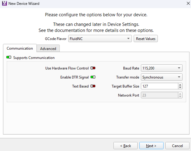

  2. Change machine settings in MillMage -
      1. I typically try to only change one setting at a time but changed three settings on this screen just before it started working for me (I was frustrated and abandoned the scientific method :joy:)
        1. Enable DTR Signal (thanks to another post on the topic addressing using Lightburn over USB)
        2. Switched off Text Based
        3. Changed transfer mode to Synchronous.
        I don’t know enough about these settings and software communication protocols to know if one or all of these contributed to today’s success. Perhaps someone who knows more can chime in.

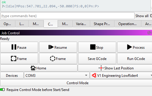

  4. I also was getting several alarm codes in MillMage. Most common was:
    1. Grbl 1.1h [‘$’ for help]
      MSG:Check Limits
      MSG:'$H'|'$X' to unlock
      MSG:Caution: Unlocked
      ok
      ?<Idle|MPos:0.000,0.000,0.000|FS:0,0|Pn:Y>
      1. In Grbl/FluidNC, Pn: stands for “Pins,” and the Y means the board thinks your Y-axis limit switch is actively pressed or triggered. I rebuilt my wiring harness for the endstops and never was able to get rid of this.
        1. I believe it was power coming over the USB that was making the Jackpot think the endstop was pressed or triggered. Based on what I read, the boot-up sequence probably was what helped fix this problem. I tried to address the problem with the 1500V ADUM3160 Module for Digital Signal Audio Power Isolator USB to USB Audio Signal Isolator. Apparently a typically USB cable carries data and power. The power is not necessary in this application and it was making the Jackpot (or ESP?) get a false signal(s). This isolator eliminates the power (?). Others suggested cutting that wire in the USB cord. I also read a suggestion to use PortaPow USB Power Blocker - Stops Charging, Allows Data. I guess the isolator does the same thing as this device in this application.

There’s a decent chance the DTR helped. DTR (data terminal ready) tells a connected device that you are wanting to talk to it. Some boards, specifically Arduinos, use a toggle of this signal to reboot them and put them into programming mode, which kind of sucks because every other device uses it to mean “hey, I’m here! Let’s talk!”
Synchronous mode means “send a command, wait for OK, repeat”, instead of “send however many lines we know will fit into the receive buffer of the target controller, wait for OK(s), repeat”.
