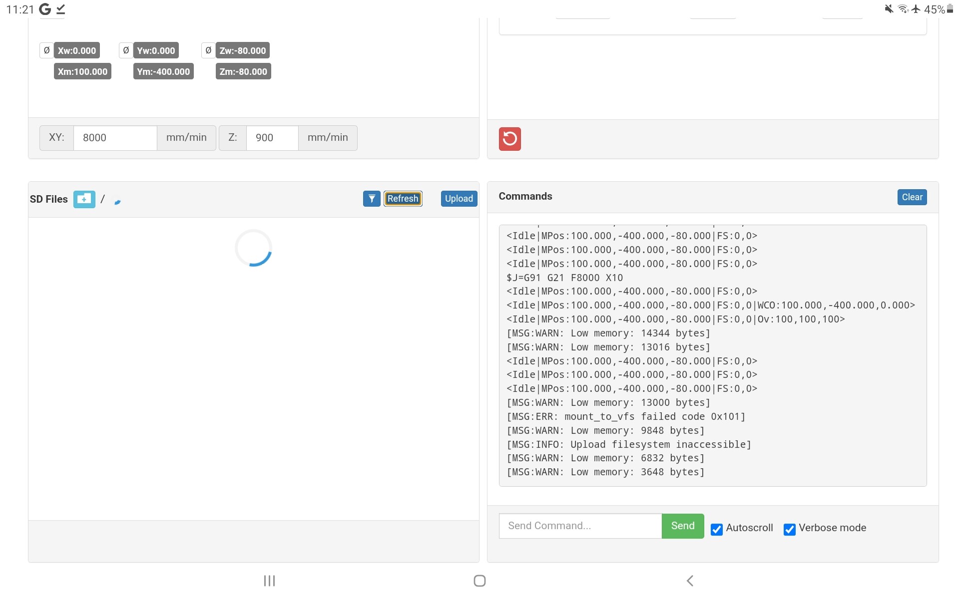

Is the jackpot supposed to be out of memory all the time? I finally go the lead screw delivered yesterday so all the axis are functional. But it’s just sitting still and giving me out of memory warnings, no files loaded and not trying to run anything.

A new update came out a couple of days ago. Update your firmware and your out of memory errors should go away.

Latest FluidNC release has indeed fixed a lot of issues, it’s much more stable…

Concerning memory, setting “Sta/SSDP/Enable=false” helps a lot.
You will need to access your interface through IP if you do this though

Upgraded firmware, still doesn’t work. It only allows me to upload very small files. It’s stopped showing the warnings but it fails at uploading at the same point. Very small files go through, anything larger and it starts throwing failures. I pulled the SD card and loaded it manually and the file runs without an issue, so it’s not the file. I tried on 2 different browsers, same issue at the same point. I’m going to change devices entirely and see if it changes anything. Beyond that I wonder if I have a bad card.
So the 2 big items for memory are fw version and ssdp both posted above. I see you said fw upgraded, assume it is 3.7.11 if so did you turn off ssdp?
Are you running the config file from the V1 repo? AP or STA mode?
Probably best just to post your config file here, as is, if you have any changes at all from the default.
Also make sure only one device is connected and loading the Web UI. This will have the biggest effect on memory usage.

It’s 3.7, downloaded it earlier. I set SSDP to off tonight. I don’t see false as an option but I’m assuming I’m in the right spot. What do you mean it has to accessed through IP? Probably a dumb question but how am I accessing it now?
Mike:
I’ve not touched the config at all, hadn’t even opened it until tonight. But I know a future question was going to be about setting soft endstops and it looks like that one is pre-emptively answered. I’m running in AP and only connecting to it with my tablet.
Anyway, I’m using a 28m gcode test file, so not huge. And after watching it fail over and over and over at 4% upload, and many reboots of the card and interface, it finally loaded the entire thing. Then deleted and loaded it again successfully. So for the moment it seems to be working correctly, and I’ll see what tomorrow brings.
