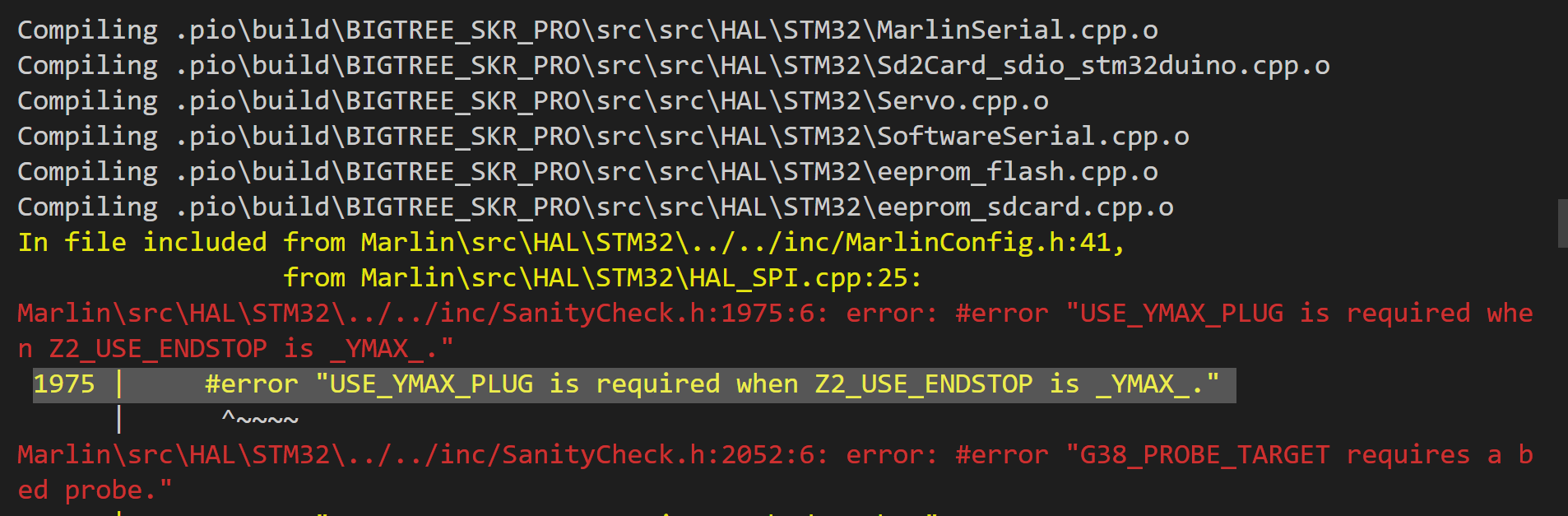

Hi again,
I made the changes you suggested, and tried to recompile. However, I get the following error:
1975 | #error “USE_YMAX_PLUG is required when Z2_USE_ENDSTOP is YMAX.”
I’ve tried to search for this setting but can’t find it.
Thanks,
Duncan
Found it. Compiling now without errors. I had also to comment out “#define G38_PROBE_TARGET” to get it to compile. Is this a major?
Duncan
If you can’t g38, then you cant probe Z.
Hi again,
Well, I THOUGHT it was compiling perfectly, until the very last few seconds, where I got the following error:
