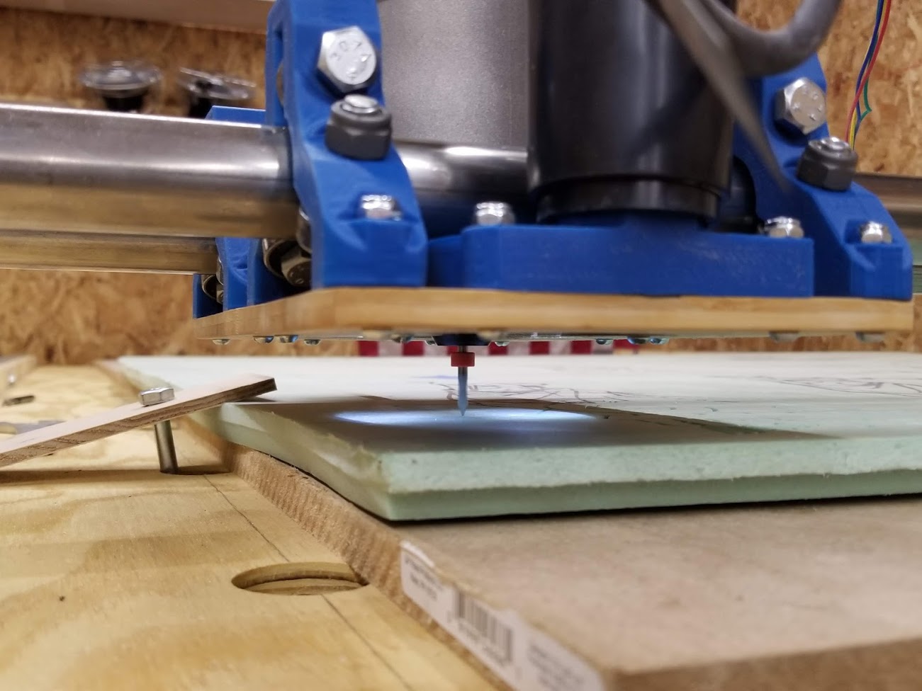

(1) Because of the sled on which the router sits, I have to extend the bit by 10mm just to clear the sled. So when cutting 9mm ply with a 3mm bit, I have to have 10mm + 9mm +1mm = 20mm bit extension - which is over-spec for the bit. The sled is also in the way, and I can’t actually see what the bit is doing during a cut.
I have quite a lot of 3mm 6061T6 sheet in the workshop - I may try cutting a new sled out of this, and claw back 5mm or so.
(2) The LR2 really struggles rigidity-wise when I’m cutting 18mm ply. For that I’m using a 6mm 2 flute upcut bit, and going really slowly with shallow passes. This requires 10mm + 18mm + 1mm = 29mm bit extension, which is again way over spec for a 6mm bit. The cut lines are clearly not perfectly even.
Other than that - all good this side… SO HAPPY about the Z-Axis steppers behaving themselves.
Duncan
I can run my router down past the plate.
18mm plywood shouldn’t be a problem. Reference Barry’s photo. The collet should be capable of being on plane or slightly past the x-axis sled plane.

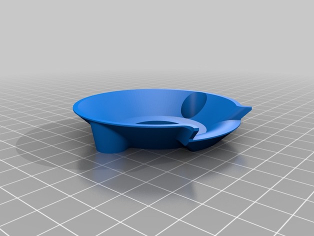

While it may or may not be recomended, I run my LowRider without the vacuum duct.b1733ef605652c28cb63c0aff09fe76e_preview_featured
I had to squish my vacuum duct down by something like 25% in my slicer before I was happy with the router position.
Mmmm… Thank you. My router gets nowhere near the bottom of the plate. Unsure why, but it isn’t due to the vac plate. The router hits the bottom of its sleeve, and that’s it… But I’ll take another look.
