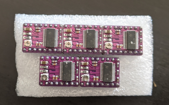

I’m currently putting together an Arduino based low cost board.
The components are as follows:
Uno R3 Board.
Source: MicroCenter
Price: $6.99
Uno R3
Protoneer 3.51 Shield
Source: Robot Shop
Price: $20.00
(5) DRV 8825 Drivers with Heatsinks
Source: Ebay - many vendors some cheaper, I chose stepperonline.
Price: $10.00
So for under $40.00 hopefully I will have a 4 axis capable machine running GRBL 1.1 and be able to run OpenBuilds Control software as a bonus.
I’m doing this more as an experiment, I already own a genuine Open Builds Control system, and am happy with it.
I’m just thinking that this might be a budget intro control board for someone just thinking about a conduit MPCNC.
