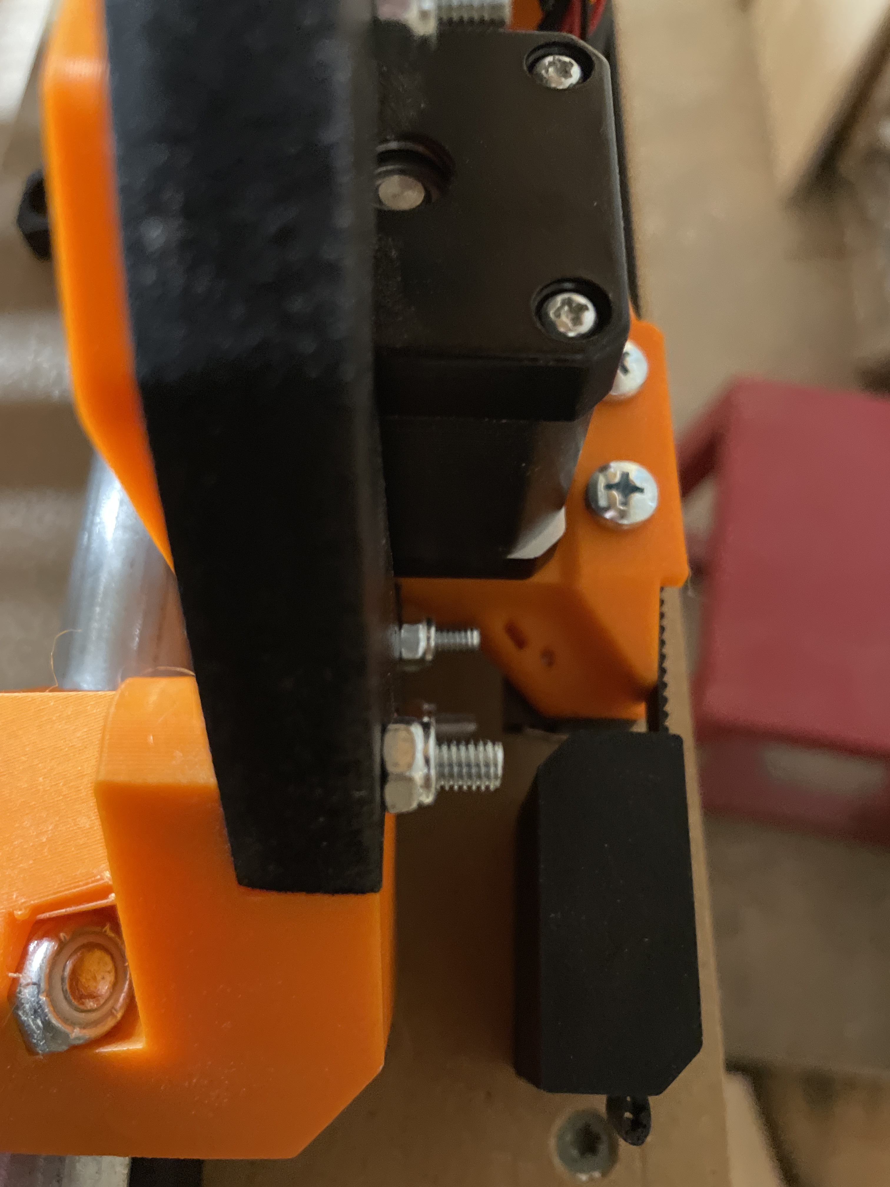

Ok. Both plates replaced and looks better, but I’m still have a little bit of an alignment issue…
It’s like my YZ plates are not parallel with each other still.
This one has more outward pressure on the belt than I think it should.

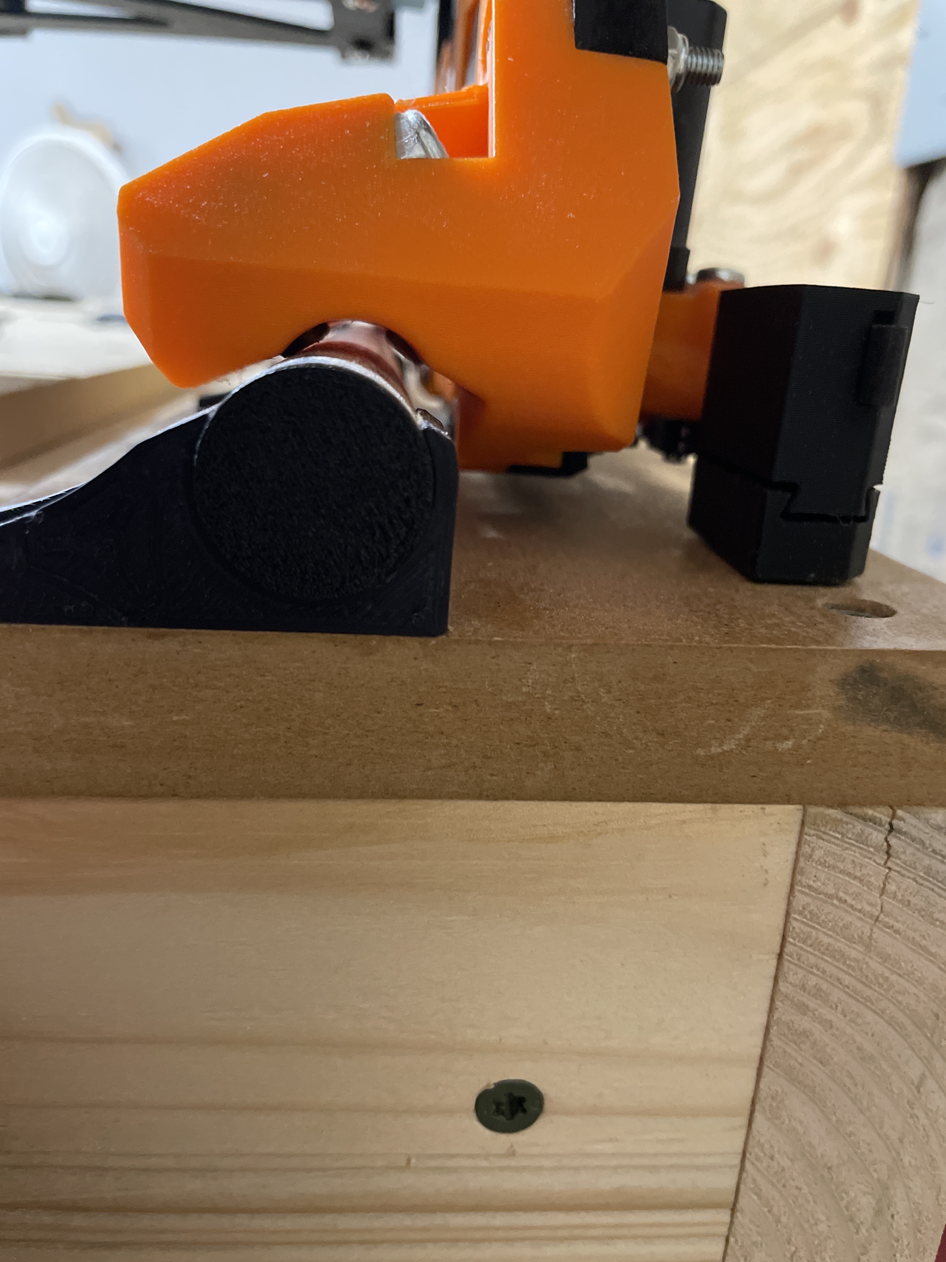

And this one is not riding square on the rails….
And has some outward pressure

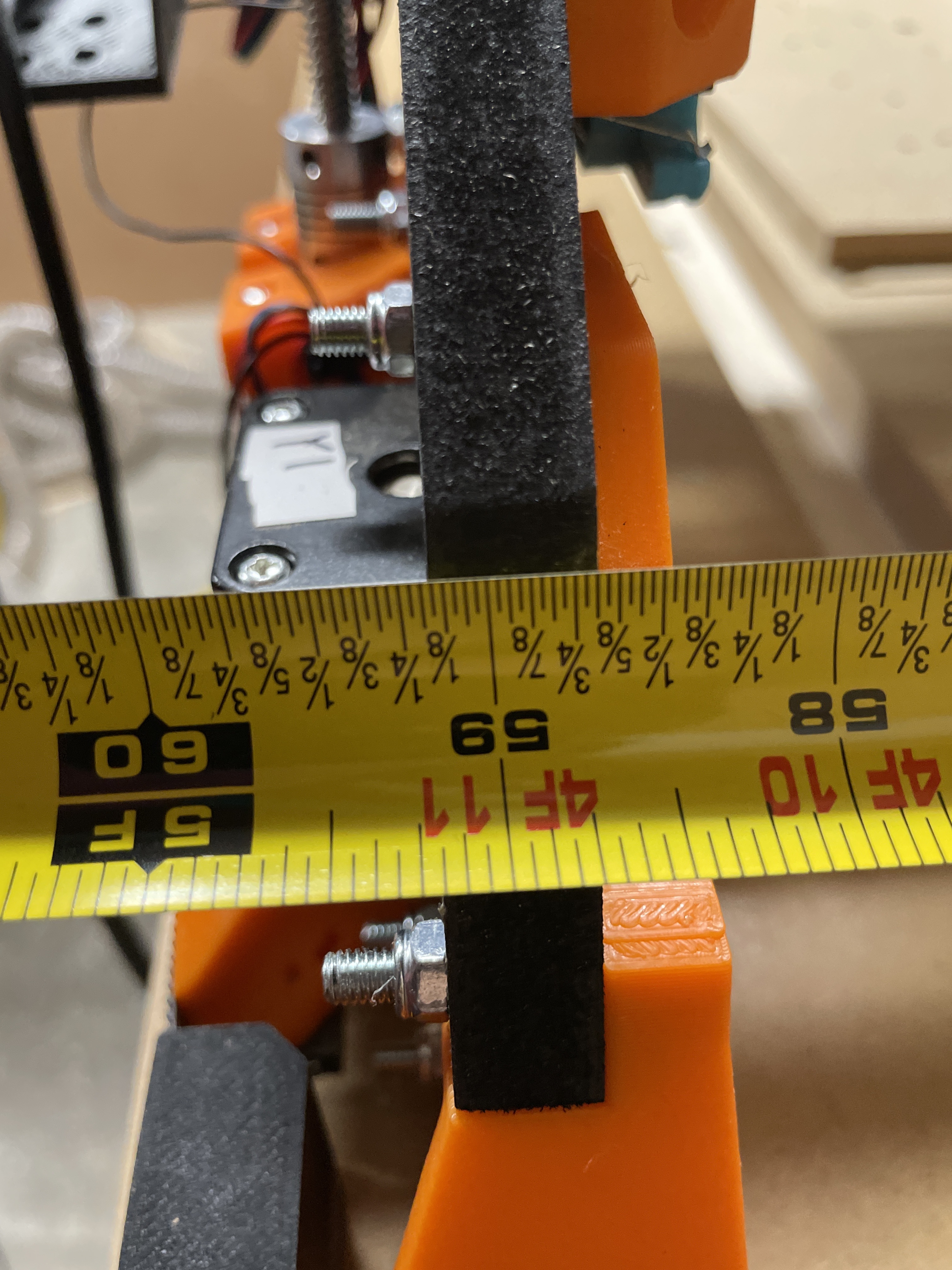

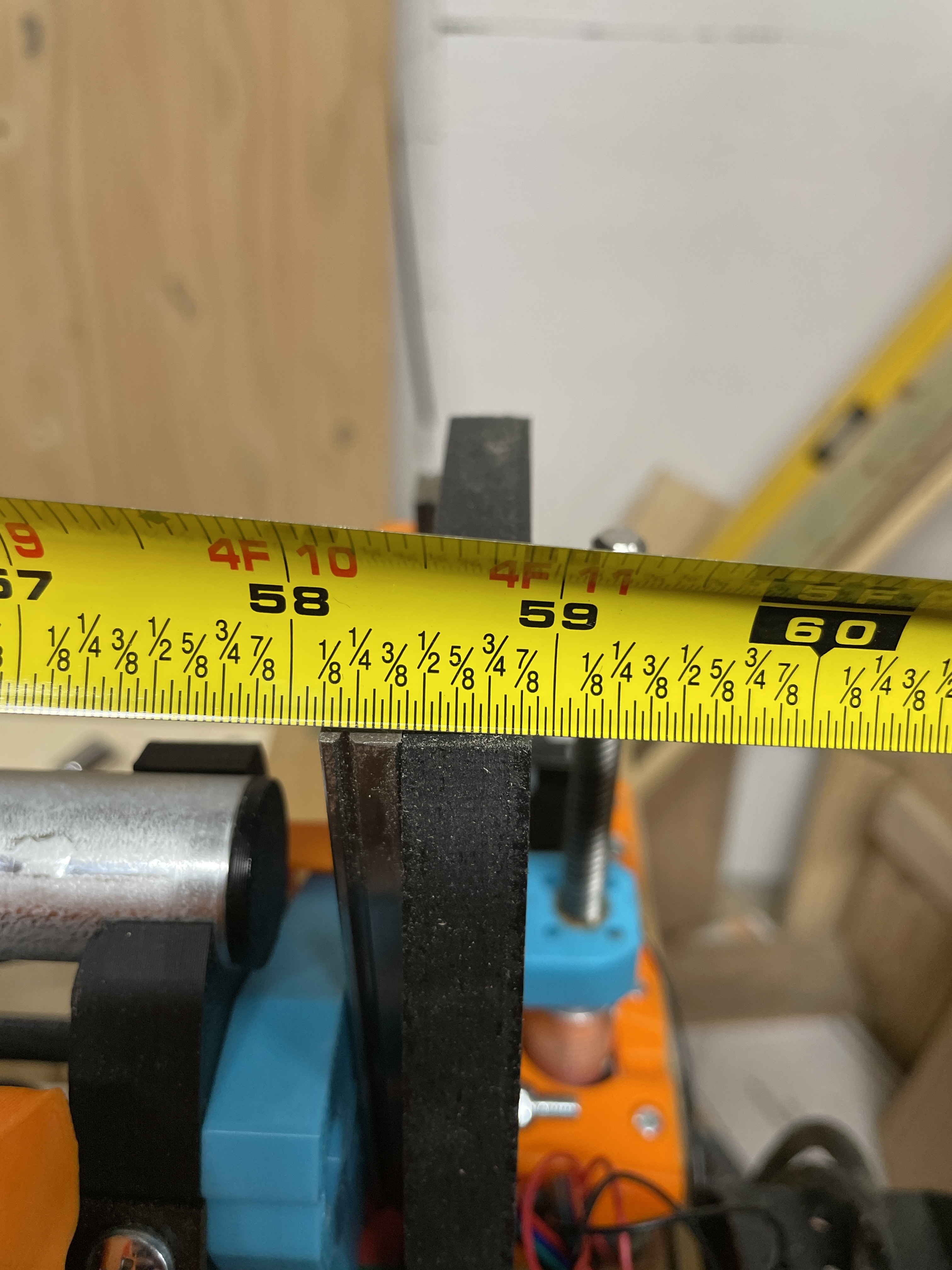

Checking measurements…
I’m not real sure what to check or where to start…
Are the MDF plates wider than your printed plates? Never had the printed ones so I’m not sure. If they are then that will cause your push out on the belt. You’ll need to adjust your X0 side (non rail side) over just a touch to make up for the extra width.
As far as it not being the same measurement that could be your outside 2 braces not sitting square on the tubes. or you have one/both tubes just a touch too long.
Plate thickness is the same.
It’s hard to get a tube measurement right now, but I was pretty careful to make sure they were both exactly 56 1/4”.
Its usually better to cut them a touch short also verify all of your struts are the same length
Struts being wrong is the next thing I was thinking. I can see that the XZ plate is kicked out, but the screws are as tight as I can get them in the brace and I can’t move them because the strut plates are there.
Not sure if that comes through in the picture or not.
