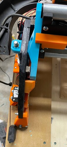

Well……that was fun while it lasted….
Haven’t messed with the machine for a few days. Went to the shop to go ahead and square it up.
Powered it up.
Home Z. Fine.
Home Y. Grinding noise…
Not sure what happened, but the printed YZ plate almost looks warped. It definitely moves easy in and out, and the linear rails seem like the screws aren’t holding good anymore.
So I guess those MDF ones won’t be sitting on a shelf after all…
