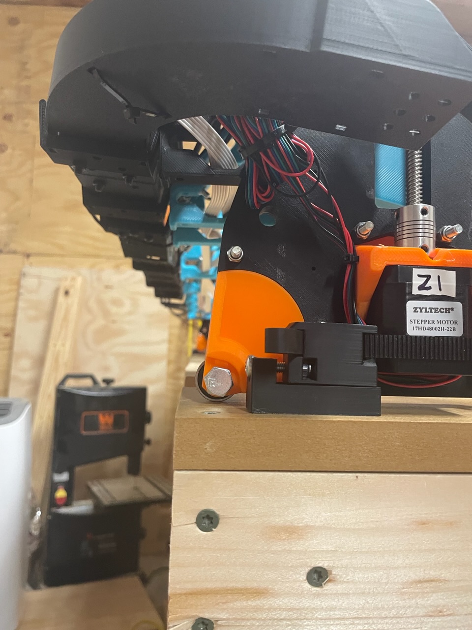

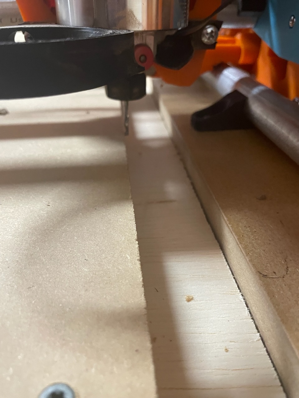

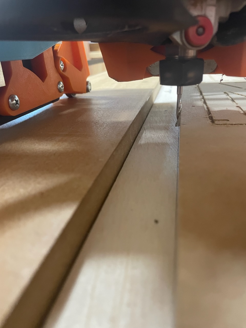

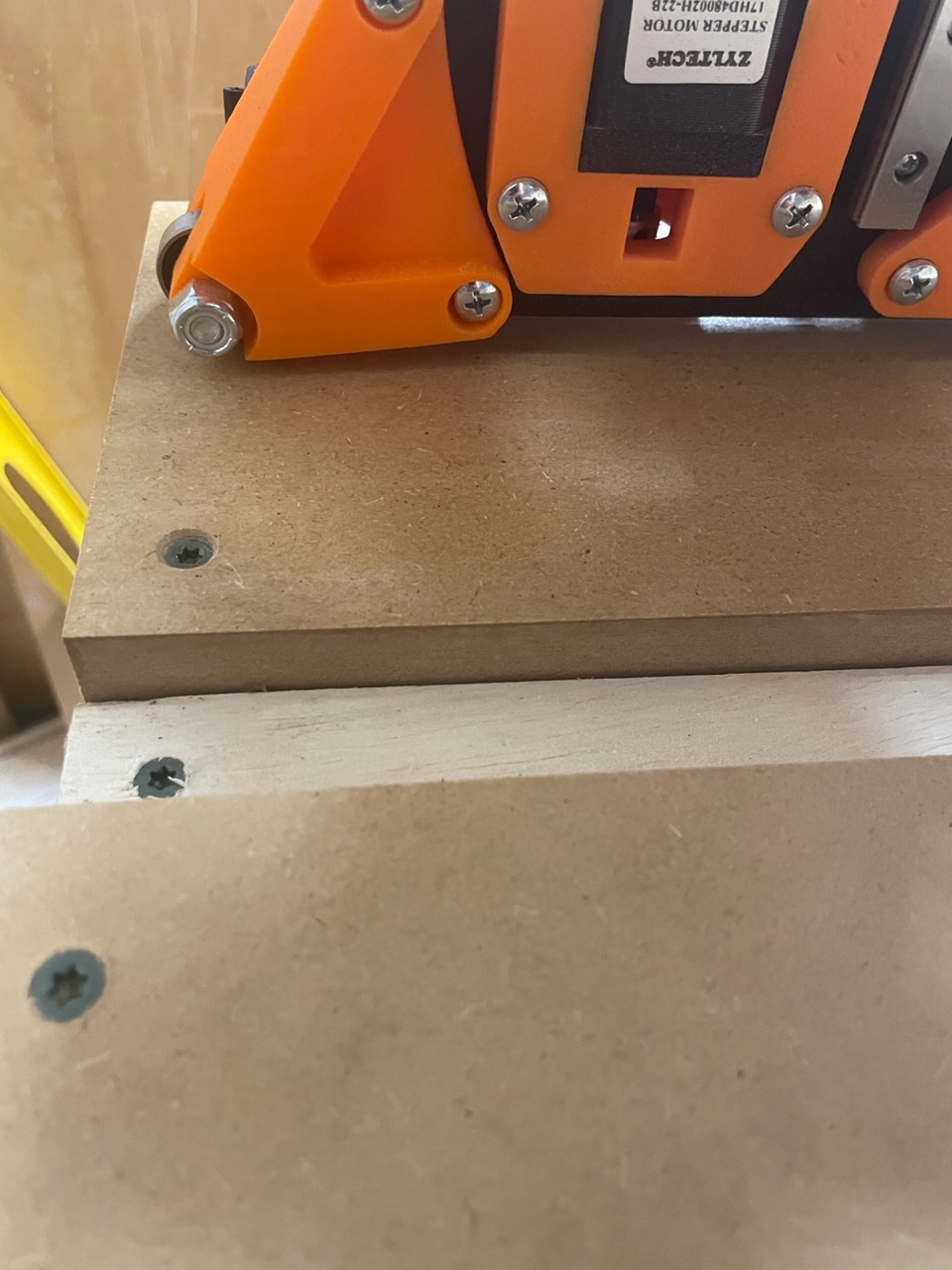

Ah, I think I have it set to have the hose hangers at the edge of the table at Y max, not the wheels. That should explain it.
I didn’t figure you would. I was more concerned the calc was wrong.
I actually have right at 1620mm before I risk missing steps, but will treat it as 1600
For X, it is 1248 exactly….impossible to get it any closer lol
And my 1/8” bit sits just on the outside of 49” MDF
For me, I only wanted to make sure I had at least 48". The extra 1.25" in the calculator was just to make sure I could address full plywood sheets. For anyone wanting full MDF, I might go slightly wider to be safe

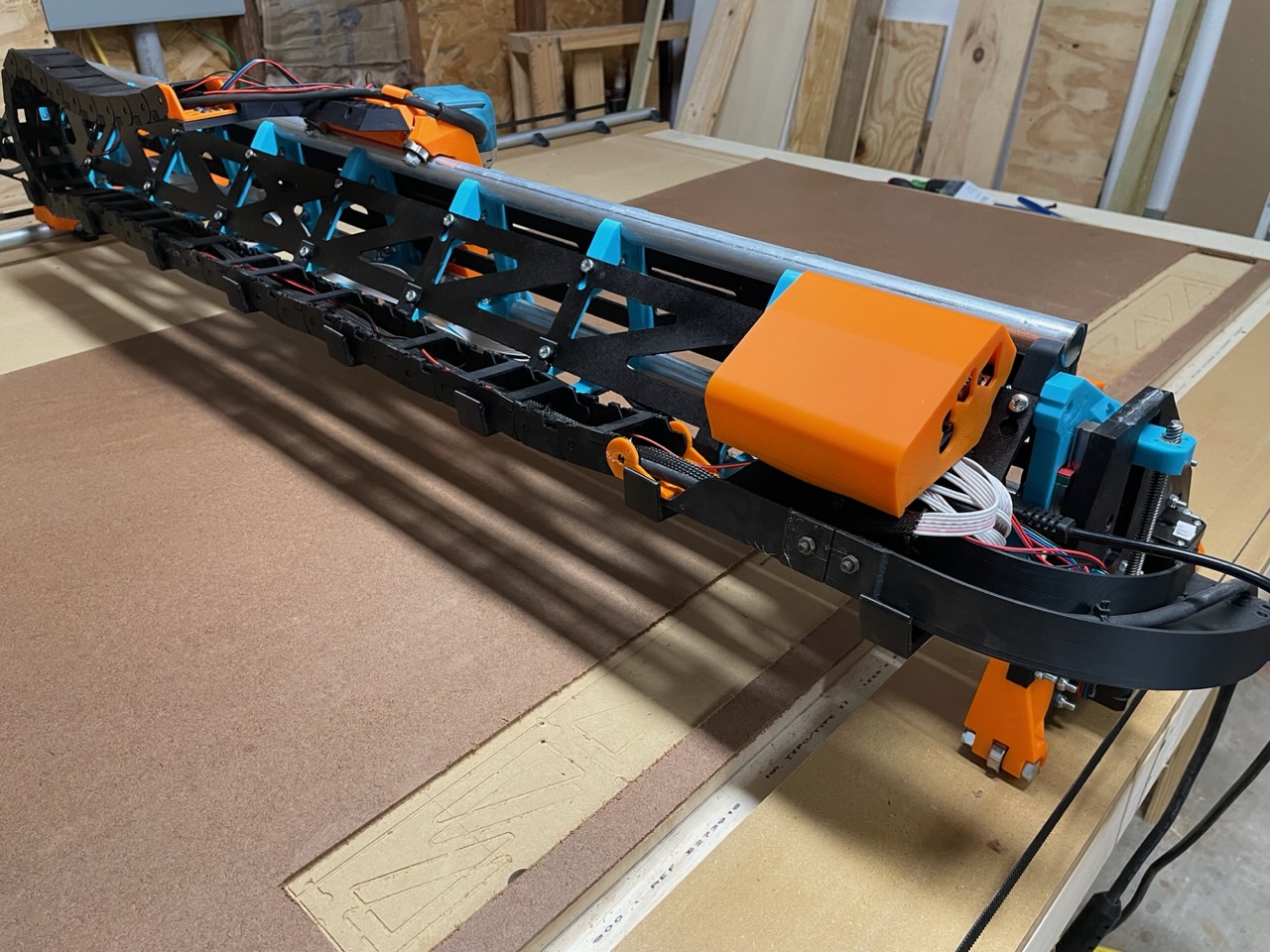

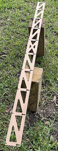

First strut ready for paint
Nice!
Alright…is it dirty enough yet to count?
All 3 struts cut and painted. Will try to get installed tomorrow
Yep, that counts as “Dirty Enough” — But I don’t recommend getting a t-shirt made that says that. LOL

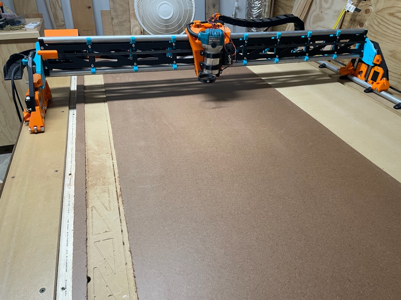

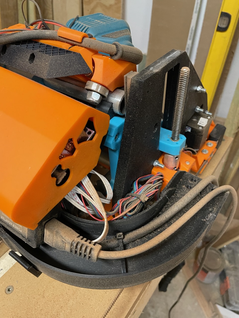

Ok. I think we can call it “done”
“Done” in the sense that all things required are complete.
Next steps:
Upgrade firmware to 3.7.8
Re-adjust belts
Squareness tests and adjustment

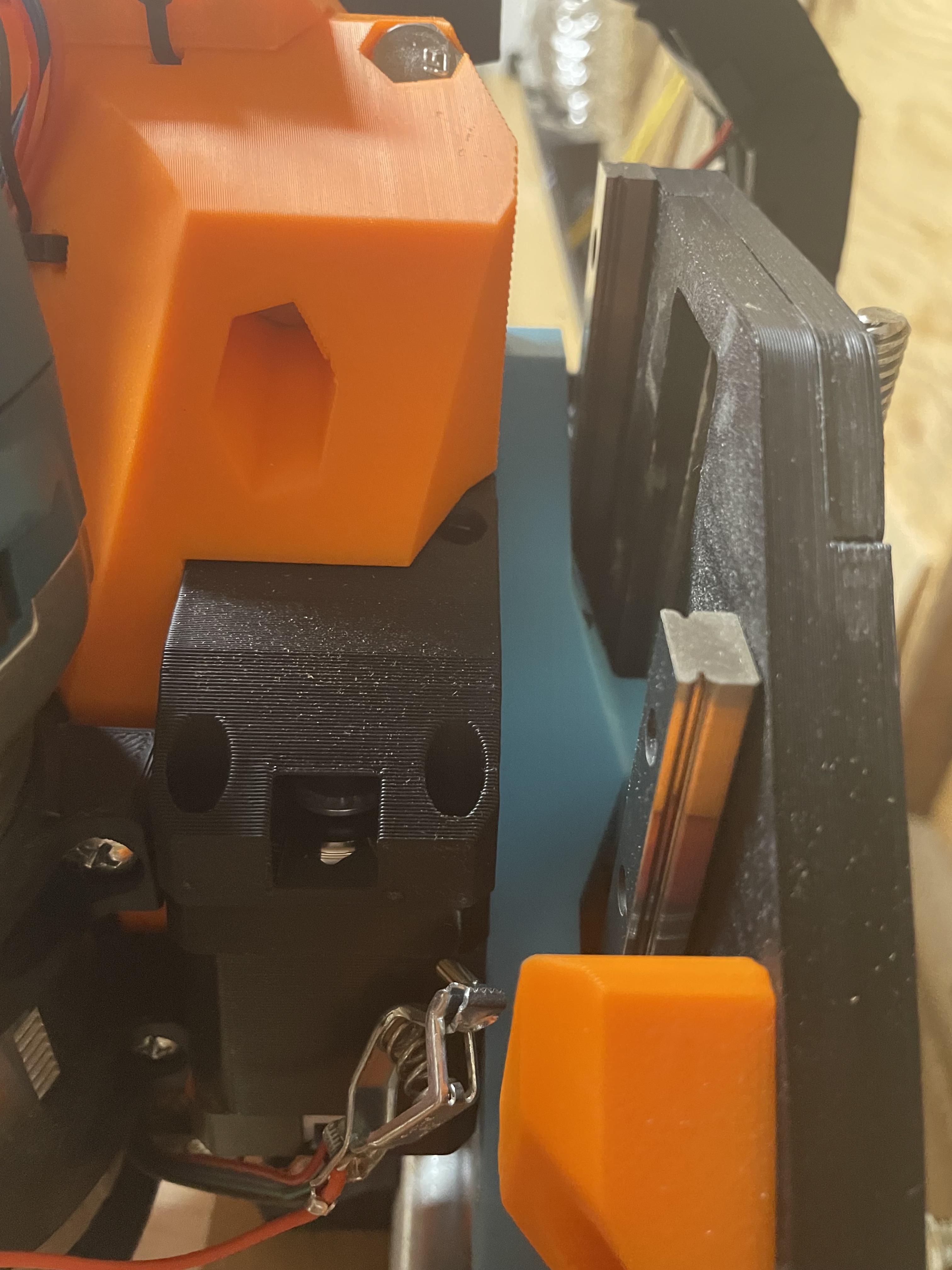

Cut YZ plates from 1/2” MDF in case these printed ones ever fail :grin:
Surface spoil board
Although it is “done”, I still have some pending modifications waiting to be done and will update here if there is anything interesting.
Next changes to be made:
Build power into table
Y cable drag chain
Add SSR to control spindle power
Kinematic tool holder for drag knife and likely future laser addition
Integrate with dust collection
Originally considered making a decorative front strut plate, but I’m not so sure I can convince myself to take that off and have to re-install it in the future :laughing:

They’ll be an easy retro fit for timber plates (just a screw fitting) but a bit more of a pain for metal or printed ones where you have to use bolts through the rail mounts. I haven’t checked to see if the top and bottom holes are accessible without dismantling - maybe they are!
