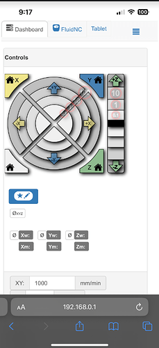

Is it any easier if you bookmark it’s IP in Safari? (default config is 192.168.0.1).
The portal redirect is a bit of an annoyance, but that should let you dismiss the iOS portal page and then just refresh Safari.
No, the portal never gets a “Done” button, so it’s the only way to be connected. All you can do is cancel to get out, which disconnects
This works fine for me on my Jackpot, with my iPhone, in AP mode. Let’s figure out what’s different. I just took the screenshot below from Safari:
Here’s how to configure iOS so that you don’t get “Stuck” at the captive portal redirect:
Go into settings, wireless. Find the FluidNC item, then click on the blue info icon next to it:
From there, I turned off auto login and auto join. Not sure which is key for preventing the portal issue. But that’s how mine is set.
With those settings, when I connect my iPhone to the Jackpot, I can just switch over to Safari and go to the bookmarked 192.168.0.1. Up comes the FluidNC GUI, no issues driving it from the iPhone that I’ve found so far.

The underlying root cause is that iOS is detecting the portal, but the iOS portal manager wants to see some kind of response from a server on an apple domain. If it doesn’t see ‘success’, then it never registers the connection as up, so the only option to the user is to cancel (which disconnects wifi from ESP32), only use the portal page to drive FluidNC (switching away again causes iOS to disconnect wifi from the ESP32), or to use the settings I’ve shown above.
