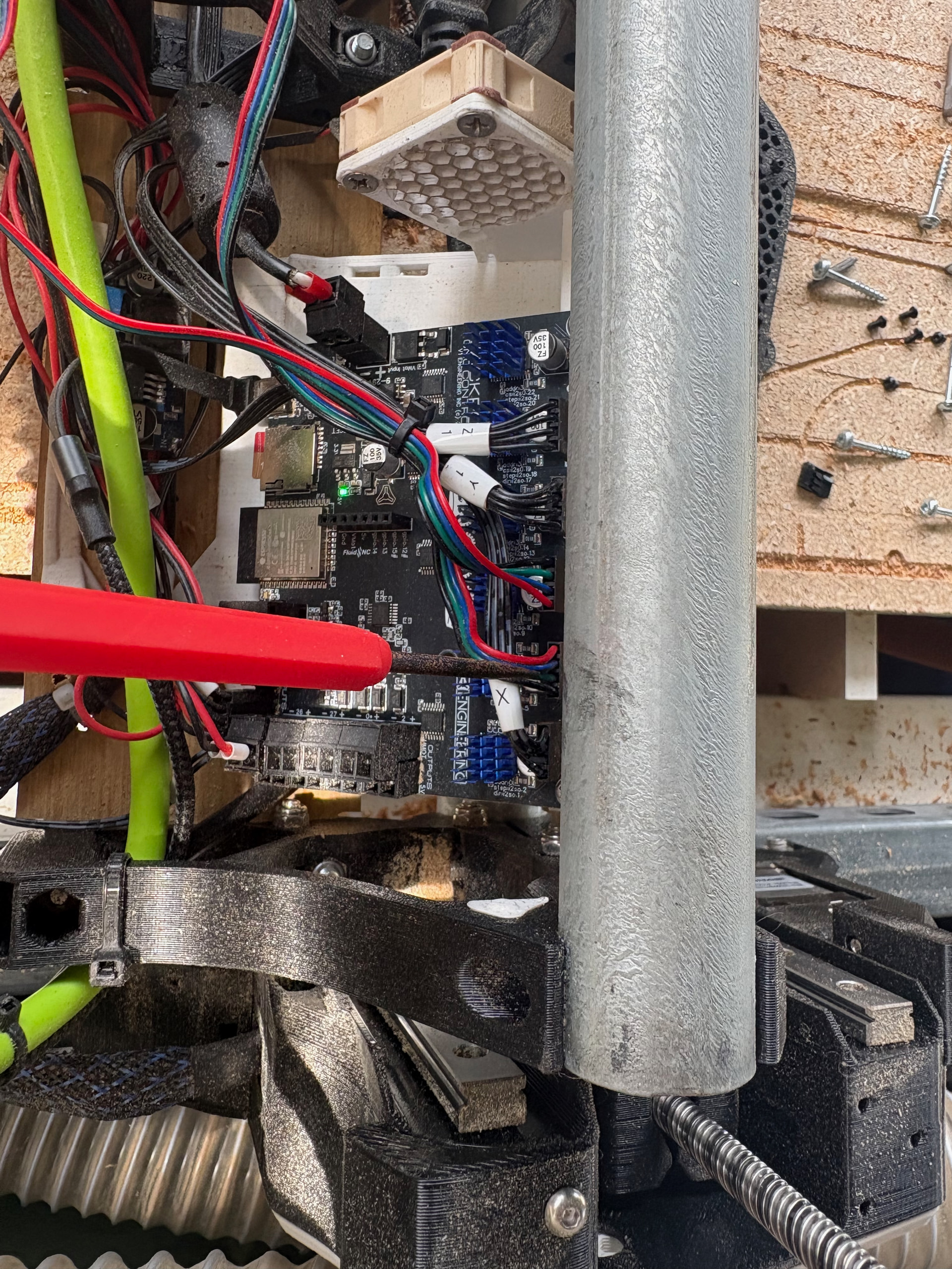

Lost power to z0 on Jackpot 3
I started randomly loosing power to this port after about 10 hrs of running the LR4. The area around the black wire on the dupont connecter had deformed.
The motor works fine when I swap it with z1, so I’m guessing its the board.
What would cause this? Is the port shot? If so, Is there a way to available connector instead?
Thanks,
–Billy
I’ve seen intermittent connections cause havoc on both sides of these style connectors.
Pull the connector and see if you can get good pictures of the contacts looking in to the connector and the pins on the suspect connector on the jackpot.
