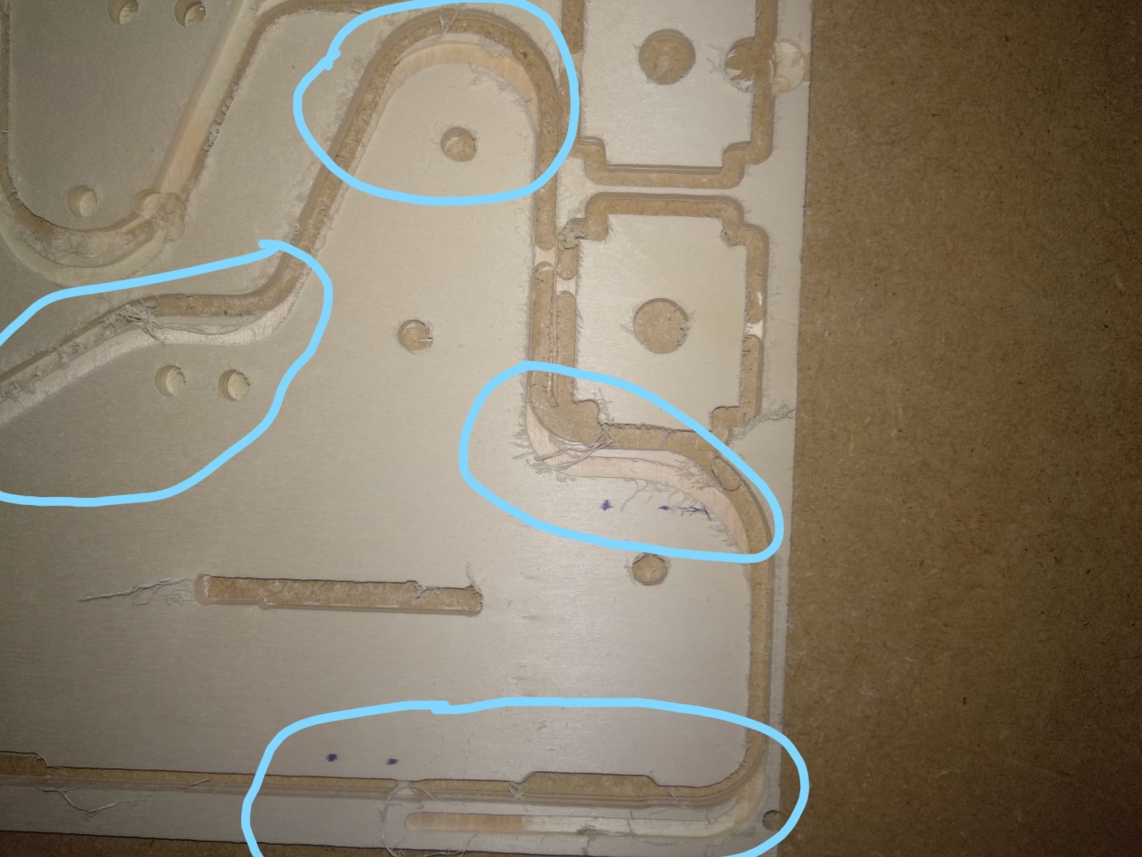

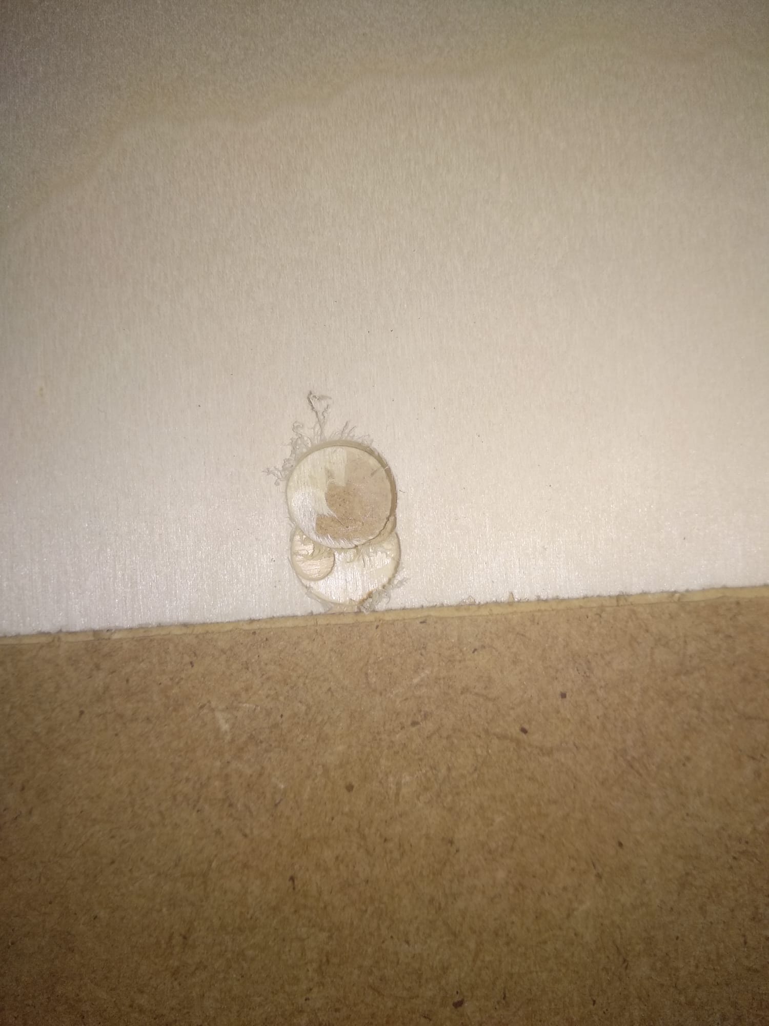

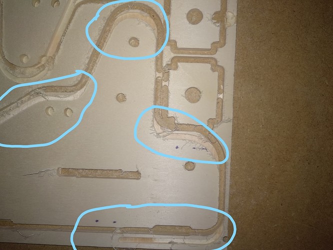

Hello, I have been a few weeks with the finished machine and I am doing tests, but in each and every one of them, both the X and Y axes change their trajectory randomly. After restarting the system and executing the Gcode again, the machine makes the correct path but after a while it loses steps again. I leave some images and a video in which it looks like when the work is finished, it does not return to the original origin, but to a 10mm offset origin
In this image you can see how the holes are not centered in the piece

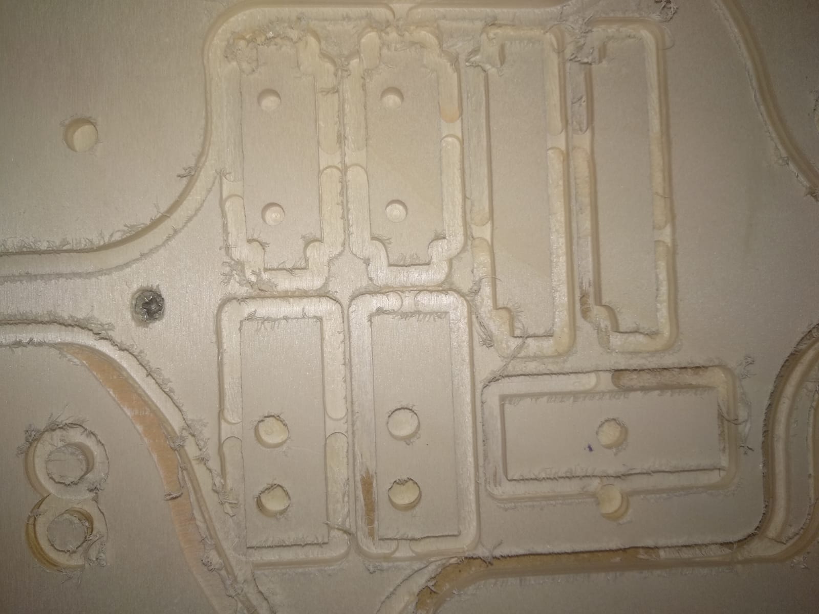

In this image you can see perfectly the moment in which I began to lose the steps in the area below

Some causes of lost steps
  • Grub screws on a pully not tight enough
  • Use of the wrong belts (don’t use steel core)
  • Too aggressive with depth of cut and/or feedrate
  • Steppers wired in parallel in a serial configuration
  • Low current setting on the stepper drivers
  • Intermittent wiring issues to a stepper
The grub screws are the #1 reason. Note that sometimes the issue is that Z is losing steps, causing larger depth of cuts than is programmed.
