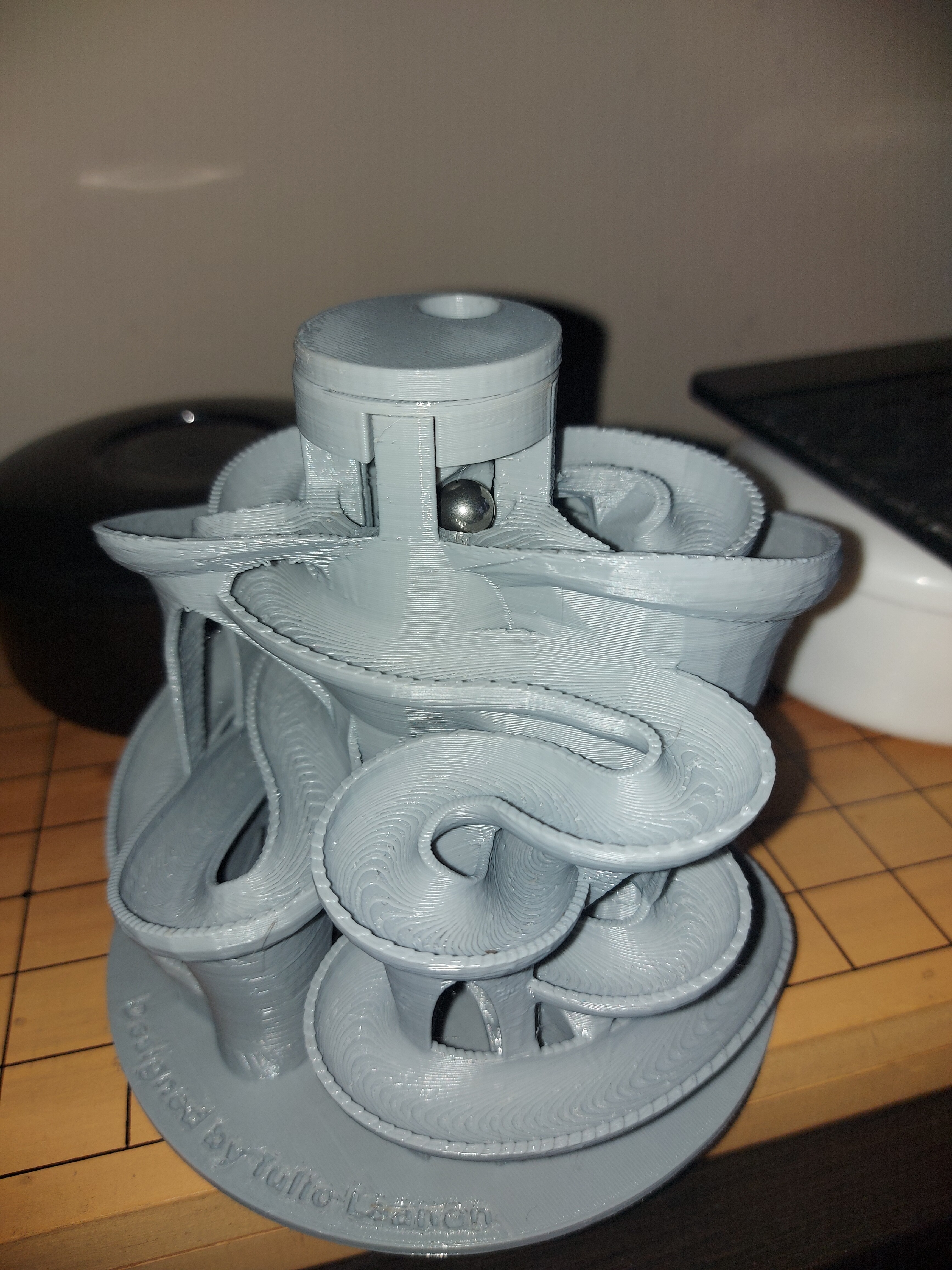

That got me looking around Thingiverse, where I found Tulio’s 3D printed Marble Machine #3 which looked like a nice candidate for the MP3DP Repeat. So I made it.
Bummer. It takes a different sized marble than the kit that I got. 3/8" (or 10mm) is what it calls for. On Amazon, I could get either a bag of 5(bearings) for $14, or 500 (slingshot ammo) for $17. I figured that the slingshot ammo was going to be more than accurate enough, and I wanted 8-10 to put in the thing anyway. Now I’ve got about 490 left in the bag…
Watched the little video on the Thingiverse file while it was printing, which led me down the YouTube rabbit hole, and eventually led to Out Of Marbles.

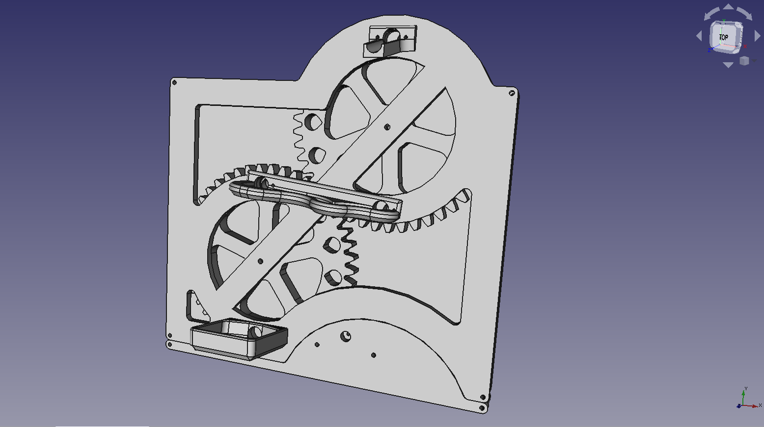

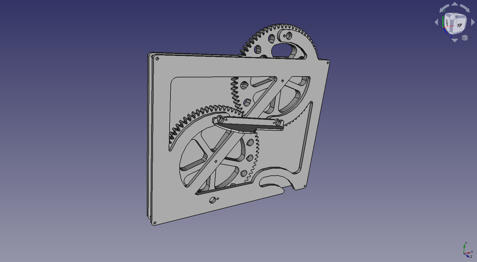

Well, I wanted to learn some more CAD stuff anyway, why not start with gears? Many of these marble machines use a gear mechanism to lift the marbles to the top of the stage, then drop them out onto a ramp. The auger for the Marble Machine is a bit of an exception, but I could probably do something using that concept, too. It would require a power take-off from the geared lift… But I’m getting ahead of myself.
I’ve also got plenty of Ikea in my house. Enough for me to have designed a PC case to go into the shelving units, so I also happen to have the dimensions for that memorized. I kind of thought that I could make a modular system that fits in there, too. So that determined the max width/height for a single module, but I still wanted to be able to stack more than one. If I borrow from the general idea that Out Of Marbles uses, so that the runs can ingterchange with the entrances and exits in the same place, then I can stack them in between however I want. Motor power (Or ceiling height) becomes the limit for how far I can stack them.
Okay, CAD time. I’m not entirely happy with the one transfer piece, so I’m going to rethink it a bit. My CAD skills are still a bit on the weak side, I know. I am getting a feel for putting different pieces together though.
So the results here are something where I can mill the frams out of 1/4" plywood, possibly the gears themselves too, or print them. There are printed inserts into the gears to hold the marbles and tip them out at the top, and I’'ve got a start on a piece to transfer them from one wheel to the other. Stacking the machines one atop the another will result in using a mirror image of that piece to move the marbles from one riser to the other, so you can just keep lifting marbles to the top. Then I need s piece to take a marble from the top exit to the start of a module, and one to take the marbles from the bottom of a module to the first feed. That will probably also incorporate some sort of motor mount to power the machine. I might also design a hand crank to come to the front of the machine. As it stands, this is meant to be at the very back of the framework. There should be a base with and without the power mechanism. Without the mechanism, it will direct the marble from the output at the top to the input at the bottom. With, will assume that the output goes into the lifter feed.

Well, that’s what the machine that I started to draw up there is for.

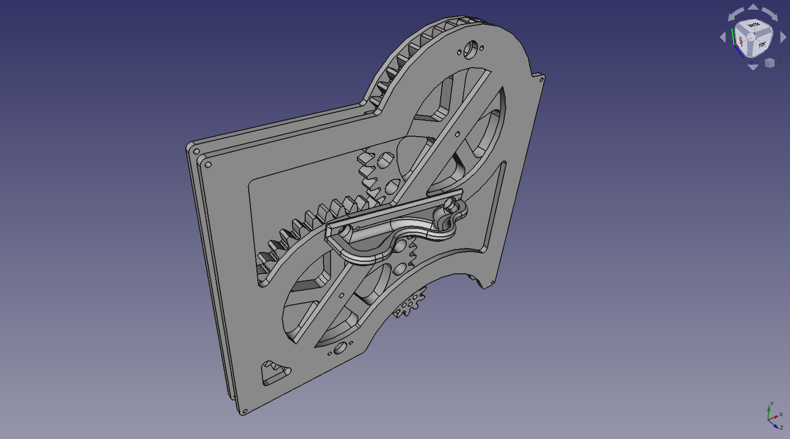

The opening in the bottom allows a marble to enter into one of the geared wheels, where it is allowed to fall out at the top. Then the (unfinished) ramp takes it to the bottom of the second wheel, where it’s lifted and allowed to fall out again.
The gear spacing is such that if the machines are stacked, this process can repeat as many times as you have the power for, or as many of the machines as you build.
I’ve got 2 bases on the drawing board. One will house a motor and another gear to drive the lifter, and the other will just take a marble from one module and take it to the top of the one below it. That’s still to be determined, since I don’t know where the entrance and exit is going to be, just yet. I could copy the Out Of Marbles designs, roughly, but I want to see what makes sense for the lifters.

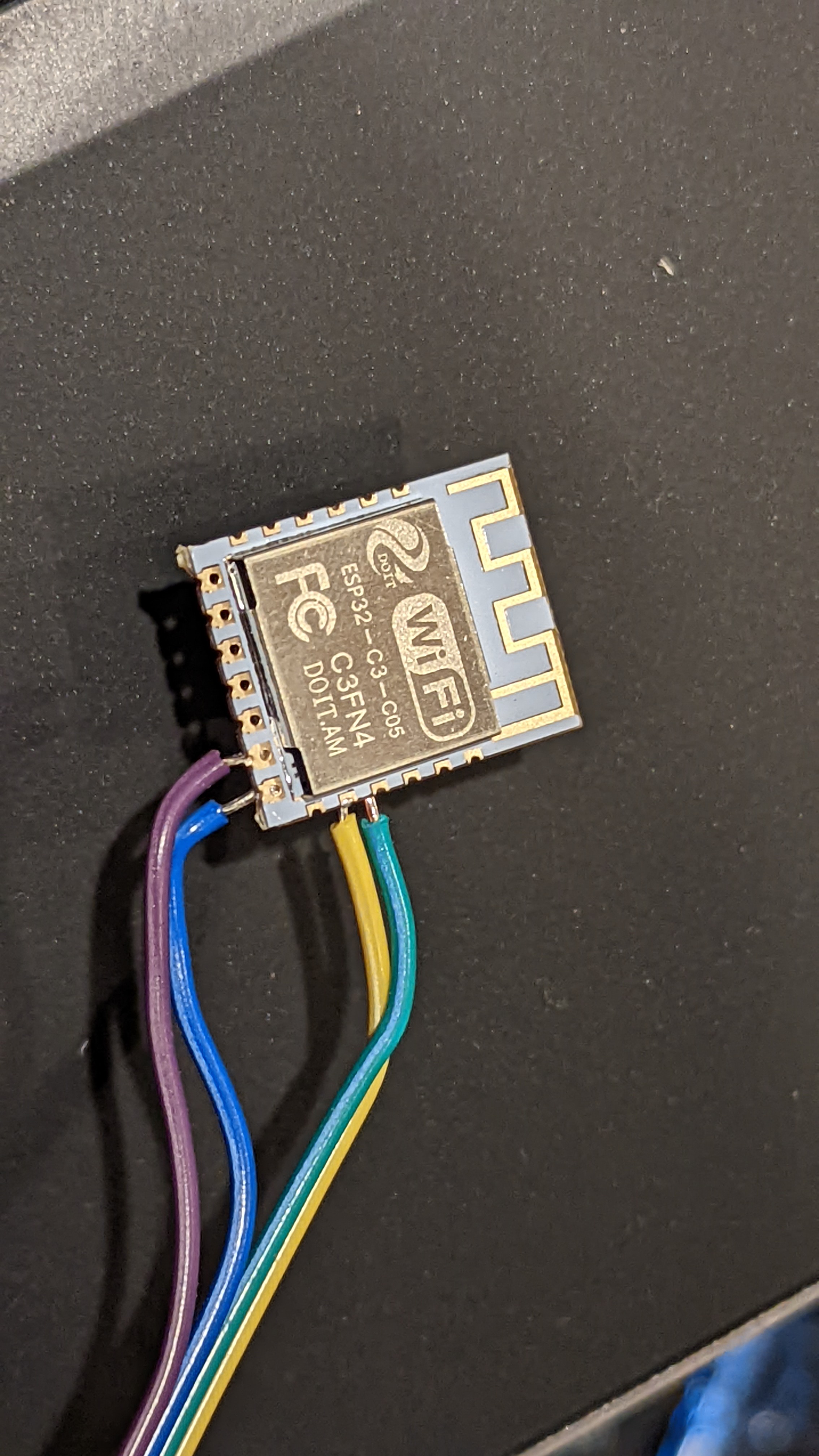

The ESP chips are remarkably fast too. When they first came out, there were many designs that used the esp as a wifi modem, and the main brain was a much slower Arduino. I read several articles where people tore down devices and reversed the software, making the Arduino the gpio extender for the much faster esp8266 and got fantastic results. They really have changed the game.
I think the cheapest arduinos are the pro nano clones. They would do fine for a job like this. An esp8266 doesn’t have many IO. An ESP32 has a few more. If I needed as many IO as a UNO, I would probably hunt for a leonardo clone. Obv. The mega has many many IO.
It is hard not to do something with the wireless features though. If nothing else, it is so nice to flash new firmware over wifi.
I really like them. I use a lot of them with esphome, or tasmota firmware.

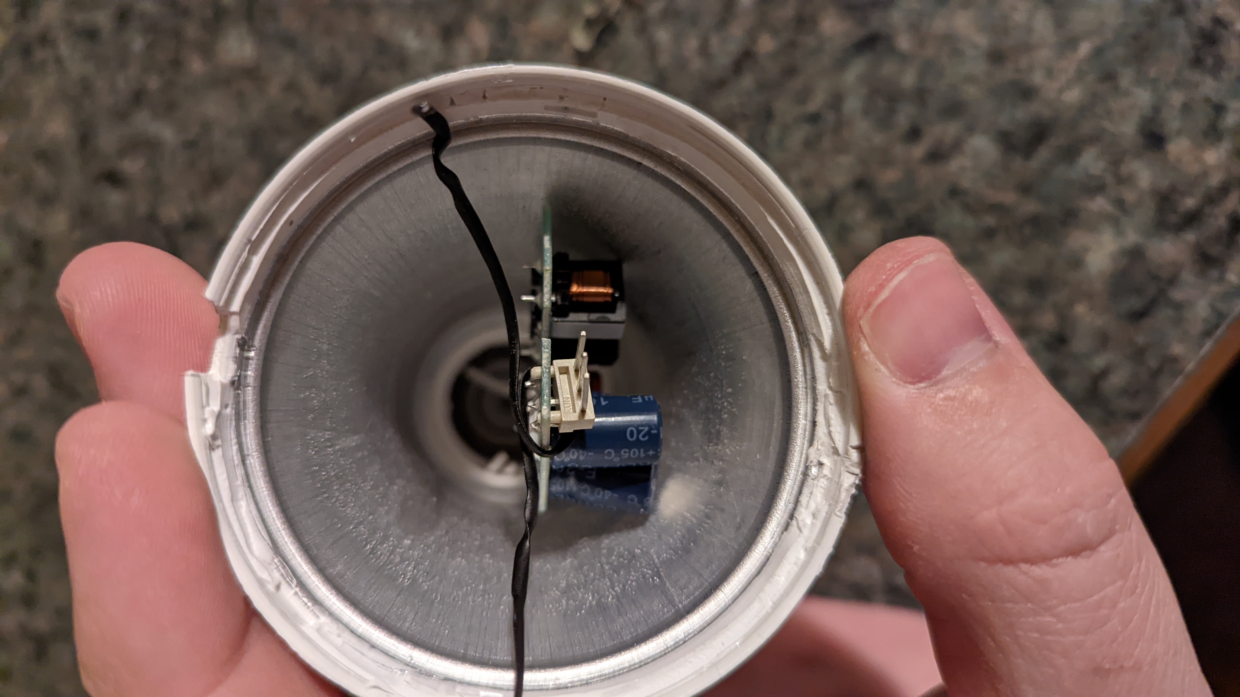

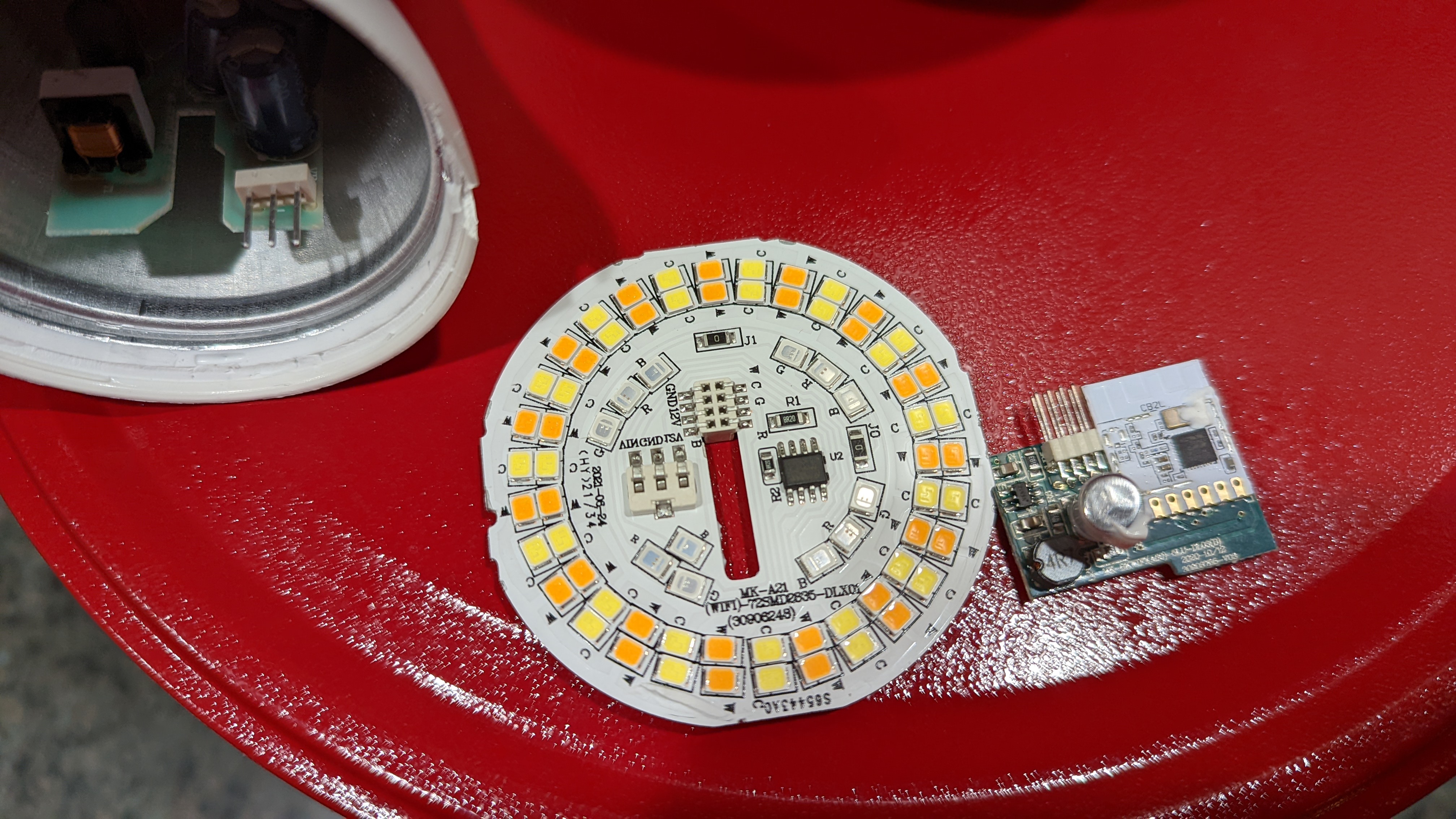

In fact, (another tangent), I bought some smart light bulbs that I thought were going to be esps inside, but weren’t. I still wanted to know the firmware was secure, so I replaced the chips inside with some esp32-c3 (which is a new variant and harder to use). It was fiddly work, but it worked.
It is hard to see, but the right most board in the first pic had to be replaced by the esp chip in the third photo. These light bulbs are very tight when everything is assembled. The board that stayed inside the bulb is a power supply, which provides 15VDC (it is labeled 12V, but I think it is just a 10:1 transform from the mains) and rectified mains DC (150VDC or so). Then the white board with all the LEDs has a transistor for the warm and cool LEDs, which run off of the 150VDC. The next board has a 3.3VDC power supply, the brain board (which I replaced) and transistors for the RGB LEDs, which run off of 15VDC.
Improvements!
  1. Changed the gear cog size. Increased so that it becomes reasonable to mill the gears out of 12mm material This does make things a little less smooth, but it’s not like a machine dropping slingshot ammo out continuously is going to be silent… right?
  2. Increased the tolerance for the marble pockets. The new ones are 12mm in diameter, hoping to accommodate 3/8" (9.5mm) marbles. The little bit of extra room should allow a bit more space.
  3. To go with the increased tolerance, the holes in the frame are enlarged, and slightly offset vertically. This gives the marble room to drop in (or out) of the marble pocket
I think I’m going to try to build 2 of these (Just to prove the “stackable” concept) and check that it works.
I still need to make the collector at the bottom and a chute for the top, but those should be relatively simple task. Also need to design the power module to drive the little gear. I’ll probably integrate that with the piece that collects the marbles at the bottom to feed the lifter.
