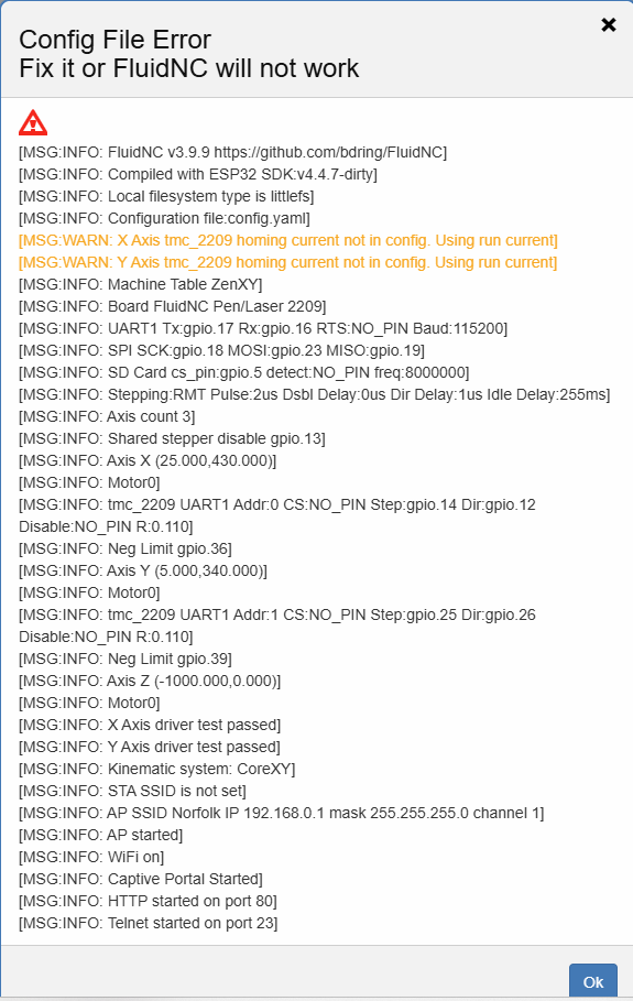

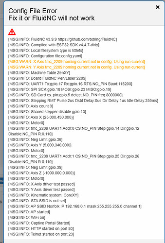

I was able to get FluidNC 3.9.9 reinstalled. Was able to download the config.yml, uploaded that to the board.
I am getting an error upon logging into FluidNC:

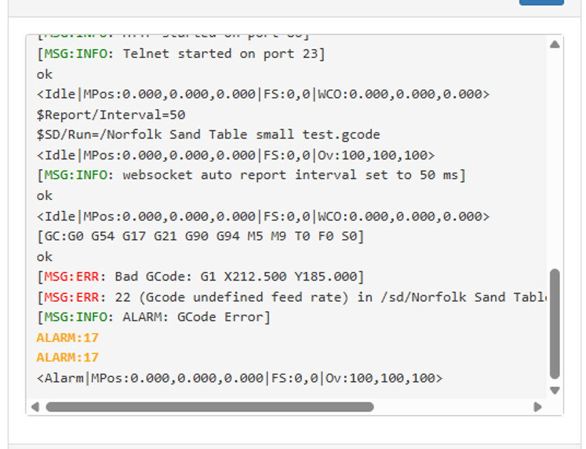

I dropped a small test pattern gcode onto an SD card and tried to run it from FluidNC. Did not quite get success, got another error code:
…but I feel like I’m real close!
Let’s look at your config.yaml file. Paste it here using the preformatted text option.
That option looks like this on the forum editor toolbar: </>

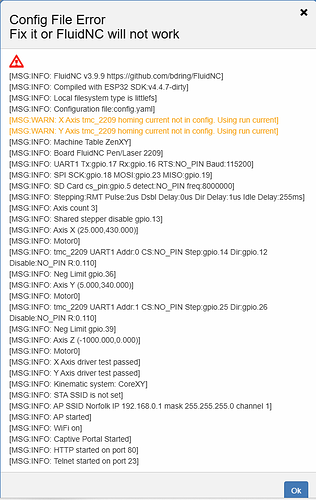

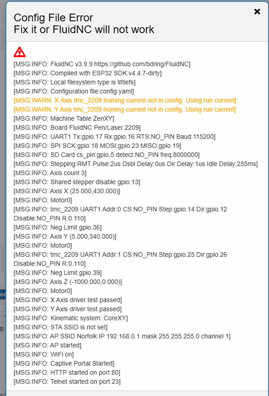

More information. I have been moving the table into its permanent home, and today I logged into the board and got this error message when I logged in:
The indentation is part of the config. That is how fluidnc knows when sections start and stop.
Your X and Y sections have no indentation. So it doesn’t know about x or y, which is why that G1 code is invalid.
