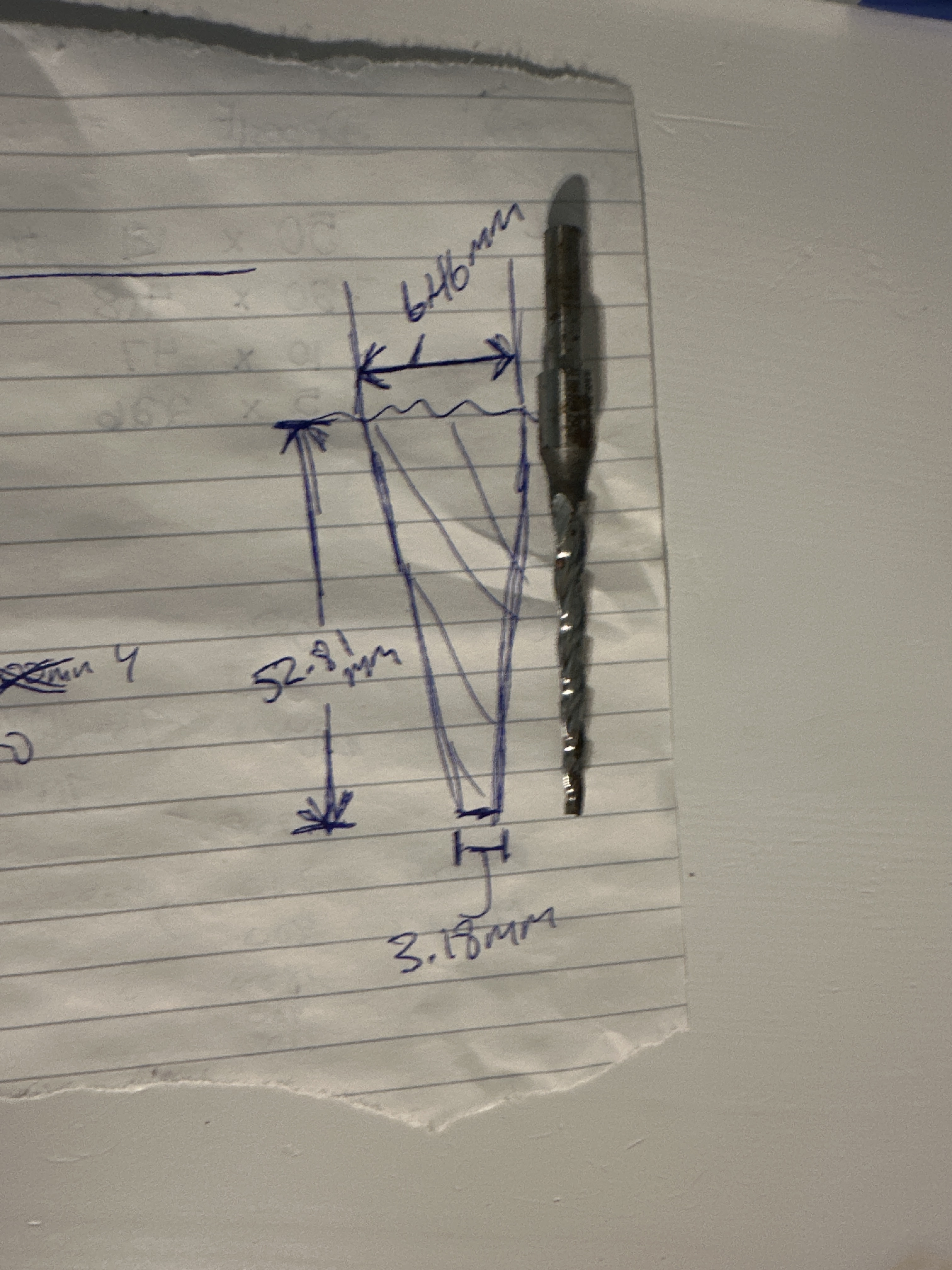

My carving partner and I were talking about this and having a look at this bit I have. It’s tapered but maybe would still do the trick - it’s a very slight taper.

I can’t recall off hand how to access the spot in Estlcam where you can add or remove tool parameters. Trying to configure that long bit. I’m using Estlcam 11 at the moment. I don’t see a cell for inputting the cutter length.
Click on the empty blue line just below the last tool, and it will add a new tool. Click on the wrench icon to modify that tool’s settings.
Perfect. Thanks. I don’t see anywhere that I can address the flat nose and the taper and the length here. What am I missing?

Maybe I can cheat the system and specify it as a very shallow angle v bit but know in my mind that the tip is blunt? I feel like the v bit distinction is specific or at least most critical to the carve function. If I recall correctly there’s a tool change built in to the carve function for the pocket clear out.
I think you want to do it like a V-bit but set the Tip offset for the tip.
Is that 6.46mm measurement at the top part of the taper? If so, I think you want these values but someone should sanity check that. I just put it in CAD and let it calculate it. I split it in half and doubled the angle.
Diameter: 6.46mm
Tip angle: 3.56 degrees
Tip offset: -51.2mm
Oh man you guys are awesome! My “faking it” might have caused a whole pile of AirPrints. I saw the tip offset but never thought to rollover it for more info. Thanks so much. I’ll set it up and try it tomorrow. If it works I’ll have to pull the secondary core off to test the job I’d be using this specific bit for but I think that’s actually pretty easily done.
