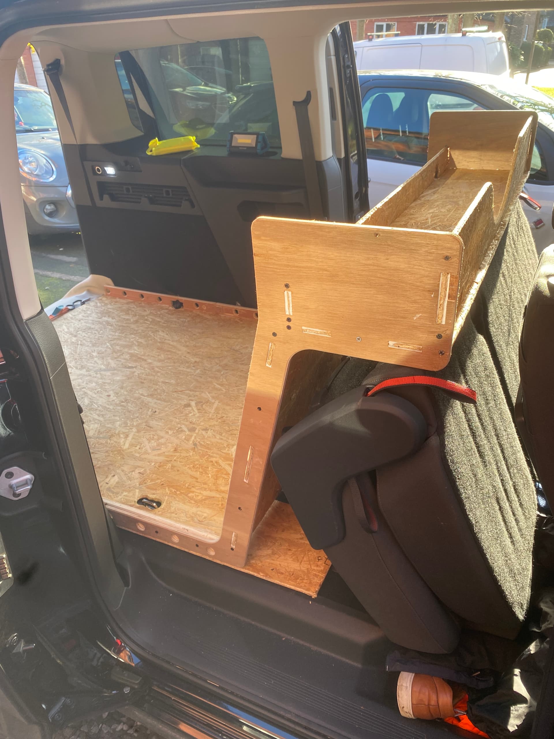

This work takes me all over the country and so I am lucky enough to have a company car. The problem is, I have more kit to carry than will fit in a small hatch back, minimum size I have made work is VW golf. For the winter I wanted something a bit more suitable that would also allow me a better loadspace for carrying tools and wood from the lumberyard,etc.
Really I should have a van but the company car tax rules in this country make that tricky so I have been threatening for years to take the backseat out of a car and to line it with wood to create a van. with this in mind I ordered a caddy 7 seat mpv and immediately removed the rear two seats.
The options to keep it as a five seater was really appealing so I wanted some sort of compromise to allow this. Luckily the rear seats folds right forward into the front so I could keep those in while maximising the space.

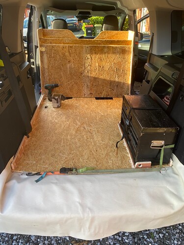

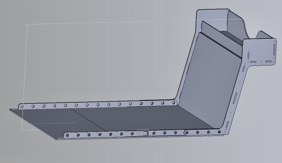

I was inspired by the guys at https://aribabox.com/ And created a floor with a front shelf bulkhead unit that can be moved forward and backwards to allow the seats to fold back down - cutouts in the floor allow for this. This was my first time using dog bones, and while not perfect the fit was more than adequate when screwing and glueing the joints. The locating rails on each side of holes which aligned to the shelf sides to allow 25mm dowels to act as locking pins - when not in use the holes in the rails can be used as mounting points for straps, etc. Panels are 10 mil. Shelf sides are 12mm and the rails 15mm. No hand finishing apart from a quick chamfer with a handheld trim router.
I did a 300 mile journey today with all of the kit I need secured down easily with loads of room to spare while protecting the OEM trim and carpet. (If I damage it I have to pay) The shelf works perfectly for little items and does not squeak Rattle or move because it rests against the seats which are protected by padding to prevent chaffing. Extra vinyl leather stapled to the rear of the floor protects the bumper. All the wood is reclaimed, I am less than £30 into this project, which is a good thing as I will only have this car for six months before I’ve done enough mileage to send it back!
Perhaps a bit overkill for a short term solution, but this was a great excuse to learn more about designing for CNC and I am now looking forward to improving the accuracy of the machine to get good dog bones for futureprojects!

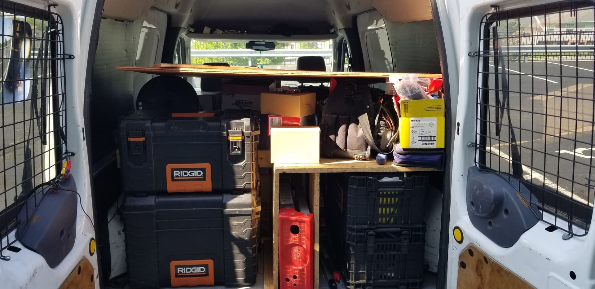

I used to think it was odd to see contractors around here in minivans until I saw the doors open up. They had a full shop built out in those things and the tools always stayed well concealed, and those vans have fairly large motors so hauling wood on top was no big deal.

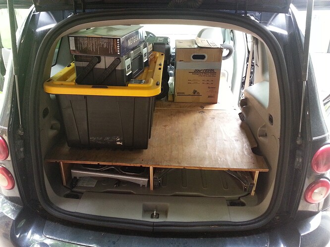

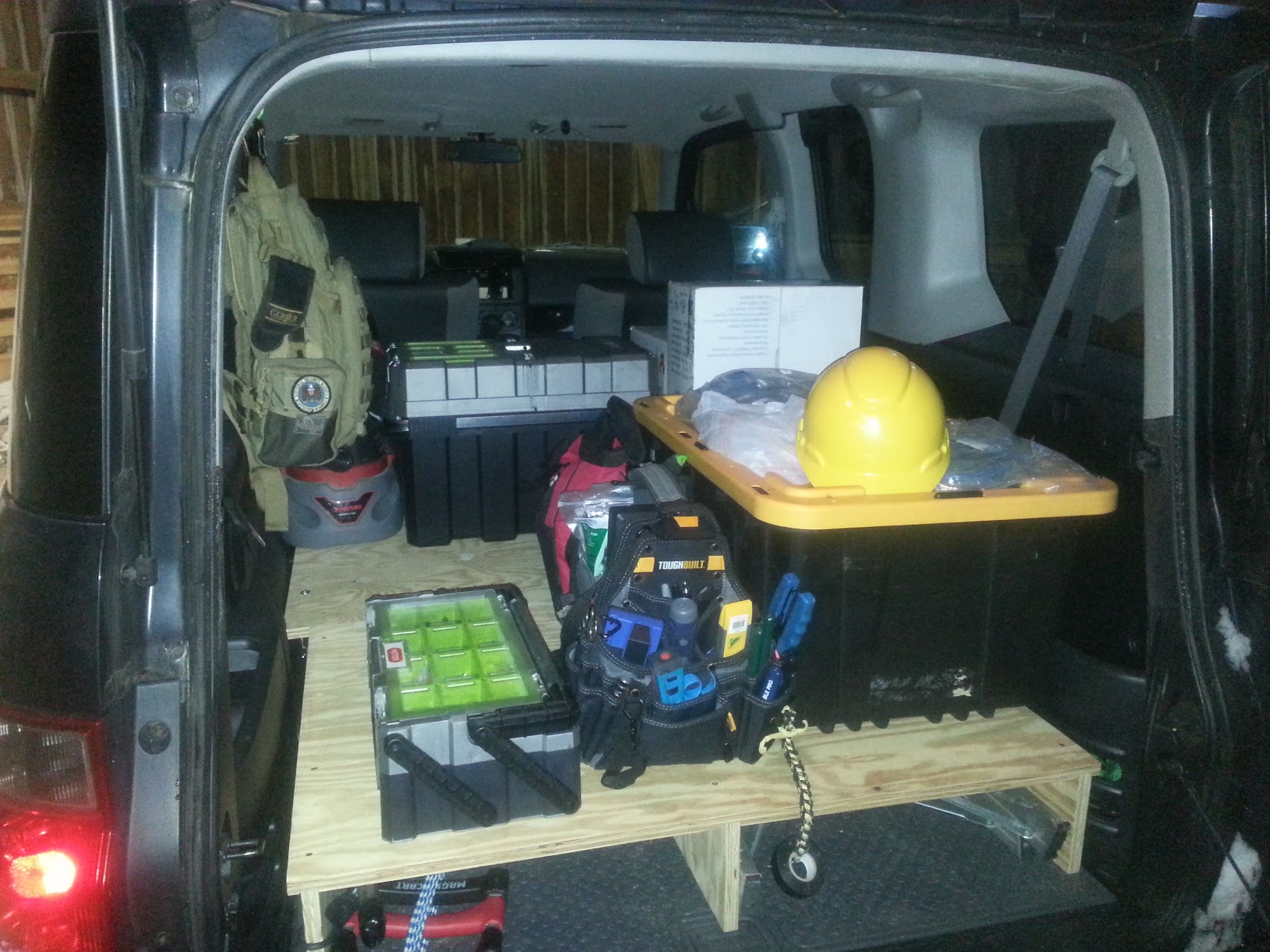

Similar to what I did to all my work cars.

What tolerance did you give between the dog bone parts?
Thanks!
Zero tolerance, but I think I have runout on the Katsu router as they went together fine with a bit of percussive persuasion! I did chamfer all the edges with a handheld router though which I think helped get them started. I was in a rush so didn’t have time or spare wood to make tests etc.
All joints glued and screwed anyway which took up any slop - because car vibrations etc
