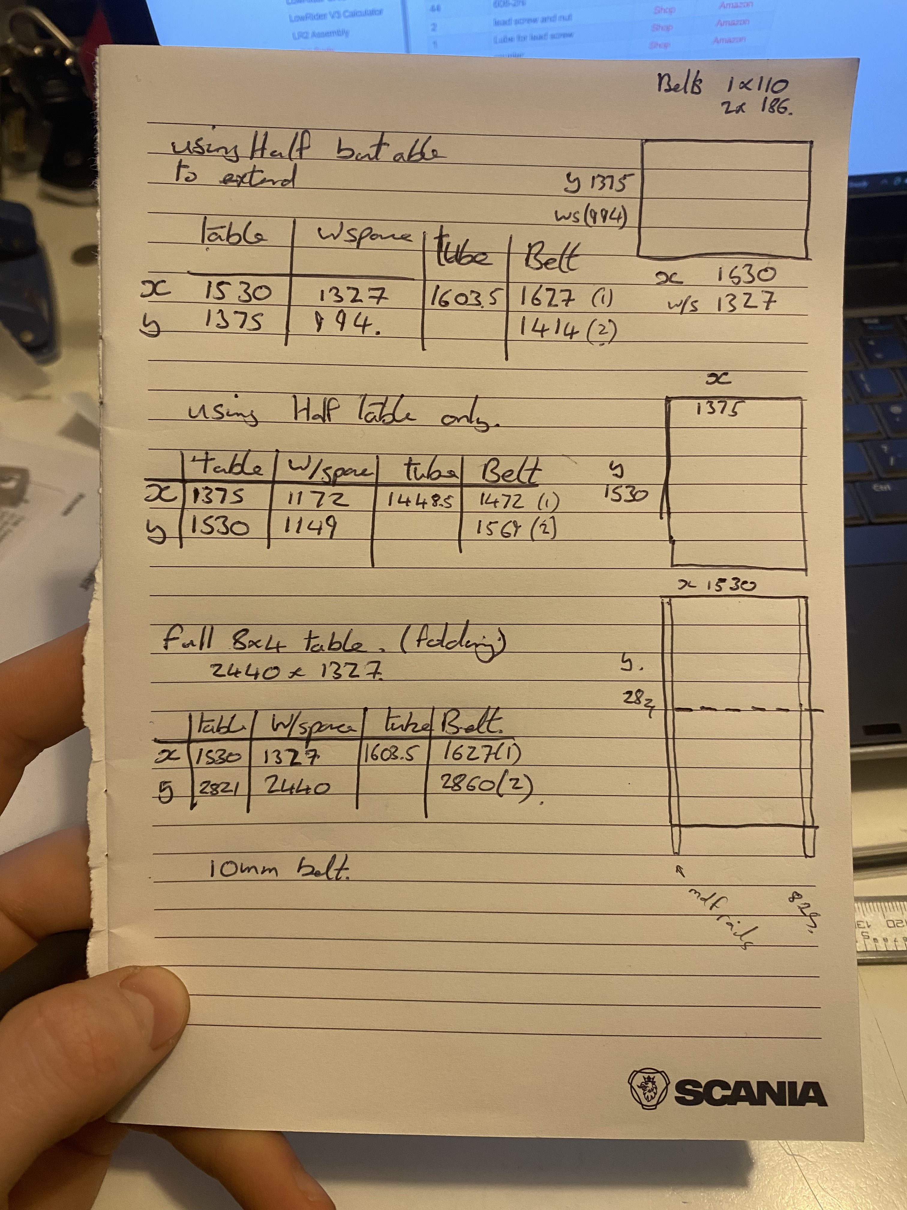

So, I’m a the stage where I have 3 options as far as I see it:
  1. Half table machine, x-axis 5ft table width, y axis 4.5ft table length, and use other side of the table for outfeed.
    Pros:
    Can build in situ, only use one half for a start. Then only use 2nd half when needed for outfeed table.
    Only need to extend belts (or deal with long belts with excess length) to get to full sheet machine using 2nd half of table.

  1. Use half the table, but have xaxis across the width:
    Pros:
    Y axis greater than x
    Can build in situ, only use one half.
    No issue with aligning table halves.

  1. Full 9x5 table machine, x-axis 5ft table width, y axis 9ft table length, nearly full sheet
    Pros:
    Full sheet
Can use most of table for other things when needed without disturbing cnc.
Cons:
X is greater than Y axis.
Need more space! May have to be used outside, or wait until garage is clear (garage only 8’x17)
Would need extending to get to a full 8ft working length.
I used the LR2 table calculator backwards to get these workspace dimensions
(Would be a good option to be able to plug in a fixed table size, and the calculator work out what workspace you can have - @vicious1 what are your thoughts for lr4 people with fixed table dimensions?)
Given all the above, I’m leaning to option one for now, with the option to go to full sheet when space and project require it. The only thing that I am majorly concerned about though is the 5ft axis, especially as the tubes are 25mm galvanised conduit - so x-axis deformation over length may be a problem?

It is very easy to change the configuration. Use what you have, leave extra belt bundled up. Get started using it. Once you get a few projects under your belt you will see what you prefer.
Thanks Ryan, I figured as much, and will go with option 1 with full length belts.
Do you think the 5ft x-span will be an issue for my use cases? Im a bit concerned about deflection but not sure if I am being over-cautious?
Yes, smaller is better. LR3 and 4 don’t hang over the edge so they are easier to use on any size table, and the gantries on those are far far more rigid for a wider build.
It will work but it will be slower because of it.
Honestly, I am not seeing the ping pong table as a very good option. Some 2x4’s and some sheet material and you have the exact size table you need, you can even hinge it to the wall or add wheels.

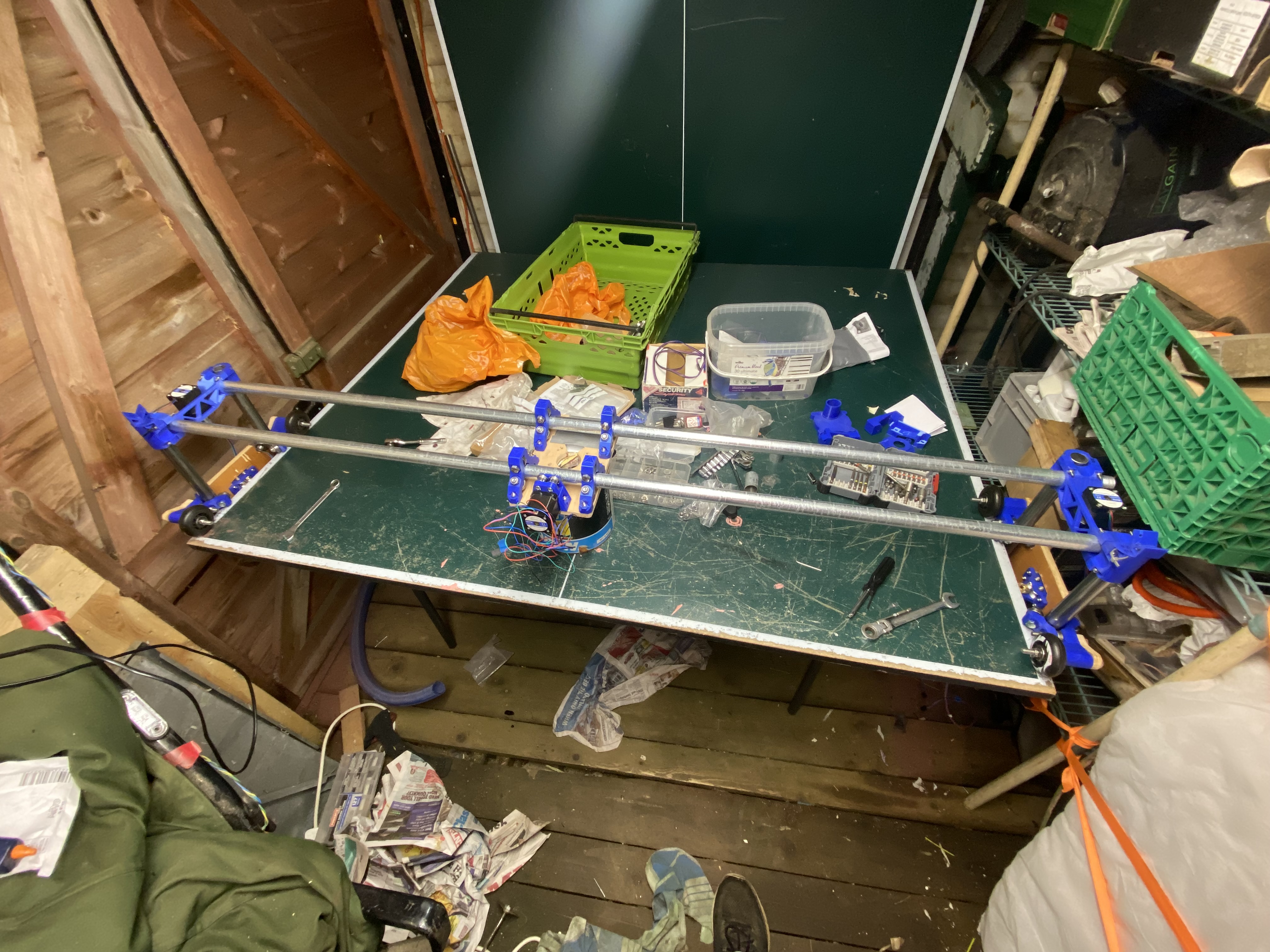

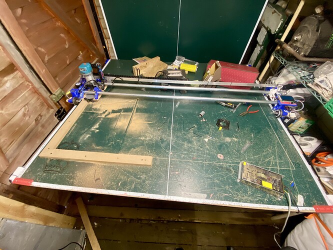

Slow progress, but progress nonetheless… I can work on it 7-8am most mornings before work, but the shed was -2degC this morning, and no heater so it takes a lot of will power to get out there and get on, when there are jobs in the warm that also need doing!
Mechanical assembly pretty much complete, just need to get Ztubes aligned better and take out lateral play between Ztubes (is there a recommended clearance gap?)
Z lead screws to go on next, then measuring up all the wiring harness extensions! https://youtu.be/_rGZ8-cSS34?si=-TypQx0KgYr8raFA

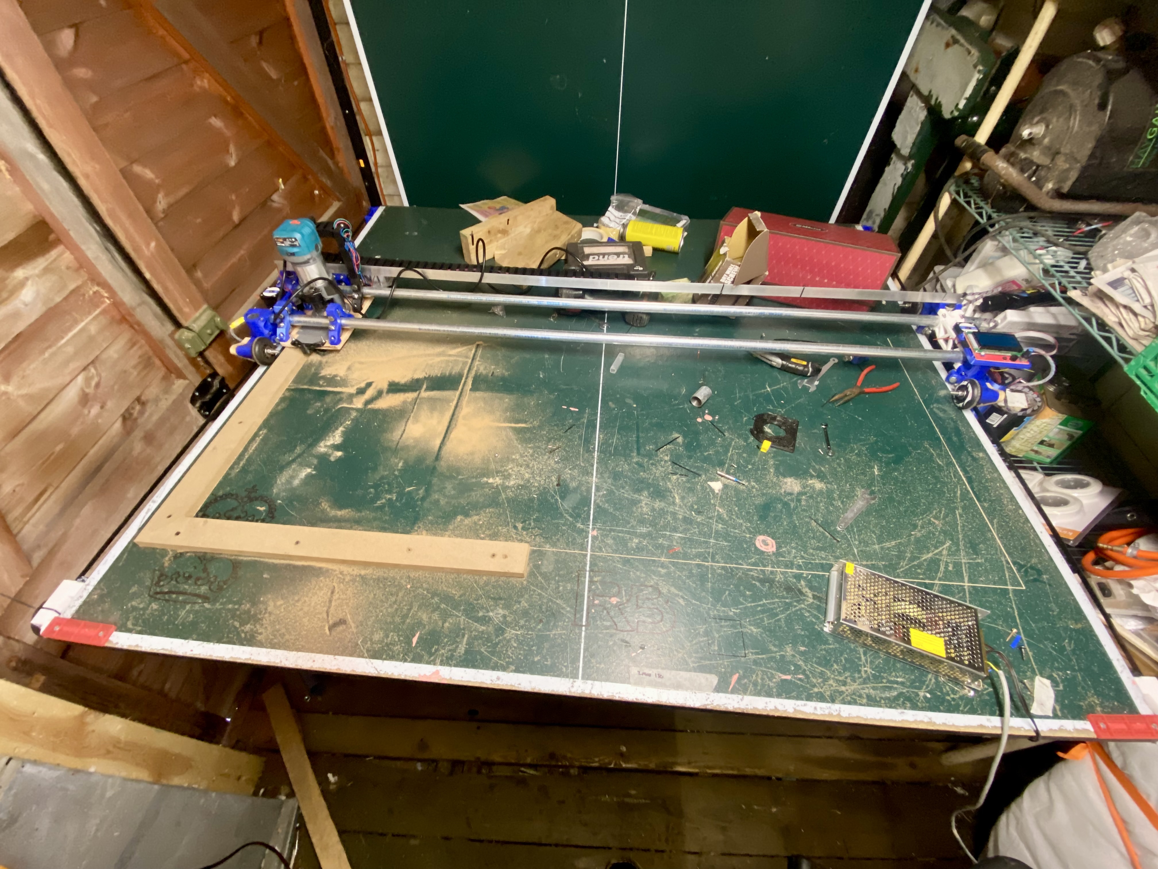

Finally, after a lot of mistakes and waiting on overnight parts from Japan (and Amazon), I made some chips/dust!
Table top is warped to hell, but I have a plan that is mainly screwing 2x4s underneath it to pull it straight.

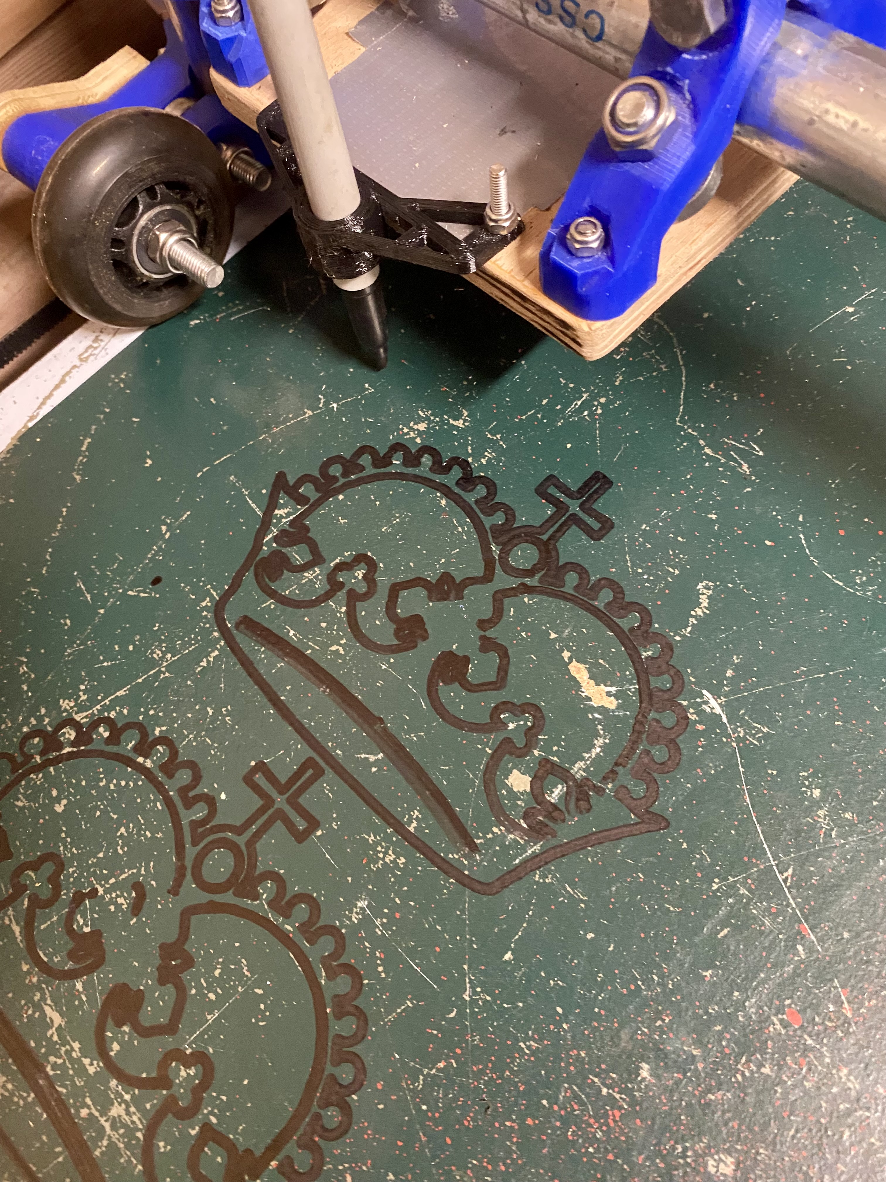

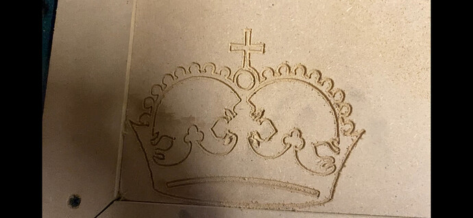

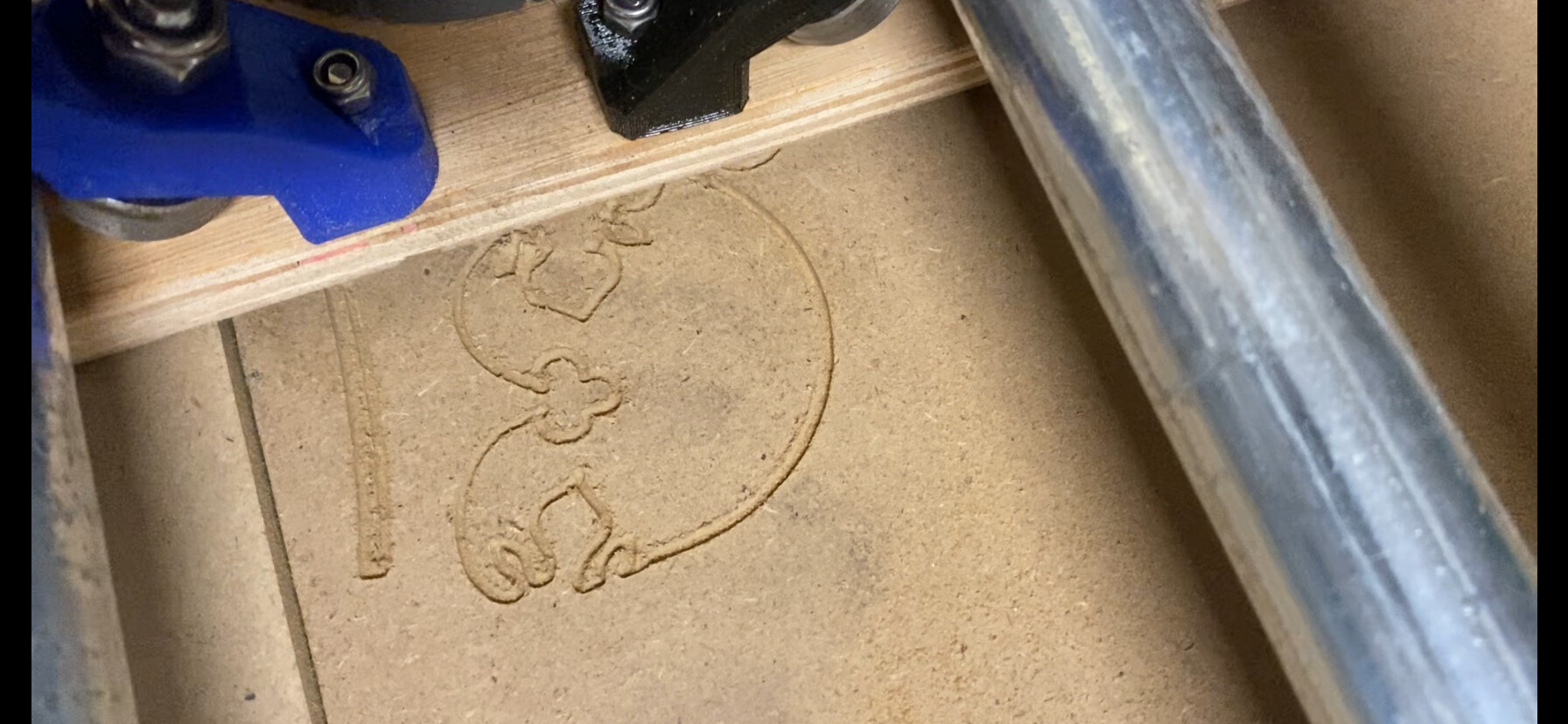

Half drag chain added (because they are expensive) and some cable management, and then it was onto penplotting - crown looked pretty good (please critique!) aside from where the pen caught, or the holder flexed. Also drew out a cattle-brand style monogram for the fun of it, so cool to see designs come to life!
onto the Katsu. 22.5deg engraving bit (for 45deg bends in future ACM/dibond projects) and just 3 manually controlled/jogged straight lines to give me an idea of max workspace, and set a corner to clamp to using some mdf scraps
Then just a repeat of the crown, and a first real engrave down to 3mm of the brand, just because!
So so pleased with how this has turned out so far, well aware this is baby steps, and the size of my work area will limit me with the LR2 design, but for me this is a massive leap! Thanks again to Ryan for enabling us to turn ideas to reality through these machines! O already have a prototyping use case lined up for a custome steel plate I need to have laser cut, so I will be checking fit using an mdf milled test piece!
Next steps, table bracing, spoil board, and squareness and dimensioning checks before engraving a full grid for alignment!

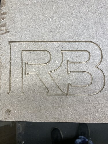

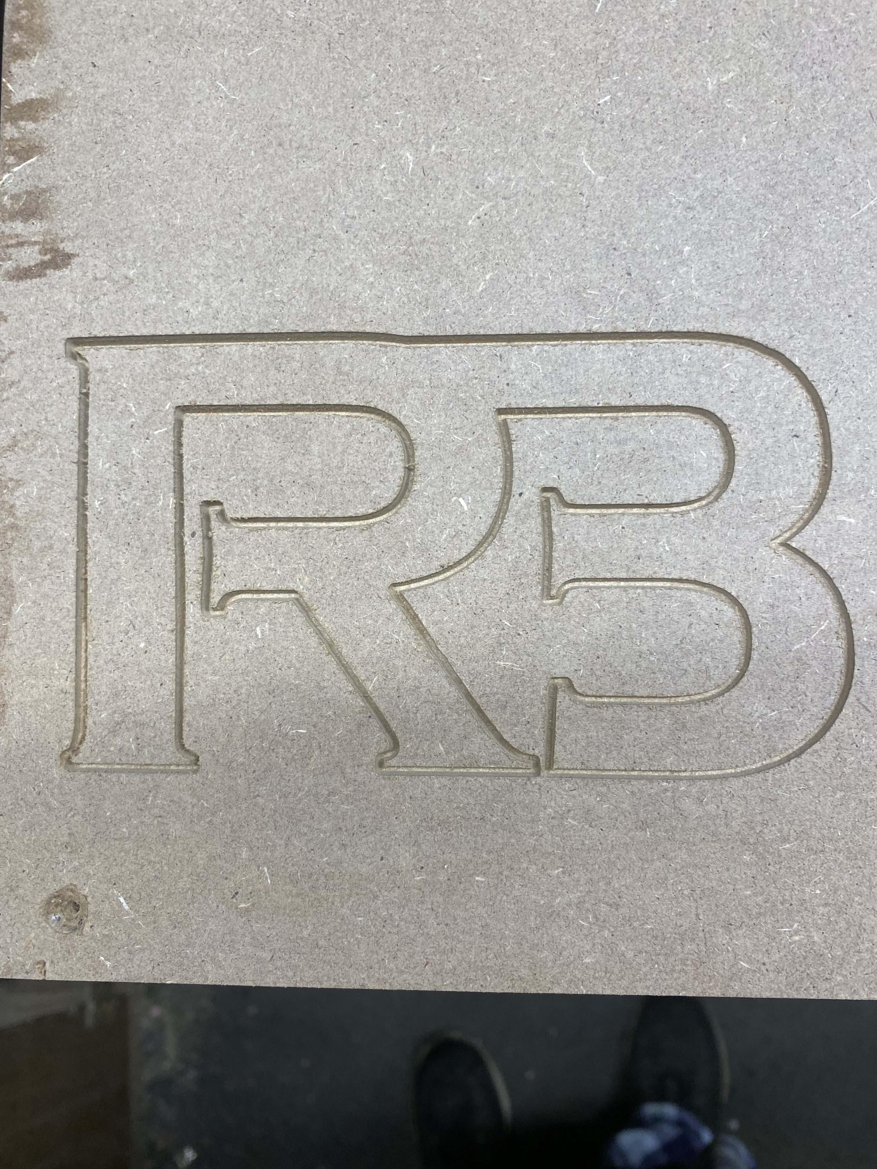

Milled crown for critique
I think this was 1mm doc single pass, which may explain some of the tear out? really I need to sort out the probing side and work out proper feeds and speeds to be able to go from there

Don’t worry about tear out in mdf it kinda always happens but should brush right off.
So a lot has been going on with work, so havent had much time to get out to the Shed but I have achieved a bit.
The pingpong table has been reinforced with 3x2 ribs under the original MDF deck, with a12mm mdf spoil board added (and 12mm mdf wheel track added to make sure the sled still clears the spoil board even at lowest Z). The table is now approx 2mm out of flat, and while I have a surfacing bit, I haven’t had the time to improve on it - most of what I will do is through cuts anyway. 600mm x-y L-corner fence added at the origin, and milled square.

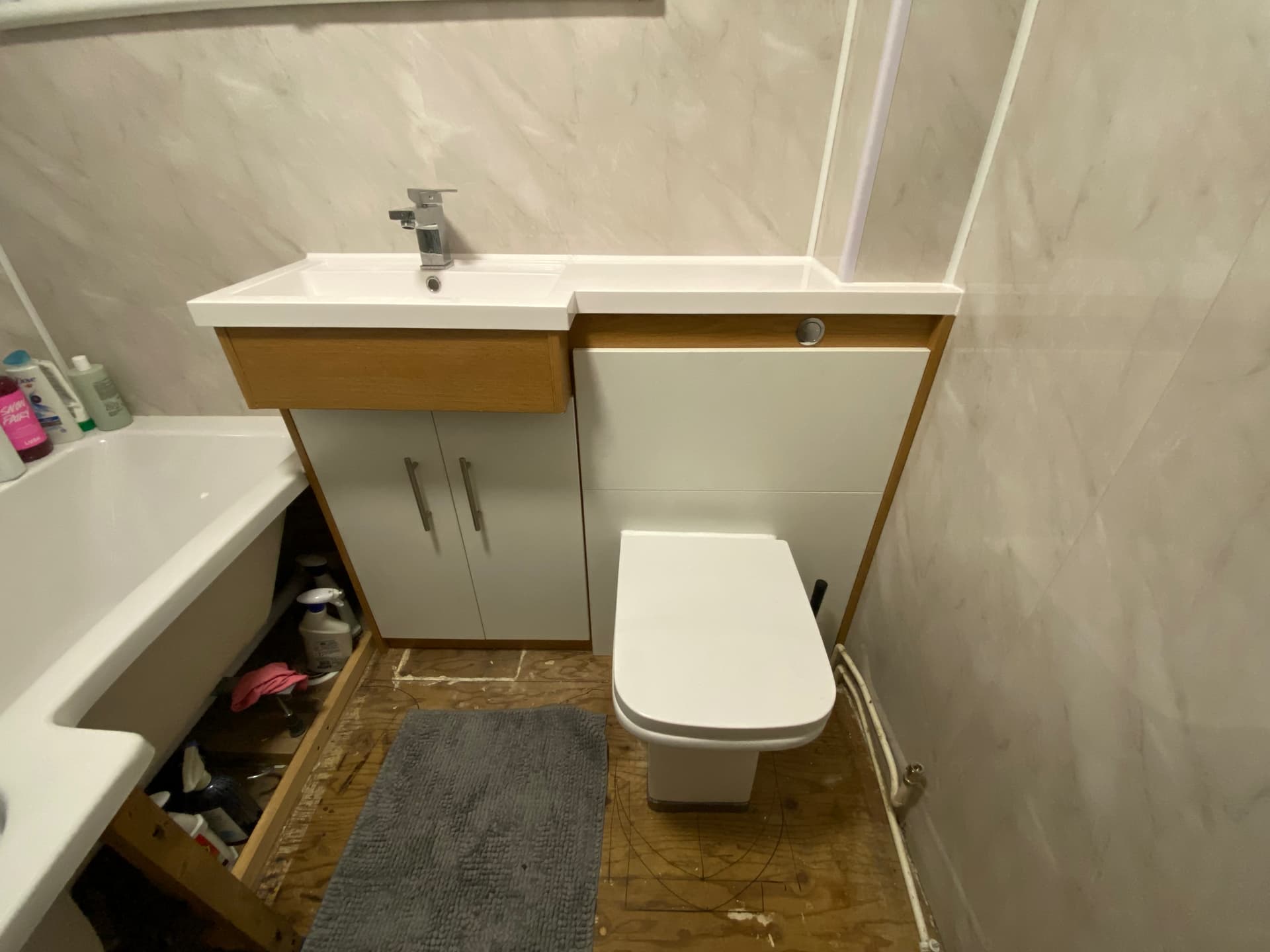

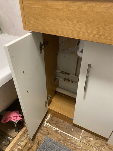

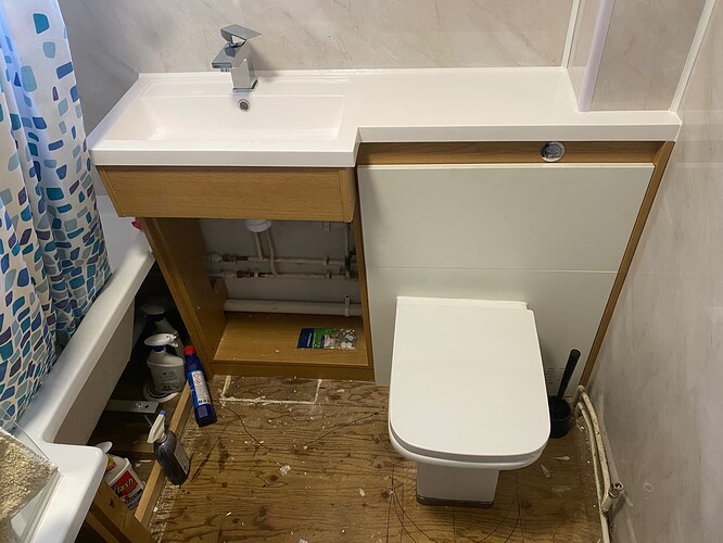

The pressing project for this build is a vanity unit for the bathroom I am renovating in the house. Nothing off the shelf fits, so I have designed my own ikea style unit, and will be using recycled Ikea Pax Wardobe sides as it’s hands down the cheapest way to get faced chipboard - light oak veneer in this case. Less than £20 for all I need for this, and probably enough to do the bath surround too!
(Sink, doors and toilet not modelled, but the end result will hopefully look like this)
In reality I would have had it built by now if I didn’t have the cnc, but I want to cnc it to say I have, and to prove a point to the other half about why I spend so much time in the shed! So the design calls for accuracy, and I thought I had better test the LR2 out, before jumping in!

Well lucky you, the Pax Wardrobe I bought at Ikea in Canadaland in 2020 were made out of faced heavy corrugated cardboard with narrow chipboard frame borders. They were pretty heavy… didn’t notice it was cardboard until I had to cut into one of them.
Sorry to hear that, the UK spec is still 18mm chipboard faced in foil or melamine. So long as you’re careful on using prefaced edges for fronts it’s ok

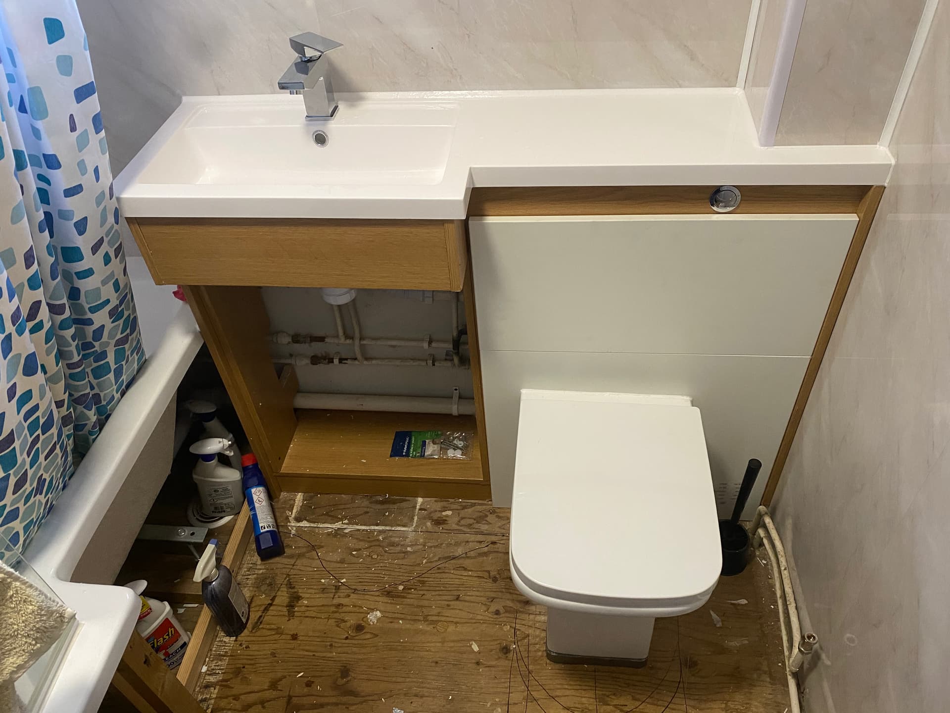

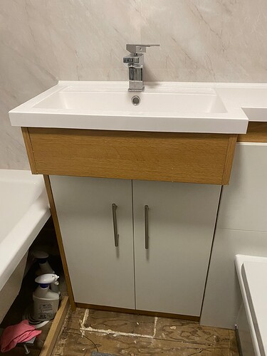

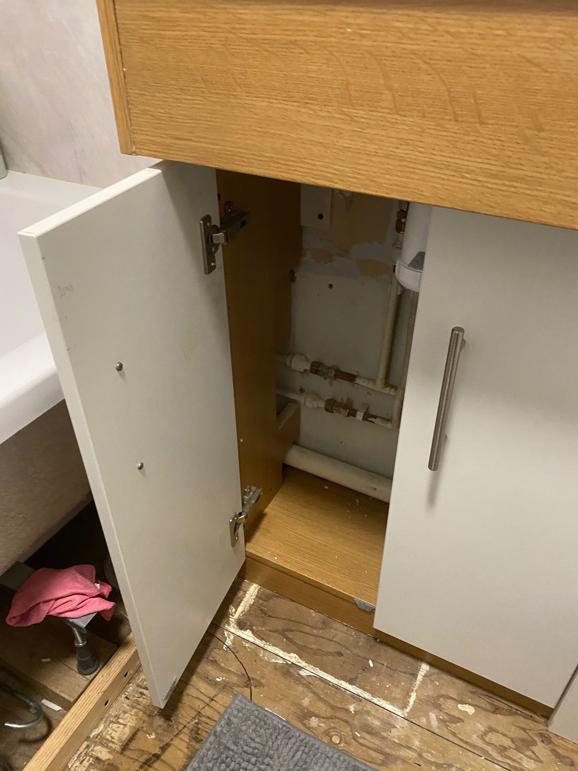

Finally got the vanity unit finished!
