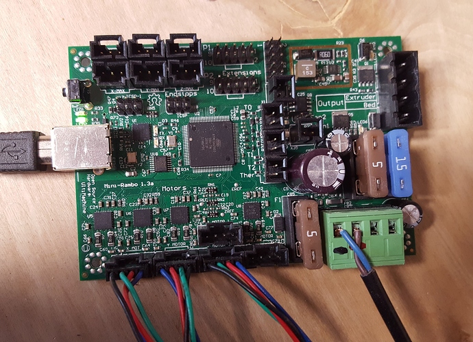

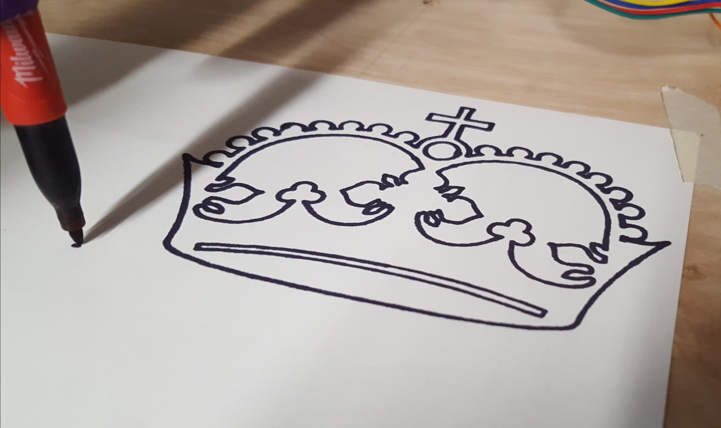

Hello. I’m getting back to the MPCNC project after most of a year off. Retirement and other projects got in the way. I smoked the MEGA under my ramps board back then. Machine moved and made the crown. I was working on calibration.
Fast forward to now. I bought mini-RAMBO 1.3 from Utili-machine. I have followed instructions here: https://www.v1engineering.com/marlin-firmware/ My computer shows Rambo hooked up, and the mRambo sketch compiled and loaded with no hesitation. With ESTLCAM I can program the controller and it seems happy. Using the manual controller, F2, I can see yellow lights in center of mRambo brighten, then normal flashing resumes. No movement of motors, no hum, nothing.

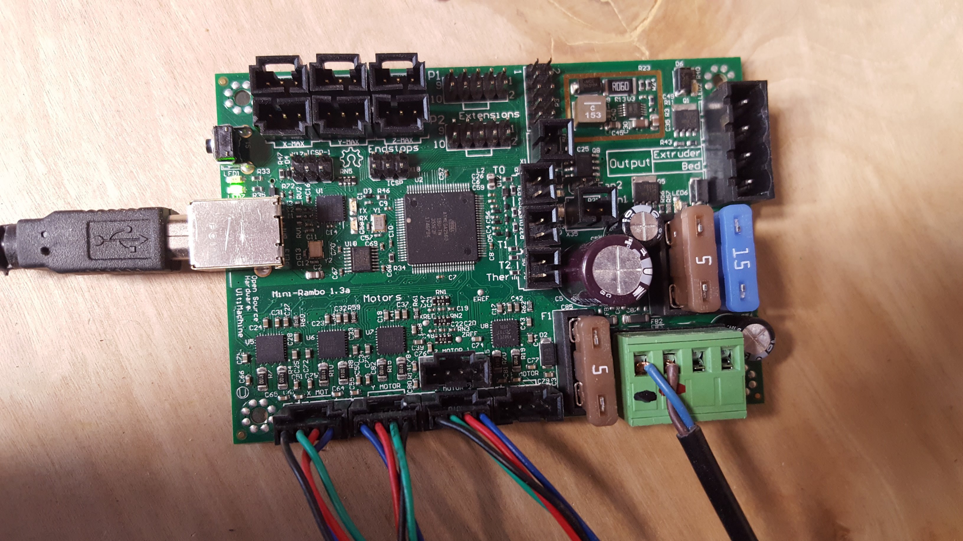

In checking wiring I found I had inserted the power jack backwards. When I turned it around red pilot light came on. Checked fuses, they are good.
I’m beginning to suspect I cooked the regulator on the mRAMBO.

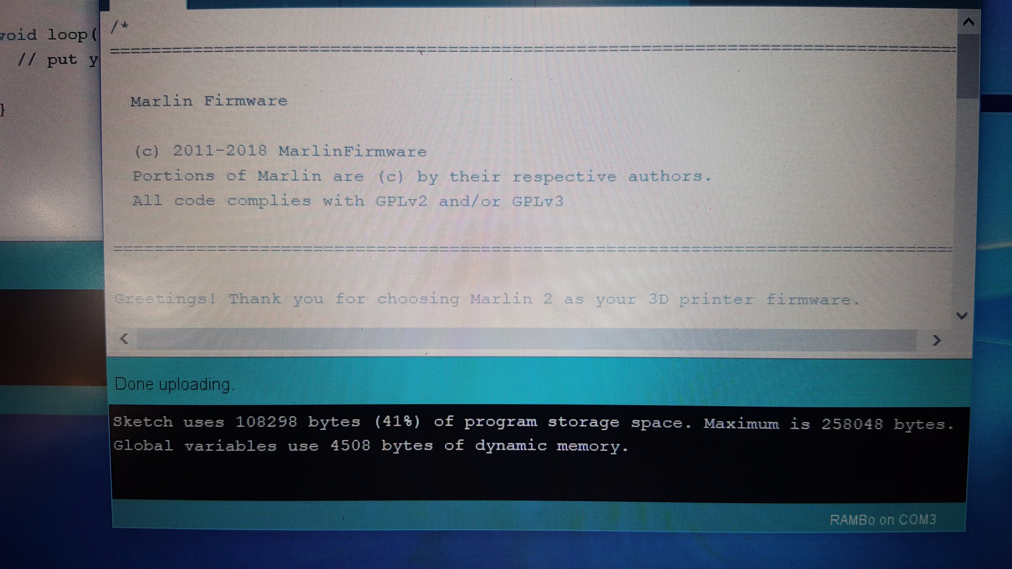

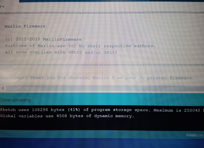

Downloaded link, reflashed. Says it was successful. No joy.
Windows 10 computer shows Arduino Mega 2560 on Com3.
Computer gives me the connect and disconnect sound when I plug and unplug.

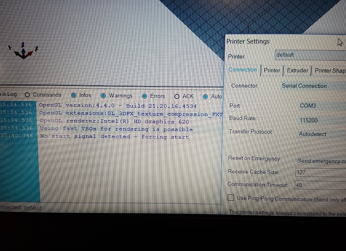

Repetier Host will connect and disconnect.
Dialogue box says: No Start signal detetected - forcing start.

He means that windows allocated com3 port for the board attached by usb
I think that 2 screenshots
Arduino ide after flashing
Repeties host after connected to the flashed board
Could be helpful here

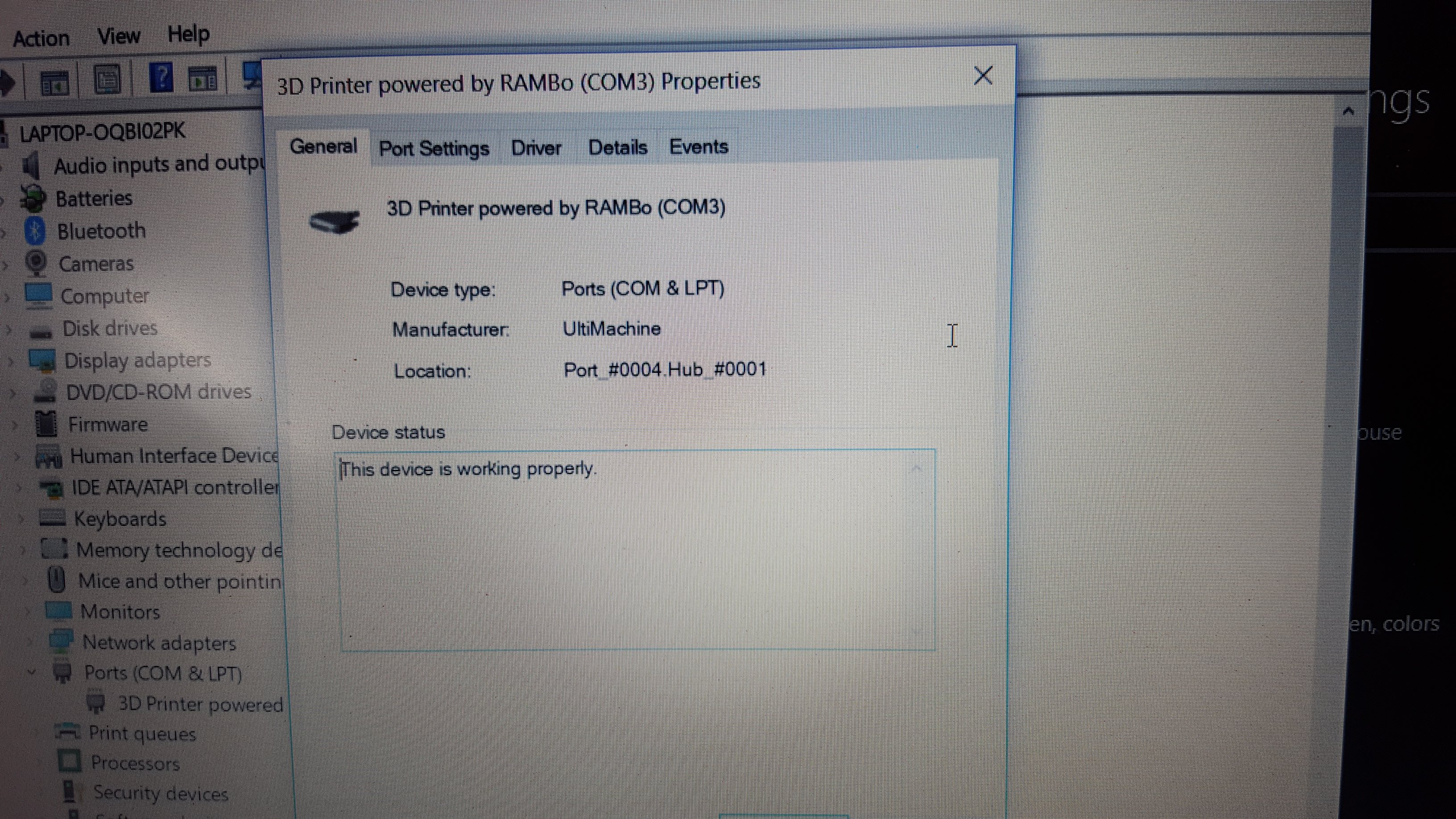

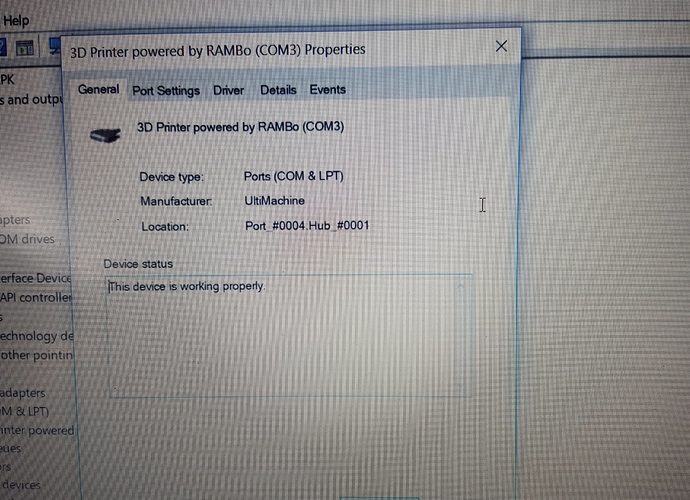

Pretty sure the Rambo doesn’t show as a Mega 2560 when hooked up to a pc.

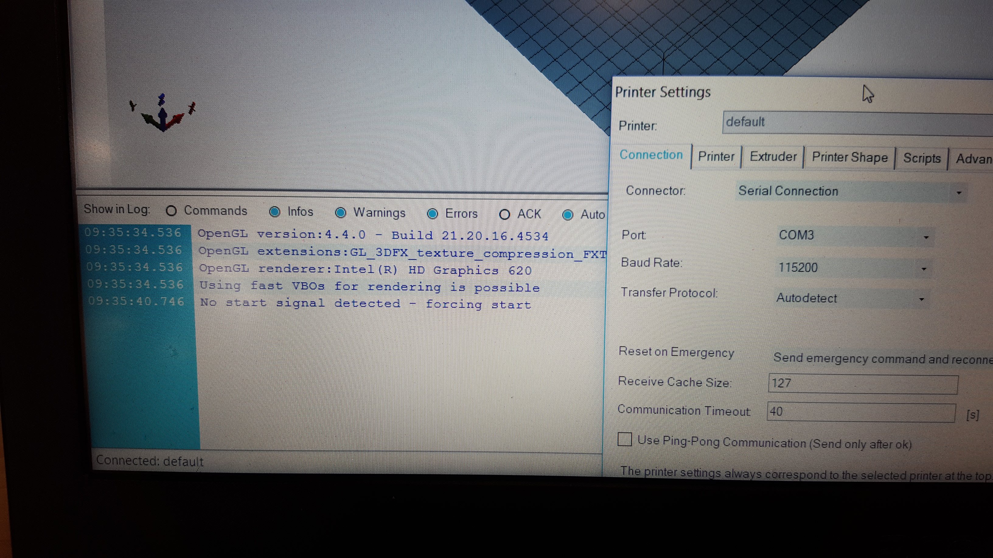

Found driver link on utilimaker site. Computer sees rambo board. Arduino lets me flash firmware “marlin” from the page listed above. Repetier-host will connect but gives error message.
Third photo and wiring.
baudrate is 250000
Success. Not sure why it deviled me so. Ryan your work developing MPCNC and supporting it is much appreciated.
