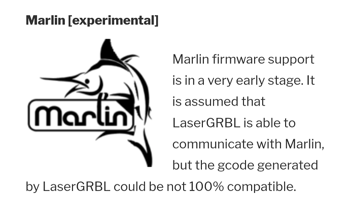

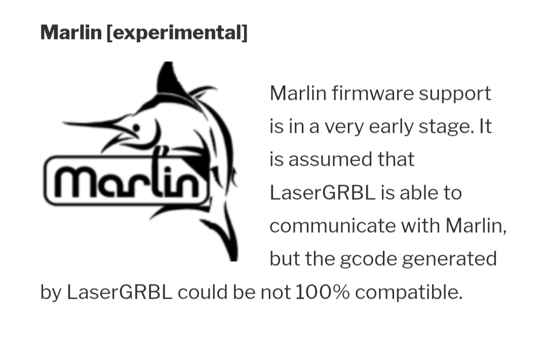

I haven’t used it myself but have you looked into LaserGRBL? As far as I recall you can export gcode. Not as pretty as lightburn or anything. Cannot speak to how well it works, personally I use lightburn, but when I first started tinkering with lasers I tried it out and it works ok
Maybe I’m wrong, but I think it only supports GRBL. I need Marlin gcode output.
Yup, you’re right, thanks. The price I saw was in $CDN, I just assumed it was $USD
They have an experimental fork for marlin export. Again haven’t checked it out myself. Another option (haven’t looked into it at all) but inkscape may have a plugin for exporting in marlin

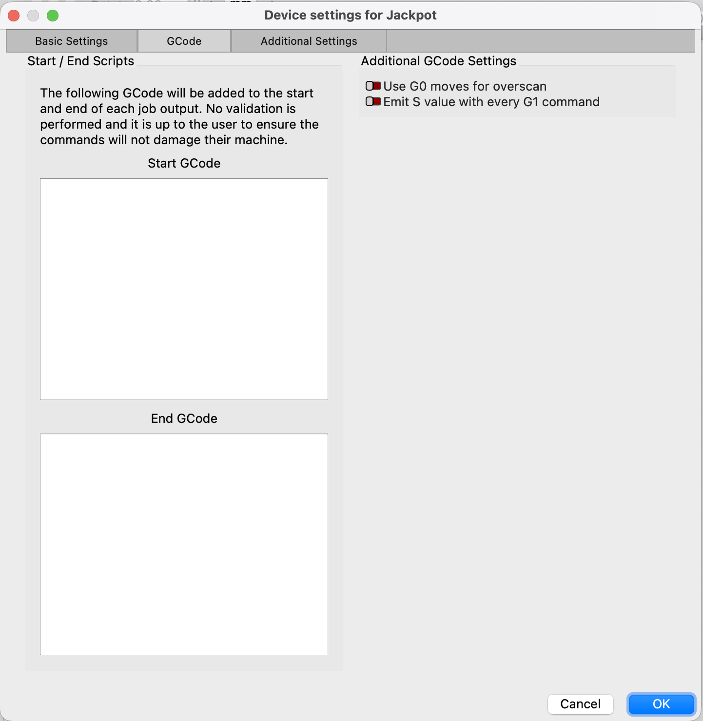

There seems to be a few issues with how it implements Inline Mode for Marlin. As discussed in this thread, it fails to insert an M03 I command into the Gcode output. I had to manually insert the M03 I and M05 I commands into the user start and end codes to make the laser turn on. And there doesn’t seem to be any way (other than manually editing the Gcode or the user starting code) to implement M04 Dynamic Inline Mode.

Try going to Device Settings-GCode and you can add the M03 and M05 there. I’m not sure about the M04 though.
