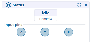

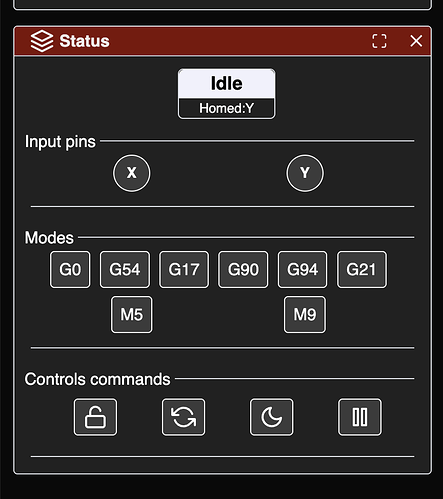

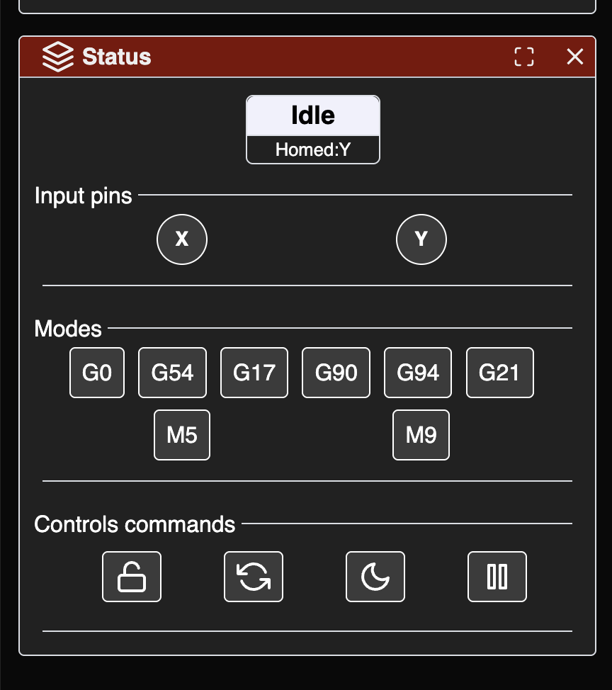

I did notice that the WebUI (v3.0.10) was showing that the endstops stayed triggered, but they weren’t.
So last I checked my indicators only show up after it triggers once, then they show dark when they are actually triggered. Maybe that is what was happening for you?
I just tried homing my MPCNC. I homed it 5 times and display cleared after each try.
It’s fine. I didn’t realize that wasn’t “dark”. So, it was displaying correctly.

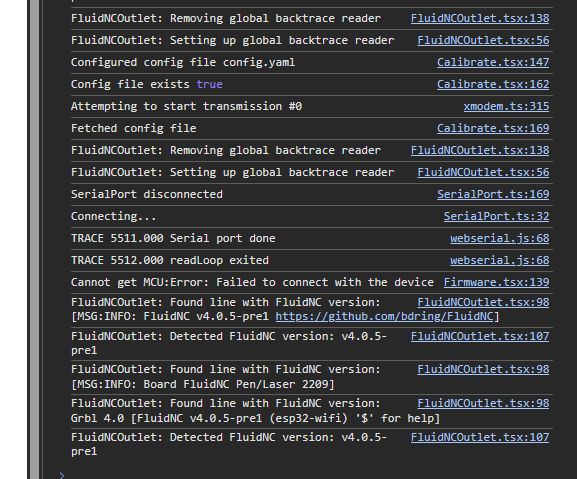

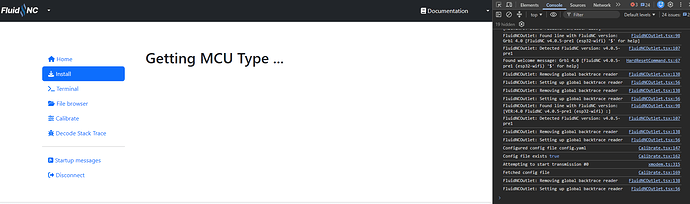

Everything about the webinstaller works fine for me, except install. No errors in the console it just sits forever. I tried in chrome and edge, same in both so it must be some sort of system issue. Edge is as clean as it gets I only ever use it for testing a page so no sign in’s or plug ins.
To flash boards I use the zip tools directly (a little modified). But this is annoying when I want to do quick testing.
edit -
Of course when I say that it actually worked. It is stuck iin some sort of loop that takes forever,
any idea what that is?
You asked about FigUI in the other thread. It will allow you to upload the firmware.bin file also. You might try it to see if it works better for you.
I have never seen that. I’m using Chrome on a MacBook though.
