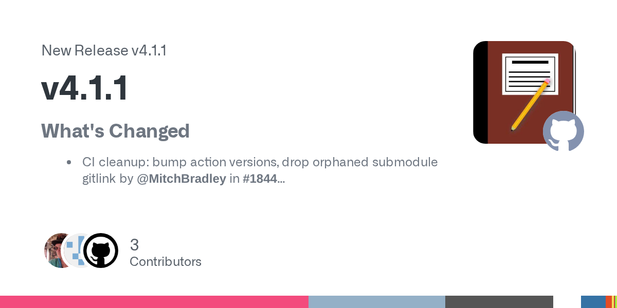

Okay…this is should be good to go, 4.1.1
I must have just put 4.1.0 on my pen plotter like 5 minutes before this was released. Updated to it now. Working on implementing ESP-NOW for FluidTouch.

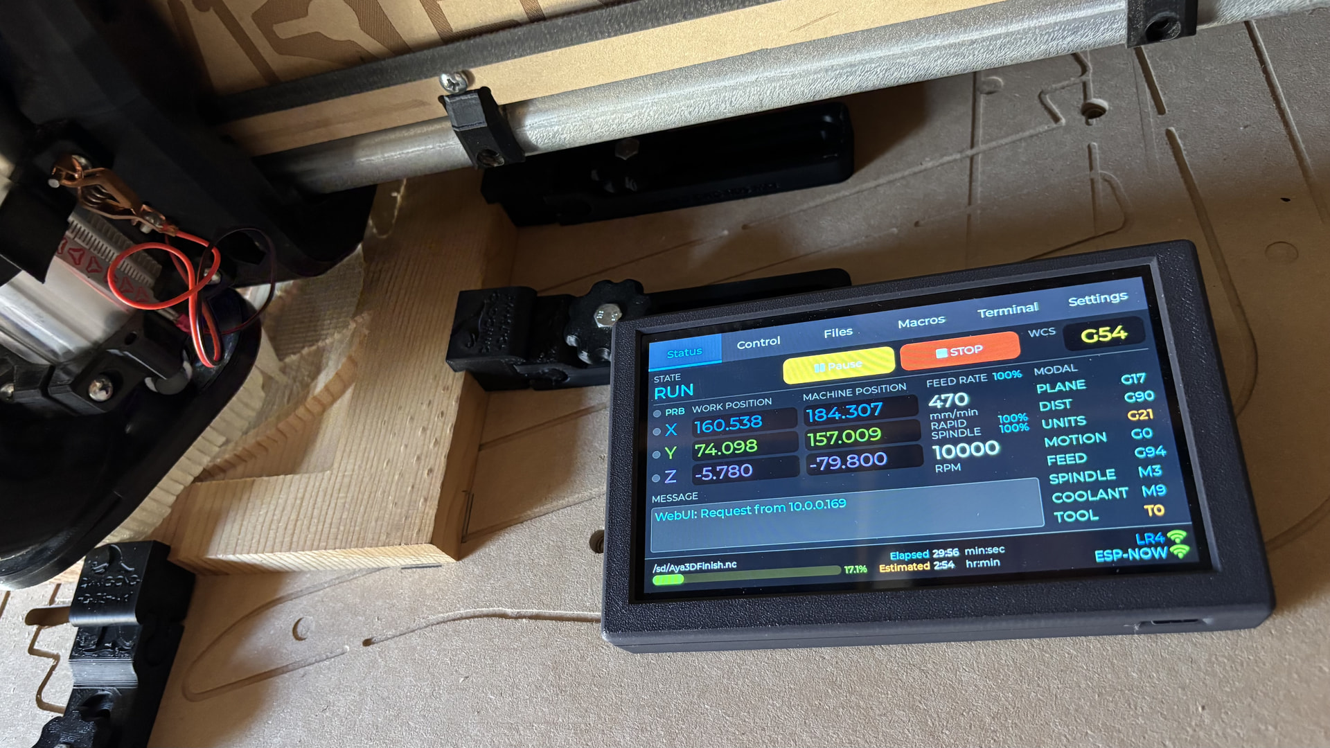

I put 4.1.1 through some testing today. First I upgraded my JP1 on the LR4. Then I paired it with ESP-Now to Jason’s FluidTouch and a CYD pendant. I homed and jogged the LR4 around for a bit first. Then I connected my laptop running MillMage to the JP1 with a USB cable. I used MillMage to jog the LR4 too. Next I used FluidTouch to probe my work piece. Then I used MillMage to frame the project. I ran the first operation with MillMage over USB. No issues there. I did a tool change and probe next. I used FluidTouch to run the rest of the operations from the SD card without any issues. All in all, it was a successful project using Fluidnc 4.1.1 for the first time on the LR4.

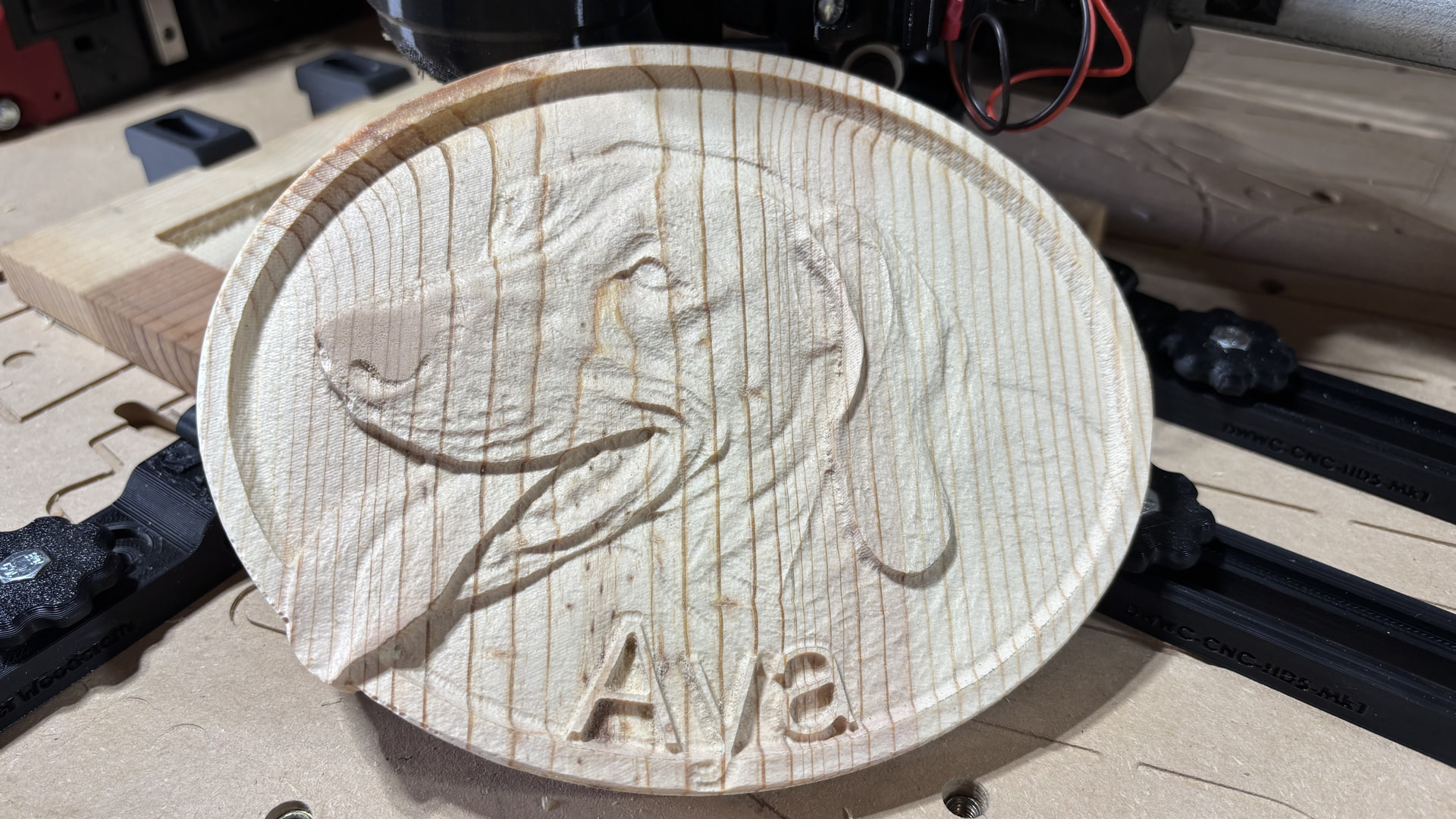

I would consider it good. I’ve done about 20 projects with it now. There’s not been a single issue. I’ve done signs, trays, and even cut out like 7 12" circles for a customer who makes rockets.
