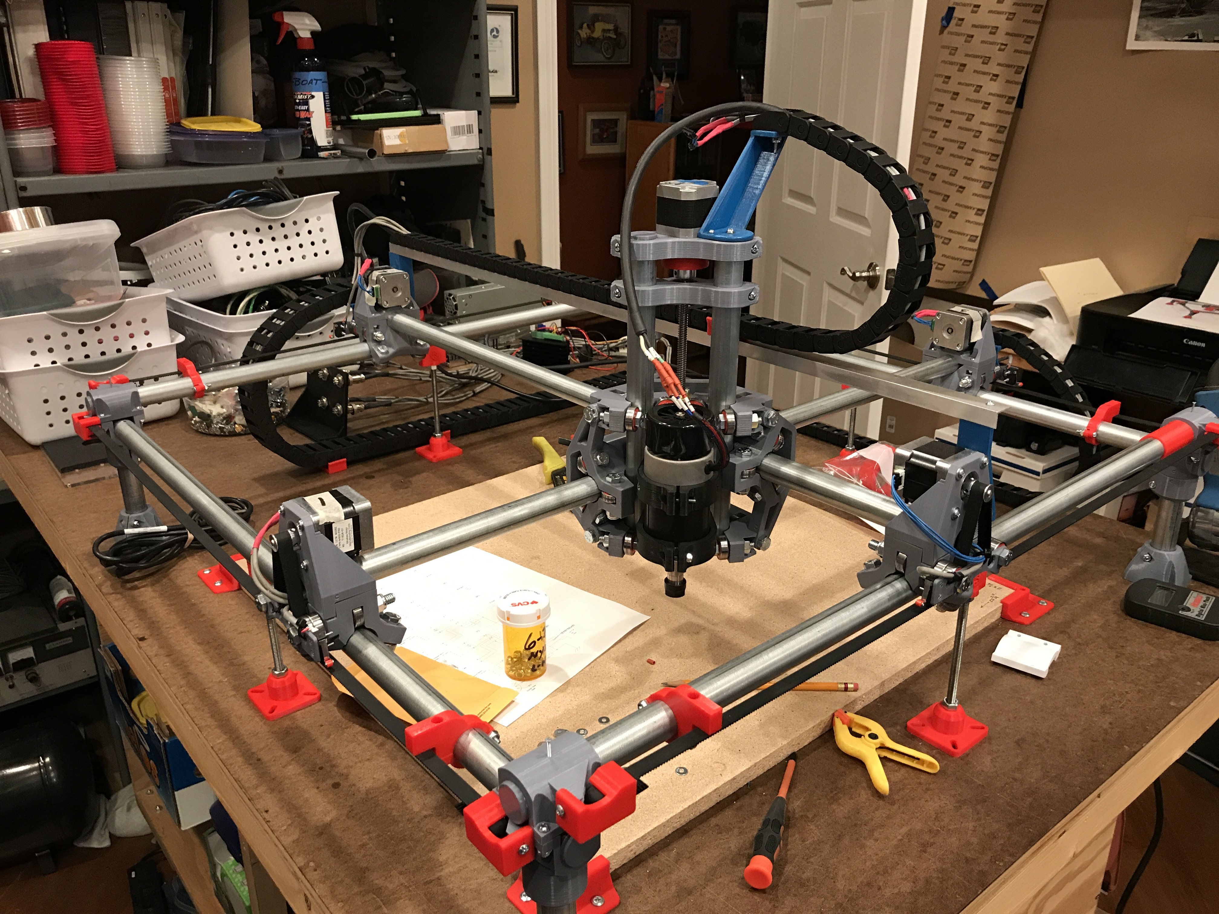

Hi all, Just received the final parts for my MPCNC project. A RAMBO board from UltiMachine.com and a RepRapDiscount Full Graphic Smart (not too sure about Smart part)Controller. All was good 'till I connected the two using Atom and marlin 2.0 (Ryan’s version). The code runs fine but the problem is that the LCD screen contrast is non existent, very dim. I believe I’ve traced the problem back to the RAMBO board. The VCC output at EXT1 pin-1 is +4.49Vdc. The input to the switching regulator is a solid 5.1Vdc from an modified ATX PSU. Being that the LCD ‘contrast’ pin is very sensitive to voltage and the pot seems to do nothing, I hoping this is the problem. I’ve swapped displays with a known good one and its dim too. The new one works fine on the MKS Base 1.4 board in my printer too.
Has anyone else had this problem too. The WEB is full of guys adding resistors and the such to the display PCB as a work around. I’m hoping that ‘tweeking’ the switcher feedback will bring the voltage up to a solid 5VDC. If not…never mind. I need help. The wirdness of the ‘contrast’ circuit on the display didn’t help. BTY, the VCC on the MKS Base China board is +5.0Vdc and everything is as it should be. I got The display thru Amazon from the cheapest vendor I could find. Built by www.bigtree.com in China. It works just as advertised but not on my RAMBO board. I’ve enclosed a shot of my work so far. I’m a retired EE from Hughes and Rockwell Collins and I can’t stop tinkering with stuff. Doug
